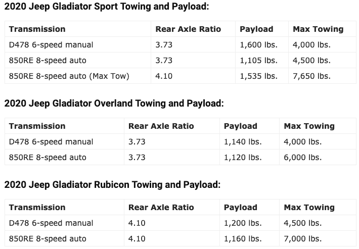

Tow rating for the standard tow package and the auto tranny is 6,000 #’s. The stick is rated at 4,500.

Hmm. I was looking at this, but I think you're right since I can't see how the Overland auto would be more than a Sport auto; I thought 4,500 lbs seemed low.
Jeep Gladiator Worth trading in to go from 3.73 to 4.10? Screen Shot 2020-04-28 at 5.16.47 PM

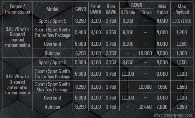

Manual and original spec sheets are misleading - this later came from Jeep and makes a lot more sense - so you have 6000 lbs. with the automatic sport or overland as long as have standard trailer tow package.
What it appears is they just listed the Sport S Rating with automatic and no factory tow package. They left out the line for Sport S with standard tow package (and went right to the Max Tow). So there is a line missing on the original spec. sheets for the standard factory tow package on the Sport S.
Its also misleading with the Overland and Rubicon lines even on this sheet - because you have to get the factory tow package to get these ratings - but it doesn't say with trailer tow package.
