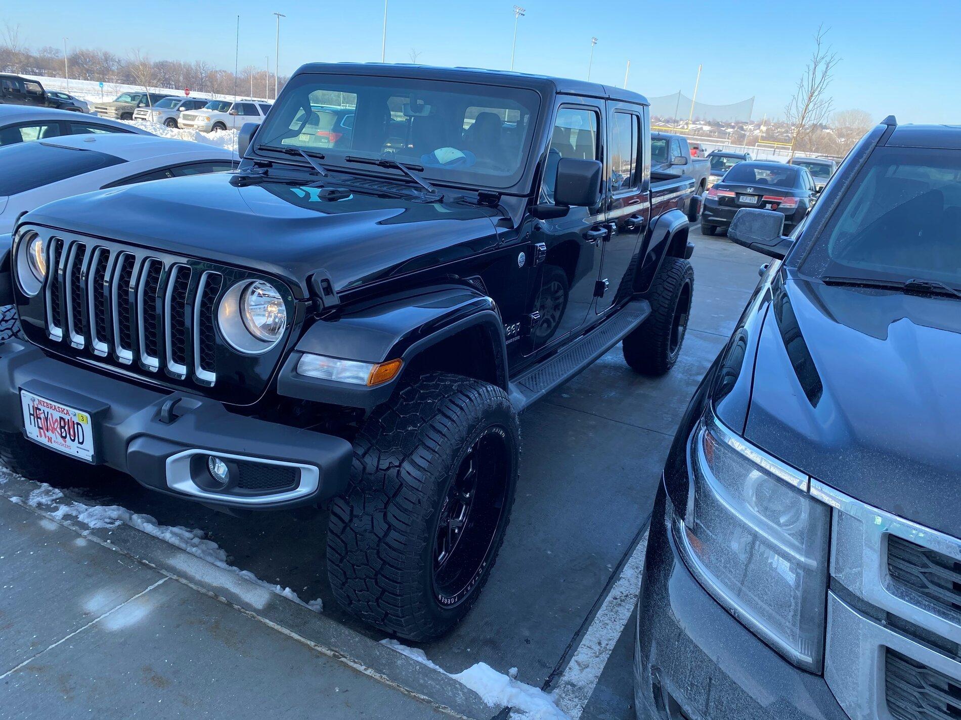

I have 35's on my Gladiator Overland and the gas mileage is crap. Would a tune or gear change help?

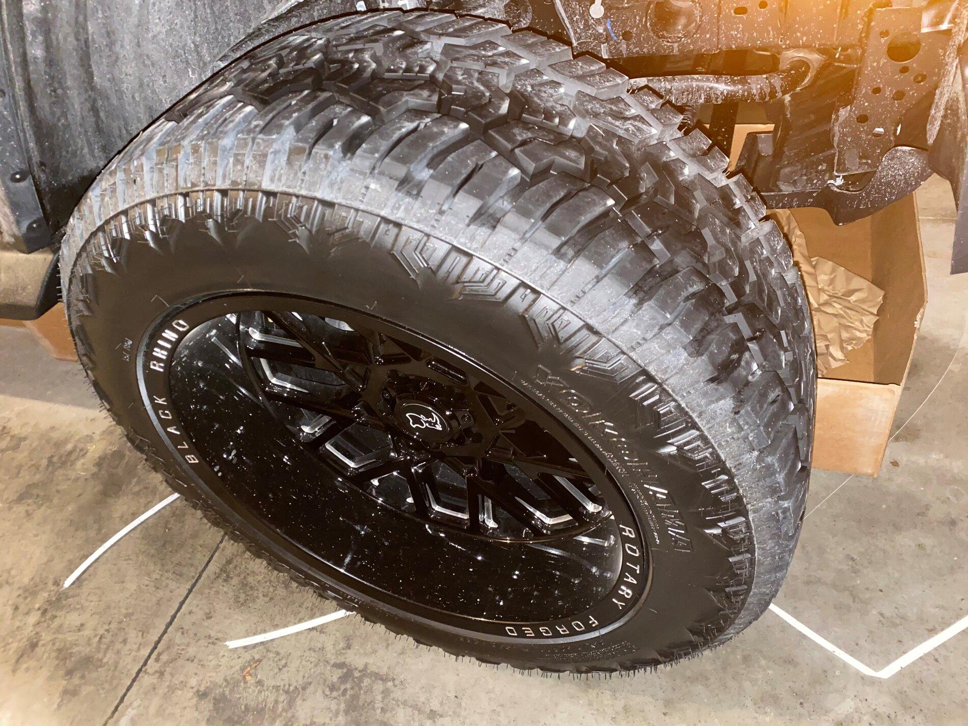

As far as the question being asked, tuning isn't going to anything for Gas Mileage, these things are tuned and setup from factory to get you the most out of your jeep you can get. If you put larger tires on mpgs are going to take a hit and with 3.73 gearing on 35's your going to see a nice hit. Regearing to 4.10 or 4.56 would get you closer to stock mpgs. That's the main reason I opted for Max Tow, I get pretty much 18.2-19.1 mpgs depending on how far I drive mine and if I stay under 80 mph. That's with it sitting like this

About 13MPG

No, I bought it this way off the lot. It has not been programmed. It was brand new - dealer added the 35's and lift.
