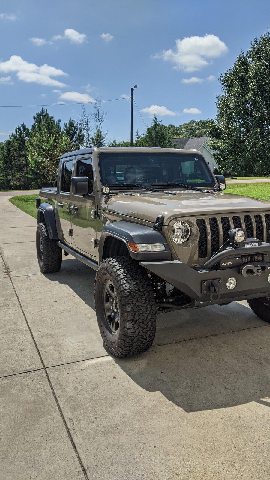

I got the 2.5" SST Readylift kit installed on mine plus Rubicon take off springs up front and Rubicon Fox Shocks. Also installed a Fox Steering Stabilizer but have contemplated removing it because it really didn't do anything. I bought just to match the shocks and to see if it would make any difference but it was already driving great without it and I saw no improvement. Also riding on 315 70 17 BFG KO2s. My dealership had no problem saying they would do it if I saw a issue on the future. Until I do I think I want mess with it, I would hate to mess up a good thing.
How it sits right now
Jeep Gladiator Would you do the Steering TSB if yours drove like this? PXL_20200913_173326147
Also drove it on a 6hr trip to Elizabeth City back in April and had the lift and tires on it then. My wife actually drove while I rode shotgun and all she did was rave about how great it drove in comparison to my JKU I sold.
