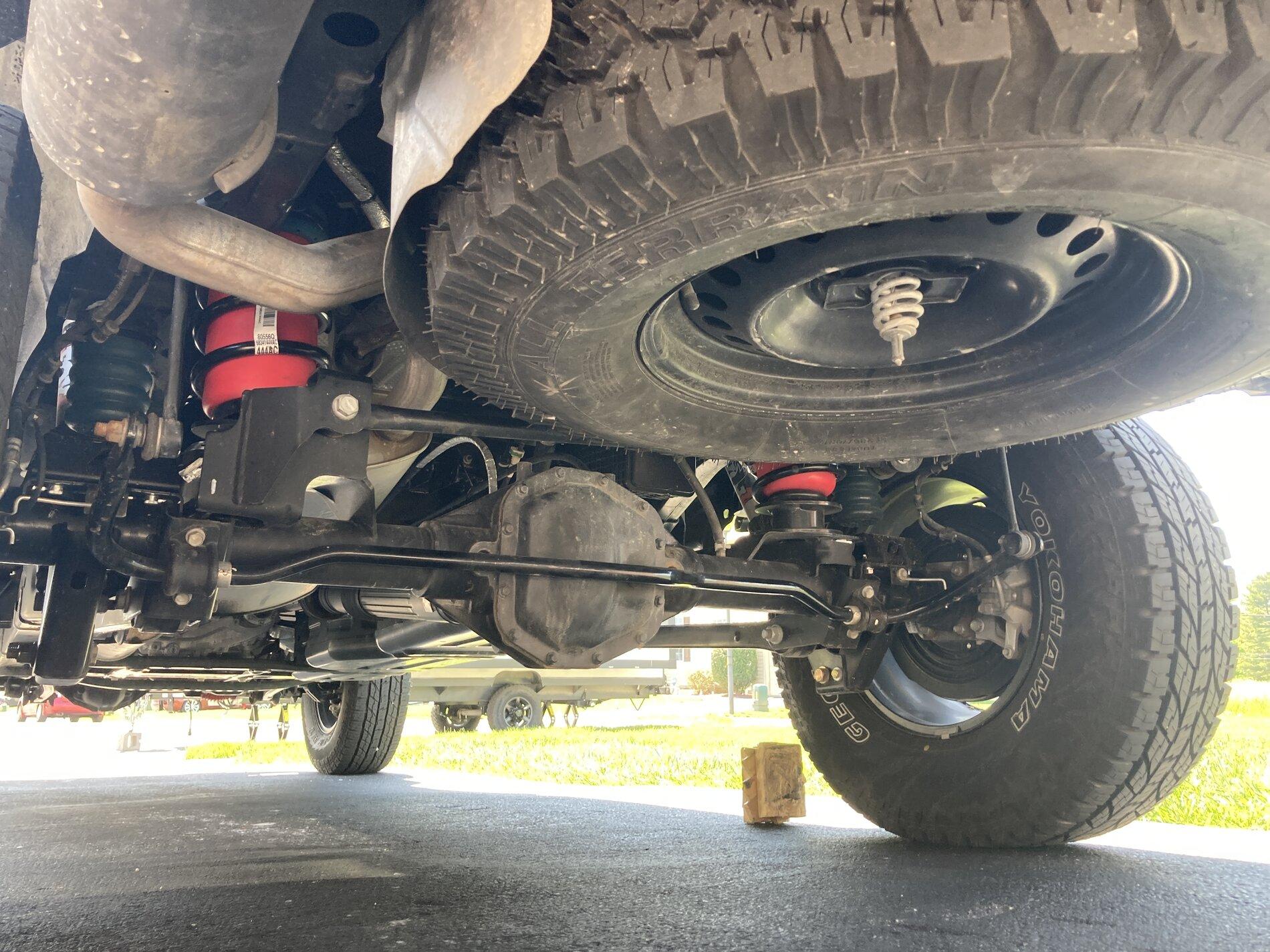

@danielspivey, that brings up a good point on tires, do folks change out their load C tires for load E? Starting to convince myself to go down it trailer weight to around 4k just so I don't have to constantly worry about what I put in the trailer or bed of the truck. I don't want to be limited on how many cases of my favorite beverage I can bring along :)
My travel trailer weighs around 5000 pounds fully loaded, tounge weight of 500lbs +/-, and I have the max tow that pulls it with a weight distribution hitch, and air lift airbags, as well as 10 ply tires. Though I feel like the JT struggles to pull it and often sits in 4th/5th while driving flat.
that being said I recently went back to the stock tires because after doing a ton of reading you lose towing capacity in relation to the increase in diameter from your stock tire size, as well as cargo carrying capacity from the added tire weight for whatever you put on. That’s just food for thought.
The max tow comes with tires that are not 10 ply and there are plenty of people who tow with those tires upwards of the maximum weight without any issue. So a lesson that I’ve learned over hours of agonizing Interneting is that I don’t believe in the 10 ply tire being overly necessary for our pulling needs.
Jeep Gladiator Would you feel comfortable towing... 4121C6E4-8315-451B-A6A6-56F788EFFDF2
now to your question. You can tow that TT, but may feel sluggish since its right up on your weight and cargo limits. You will absolutely want a wdh and id suggest airlift air bags. Not that youd need them, but man do they make a huge difference.

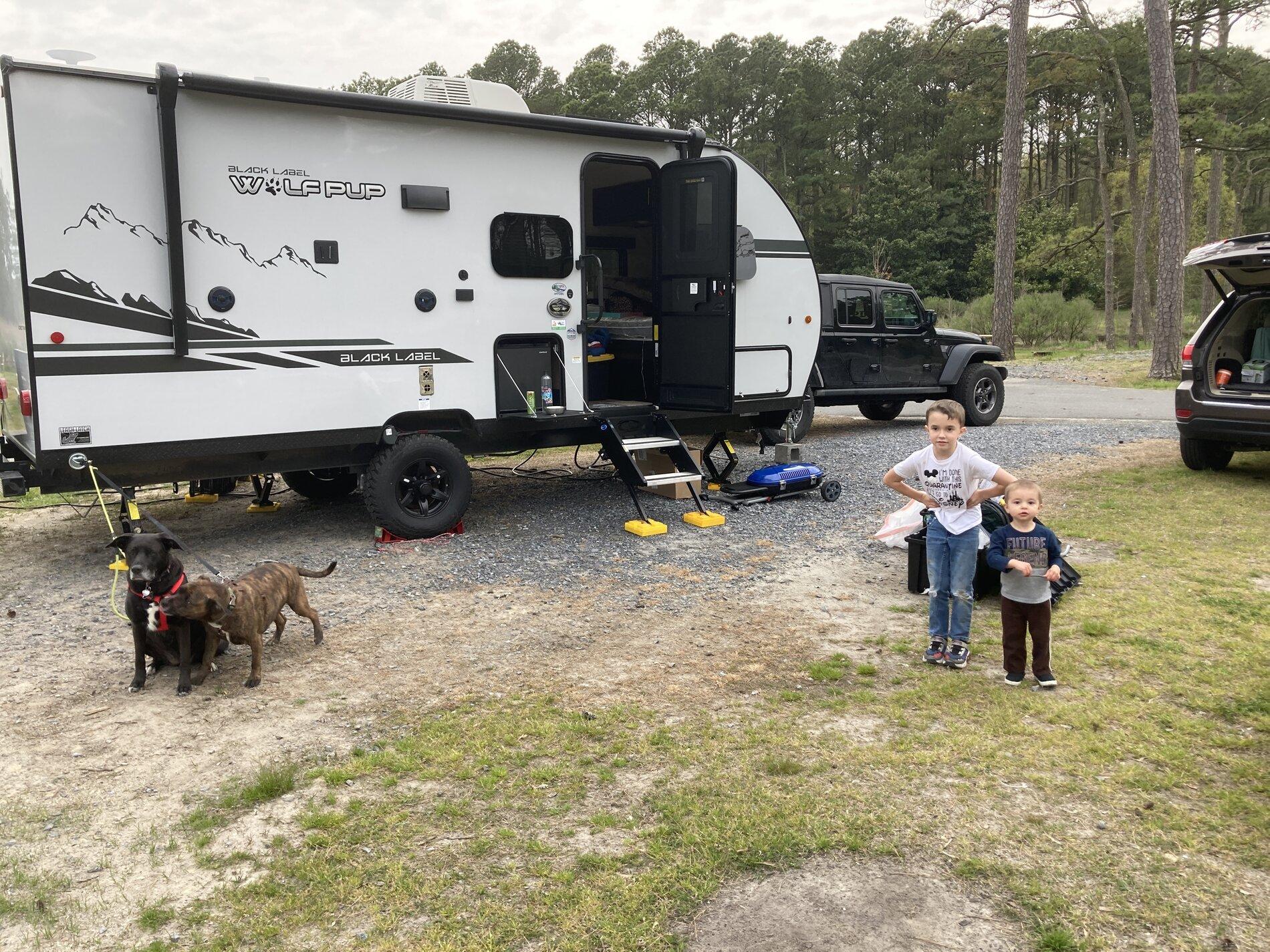

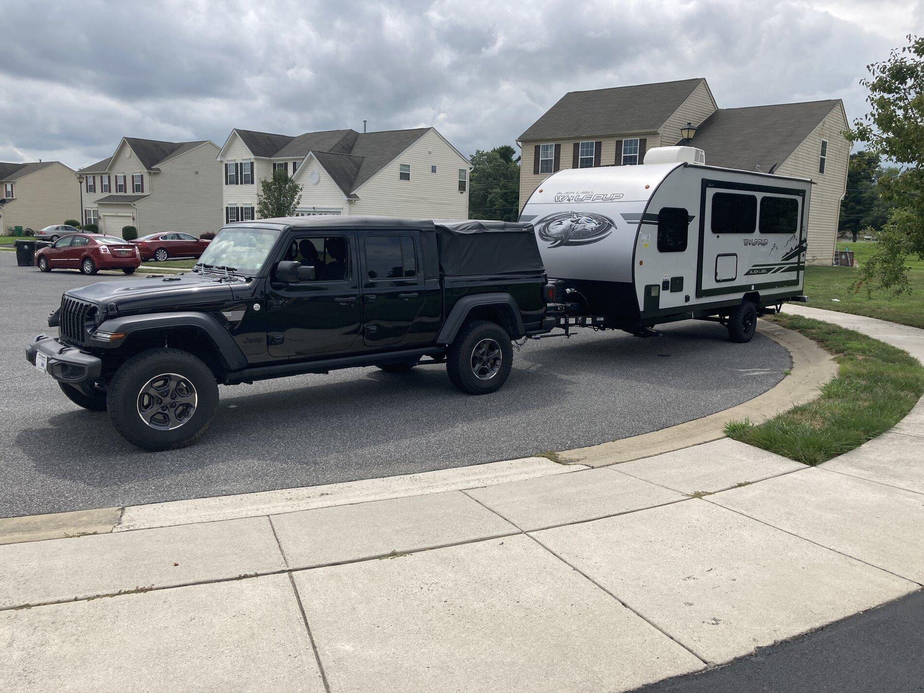

@Gren71, are you happy with the wolf pup? What do you figure is the load on one of your trips?
VERY happy with the pup. We got the 18TOBL with the off road package and solar panel.
Fits the wife, my 7 and 2 year old, and our two dogs, with room to spare.
I haven’t weighed it but im positive we get close to 5,000lbs by the time food and beer is loaded. To offset all the weight in the front storage we leave a bit of water in the black tank when we travel. Helps keep the tank clean aswell. Sits well on the Jt. We Certainly notice trucks and all on the highway but nothing nearly as dramatic ad people make it seem…either the army had made me numb to being scared (real chance this is true) or its just not as bad as people say with the single axle.
longest trip ive done was from delaware to niagra falls ny, 460ish miles one way. With my heavy tires it was a little sluggish on inclines, but honestly pulled great.
the wdh and air bags make a HUGE difference in pulling, even with a jtmt.
for the price i think ya cant beat the value compared to anything else in the same size and weight.
