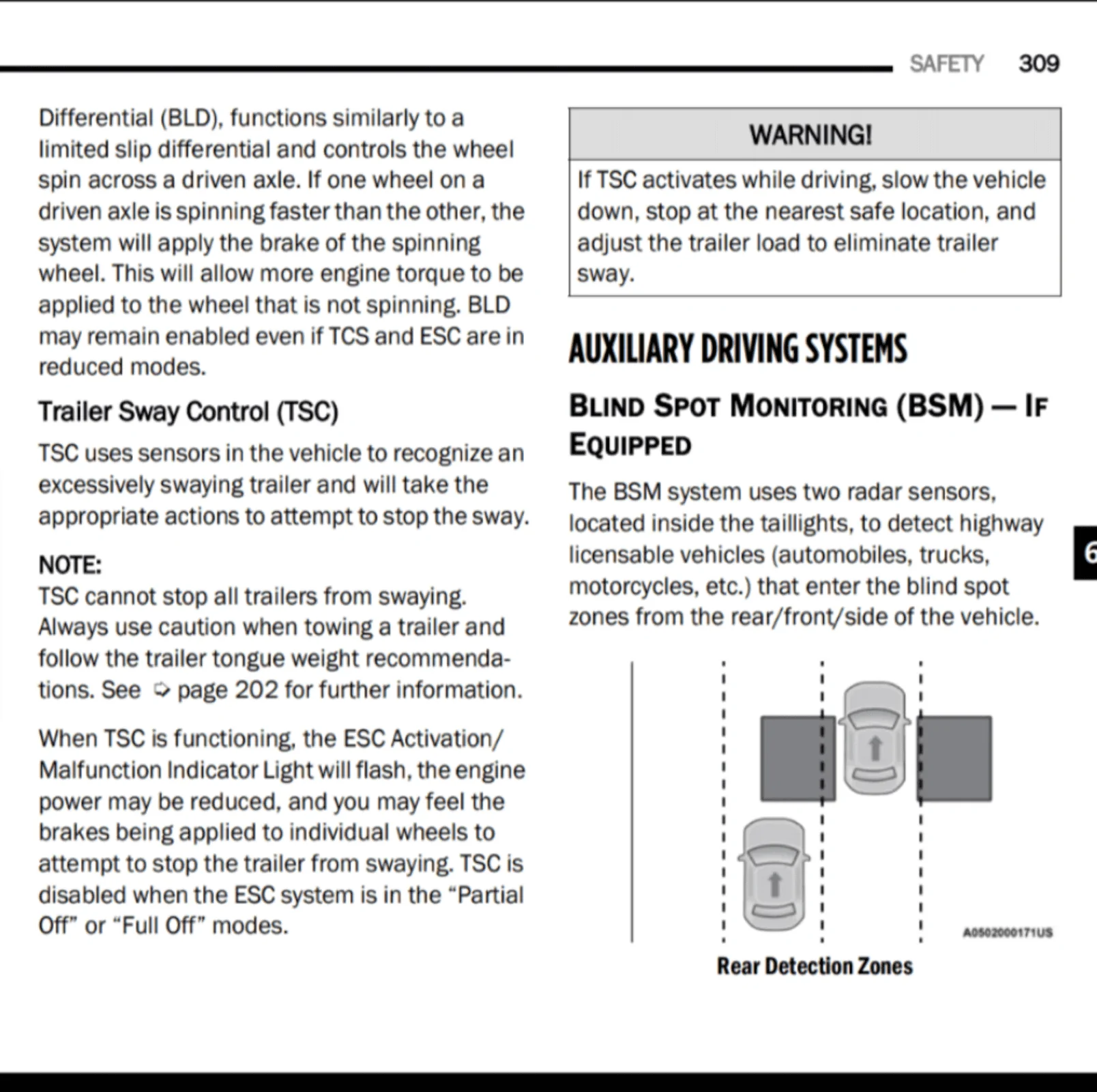

The Gladiator has a built-in sway control.
Page 309
"Trailer Sway Control (TSC)
TSC uses sensors in the vehicle to recognize an
excessively swaying trailer and will take the
appropriate actions to attempt to stop the sway."

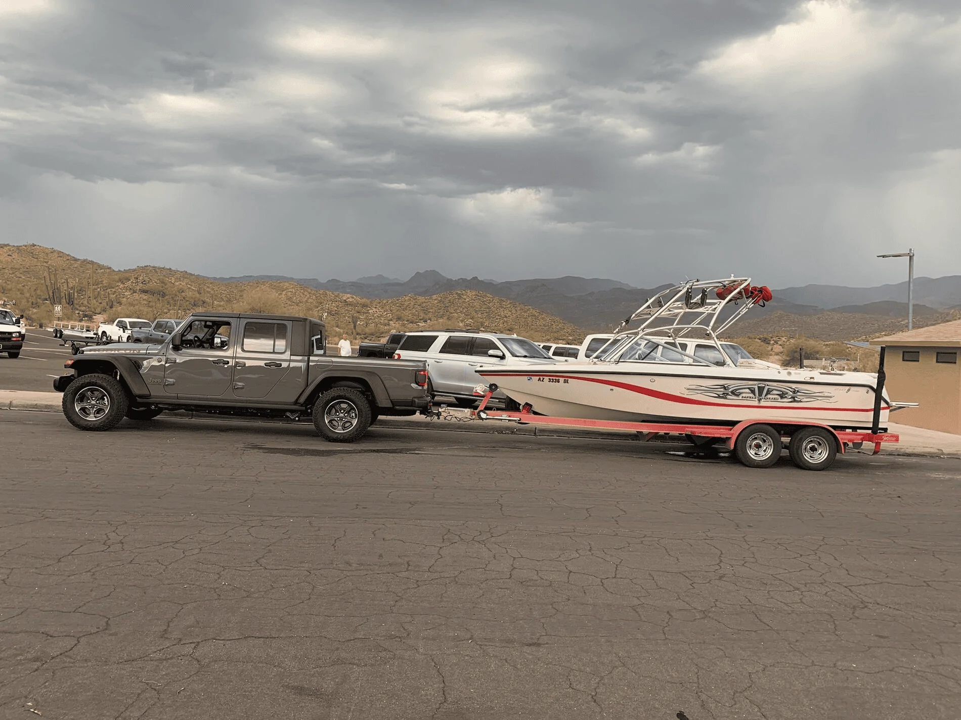

Yes, I regularly tow a 5,500 # boat with my Gladiator diesel on 100 mile round trips to the lake and back home. I previously had a 2012 Ram 1500 Crew Cab with 5.7L Hemi. I have noticed that I need to go slower in the Jeep. In the Ram I could go as fast as I want and not have any stability issues. In the Jeep I can feel the boat slightly moving the Jeep around on a really bumpy stretch of road.
Page 309
My guess is that only comes with the other nifty safety features in that package. None of which i have :facepalm: so can’t really speak to their efficacy.
It comes with the tow package.
