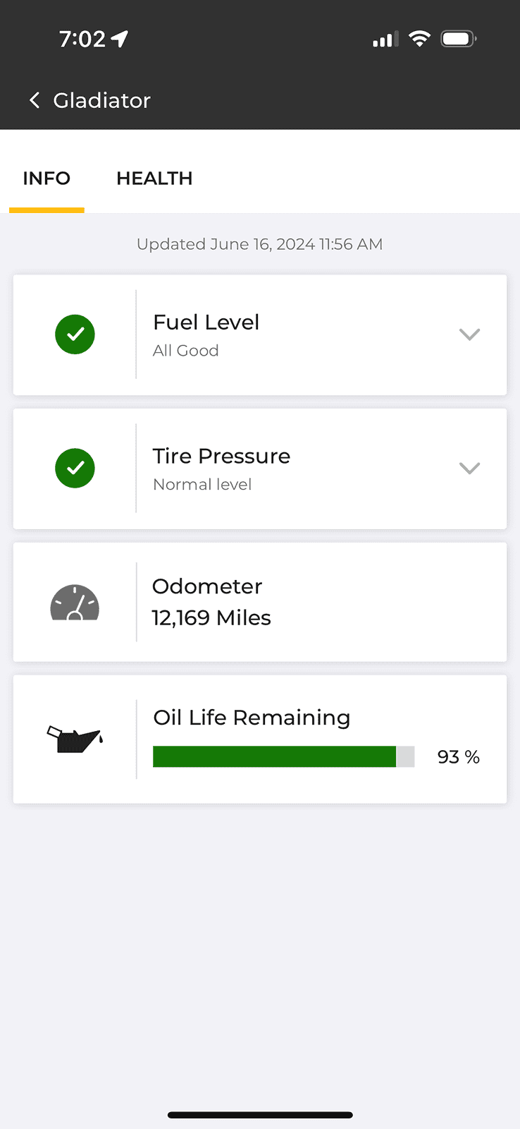

As of your post, you have/had 2,654 messages on this forum and 26,542 miles on your JT. You may want to play the lottery tonight. And that is low miles for three years.
Shit, that’s nothing. Bought first week of October in 2021.
