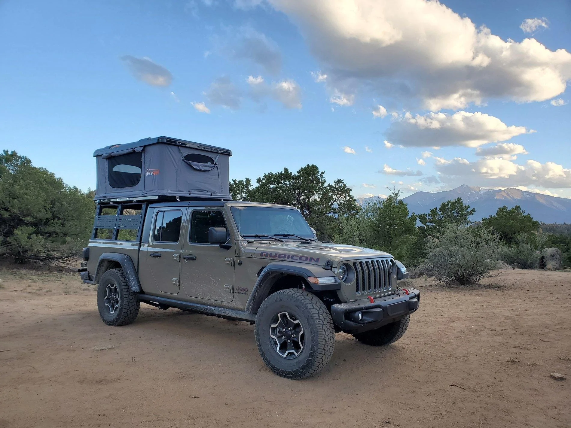

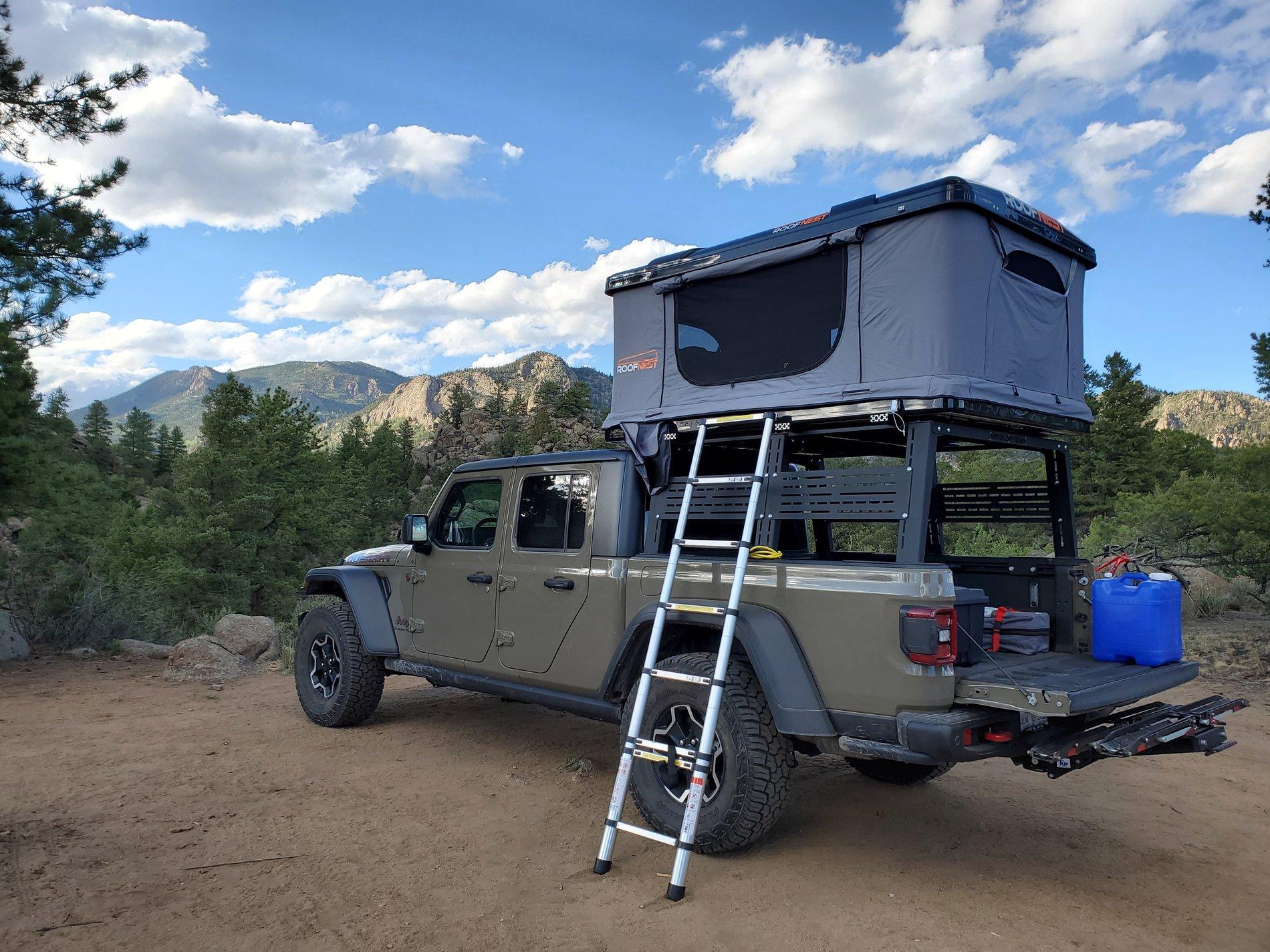

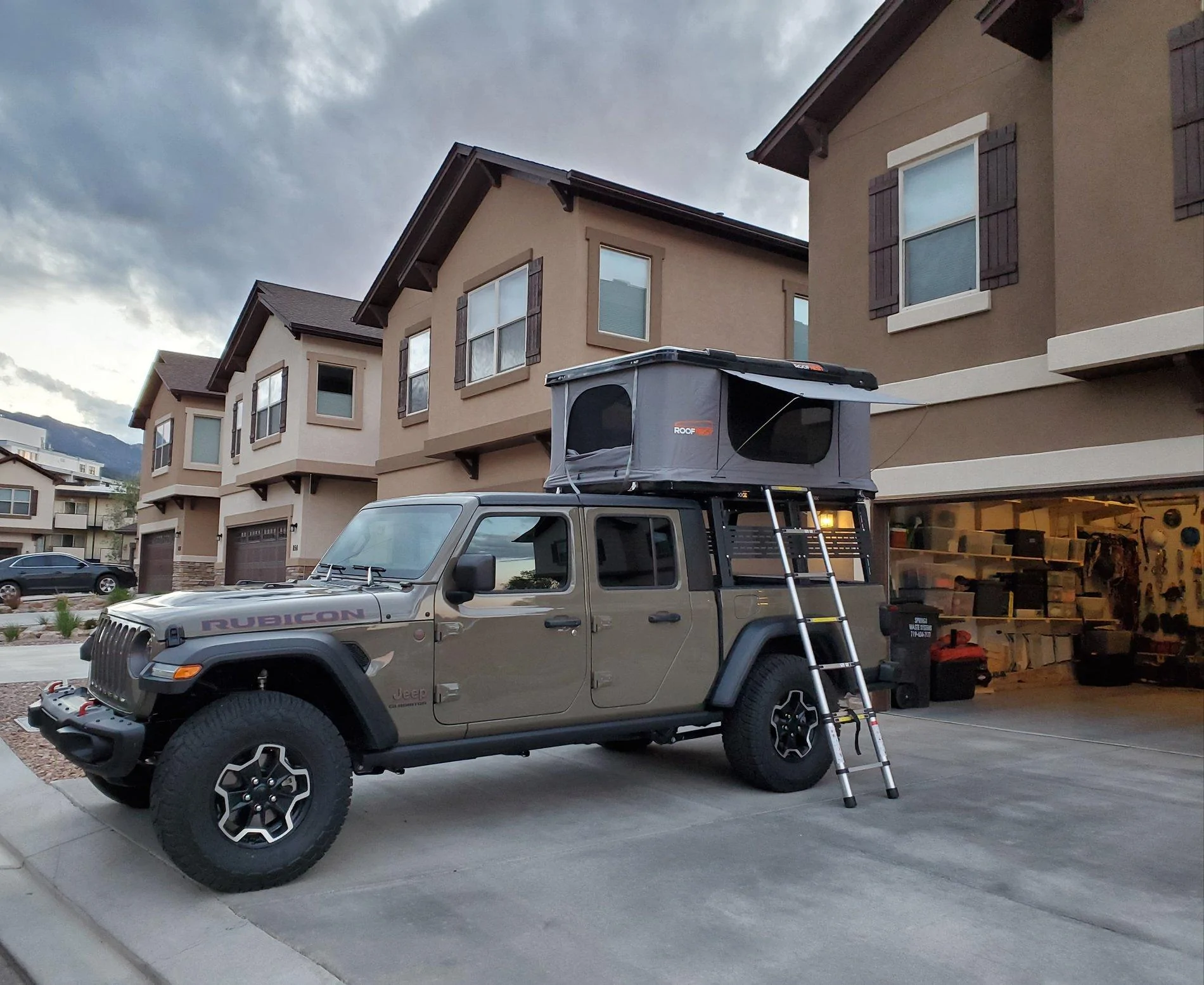

I have my Alucab tent extending over the cab. It is roughly the same closed size as the Ikamper. I am very happy having it over the cab. It even keeps the back seat cooler during the summer time. I DO NOT hear any wind noise. That surprised me but the tent cuts right through the wind. I also did not notice much MPG loss.
Jeep Gladiator XL RTT - Extend over cab or stick out the back? 89E2114F-6835-44AD-BFAB-3C14E39C139F
PhantomChameleon
Nov 6, 2019
397
700
Gator Gladiator Rubicon

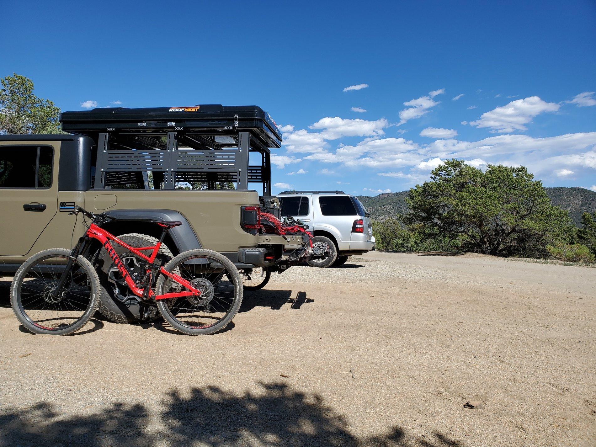

Awesome setup!
I totally agree about the tent placement - I have a Roofnest Eagle that I have set up to extend a little over the cab. It looks way better that way in my opinion, and I've never had an issue with it offroad.
I do not hear any wind noise with mine either, which surprised me as well. I honestly can't even tell the tent is up there, which is amazing after having it on a smaller vehicle where it was VERY noticeable.

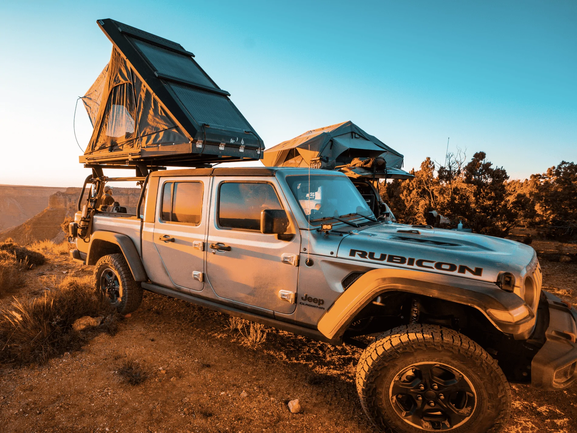

We really love it! I had been wanting one for a few years and we finally got one a couple years ago or so. We have used it a ton, and it really makes car camping easier and faster since the tent just pops straight up. It also helps with storage too since bedding can all be stored up there.
I highly recommend the hardshell RTTs as I feel they provide maximum benefit over some of the fold out soft tents that require almost as much time and effort to set up as a much cheaper ground tent.
This one is the Roofnest Eagle (now called the Sparrow XL I believe), and is just slightly smaller than a queen sized mattress inside...extremely comfortable and fun to sleep in!
Only real downsides are that if you want to drive away from camp you have to take the tent with you (we often take a canopy to set up to hold the camp spot while we are gone), and if you need to use the bathroom in the middle of the night, you have to climb down the ladder :CWL:
Added bonus: with the pitch and roll sensors in the JT's Off-Road Pages, its super easy to get it level!

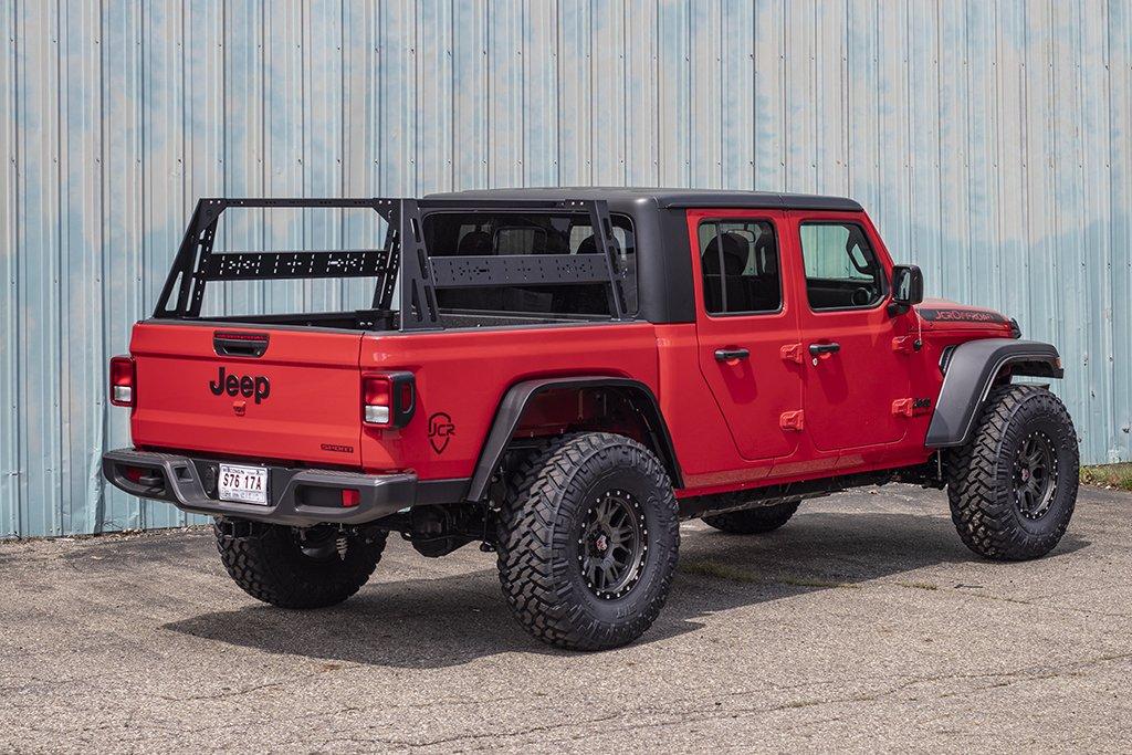

Anyone have any proven solutions for JCR Full Rack? I am running into the same problem....

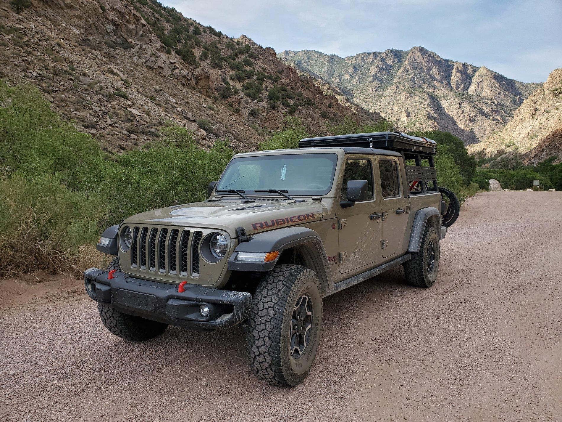

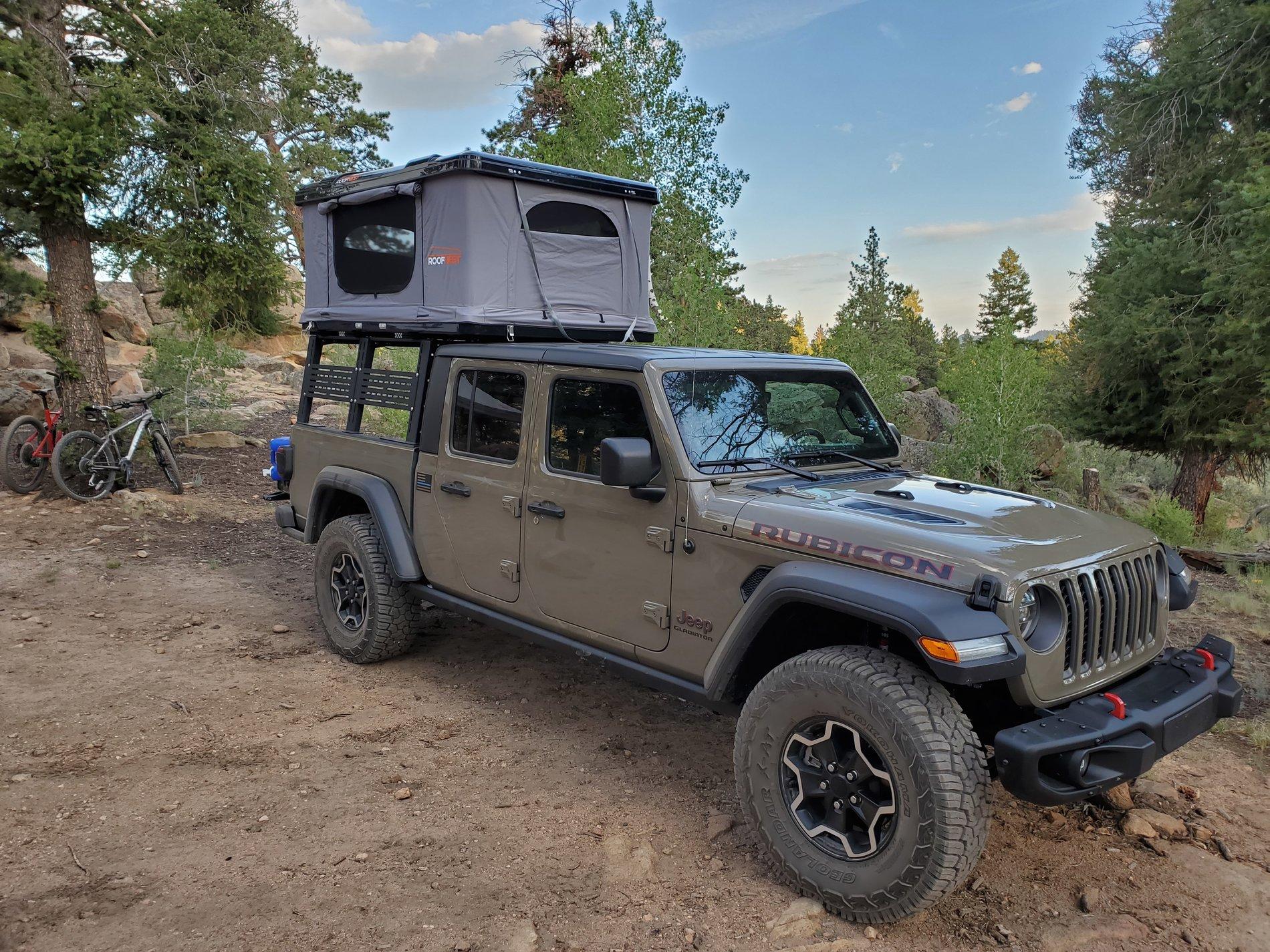

Here is my ikamper with rack extended over the cab. I have noticed no wind drag or reduced mileage.

I think I have a solution. The rack portion is installed and I'll be testing the tent on it this week (finally!)
  • FrontRunner Outfitters 1400mm Universal Track Set attached to the top of the JCR Full Rack
  • FrontRunner Outfitters Foot Set (2) 40mm-50mm
  • FrontRunner Outfitters 1425mm slats to use as load bars
I discovered that even if I WANTED to have the Skycamp attached straight to the JCR rack and just hang way off the back of the truck, the crossbars for the JCR rack are too thick to be used with Skycamp tent mounts. It turns out I need different non-JCR crossbars that are thinner, at which point I might as well raise them up a little so I can stick the tent out over the truck's cab. That's what the FrontRunner Universal Track and Support Feet do -- they raise the load bar up high enough. (I think, to be tested when the wife finishes work in a few days and can assist in lifting it onto the truck). You can contact the company directly by opening a support ticket and they'll create a custom quote of just the parts you need. They generally respond next business day.
Of course, I bought the FrontRunner Load Bars but now I'm already wondering whether I should replace them with a FrontRunner SlimLine II Rack so that I can have the support I'd need to mount an awning on the opposite side. Just Empty Every Pocket....
