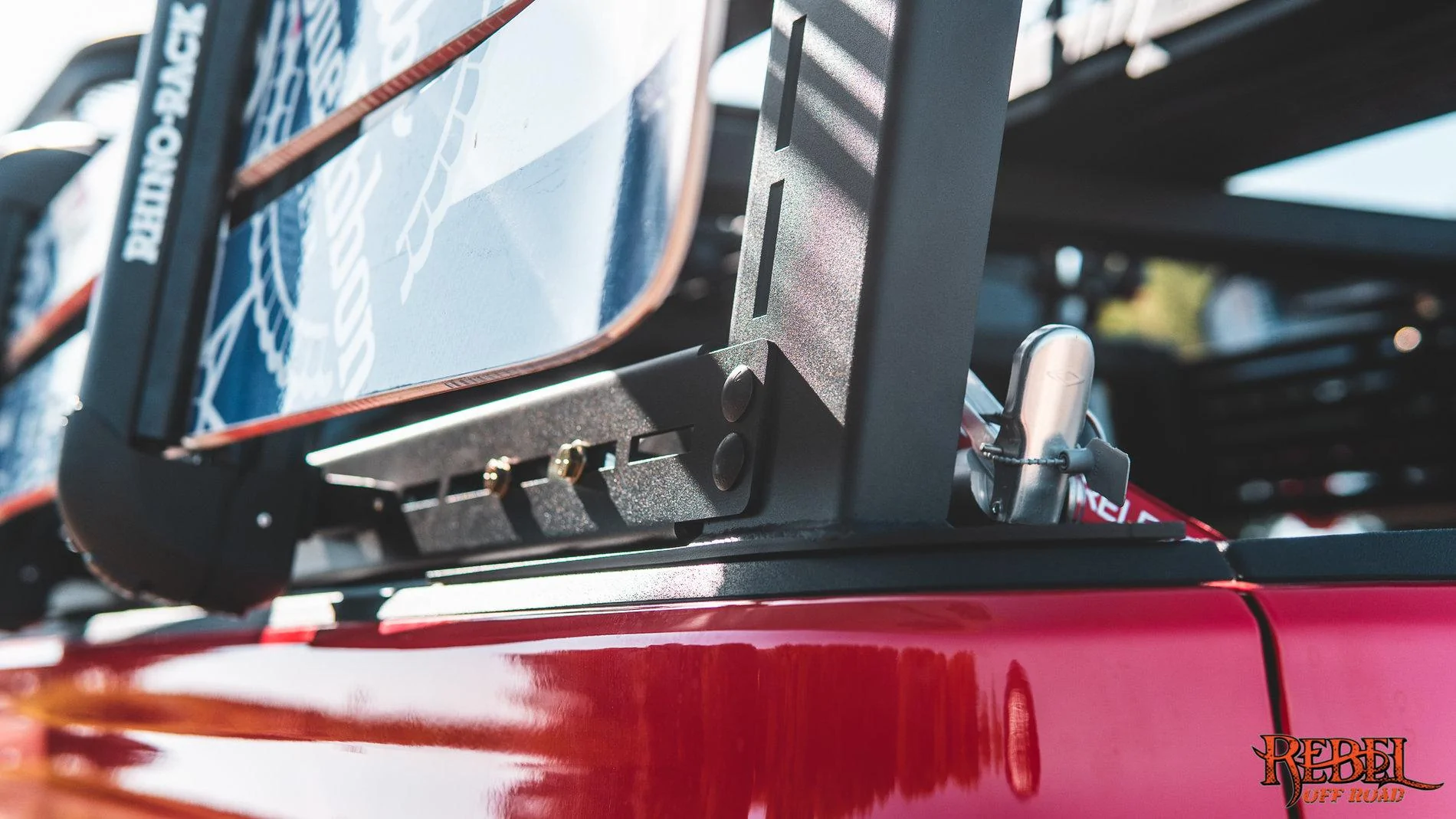

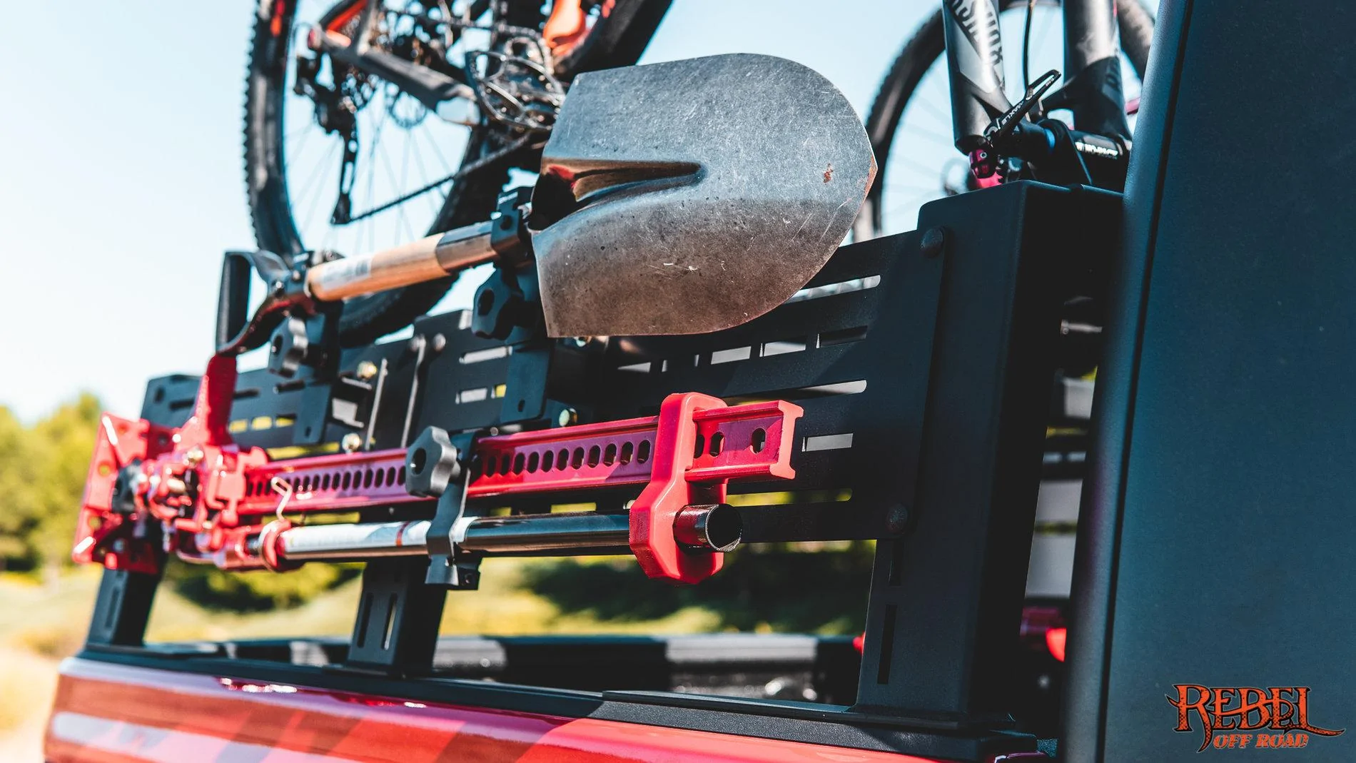

Looking for a truly modular, make it your own bed rack system for your Jeep Gladiator? Look no further. We've created the XPLOR Rack with customization front and center. With the ability to mount our carrier plates on the outside, inside and top of the rack, you can create the perfect setup for your next adventure. We went with half inch bolts for mounting to your existing factory frame rails and 3/8" carriage bolts throughout out the frame for added strength and reliability.
Our rack allows you also to run either a Halo Rack on top or the Rhino Rack Pioneer platform for additional mounting/storage options. With plenty of locations to mount lights, if you decide you need to make your own, feel free to drill into the cage and create your custom light setup.

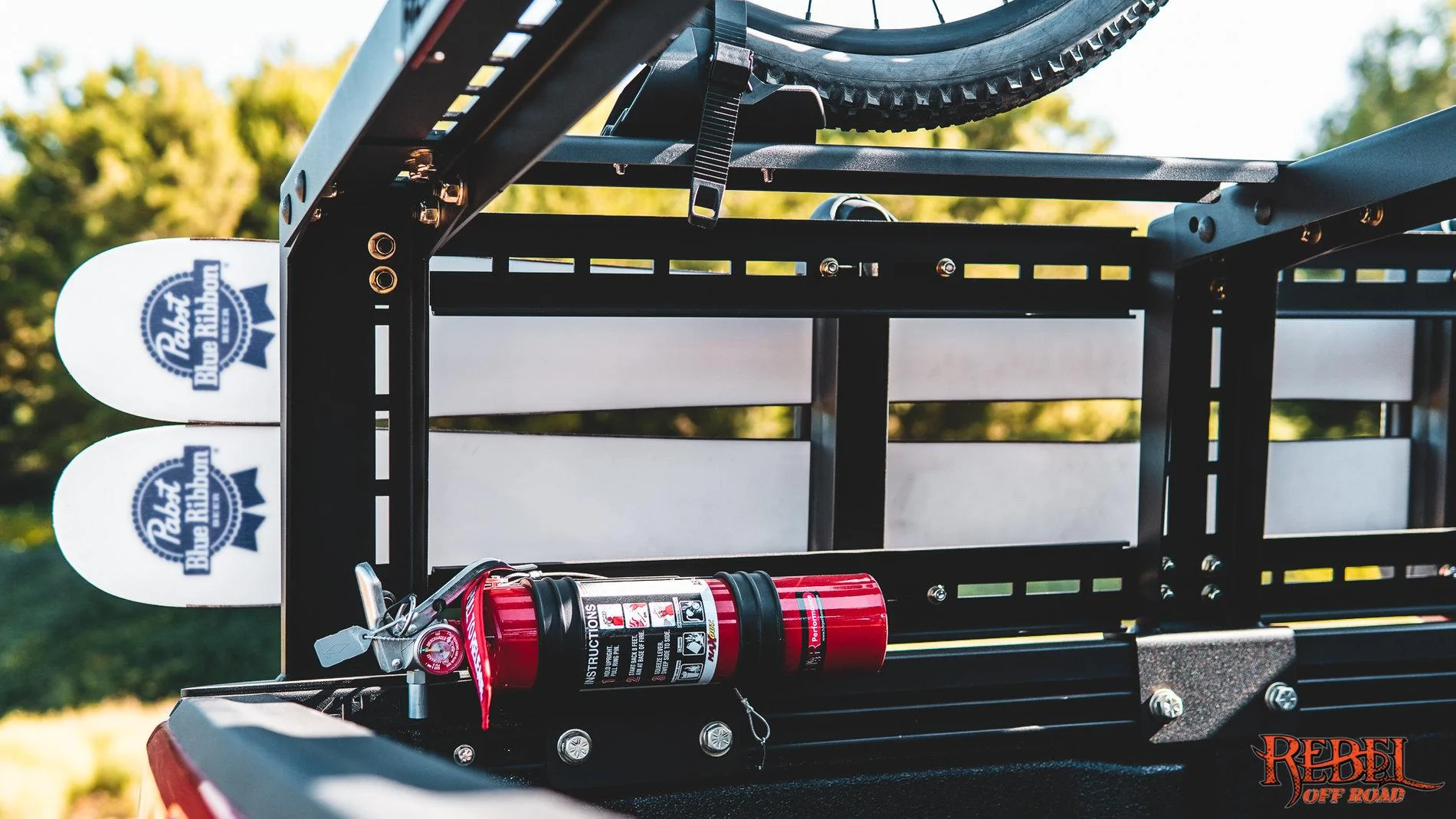

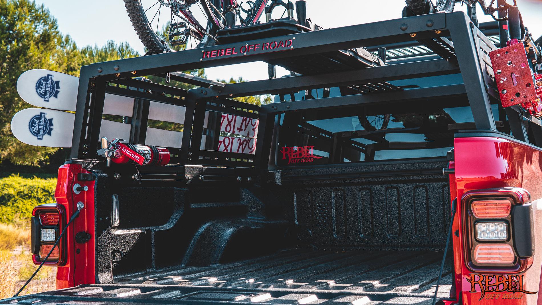

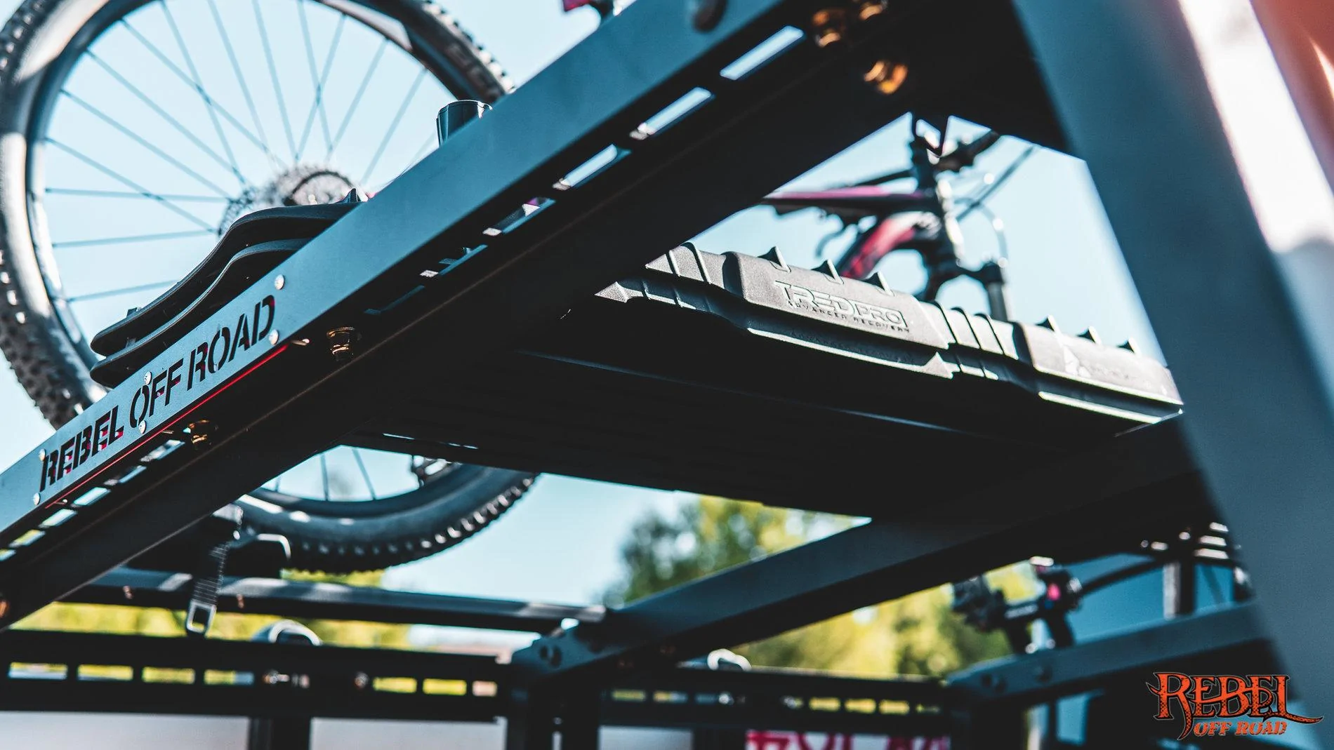

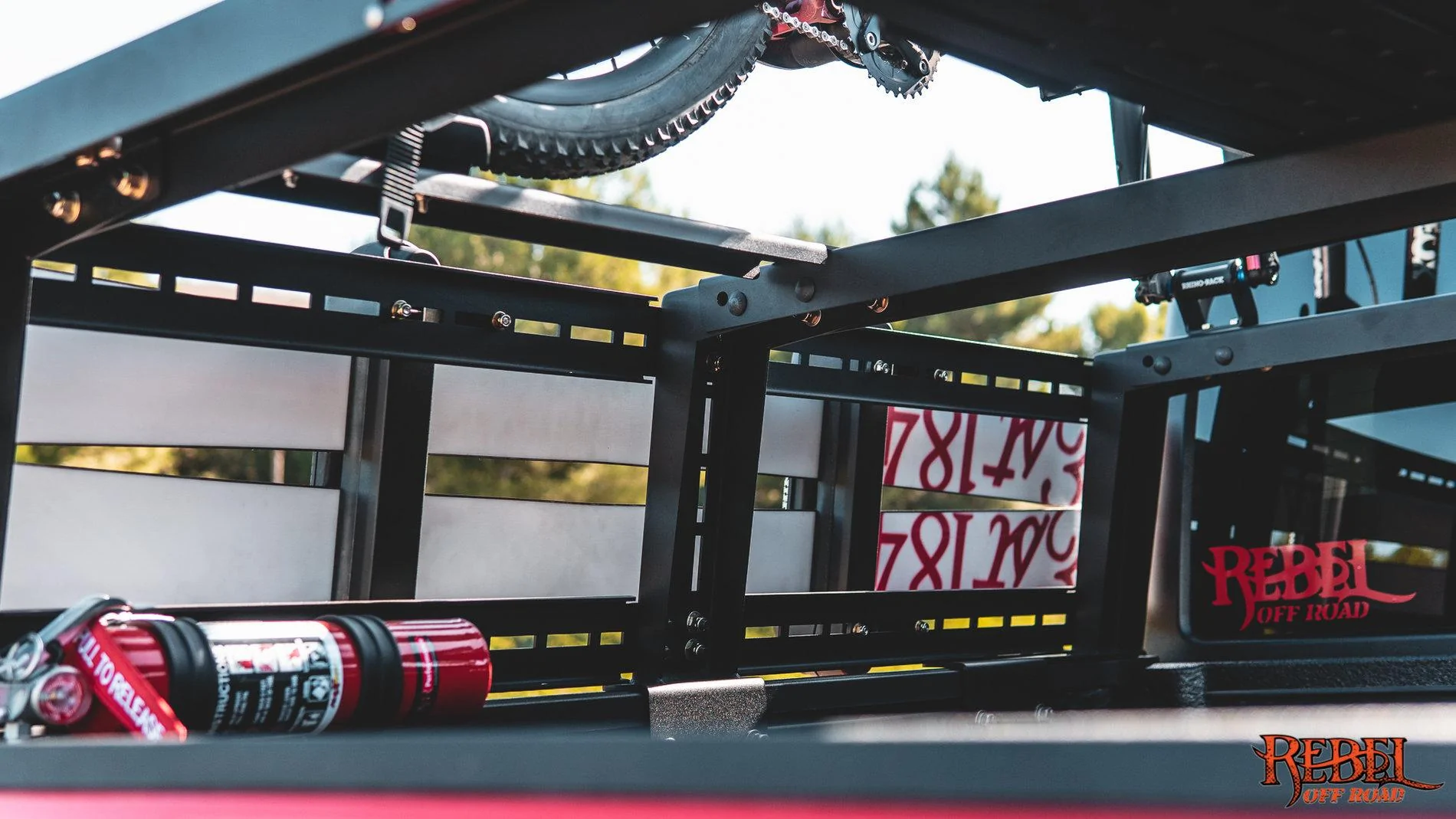

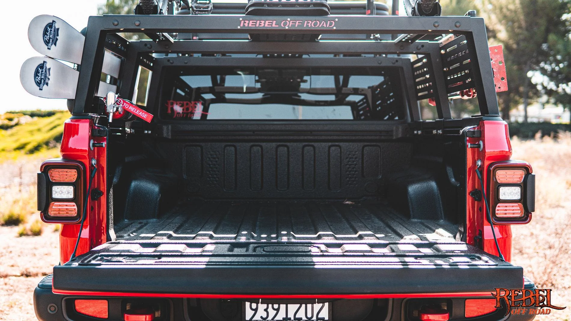

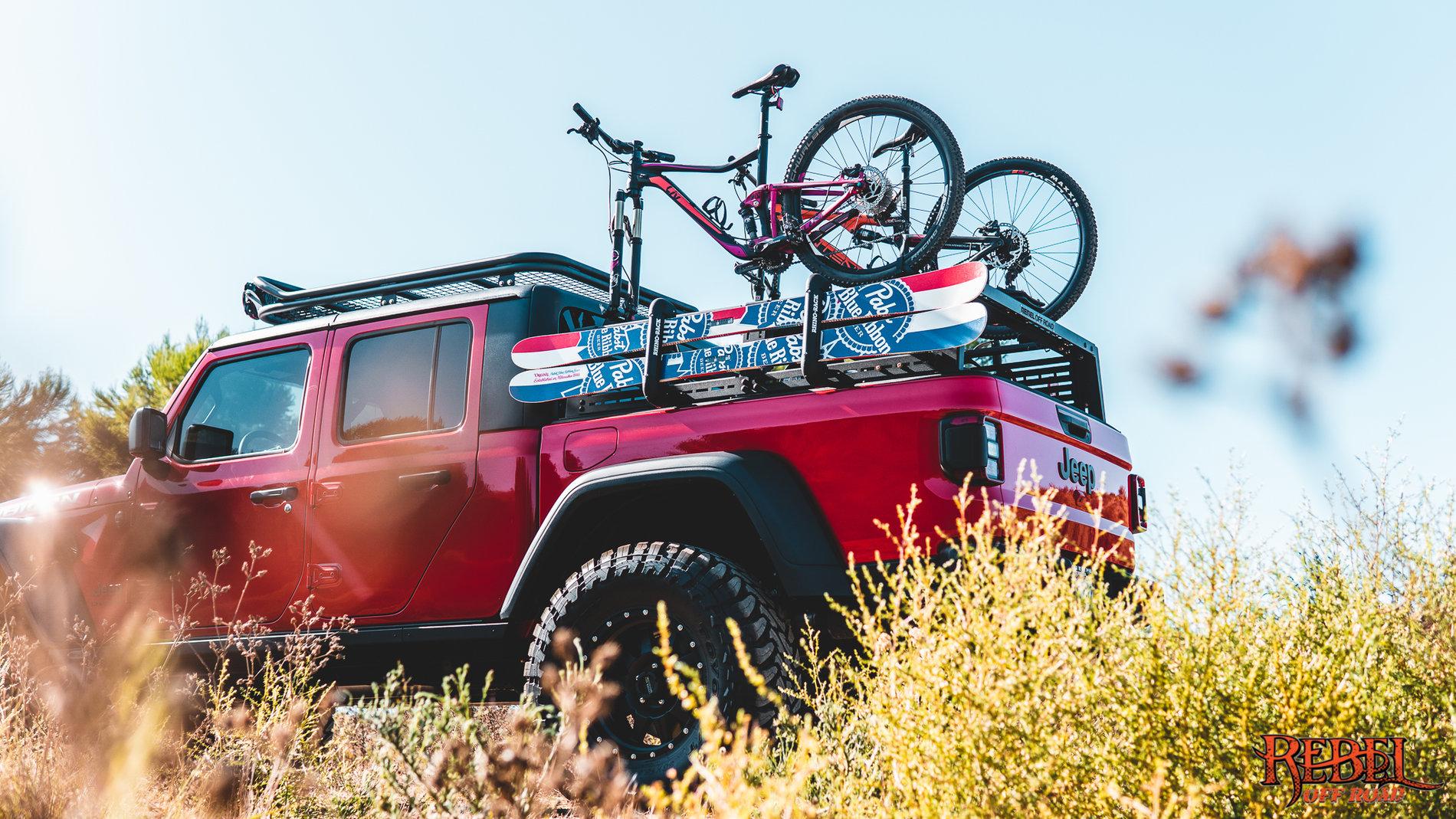

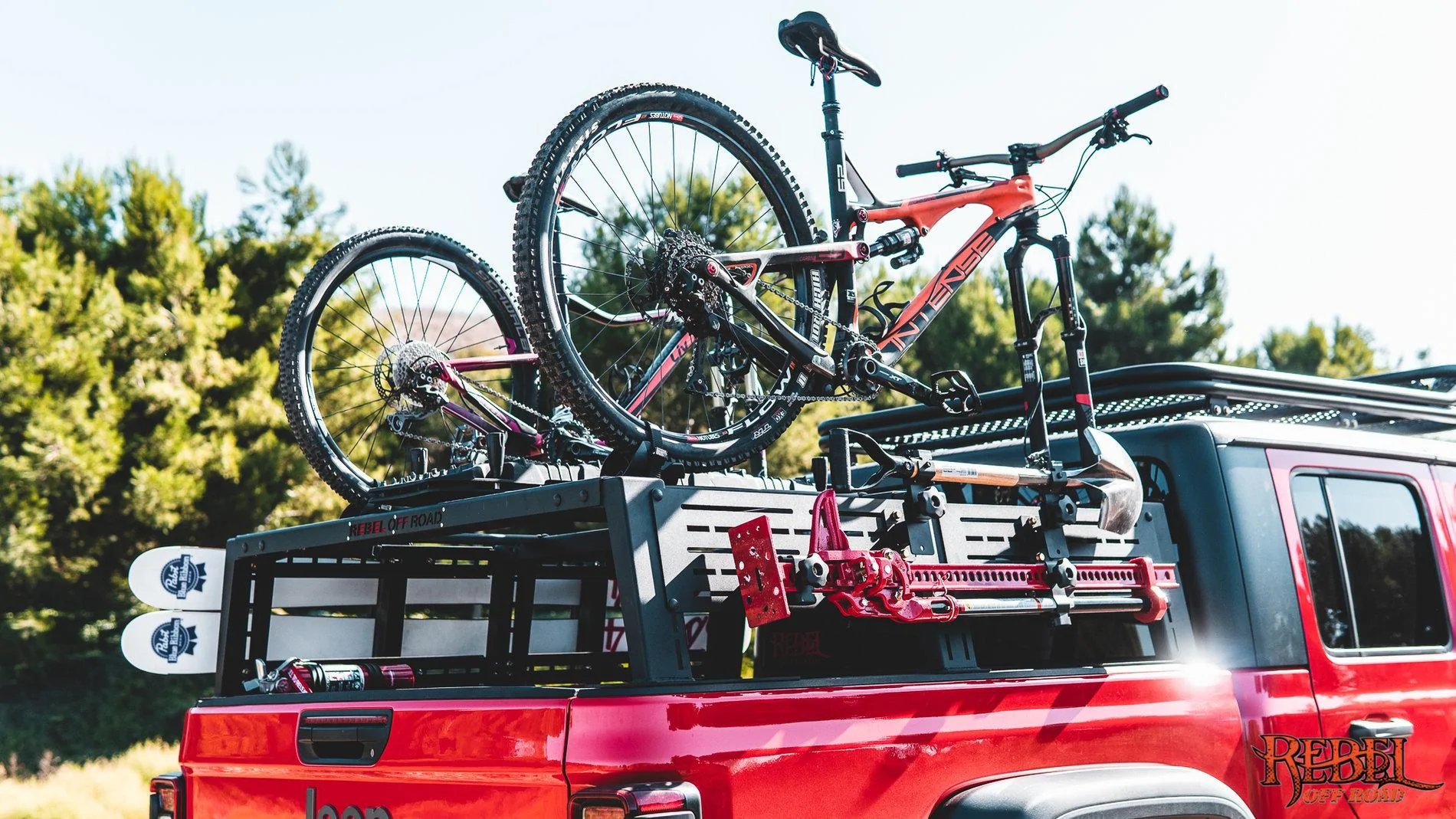

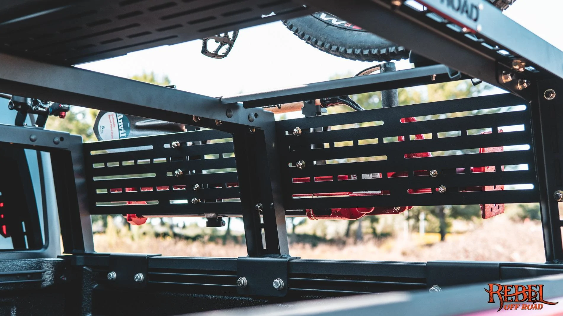

Some additional photos of our Half Rack.

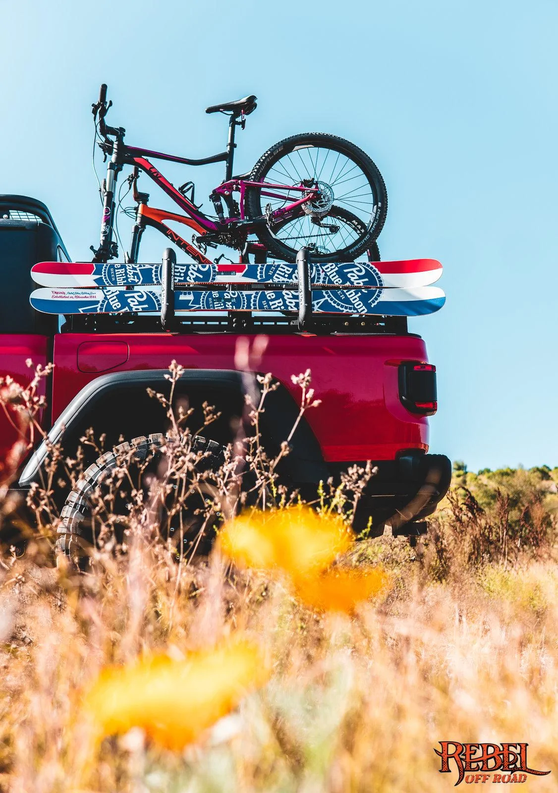

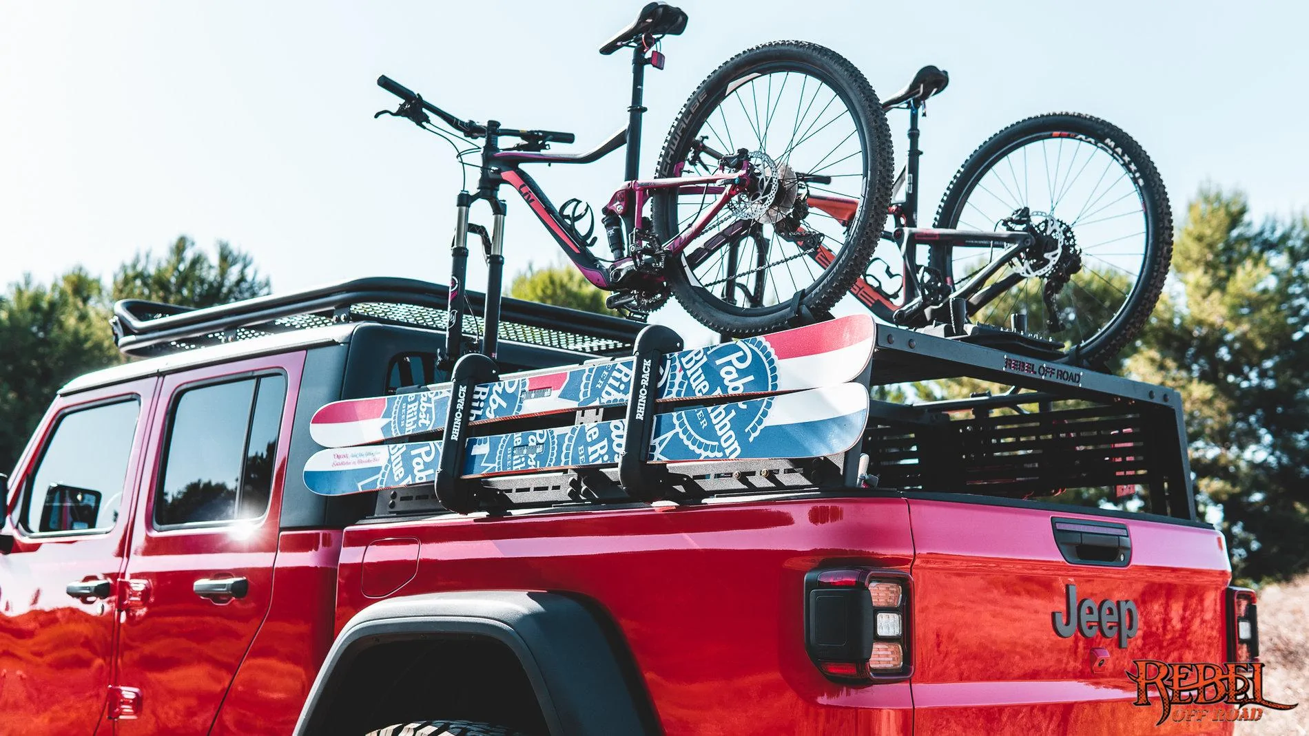

Had another question: I am looking to use my bed rack for skis and snowboards, as well as a RTT. For the skid and snowboard, do you think there is enough clearance on the sides to have skis or snowboards back to back on one Rhino Mount?
The stock pictures show skis with no bindings facing out and I was just wondering if you’ve tested it out with skis and snowboards back to back on one mount. I’m really wondering about the snowboards since it might be a tight fit.

Yes it is possible to run the snowboards back to back on the sides. You would just need to purchase a couple of our Standoff Brackets and Small Top Channel Brackets that would push the Rhino Rack mount outward, giving you room to run back to back with room for the bindings.

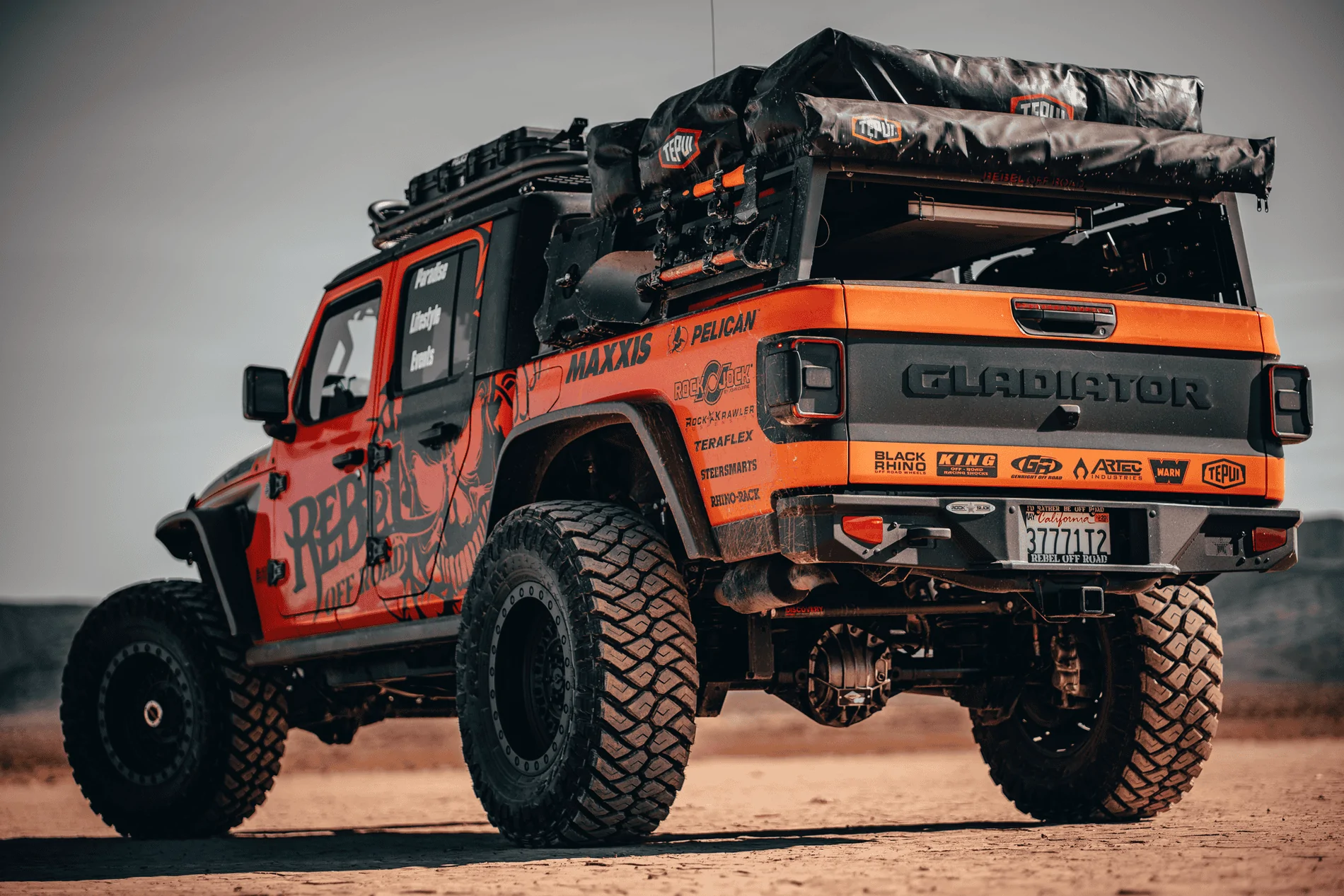

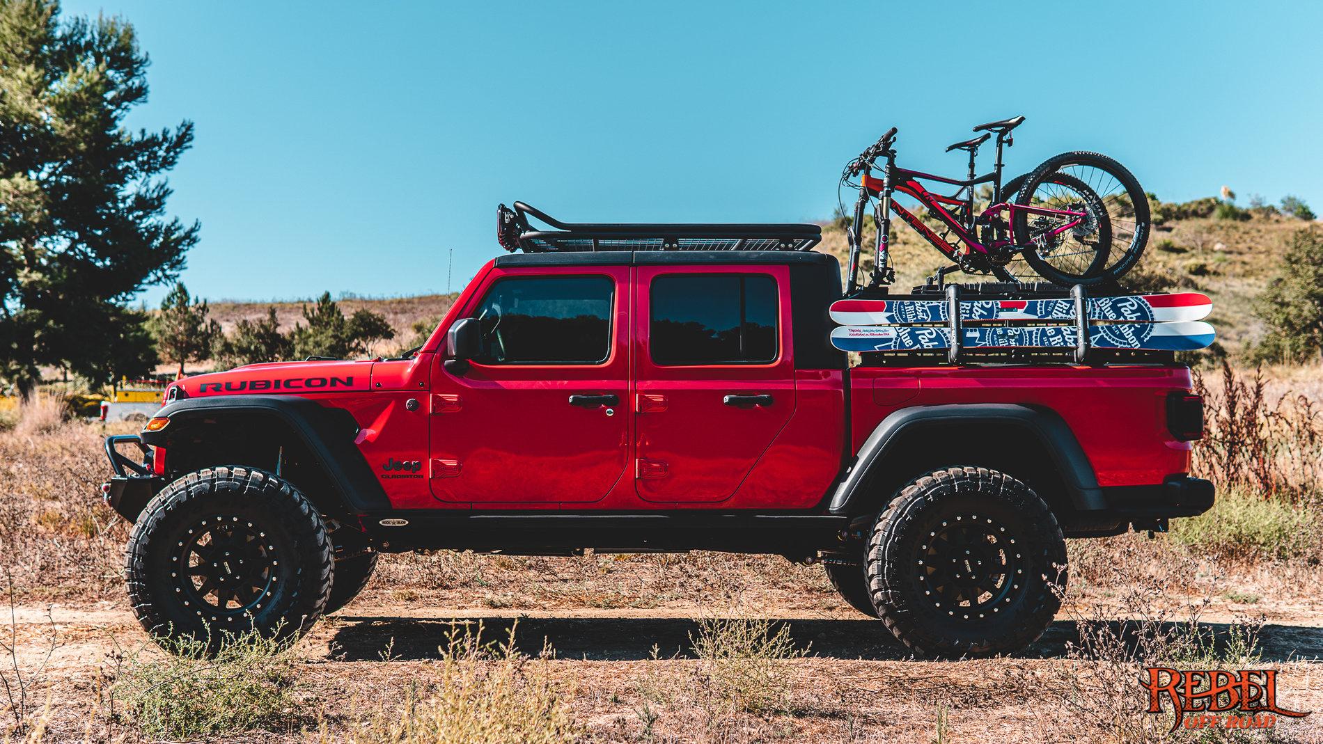

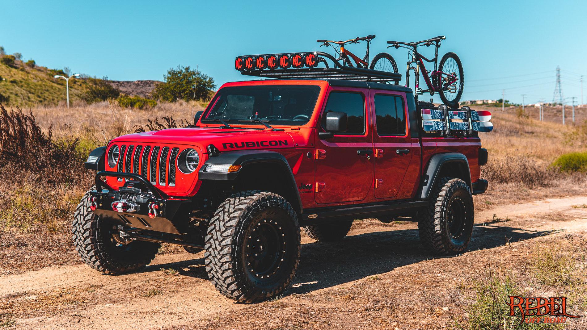

XPLOR Half Rack on our Jeep Gladiator Overland
