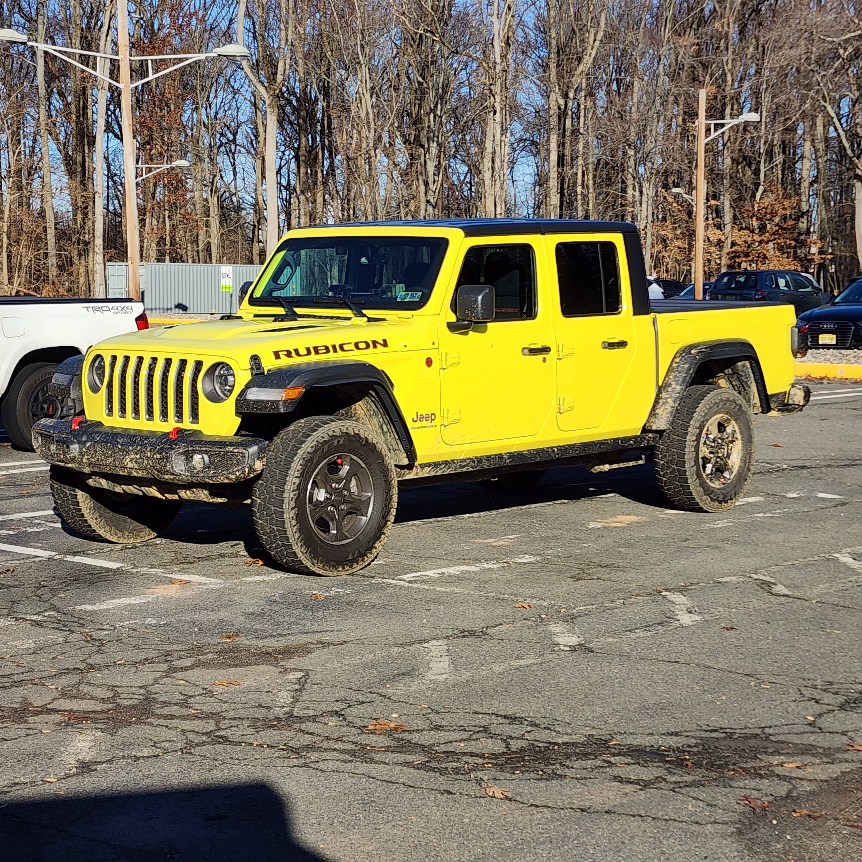

looks great, those plastic rivets are torture to deal with....

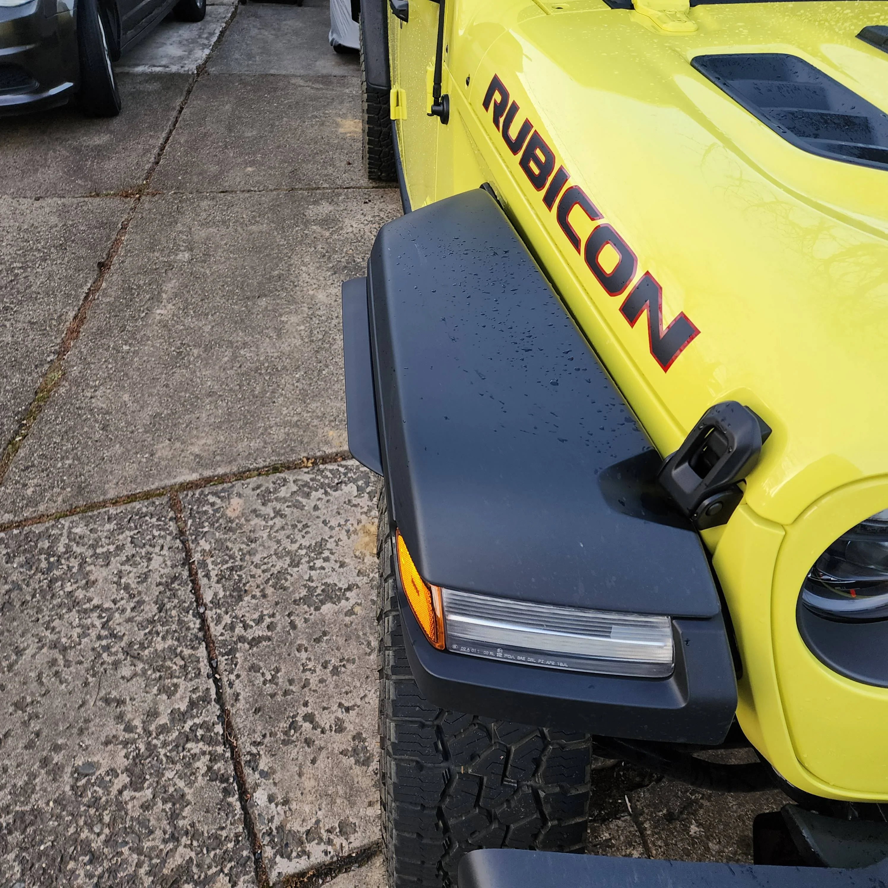

Two things of note.
1. The plastic stretches into white lines, so dont bend it too much while fiddling with the relief cut(s)
2. My toothy/pie cuts sit nicer in the curve than the huge single chunk I took out, lol

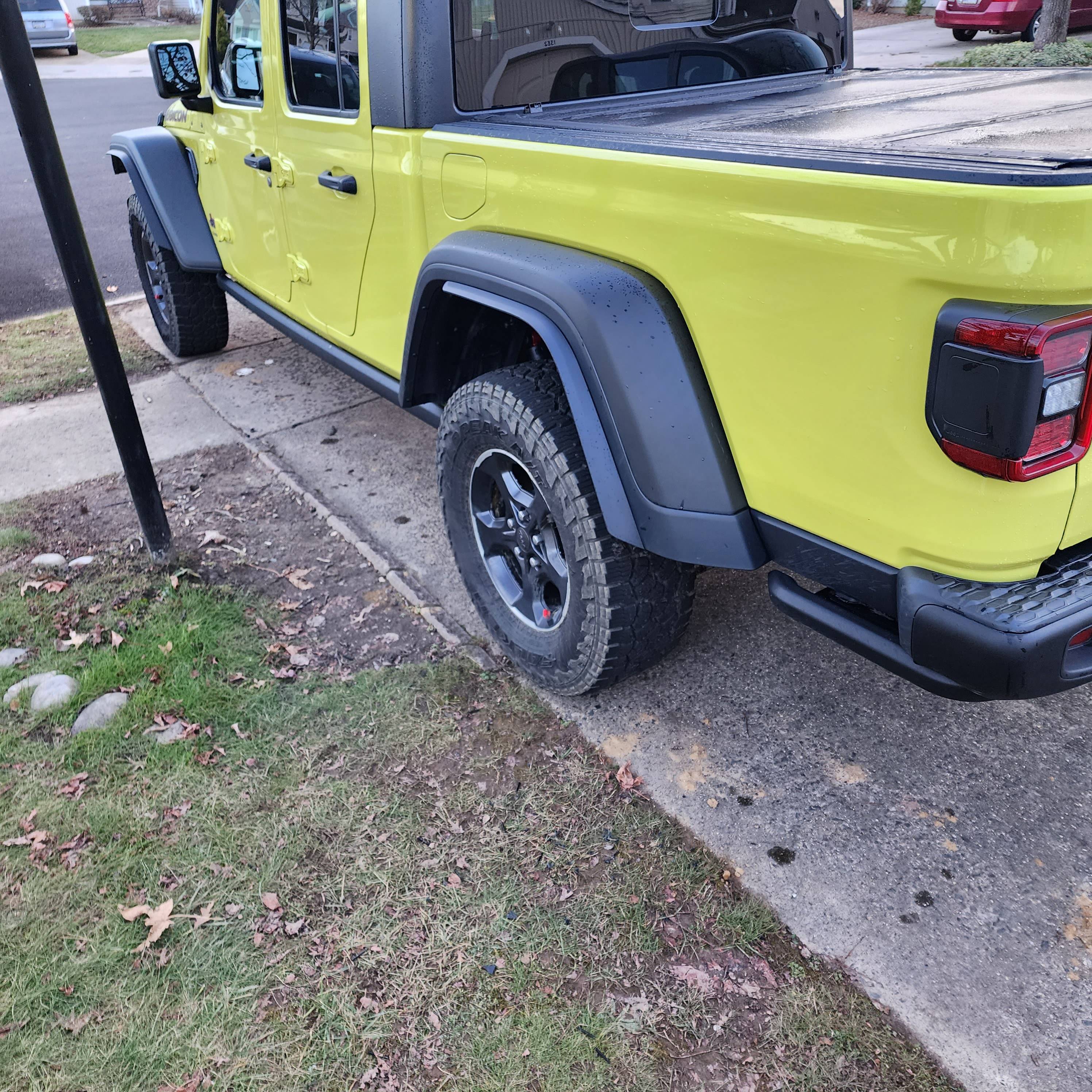

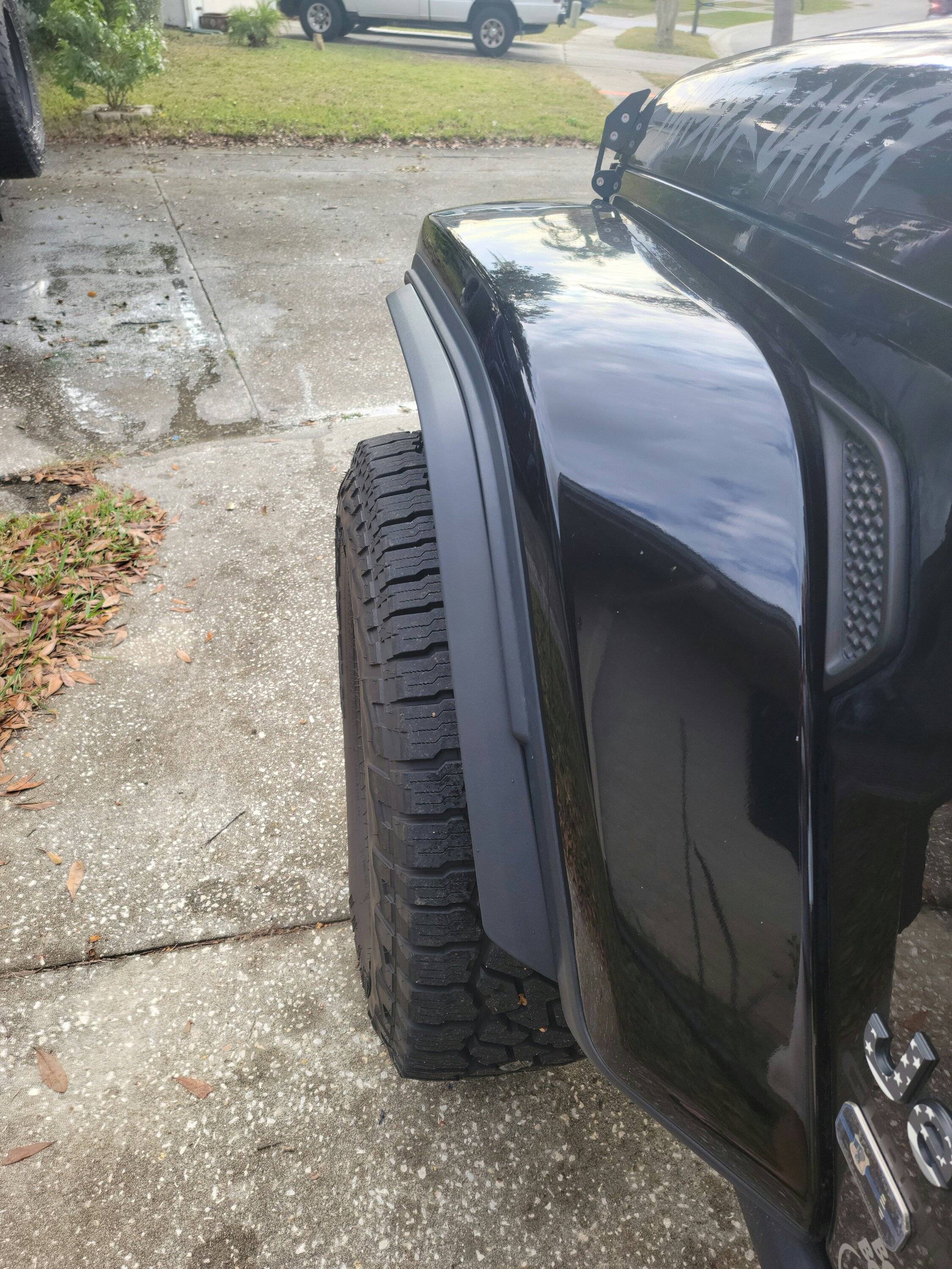

Here they are installed on the front of my Max Tow, waiting for another set of front flares to arrive and will do the back fenders.

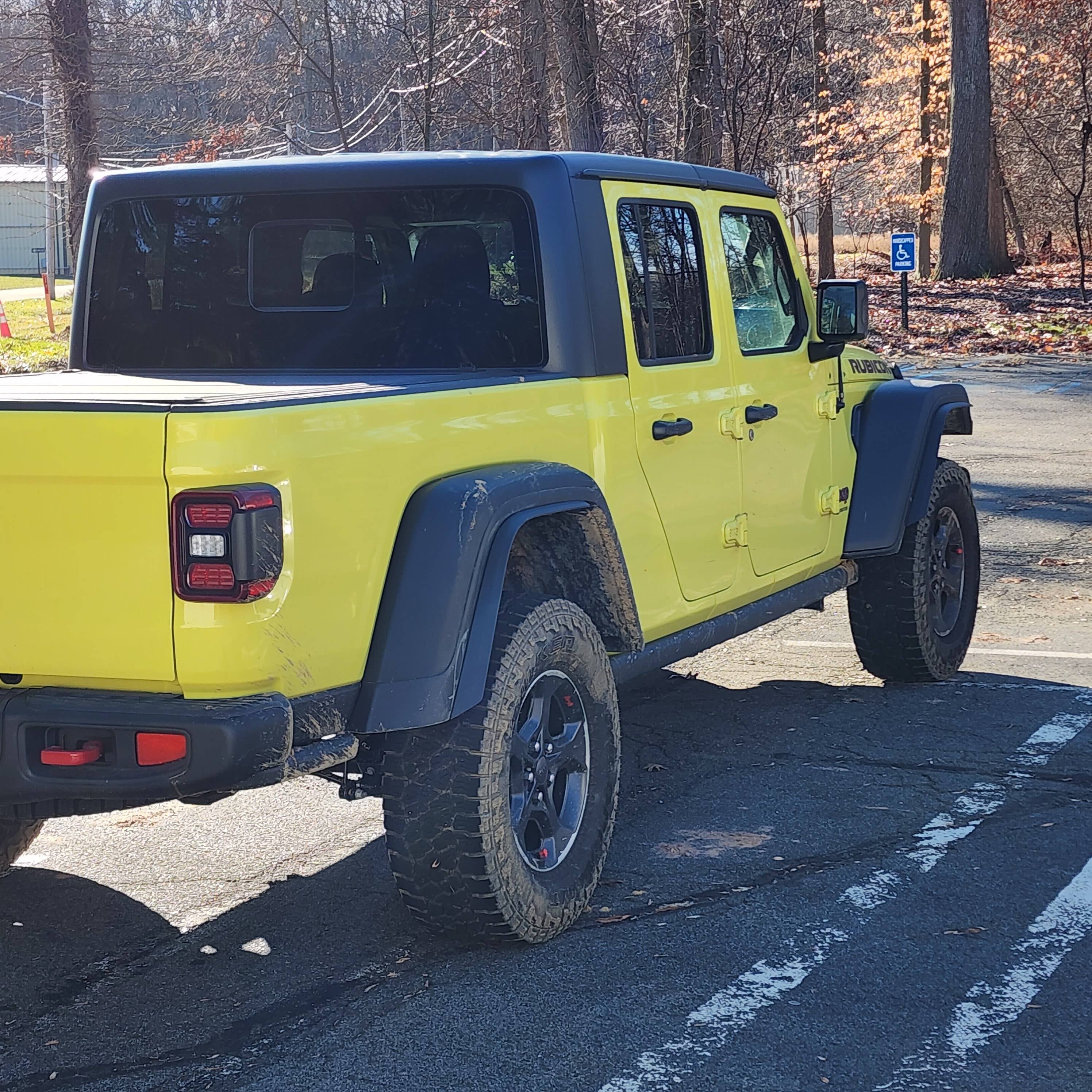

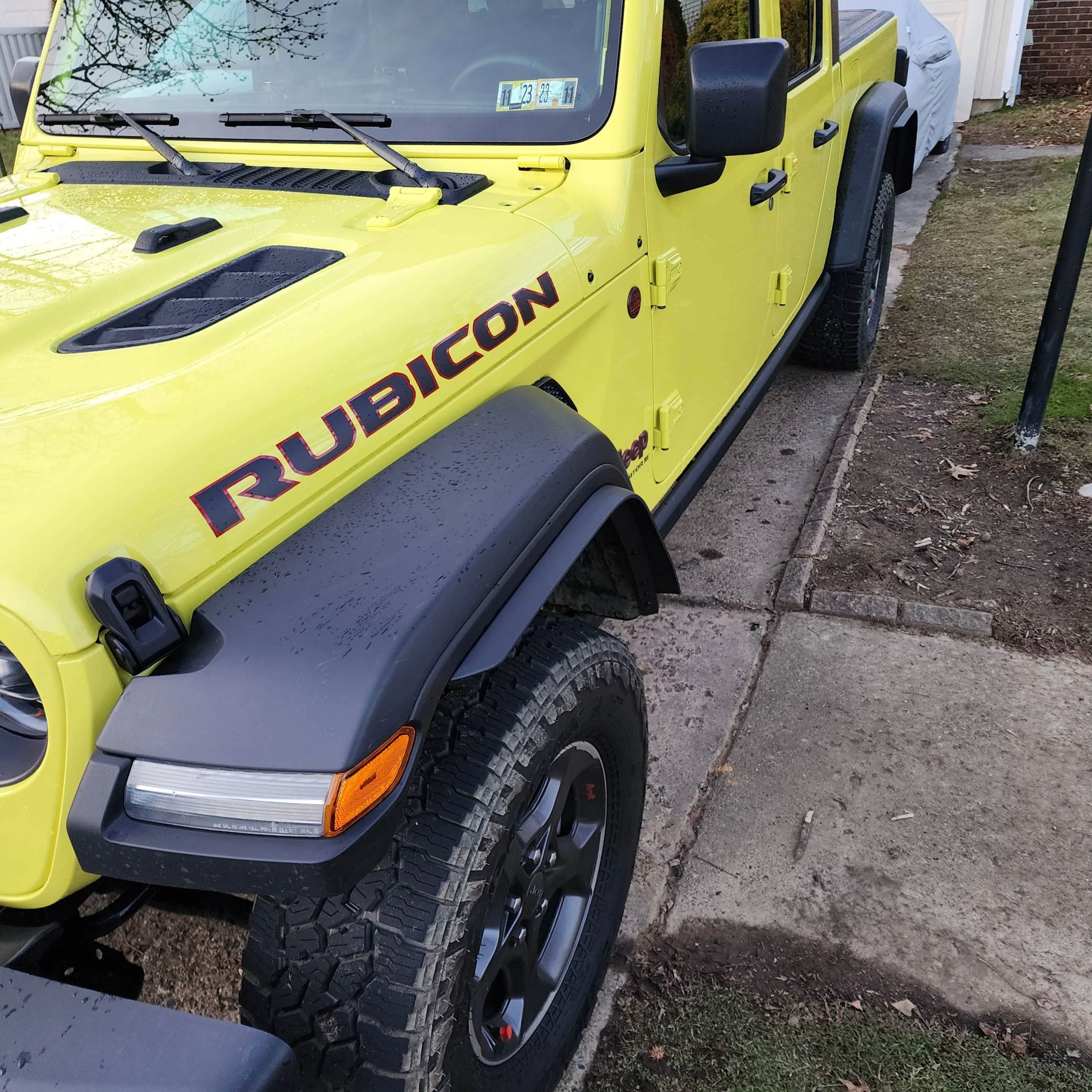

Just overlaying the XR extension, I have a lot of rivets in the existing fender that don't align on the XR flare. Is this the case for all Gladiators? Are people leaving holes open if they don't align on the XR flare?
Can anyone upload a picture of their stock fender rivets w/o XR flares, I want to see if stock Max Tow rivets are different than non-Max Tow rivets.
The front ones should line up with the rivets pretty well... since they're obviously made for the front. Not sure if different on Max Tow fenders....
But if you're using front extensions on the rear (like most of us have done), you'll need to punch new rivet holes. The Amazon kit came with like 500 rivets, so I was pretty liberal...
I'll try to take pics at some point, but fighting a cold and I don't want to go out. Maybe someone else can do it sooner...

Holes for rivets don’t align on front as I’ve seen here or in videos. Looks like stock holes on Max Tow fenders are different.

Just drill new holes. I had the same experience with my overland.
