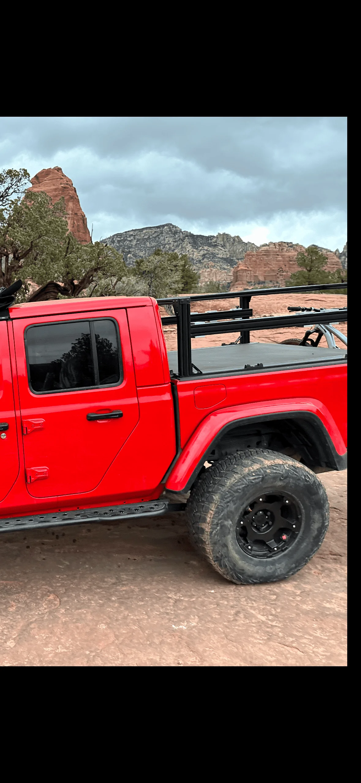

I made a copy with t-nuts that go into my Bak4 tonneau.
Originally tried 23” which was too high.

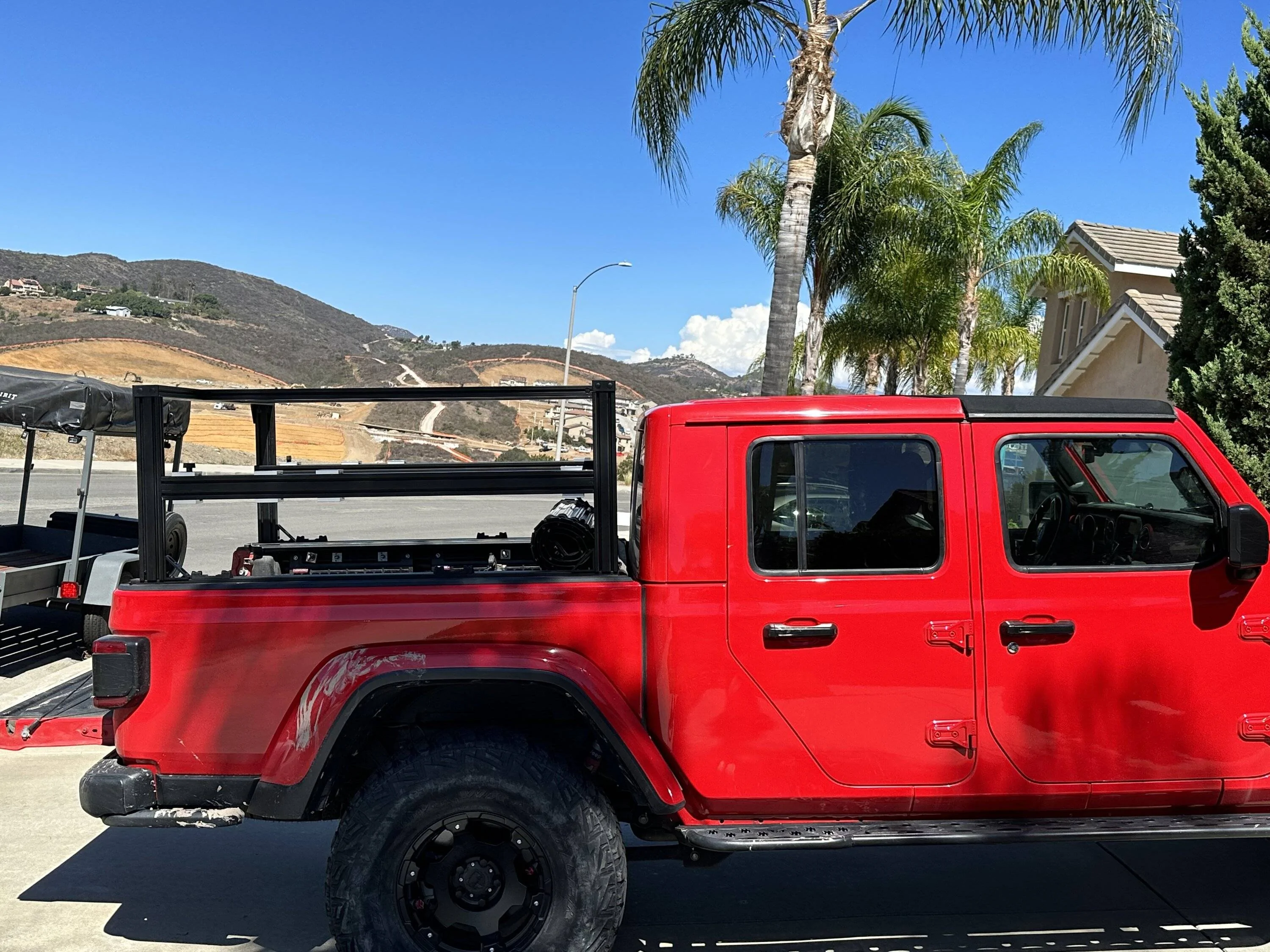

Jeep Gladiator xtrusion overland owners ... what height rack did you get and why? 1675053947174
Replaced with 18.5”
Jeep Gladiator xtrusion overland owners ... what height rack did you get and why? 8A0704A9-76D9-431B-9EBE-C222D7D01EBA
edit: forgot to add, pretty much anything you put on top willl have added height from brackets/mounts.
I will never lay lumber or something flat on the rack so it’s ok if it’s a little below roofline. I don’t plan a RTT so was trying to thInk of cargo.
Or go lower so RTT sits level with roof, like @NC_Gladiator said.
