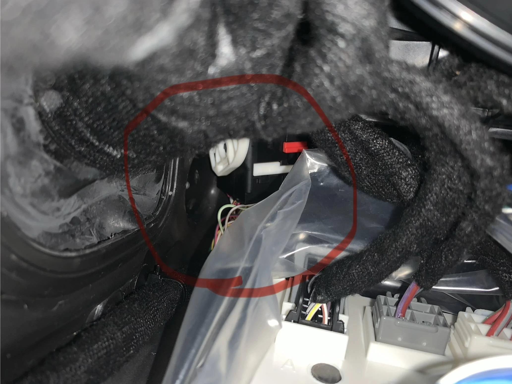

I’ve located the XY401A harness above the BCM in the passenger side. It appears to be located all the way up just below the right dash speaker. Does anybody know a good way to cleanly access this harness? Here are a few pictures to understand where it is in the cabin.

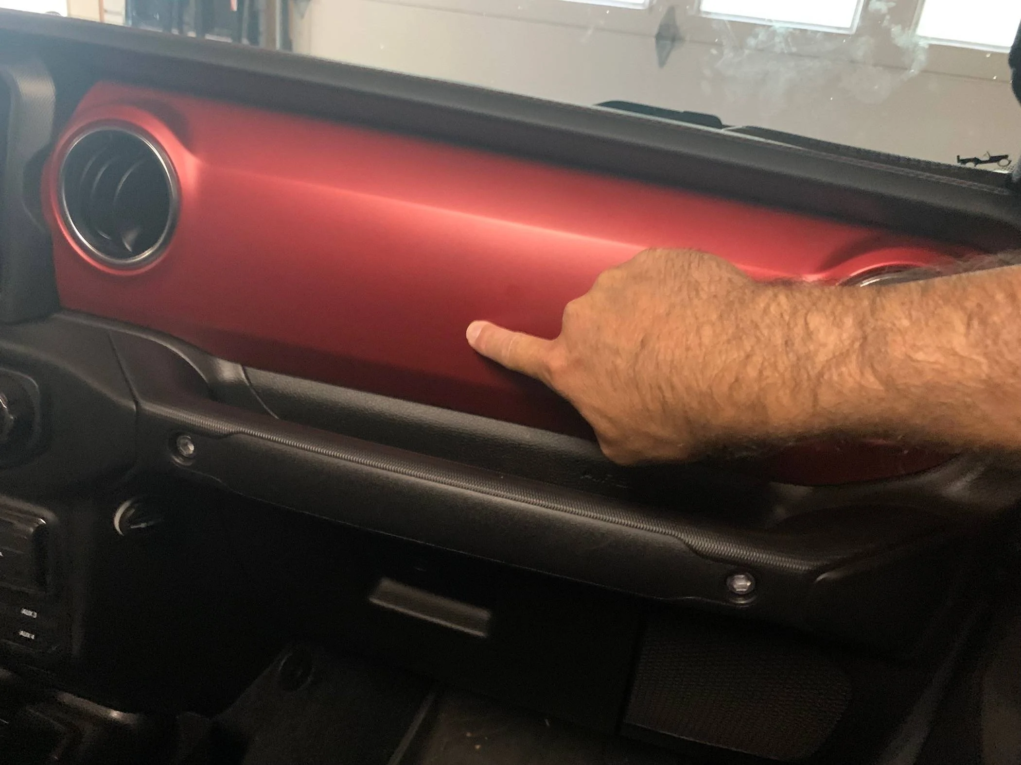

Does anyone have a picture of what it looks like when the red dash is removed in the passenger side above the glove compartment?

Yeah, I saw that one a while ago but they dont have a good still shot of of behind the airbag. Just wondering if that is the way to access the Xy401A. I prefer not to go that route if it doesnt make it possible to get to it. I removed the front top dash speaker and it appears there is a conditioned air tube blocking that route to the harness. Crazy is you can actually see the xy401A in the corner if you look through glove box to the farthest right corner. There is just no way to get a hand in there.
