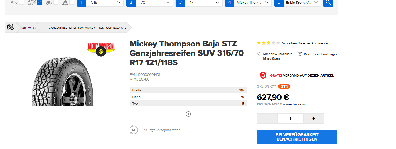

Or… you can pick up some Mickey Thompson Baja boss at’s that are close to a mud terrain but it is 3peak weather rated… just a thought.
If they were a tire that was widely sold here, maybe...
They are not sold in Germany, except by a few specialty importers. Wheels still go through accreditation here... which I doubt they have at the quantity they are being sold.
I have the Falken, why waste them
also:
Jeep Gladiator Yes, sigh, another tire thread. Help us choose! JT Rubicon Falken for Summer, Geolandar AT for winter, but... 1651676231408
That is per wheel sir...
Also still the same problem, on 34/35s not legal on stock rim.
Wasting a set of good tires and rims.
