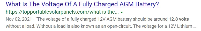

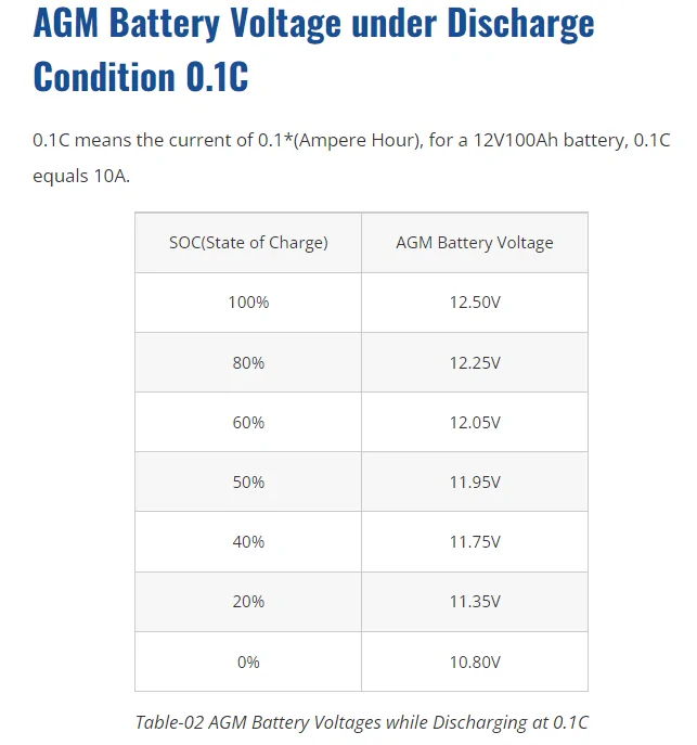

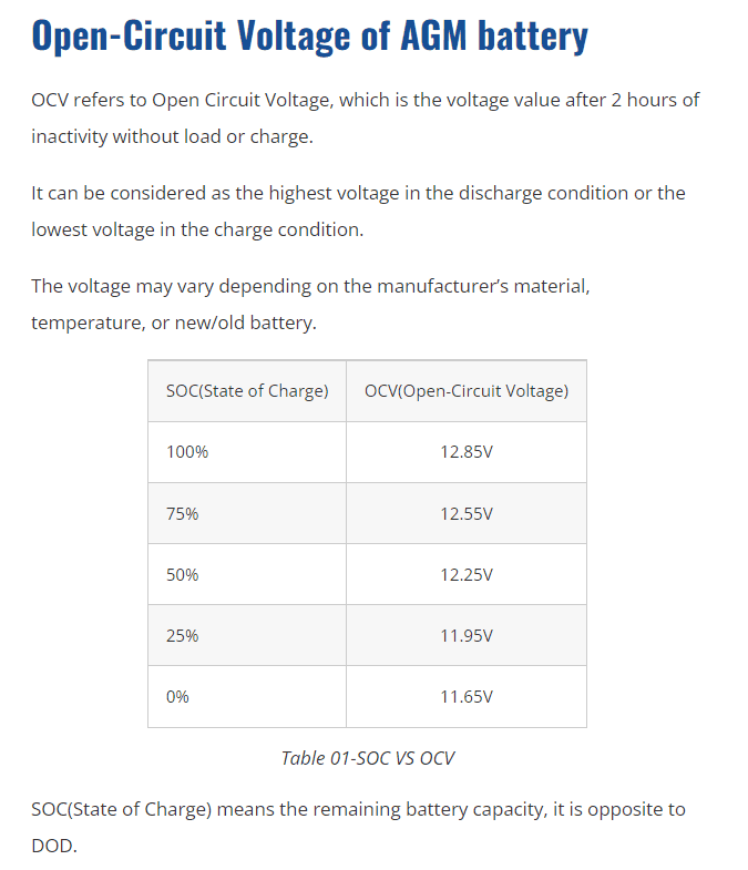

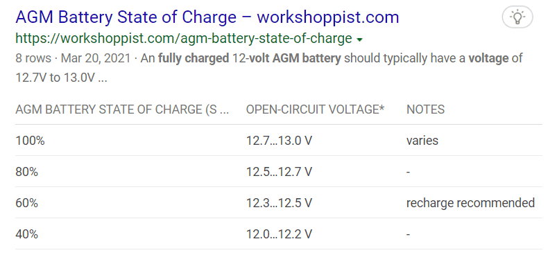

Which I find interesting as if these were any other batteries or vehicles, I'd be trying to figure out why the batteries never fully charge with the system voltage running over 14 volts while running. Mine runs 14.5 and higher much of the time, that's well into the rage to fully top off an AGM battery.
And while it cranks and works fine even when it's 0 outside, 12.3 is not a fully charged battery.
When searching using Bing or Google and looking for things like "what is the voltage of a fully charged AGM battery" you always get 12.6 or better and even thought SoC charts don't agree on exact numbers, they all agree - 12.4 or less is only partially charged, the best chart saying 75% while the worst saying 60% charged at 12.3 volts.
So, automotive EEs here - what's up with this? I can go to my cars any time and find the batteries even after sitting 2 to 4 weeks have a charge of over 12.5 volts and those start out at 12.6 while a full AGM starts out higher.
In short - why aren't Jeep vehicles fully charging AGM batteries, or, are all of the battery companies - those that MAKE and sell AGM batteries, full of bunk when they say that 12.4 isn't fully charged?
Someone is not telling the truth.
In any case, my ESS only works when the truck is driven for hours, or I charge the batteries overnight, otherwise, the batteries sit at 12.3 volts or LESS and the ESS doesn't work with a battery charging message.
