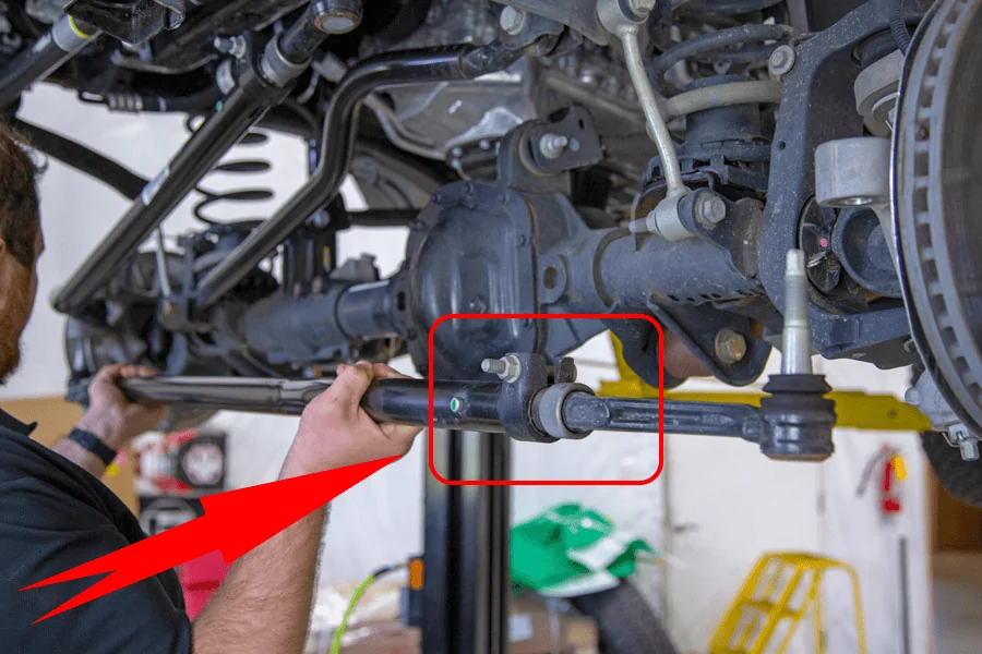

So, I measured my toe in as explained here. Took avg of 3 measurements from same spots front and rear of front tires. My toe measurement is even I basically have no toe in. How do I adjust for toe in?
on the tie rod you will loosen that clamp thats sticking up and then rotate the knurled piece till you have the measurement you need. It'll be easier to rotate with tires in the air but do your final check with weight on the tires.
