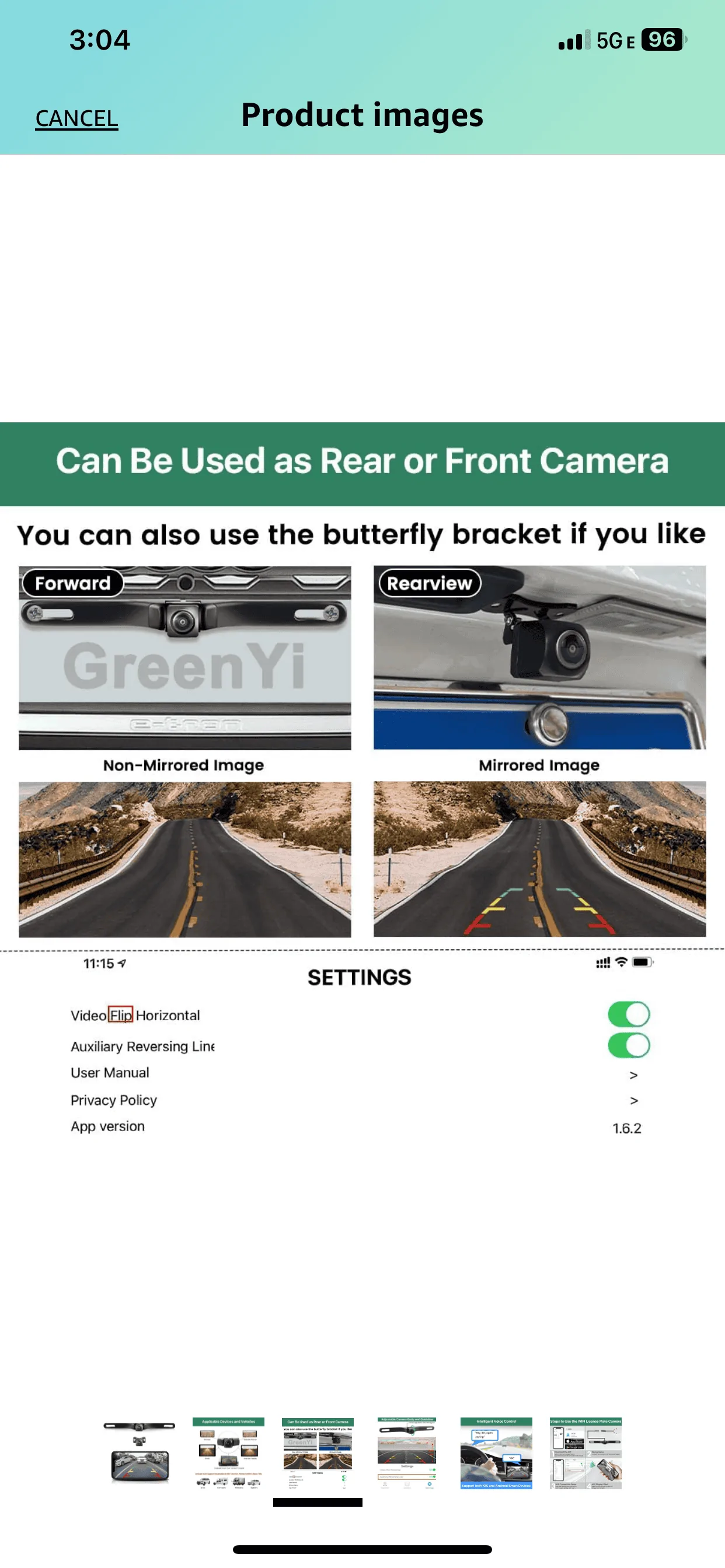

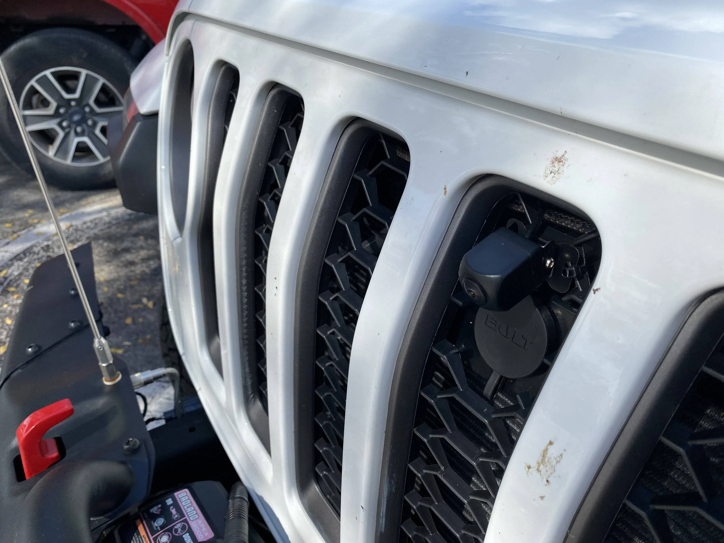

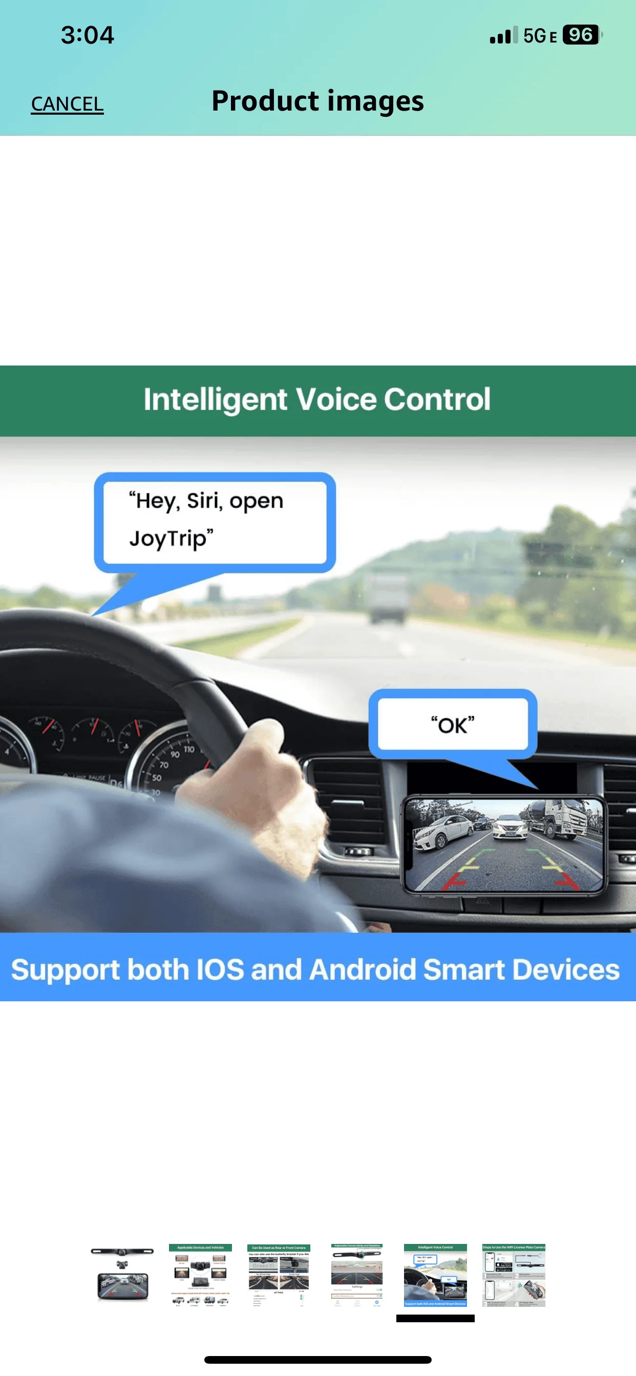

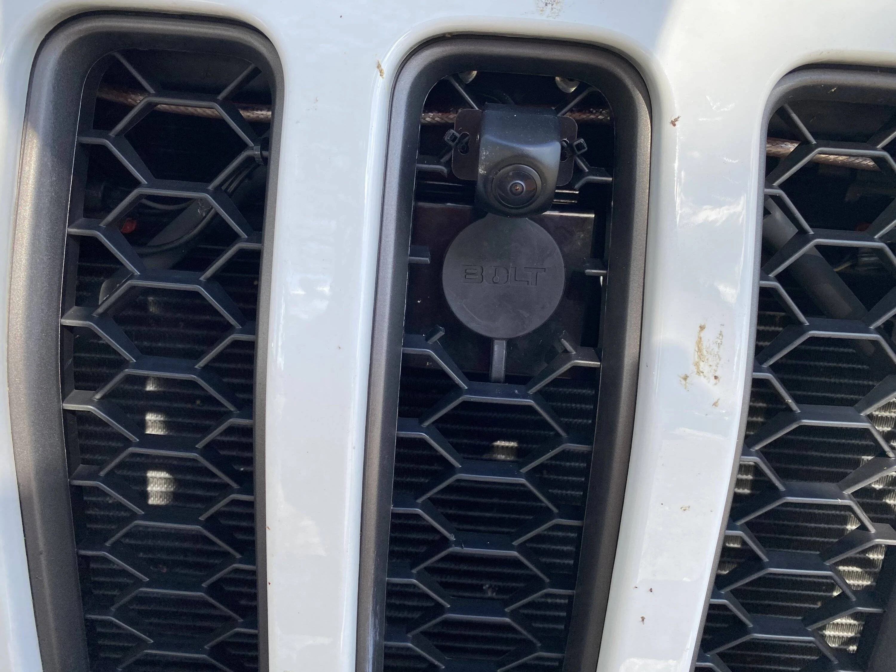

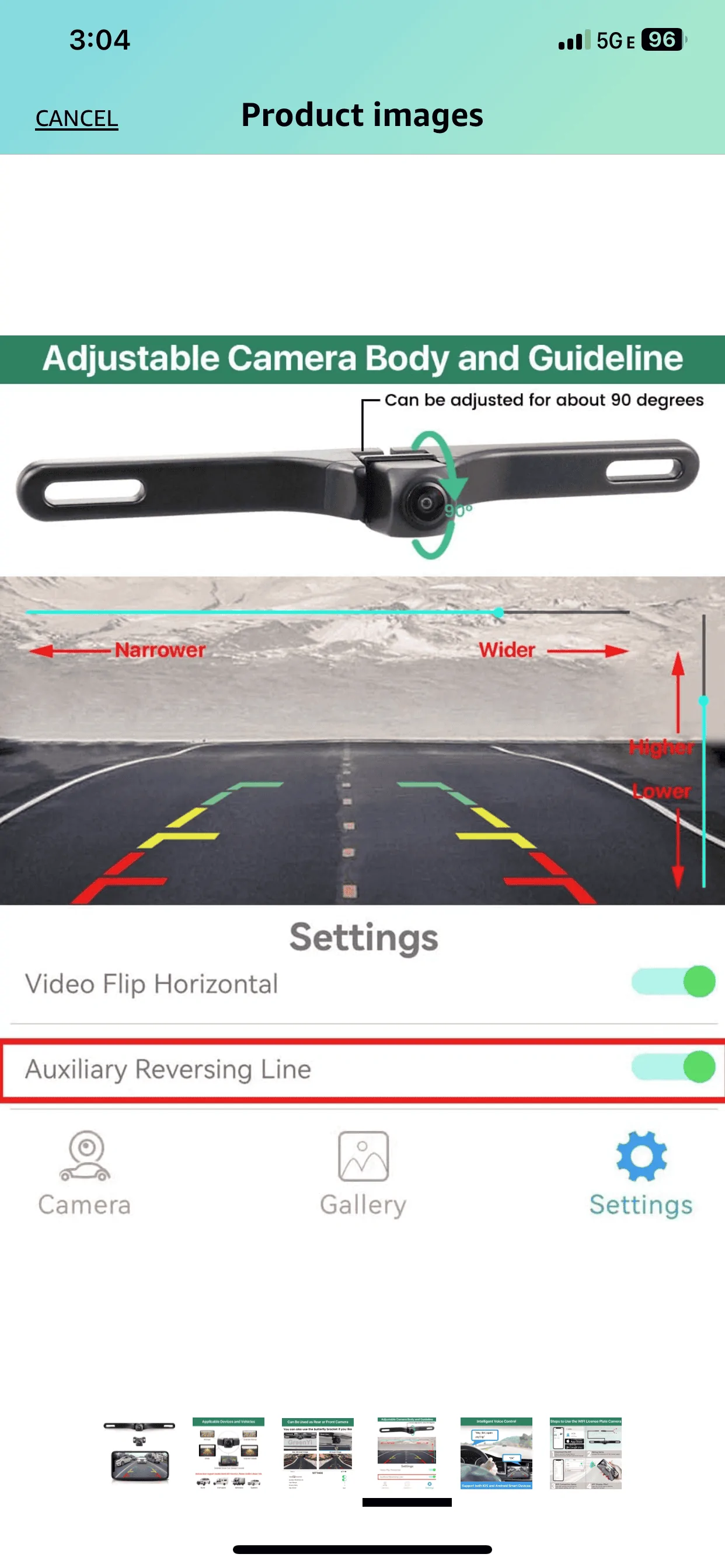

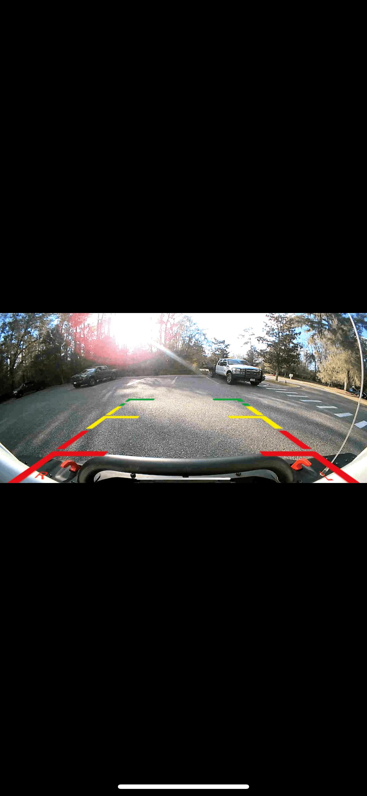

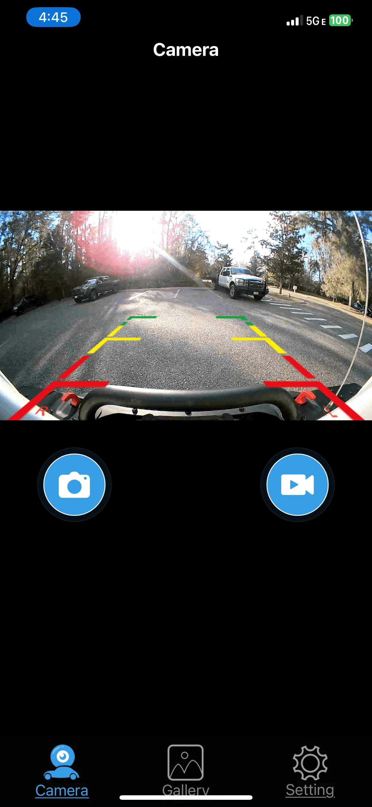

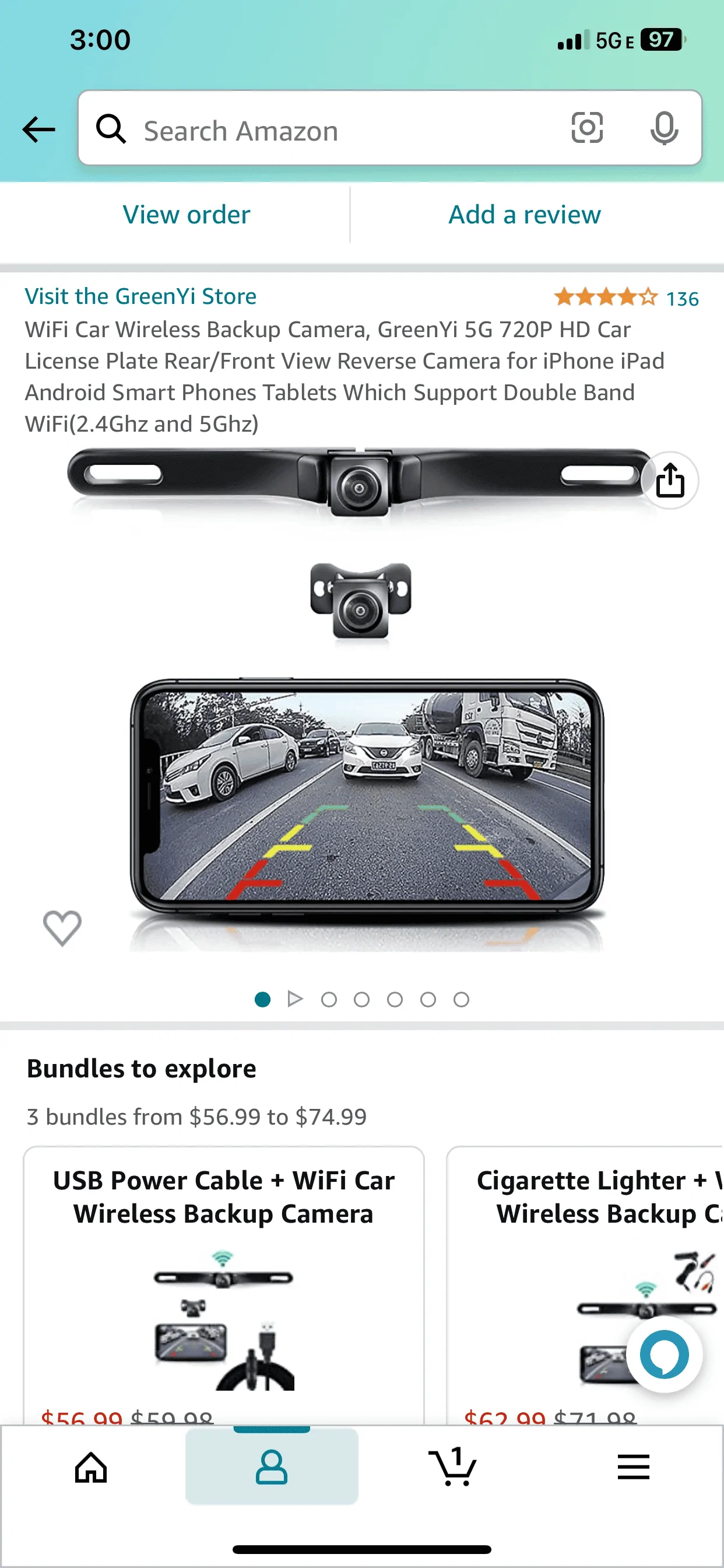

I posted this in the what did you do TO your…
Not sure why anyone would go through the headache and expense of retrofitting a hard wired front camera after this

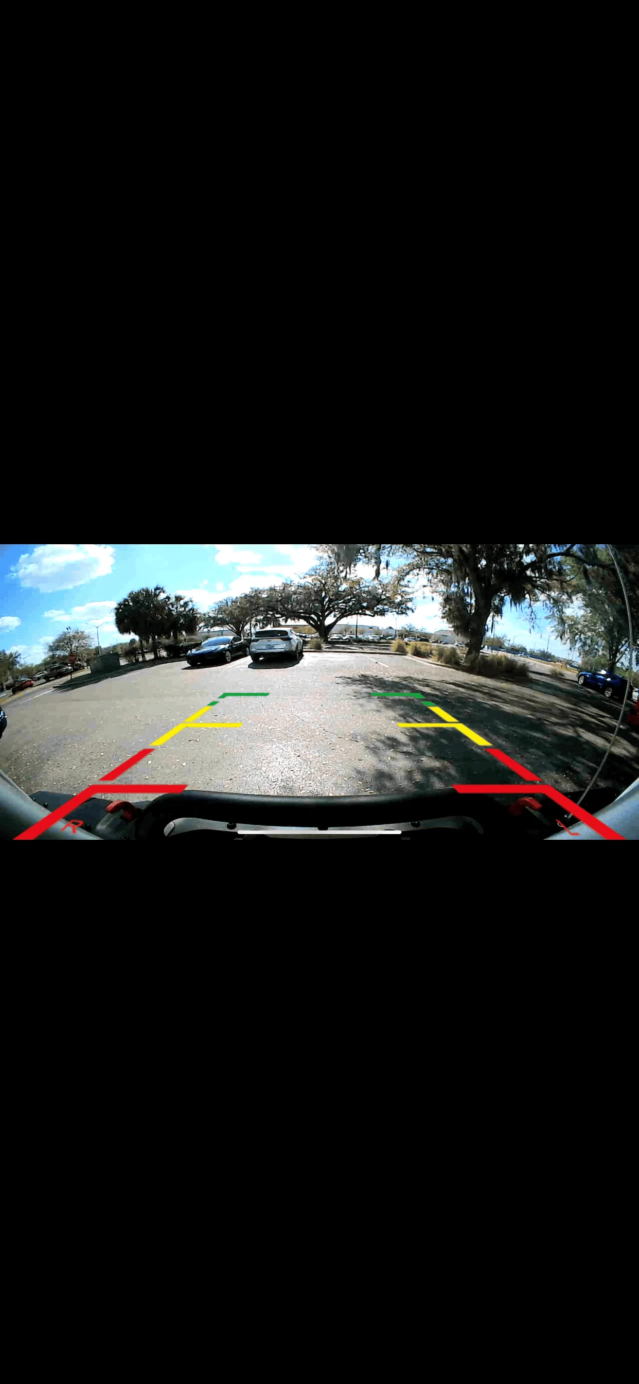

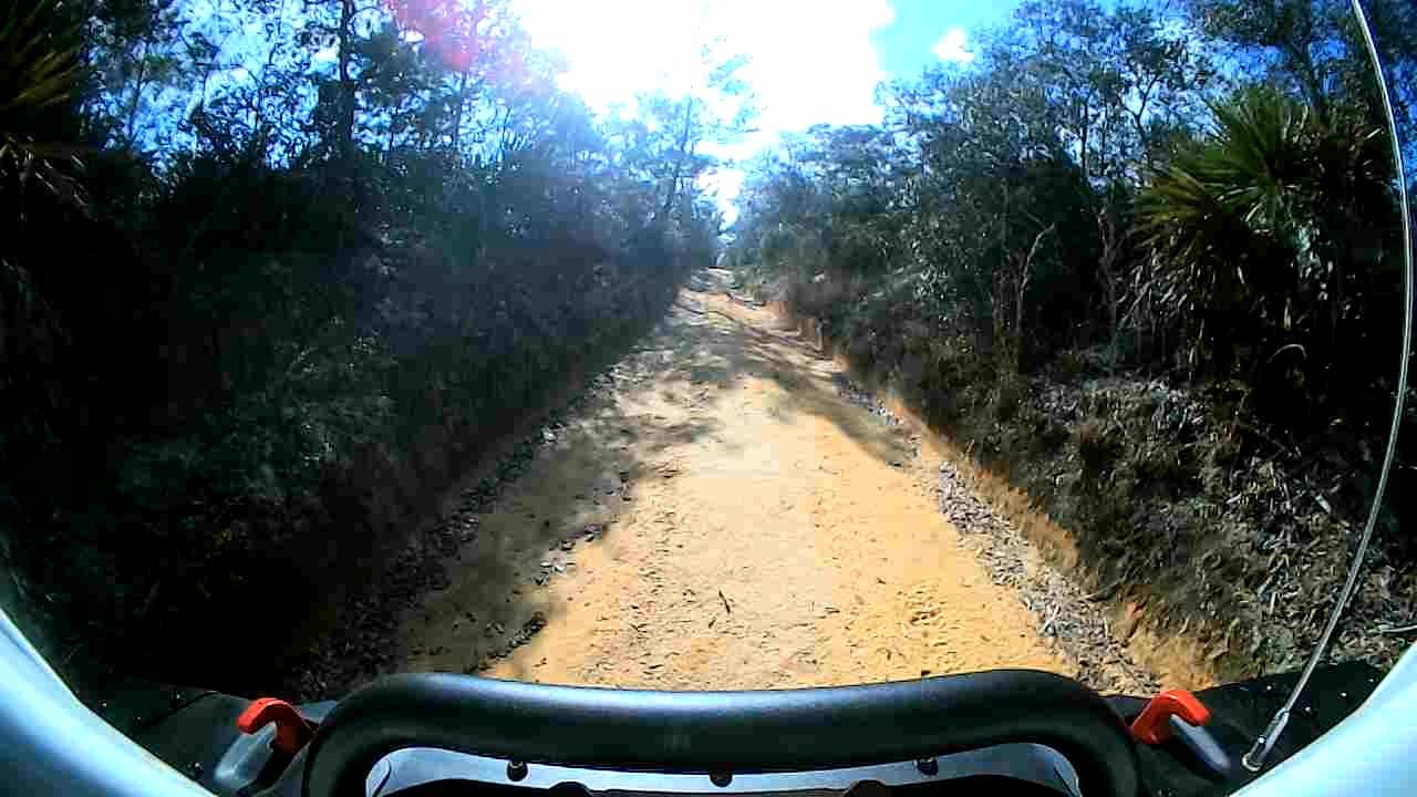

I purchased a GreenYi 5G wireless Wi-Fi camera from Amazon. Install took about an hour and could have taken much less, but I tend do chase squirrels…lol. At some point I may correct the angle a bit due to a touch of OCD, but it’s damn close. So, I was out < $60 and have a camera with fully adjustable guidelines…through wireless technology…less a power and ground wire. The ground is run to one of the numerous fender ground posts and the power is ran to the cigar lighter switched power fuse in the fuse box.
The last 2 photos where from a horizontal screen, which were too large of files to upload so I screen shorted them in portrait mode.
After I save my penny’s, get and install a Bulletpoint dash mount I’ll mount an iPad mini so I can run multiple tracking maps at the same time.

I’ve had one in the grill for over a year. Camera always works. Might install it lower if doing it again. YMMV
I thought about mounting it to my winch protecting hoop, but the small area above my Bolt hood lock was calling me. It’s more protected. It worked well. Worse case scenario. If the camera module failed…$58 and no major re-wiring.

Cool Bean’s. Under the winch would be the ideal position.

I thought about that but there's too much water here in FL, GA, AL and TN. Up a little higher protects it.

Stupid question, but do you need data signal in order to use wifi on your phone/tablet? Meaning, would it work if you were out in the desert with no phone reception?
Do you find the guidelines are accurate to your tire line?
I'm unable to order with trailcam as it's unavailable at this time, which is really disappointing considering it's the only option with guidelines that follow steering. As such, I'm interested in easy aftermarket options, so thanks for the mention.
Not a stupid question at all. When you open your phone WiFi connections you will find the camera link there. When it’s powered up it transmits a signal. Make sure your phone is connected to the camera’s link and open the JoyTrip app. Done.
The guidelines are adjustable from within the app. You can adjust the width and length.

So with the phones wifi and the JoyTrip app connected are you using any data from the phones carrier or is it just a way of connecting the two? Do you have to have a hotspot with your phone?
My hot spot on the phone isn't on. I just connect to the WIFI from the camera. I think it's the same as if you logged onto your home network. You click on "MyHome" or what ever your network is...and the image taken by your camera shows up on the app. You can save an image or video on your phone. You can make the tire lines disappear etc.
Hell, if you're running with some other Jeepers, and they have the app, they can log on to your camera if in range and see what you're going over.
