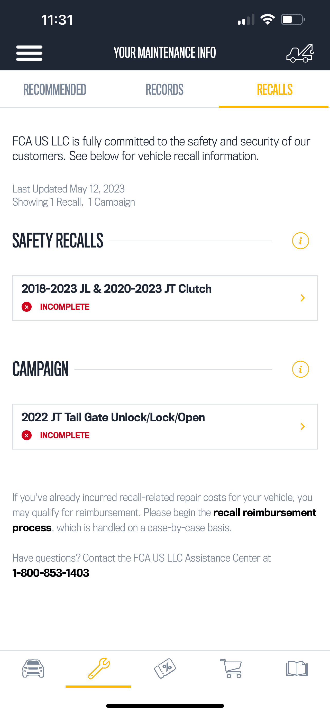

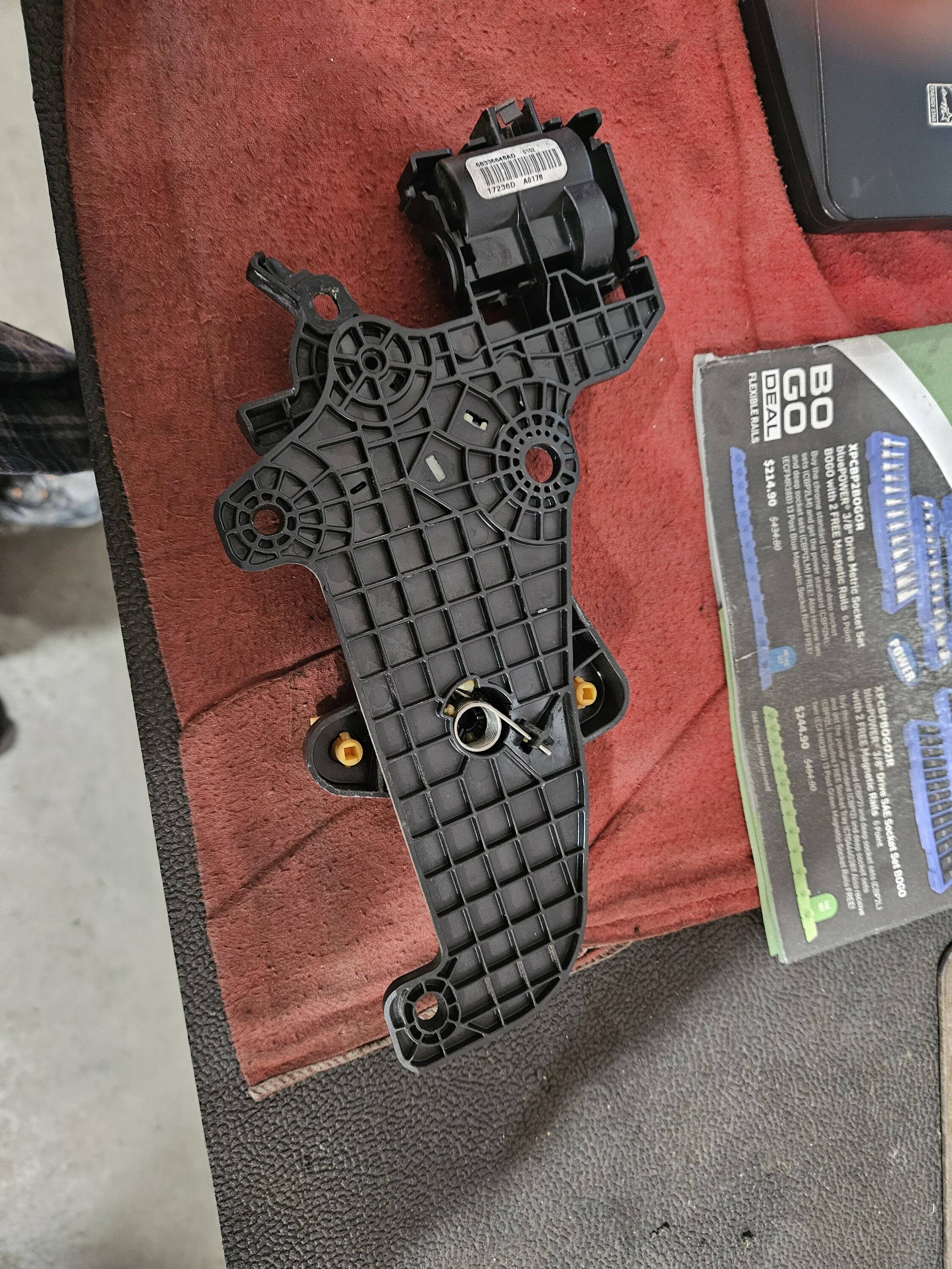

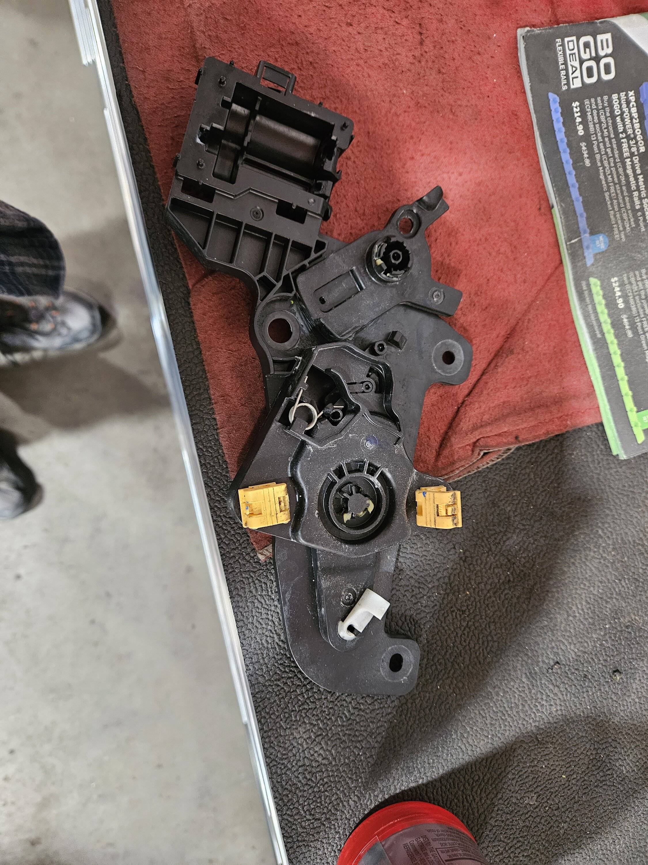

I got a notice for the ZE2 recall on the Jeep last week, and got a letter this past week on the recall. I made an appointment for this morning when I got the notice on the app. It takes about 45 minutes to do the recall. They replace the Tailgate Controller in the tail gate. This is for the power locking tail gates. Talking to the tech who did it. He say that the controller over cycles and gets jammed. The difference between the 2 is unknown.
The old controller.

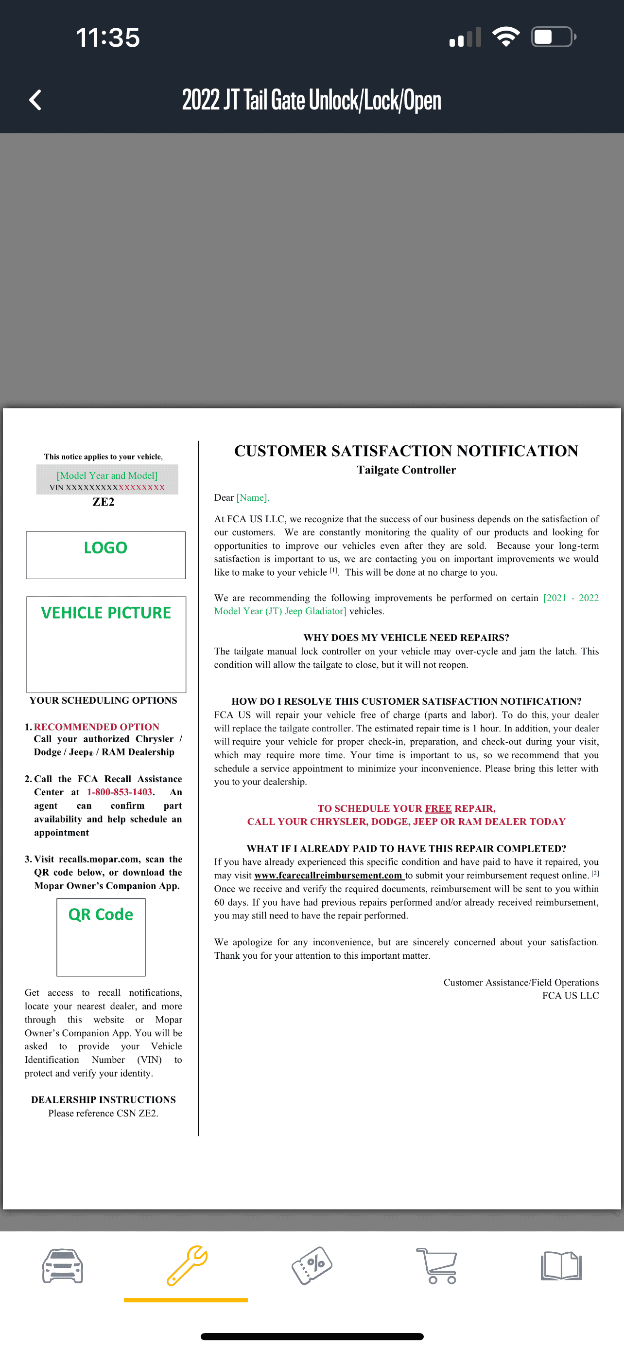

I got this letter also. It says “on certain 2022 Jeep Gladiator vehicles.” It also shows up in the My Mopar app. Looks like just 2022 model years, but it doesn’t specify any other details. I would assume this applies to any 2022 Gladiators with power locks.
Jeep Gladiator ZE2 Tail Gate Latch Recall IMG_1981
Edit: when I clicked on the attachment, the default letter does say 2021-2022 Gladiators.
