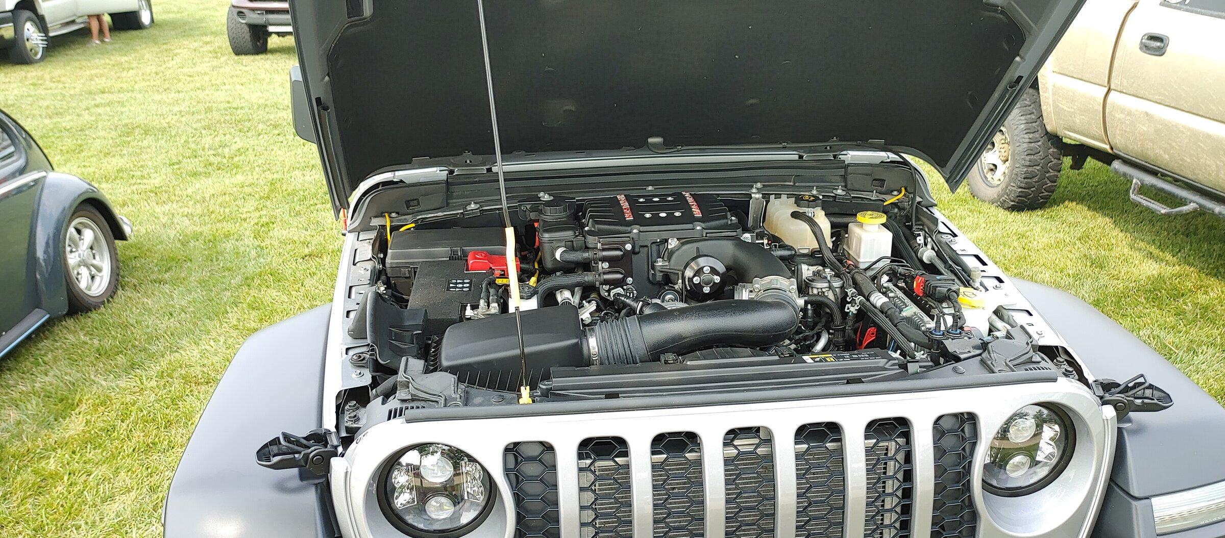

I purchased the Magnuson as I have used their stuff in the past, and figured it would be plug and play. Even told the wife I would not mess with it, promise. After a month of my family looking like bobbleheads, she gave me the ok to mess with it lol. I don't blame Magnuson or Petty, there is just a fair bit to understand when doing this. In hindsight I imagine, they should have put an electric bypass on and then they could leverage the boosted operating system that already exists in the ecm. That would be killer

after reading a few other threads your name gets mentioned a bit cause of your tuning ability. once you had figure out the appropriate tune how much MPG did you lose over stock if you are driving the same way and not mashing on the gas?

I get 14 in the winter, and 16-17 in the summer. I had tunes go as high as 19-21 but the power was abysmal. I run 10-11 psi now
