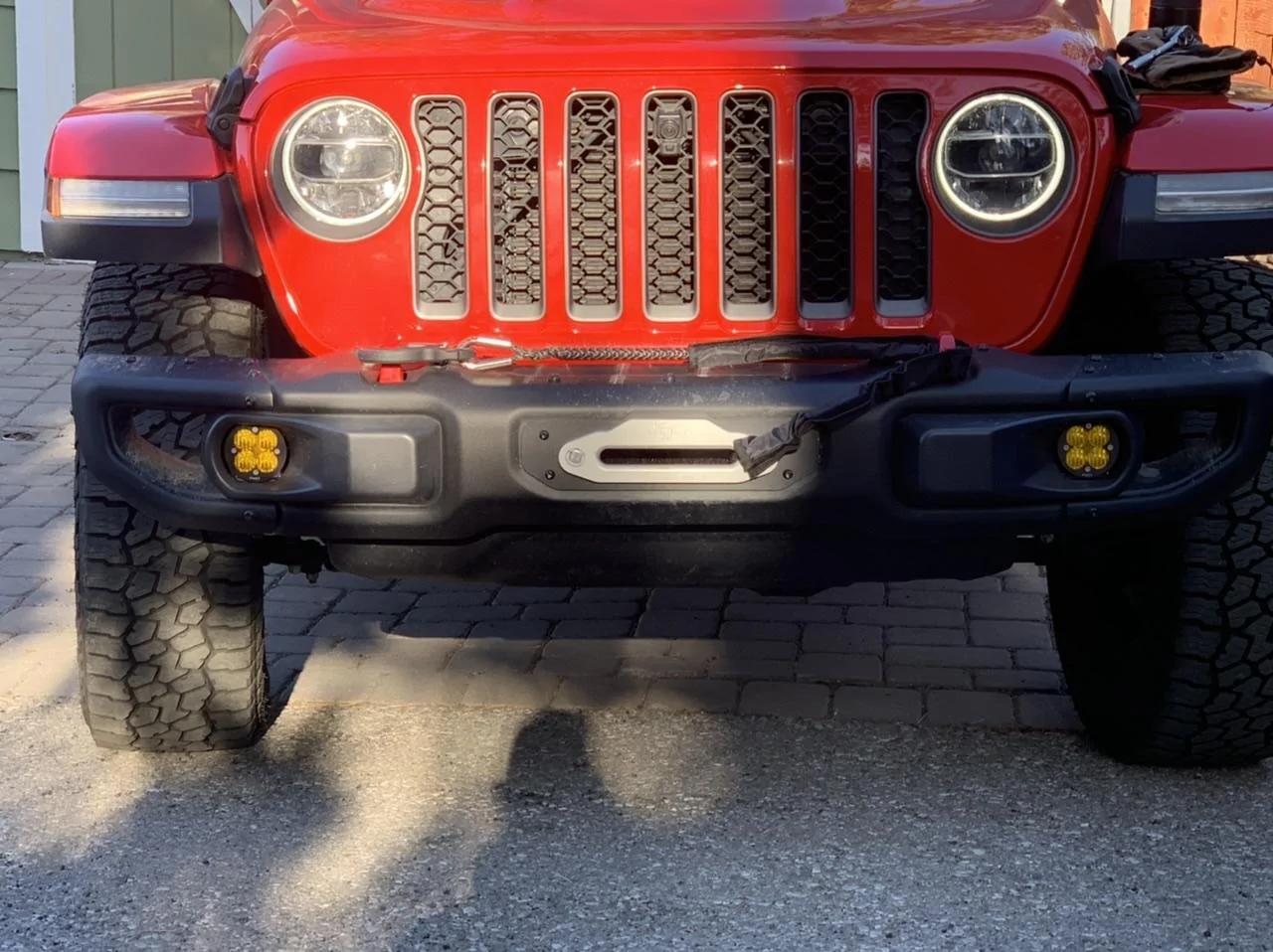

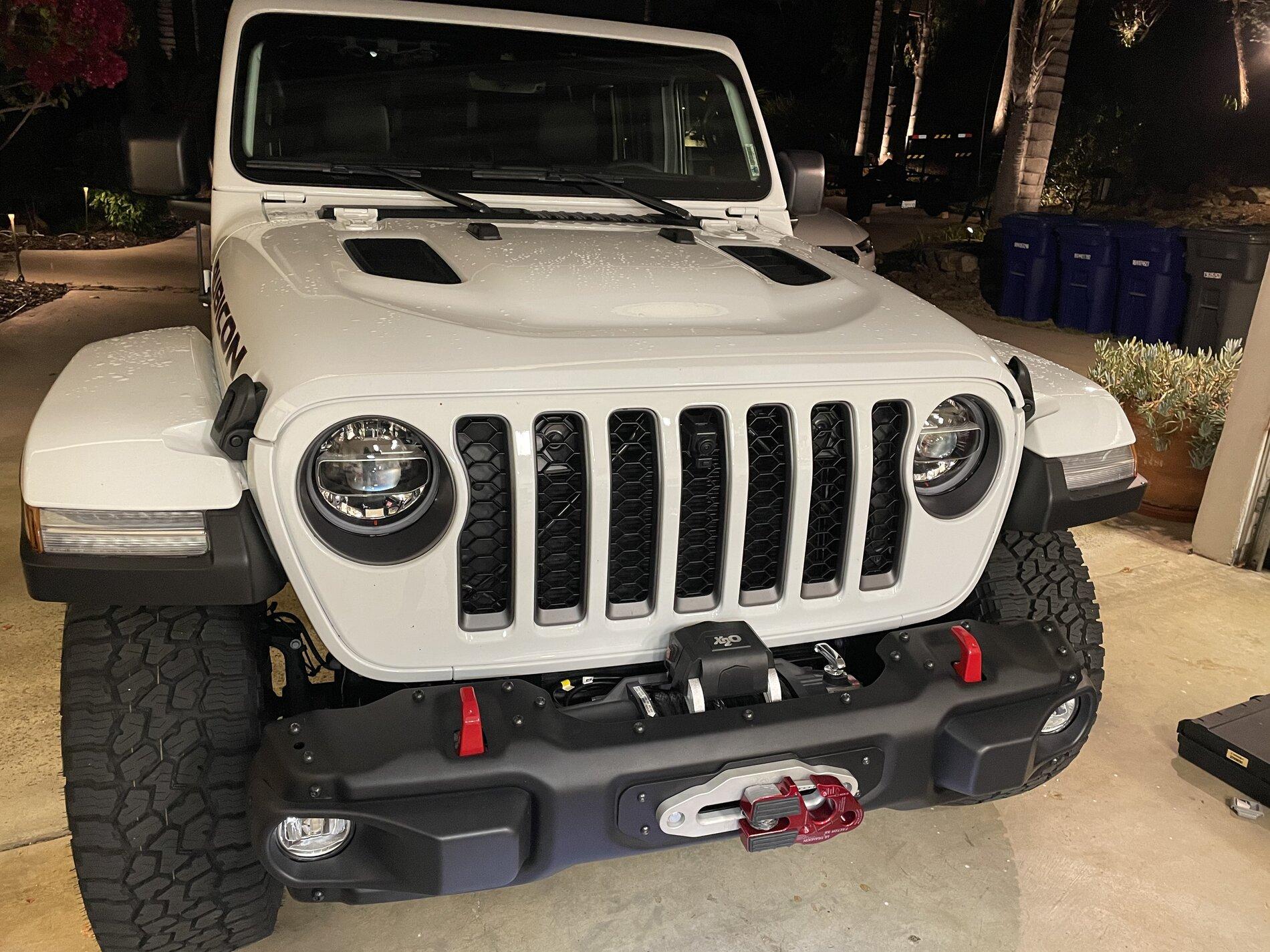

Stealth hidden smittybilt H2O 12k winch install on Maximus-3 winch plate and Rubicon Steel bumper​
Solenoid relocation.​
Jeep Gladiator “Stealth” hidden smittybilt H2O 12k winch install on Maximus-3 winch plate 2DF89A3A-C3E8-4EC5-9027-8CDAECD97D0F

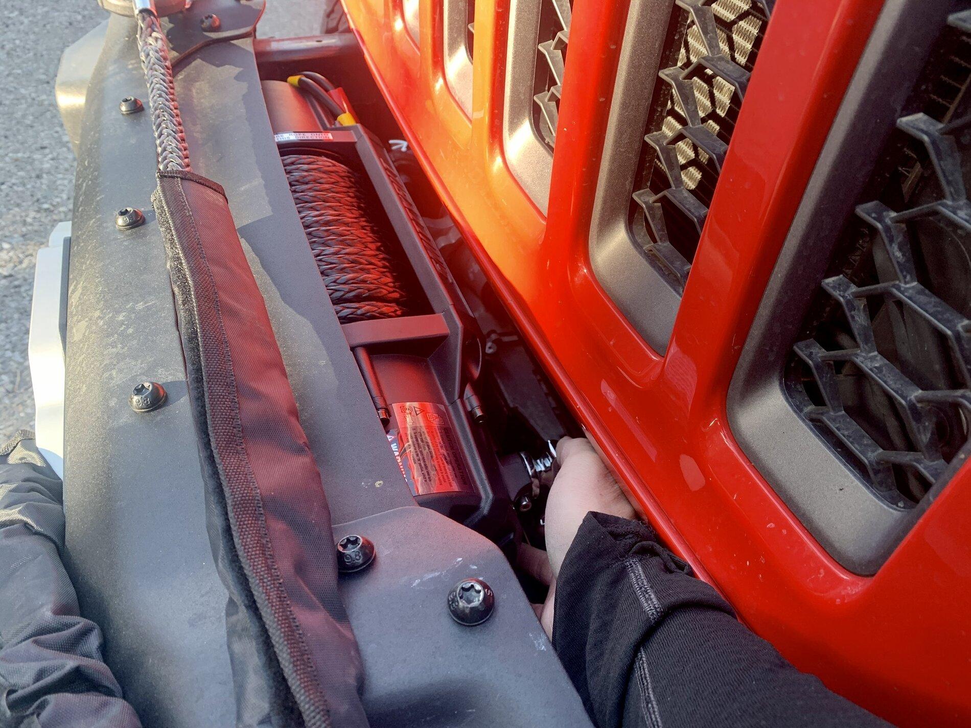

12k H2O winch and Maximus-3 winch plate were easy to install (as I had learned on this forum) :like:

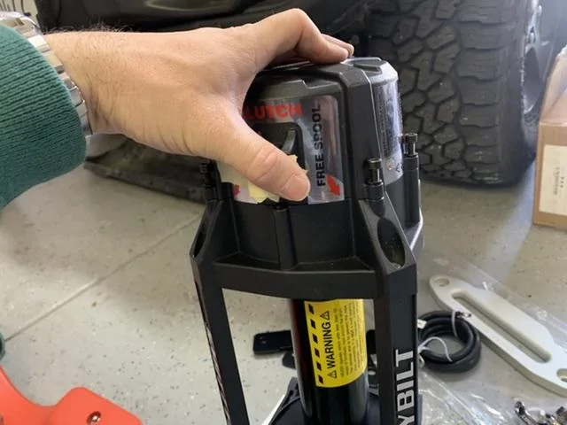

I wanted a clean “hidden” install and did two things: clocked the gearbox 90’ backwards to clear the clutch lever from the bumper/delete plate; and, I mounted the solenoid behind the right side of the bumper like @Moregone​
Jeep Gladiator “Stealth” hidden smittybilt H2O 12k winch install on Maximus-3 winch plate ?hash=189f03930bb1622ea5c3a059aec00cf9

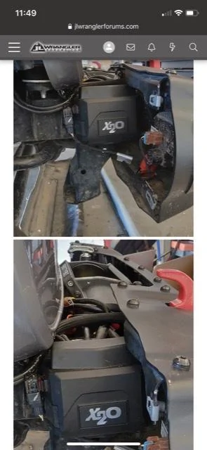

You can also see from his pics that he routed the wires from the solenoid to the winch over the front frame rail; this is probably the cleanest way to do it.​

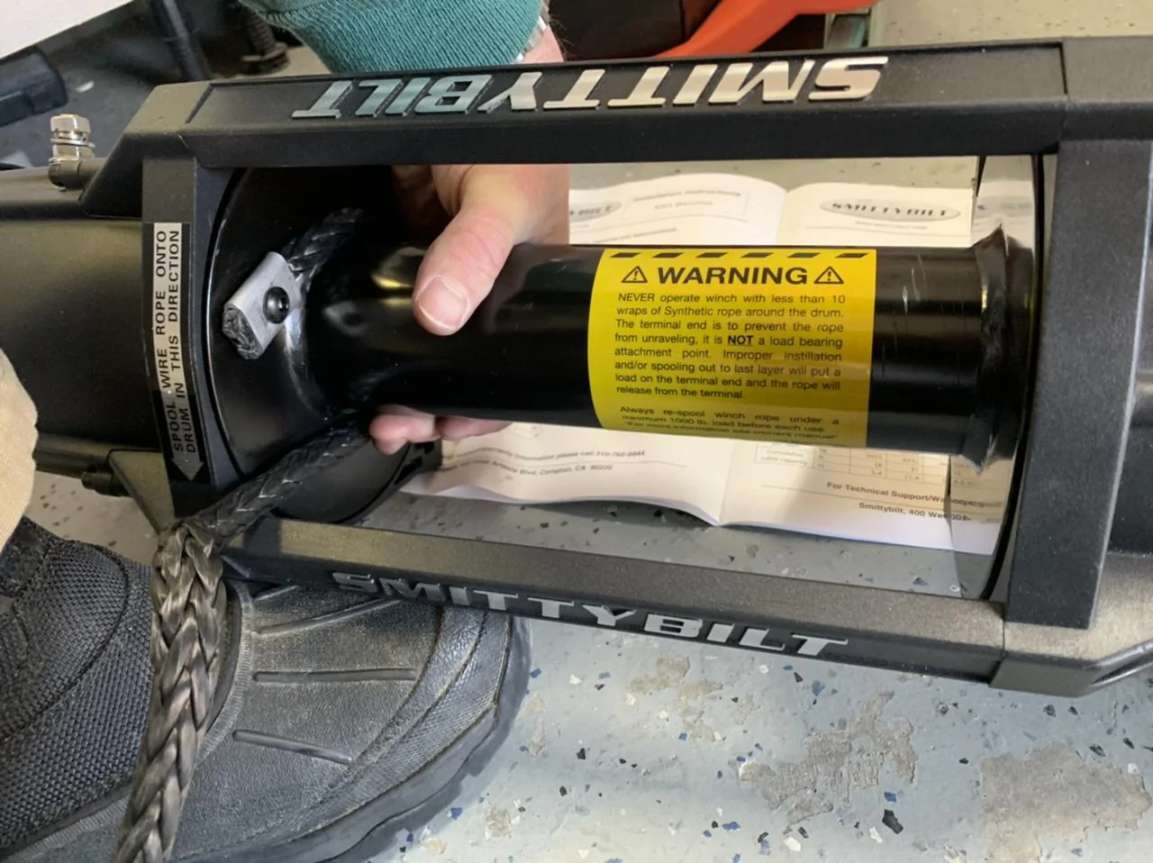

Also, I couldn’t find it in instructions and had to google it. The rope loops behind winch and back over the top to attach to the drum. If your winch hook can’t fit through the bumper or fairlead then it’s easy to just mount the rope after mounting the winch.​

3. Clock winch gearbox 90’ backwards. Very easy with hex key, think it was 5mm.​
Jeep Gladiator “Stealth” hidden smittybilt H2O 12k winch install on Maximus-3 winch plate 23483451-8B06-4521-BBA3-36697D047C82
Jeep Gladiator “Stealth” hidden smittybilt H2O 12k winch install on Maximus-3 winch plate 4BF9D4E8-F93C-4C29-B2AB-78235ED5DF4C
There is plenty of room behind winch to reach and turn clutch lever. Not an issue.​

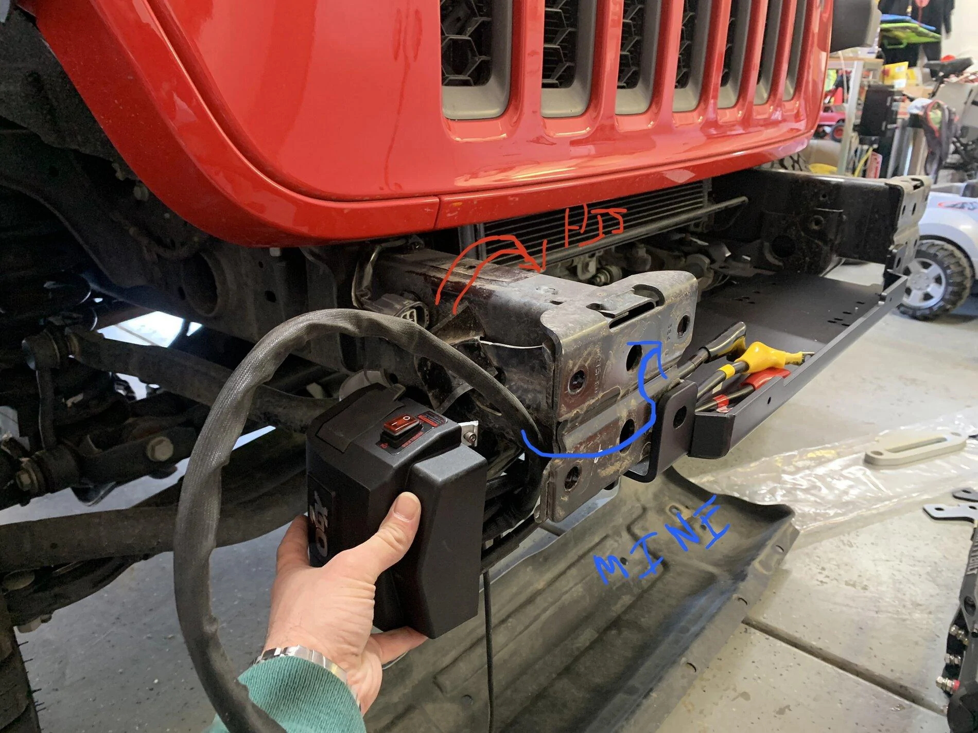

4. Figure out wiring, and then mount winch. I like uncluttered OEM appearance and saw people that had relocated the solenoid so I tried hiding mine. Thanks @Moregone for the idea.​
I wasn’t sure from his pics if I could still replace the winch delete plate for a true hidden install, but it worked perfect!​
I plan to rewire/remount the solenoid up a little higher like Moregone but was tight on time. I routed the short wires forward around/under the frame rails. I didn’t have time to take the feet off the solenoid but it didn’t seem like it would fit anyway; after looking at his pics, it’s clear he had room after removing the brackets. Whoops!​

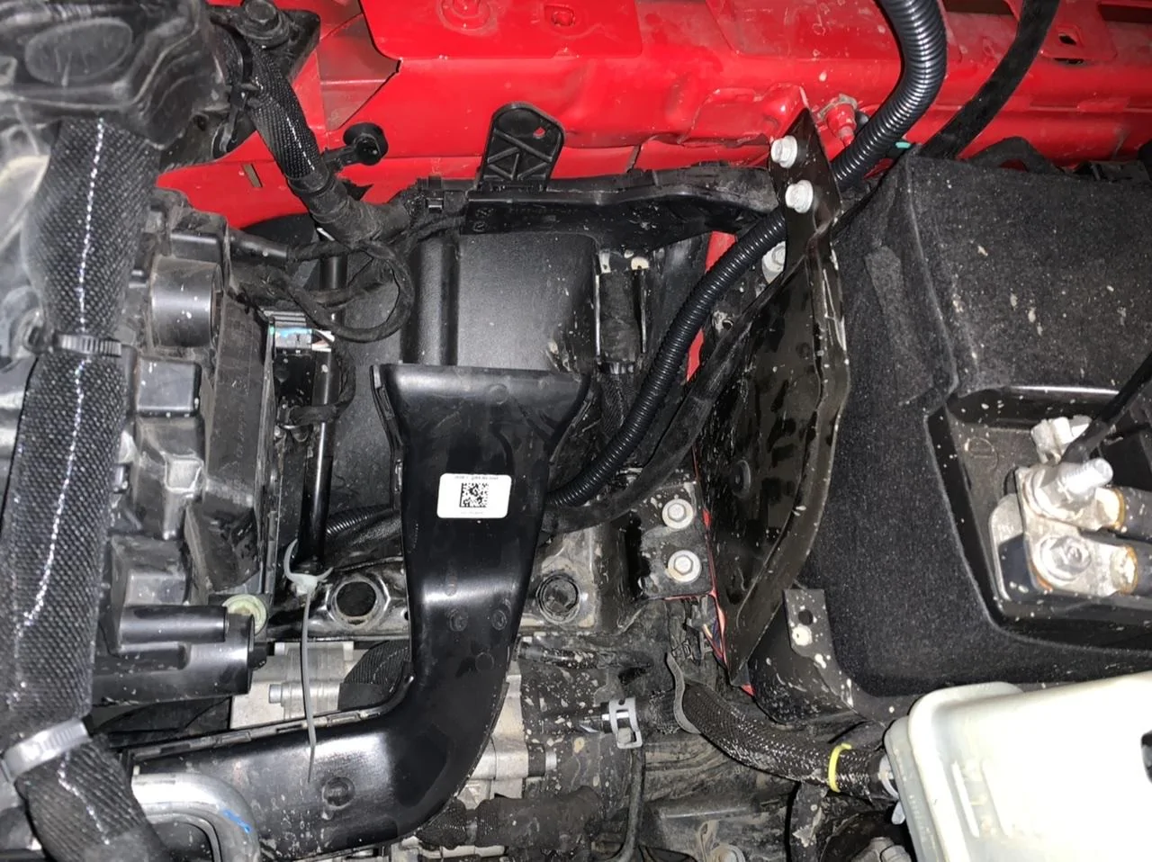

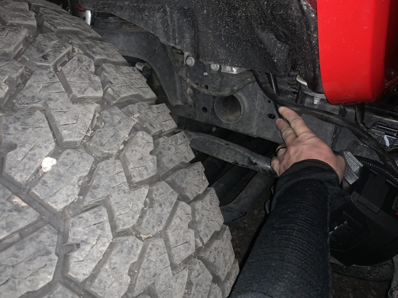

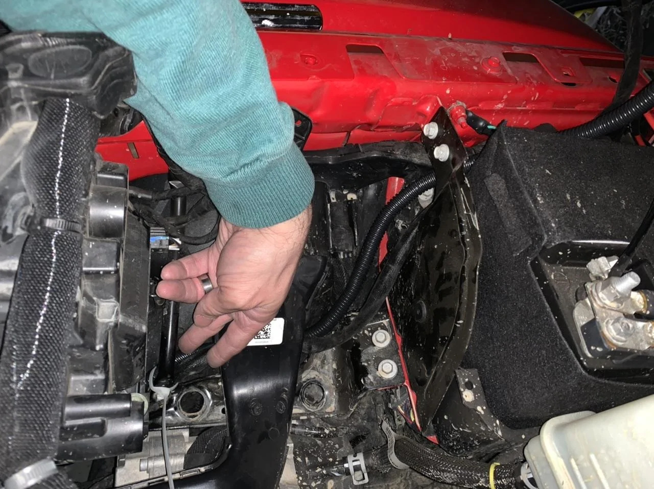

I’m still not set on the the wiring up to the battery. I could not feel/see a route inside of the grill and frame rail that didn’t pass pretty close to hoses and stuff that I worried could cause a major failure later. So I tucked mine outside of that rail, but it pulls the wires into/under the fender liner. I worry that they could rub the tire, especially if tires bigger than oem are fitted.​
Jeep Gladiator “Stealth” hidden smittybilt H2O 12k winch install on Maximus-3 winch plate FBCA8393-7406-4212-BD88-BDF6D6D55162
I plan on keeping this route and adding a hose clamp or zip tie close to the frame to keep the wires as far from the tires as possible.​

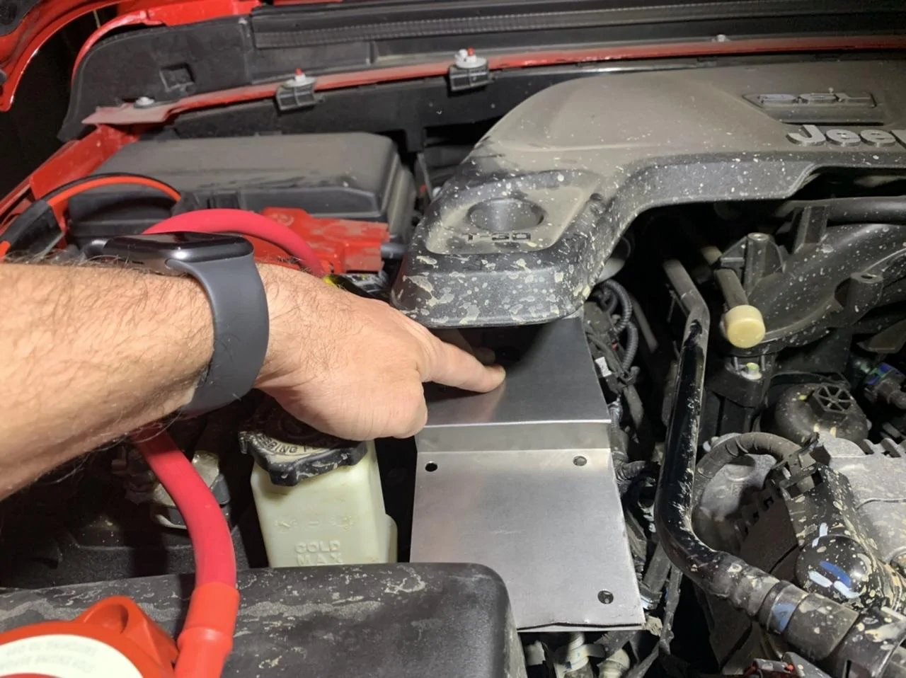

As others have shown there is an easy route up by the air box on the inside, I did remove mine to see better.​
On the inside, I pulled it laterally to run underneath of the air intake, up in front of the battery and through a little bracket between the fender and the battery. I’m pointing at +\- wires, negative I ran in a plastic loom.​

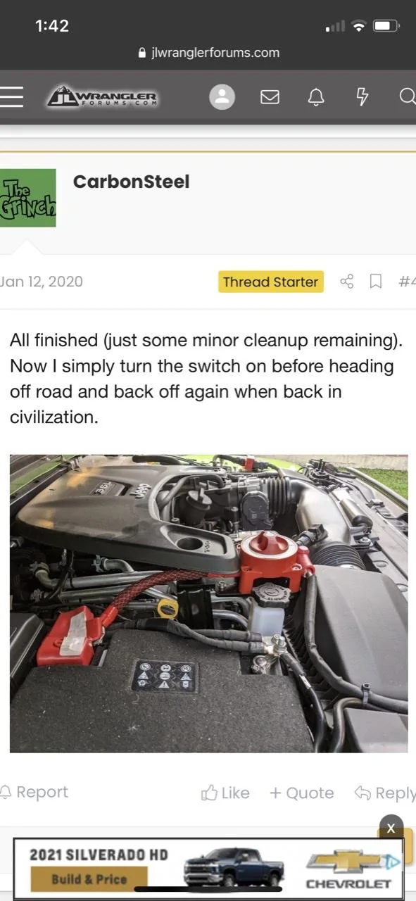

5. I plan on mounting a shutoff switch like this close to the battery:​
Jeep Gladiator “Stealth” hidden smittybilt H2O 12k winch install on Maximus-3 winch plate D70F4C48-7E03-4923-A5B6-E42F5E574A4D
I don’t like having constant power to the bumper. Didn’t want to use aux switch for relay and don’t think it’s a big deal to raise hood to turn on winch, or turn on winch before a big trip.​

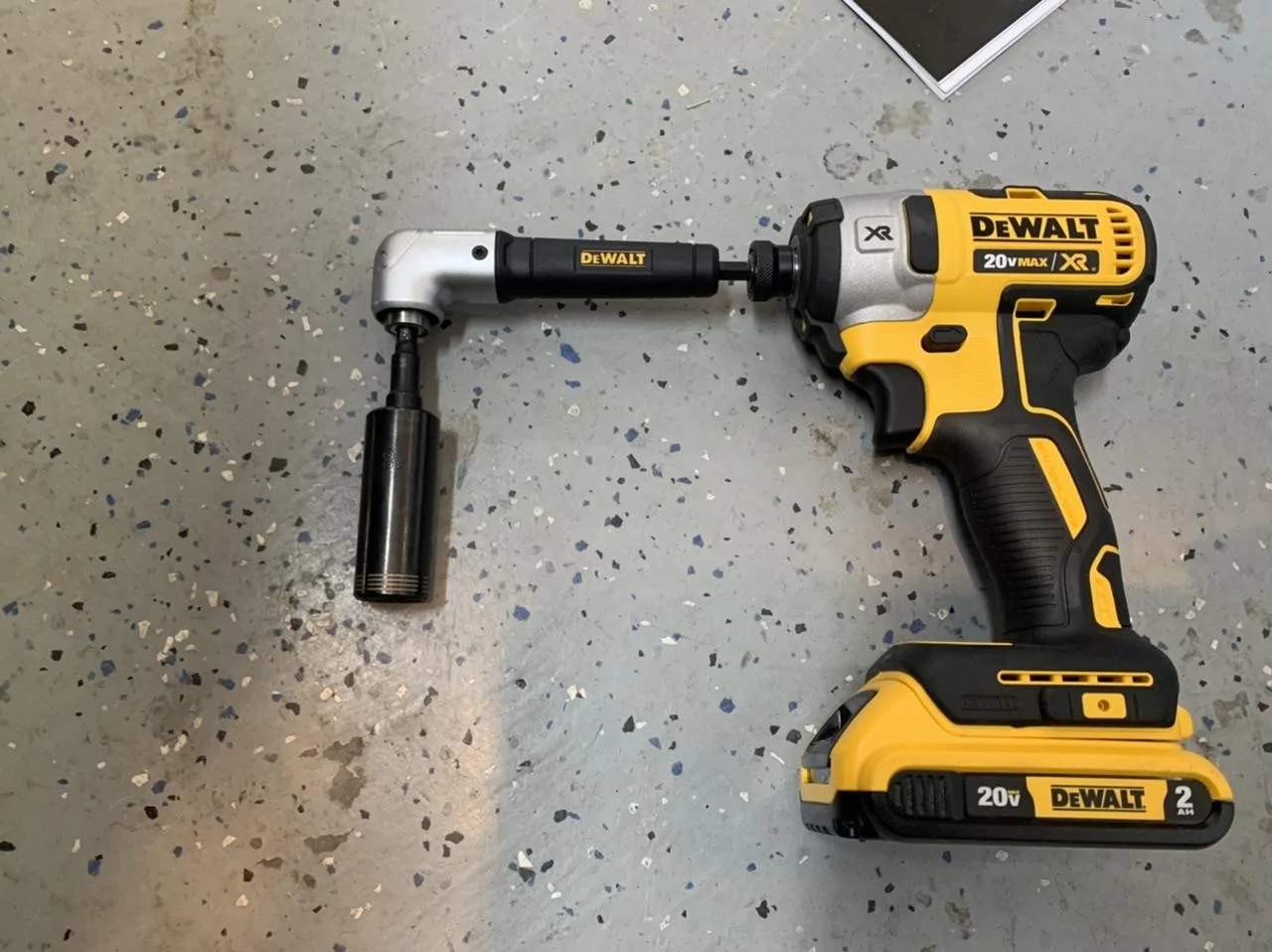

Not terrible but passenger inner bottom nut was hard to reach through wiring.​
It wasn’t bad with some mcguyvering.​
Jeep Gladiator “Stealth” hidden smittybilt H2O 12k winch install on Maximus-3 winch plate 92B0E660-282C-4C20-94E0-2197BD1EB003
For that bolt I had to hold the impact under the bumper.​

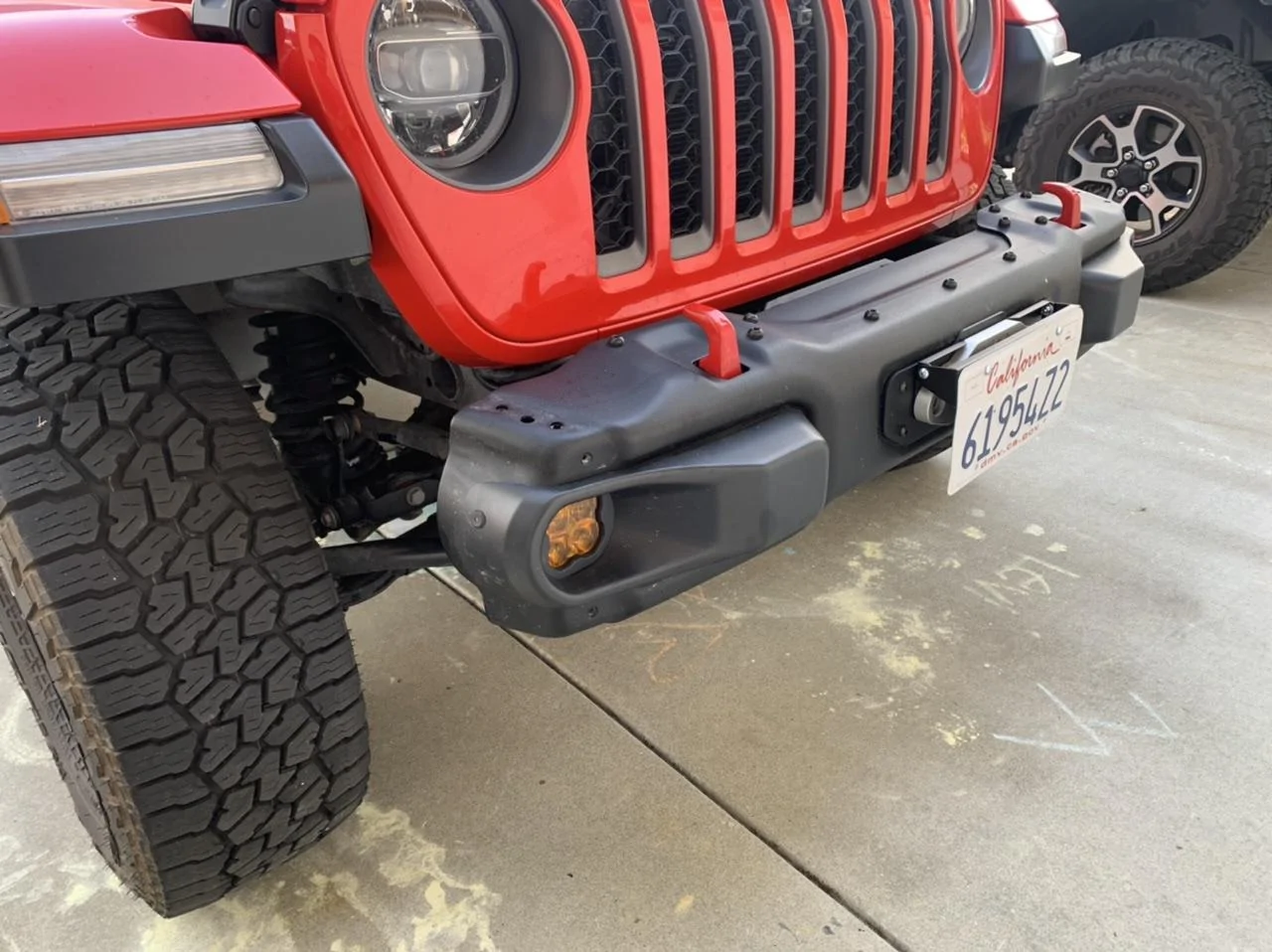

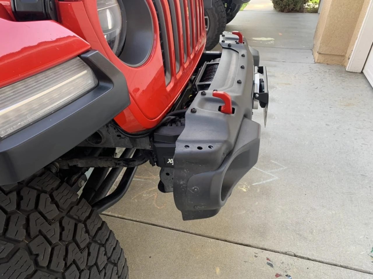

I also could still mount my oem rubicon skid plate despite winch plate moving the bumper/skid forward 1/4”.​
I loosely started all bolts, but one towards driver side didn’t fully seat and I was worried about stripping the rivnut so I left it kind of loose. It’s a pretty weak skid plate so whatevs.​
7. I plan on hiding hook behind a flip-up license plate bracket, didn’t have time to mount it. One question I have is, even after tightly wrapping the winch line under tension, I’m not sure I have room left to wind the nylon protective winch wrap into the drum. I see other people with it barely sticking out so it must be able to be wound inside? I may just un-Velcro it and keep it with the remote and put it on as needed instead of winding it in, I’m afraid of cutting the line on the inside of the winch frame if it’s too large inside. (I had smashed the rope a little when I loosely wound it at first. Gotta wind it under tension just to have enough room!​

What are you gonna do about a front license plate?

How did you mount the X20 90 degrees Backward? Are there mounting points for the bolts to facilitate that orientation?

The winch itself only mounts one way to the plate. Before you mount the winch, take a ?5mm hex key and undo the bolts on the gearbox and then you can separate and rotate the gearbox 90 degrees clockwise.
Then, when you mount the winch the clutch handle will be below the grill like my pictures.

I do not have the Maximus stealth license plate relocation bracket so cannot comment on that, I just have their winch plate.
I think the flip up license plate bracket (not pictured) was Tuffy or an Amazon knockoff.

Updated pics.

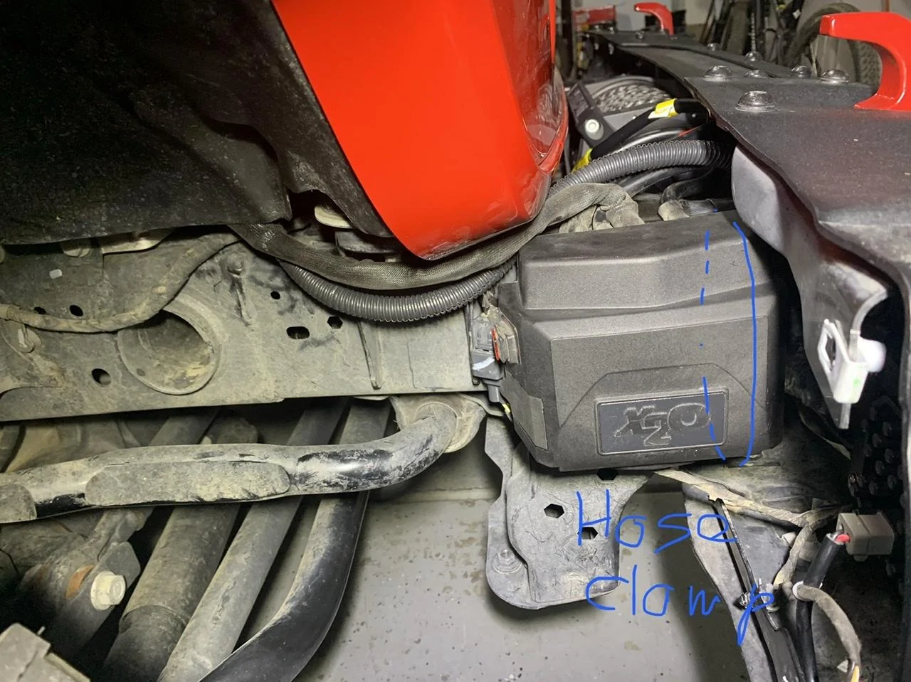

I finally rewired the solenoid over the frame like it should’ve been. Bought the biggest hose clamp at Lowe’s I could find, sorry didn’t take a pic. Just drilled a couple holes to screw the solenoid to it and tightened the hose clamp over the frame. There was enough room once I pulled the fog light wiring loom mount out of the frame and pinched it further back behind the solenoid.
Now the solenoid sits tighter and wires still fit well. Love the look

@CarbonSteel did a better job than I did mounting my shutoff switch, so copy him instead :LOL:

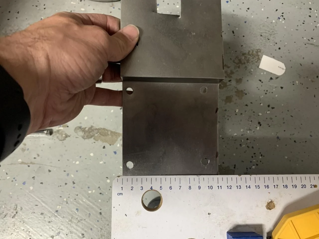

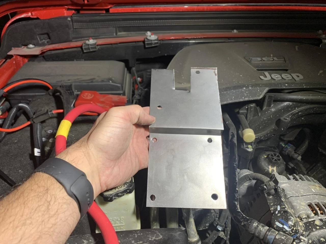

His shorter positive cable is much cleaner but I just ordered one off Amazon. Wish it were shorter but couldn’t figure out how to source one or make one without spending way too much time doing it.
Exell Battery 1/0 AWG Interconnecting Copper Cable, 18-Inch Length with 3/8-Inch Lugs (Red) https://smile.amazon.com/dp/B07HGKX...abc_F53W6V16EBHHTT1WAHDJ?_encoding=UTF8&psc=1

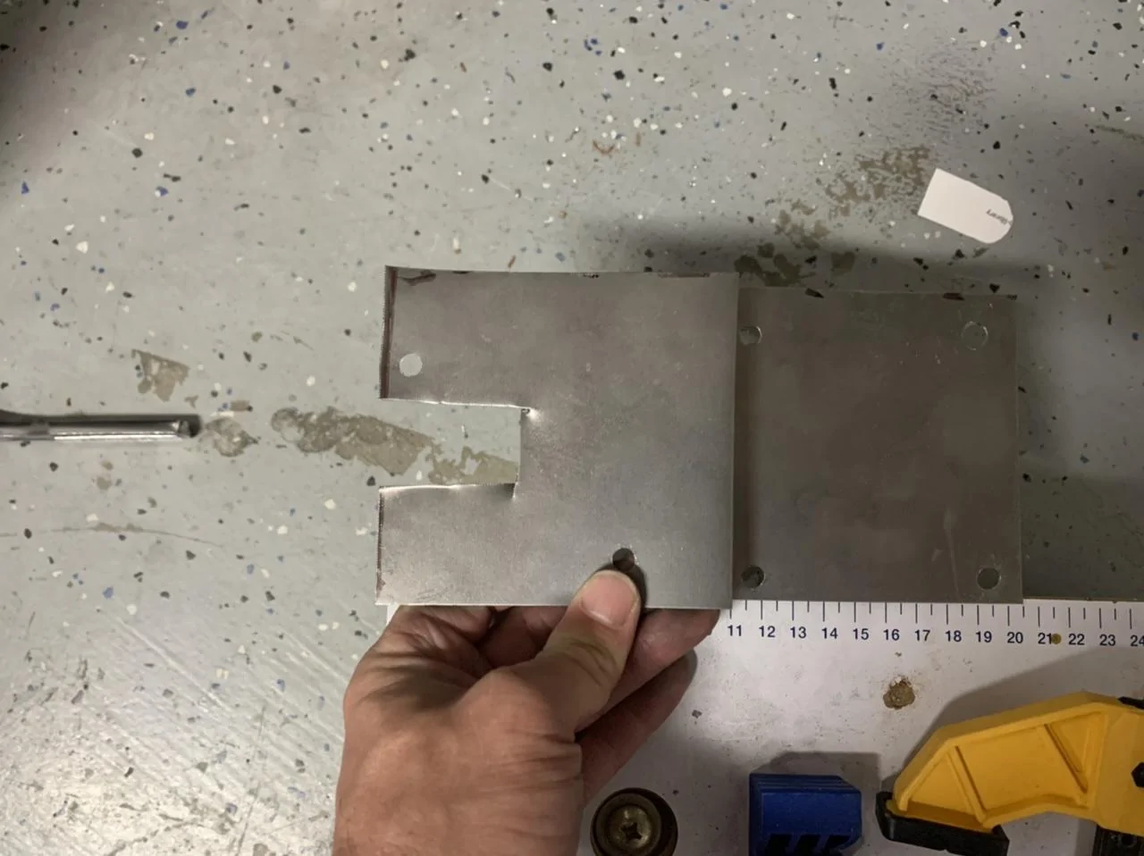

I copied him and made a thinner, jankier plate out of two layers of 22g steel from Home Depot.
If you do it like me you can use about 18in or slightly less , I did it differently and bent the plate down to lower the switch instead of using washers to level it.

I’m sure the guys with machining experience are throwing up, but hey you do what you can with a dremel and a drill:rock:
