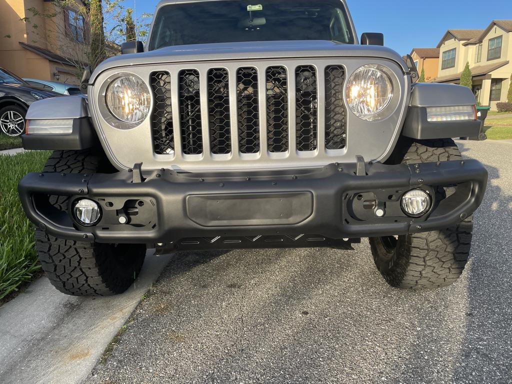

I took a Rubicon Metal bumper and removed the bumps that stick out of the bumper by the fog lights. Tomorrow, after I install the panels I fabbed up to fill the space, I will take pics and post.
It makes the front bumper about as short as it can be. probably 1.5 inches past the tow hooks which mount to the end of the frame. Anything shorter will literally need to mount directly on the frame rails. You need some collapse space to protect the frame if you bump something.

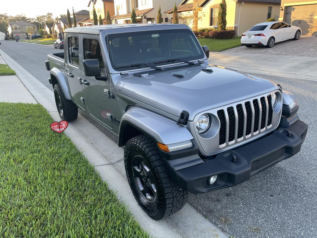

Here are the pics. The fab is a little crude. I did it with tin snips and a belt sander for shaping.
Stock

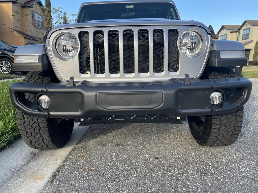

Modified with a steel bumper - No patch panels
Jeep Gladiator “Shortest” front and rear bumpers? 86A17B35-8826-4D65-9AEF-FDBDD4BE9816_1_105_c
Jeep Gladiator “Shortest” front and rear bumpers? BBB1C42D-ABE8-48E0-8BE3-71E145B2FD24_1_105_c

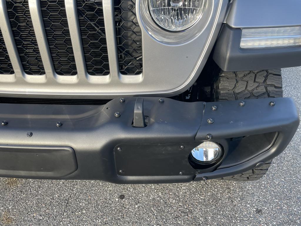

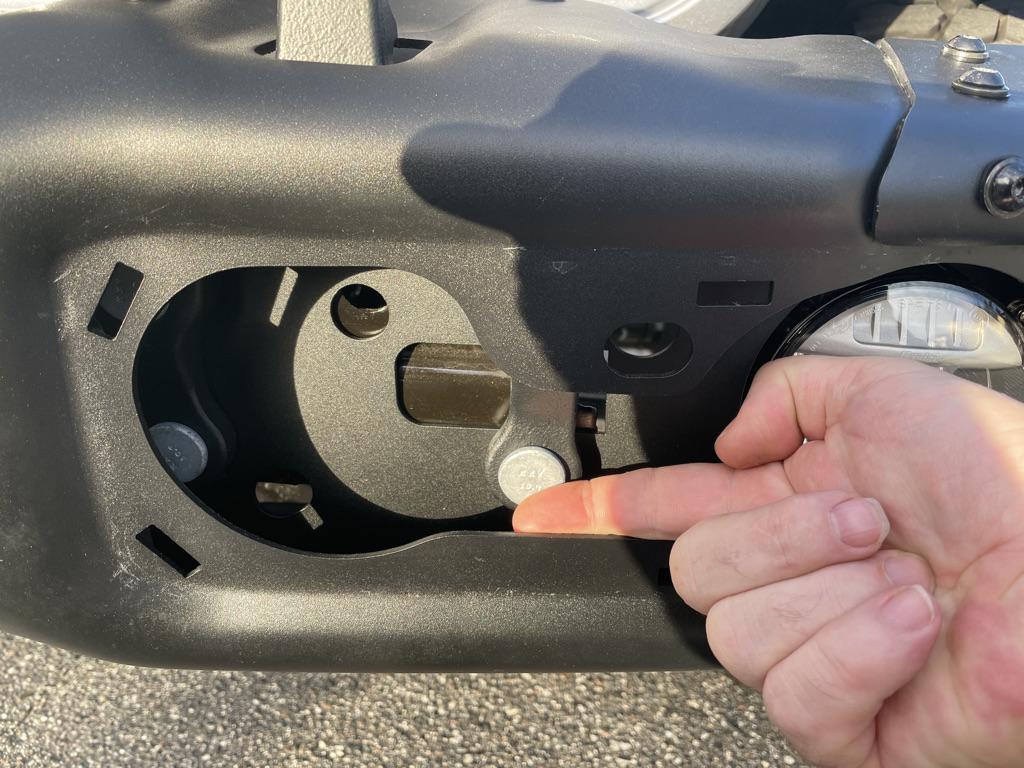

Patch Panels installed
Jeep Gladiator “Shortest” front and rear bumpers? 37E15ED5-B10E-4EB7-95D2-331B02BA46AE_1_105_c
Jeep Gladiator “Shortest” front and rear bumpers? 6A18D8AB-7B64-4E15-BED5-4DB46E4B1165_1_105_c
