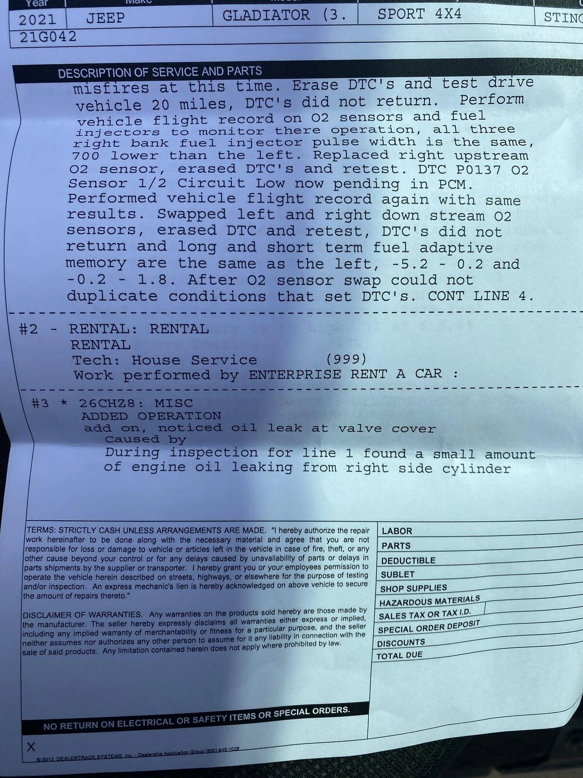

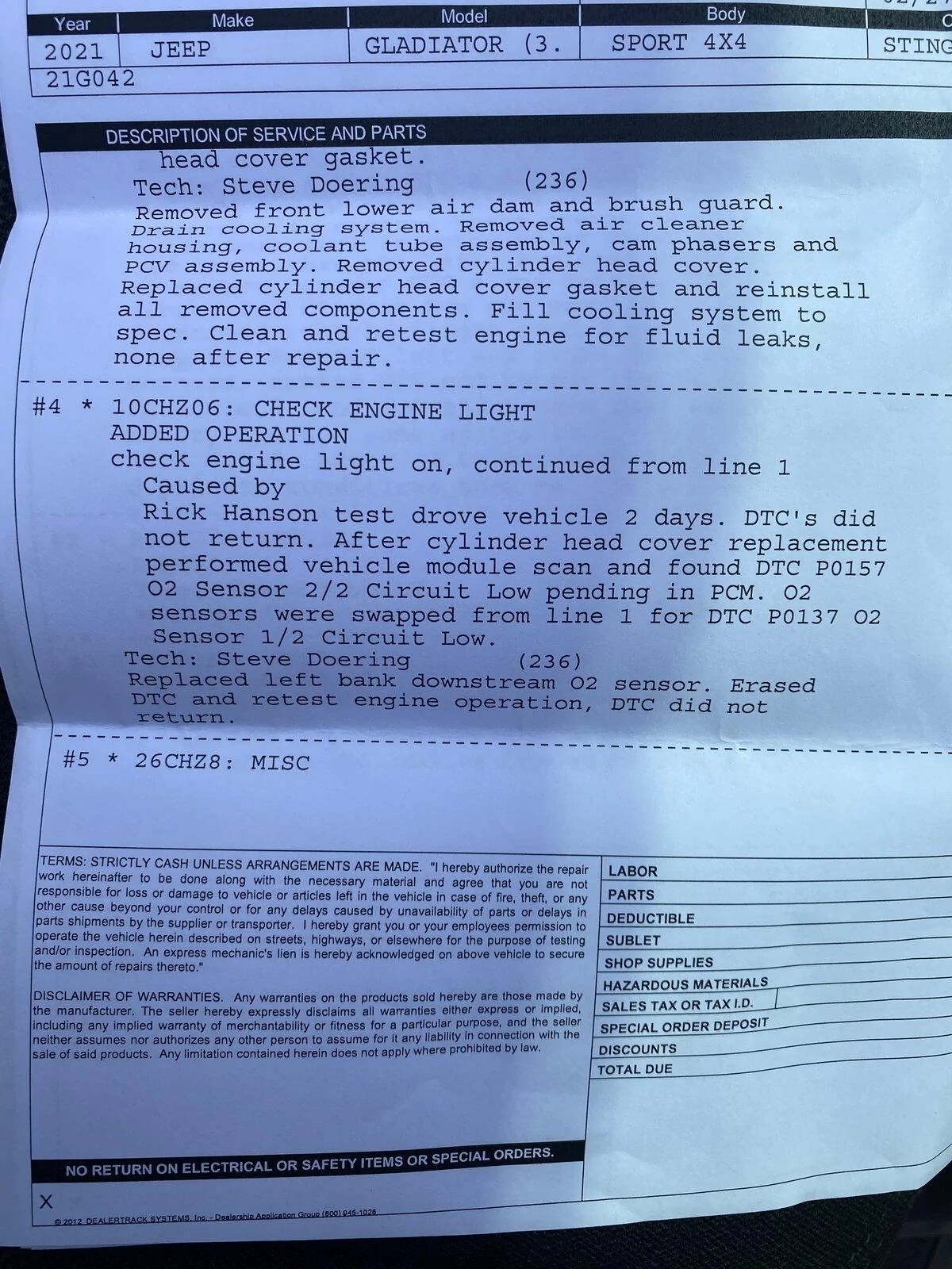

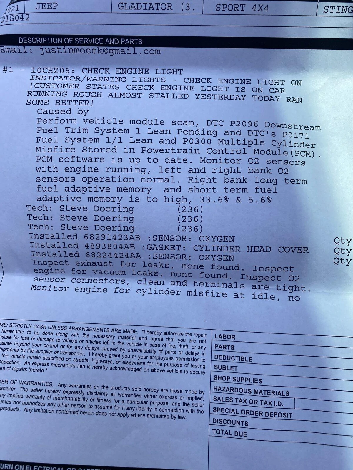

too much to type so here is the work order.
Thanks!
Reading it, looks like they made a good faith attempt in troubleshooting and repairing it. Only niggle is that I doubt two O2 sensors would crap at the same time but since the warranty parts cannon was loaded, they made the call to just replace both to be safe.
This is the 3rd time they were replaced to.

I totally missed that. I guess they are shotgunning parts.
It went into the dealer for this same problem 2 months ago. I didn’t include all that.
