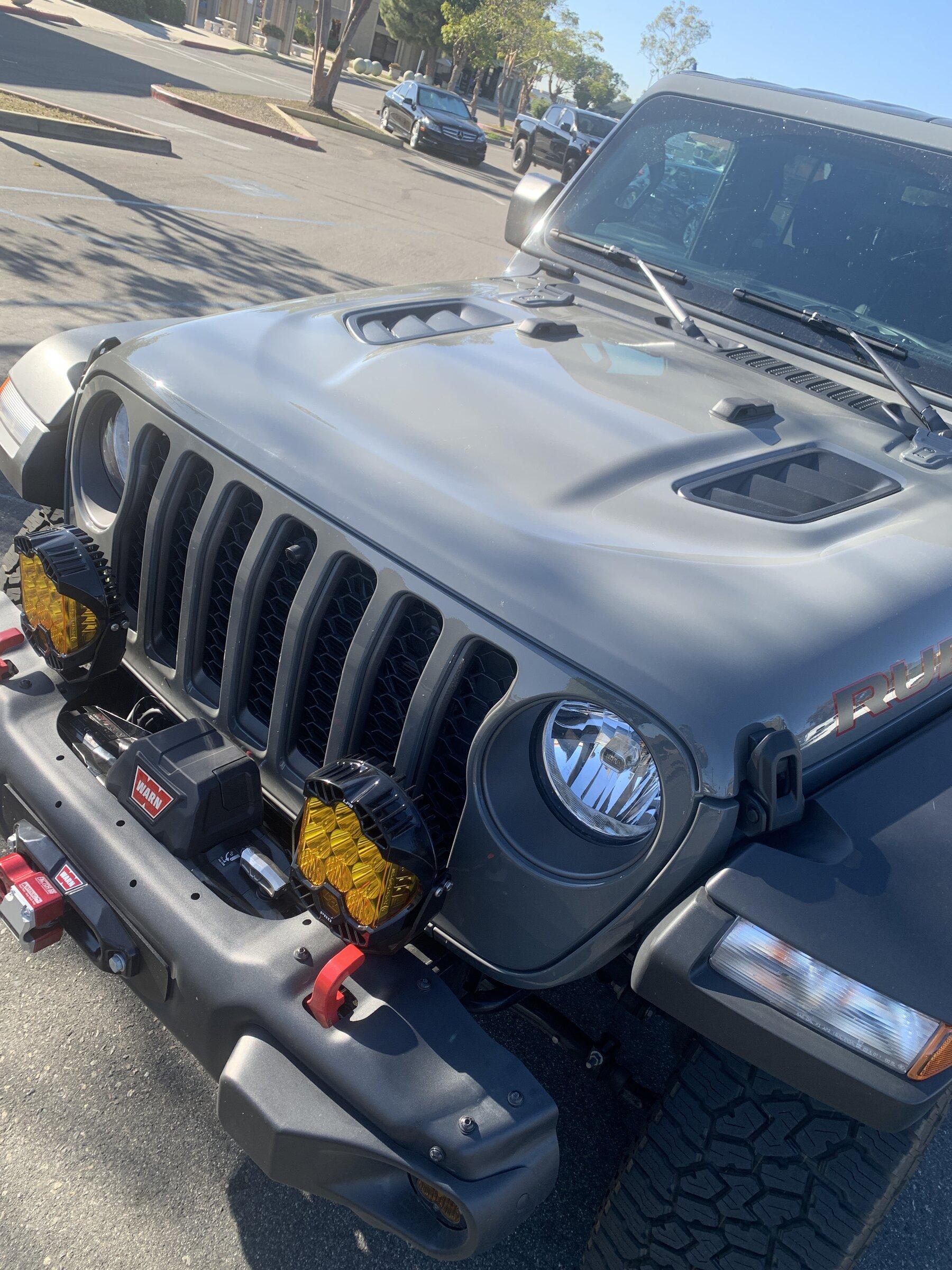

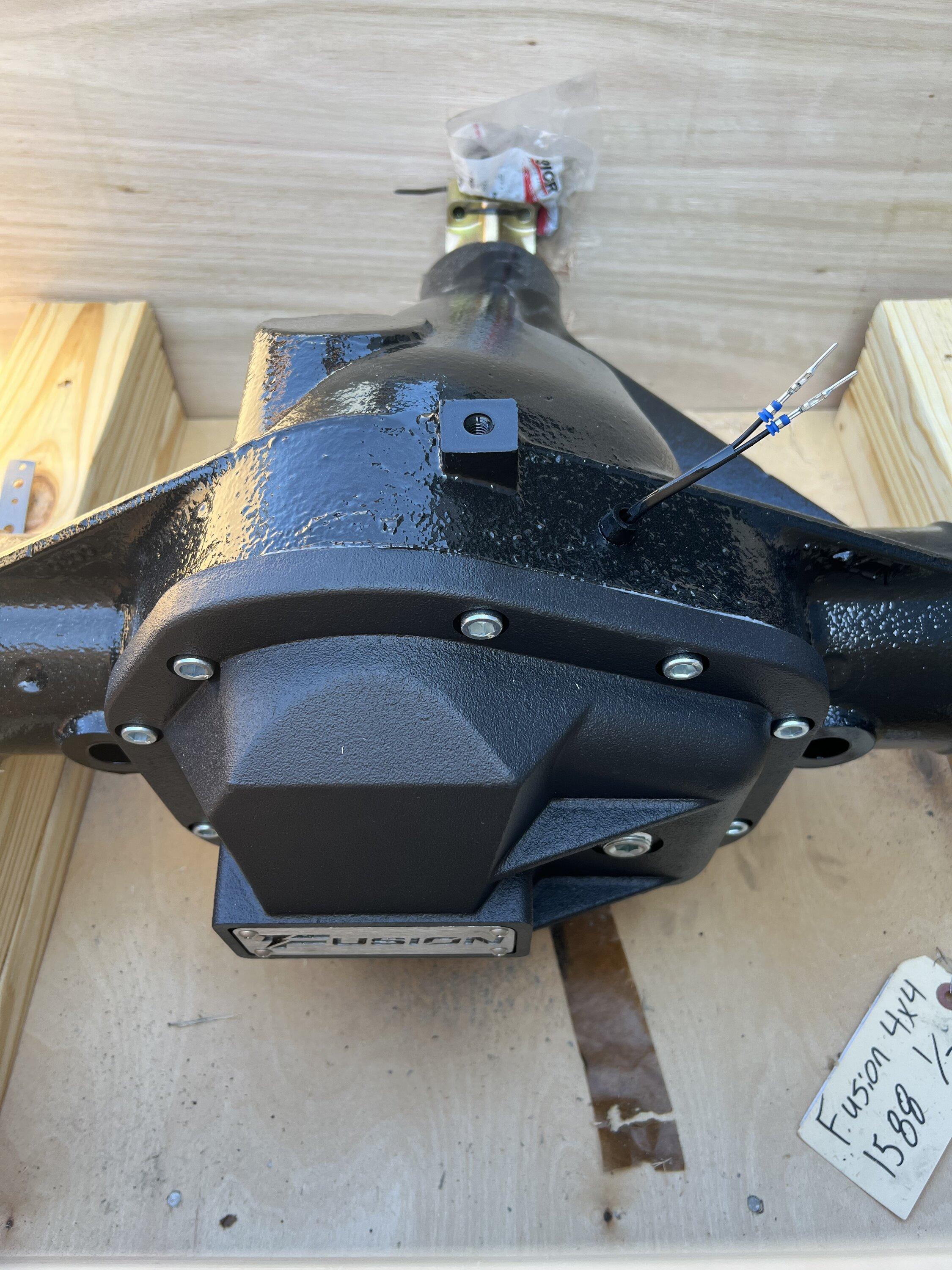

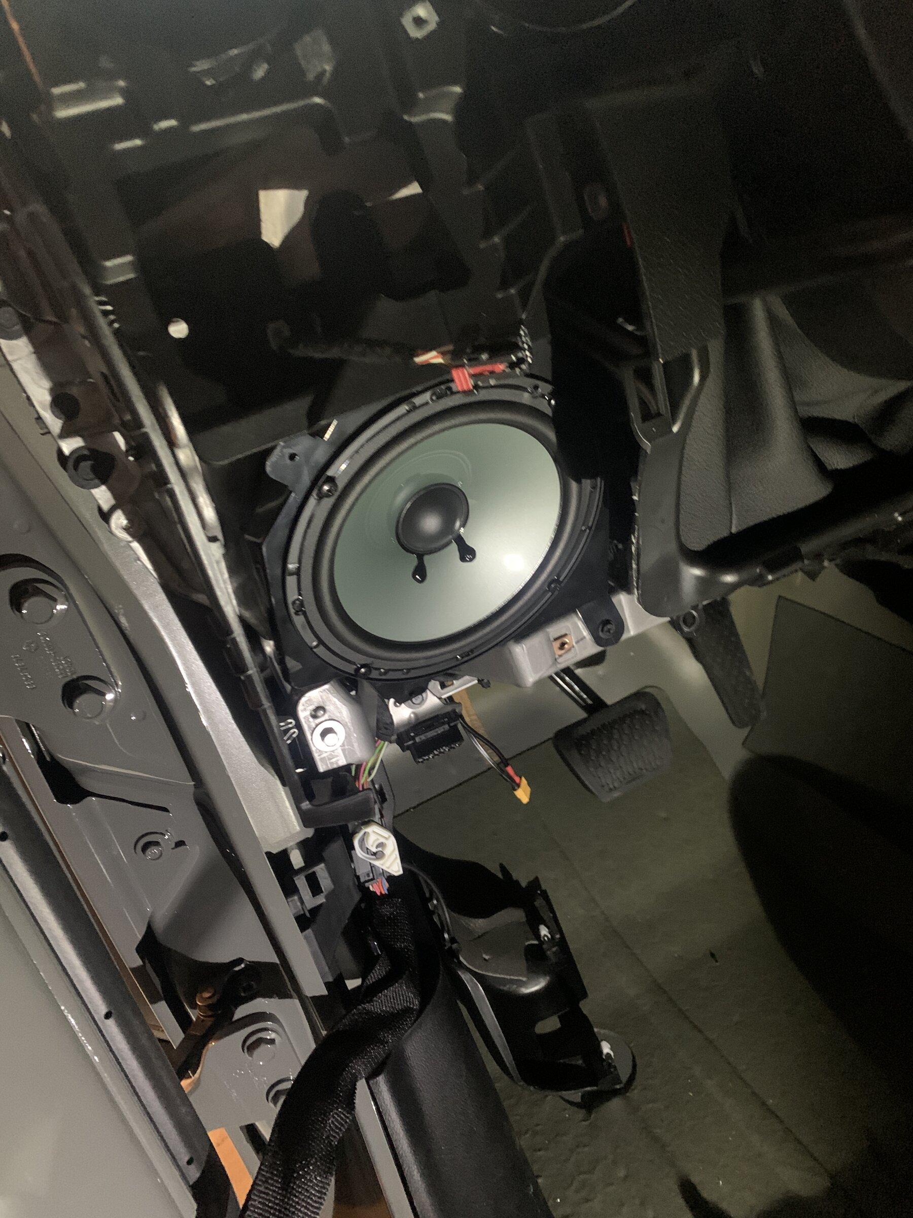

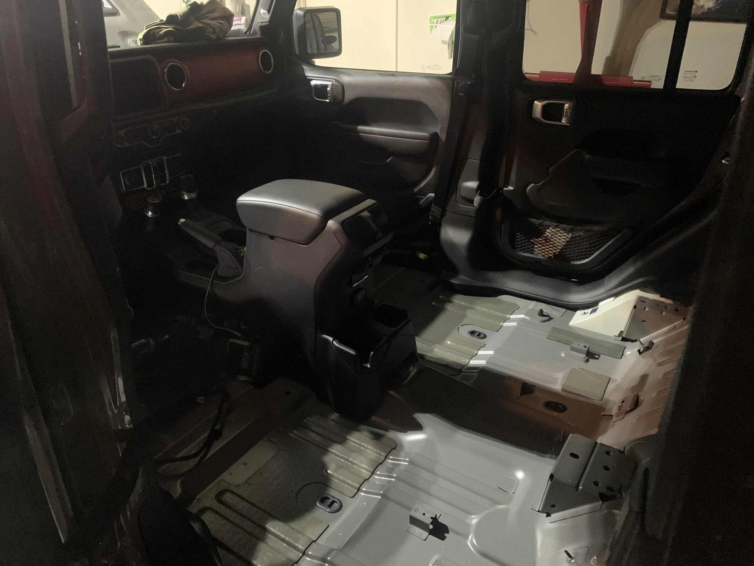

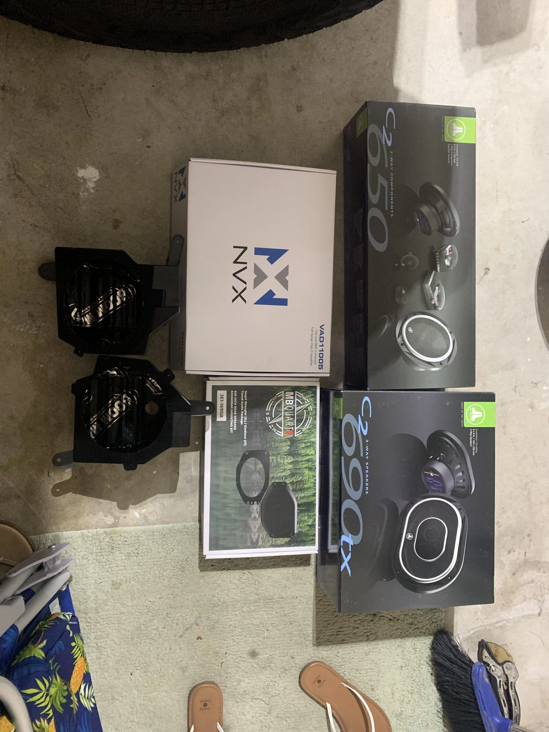

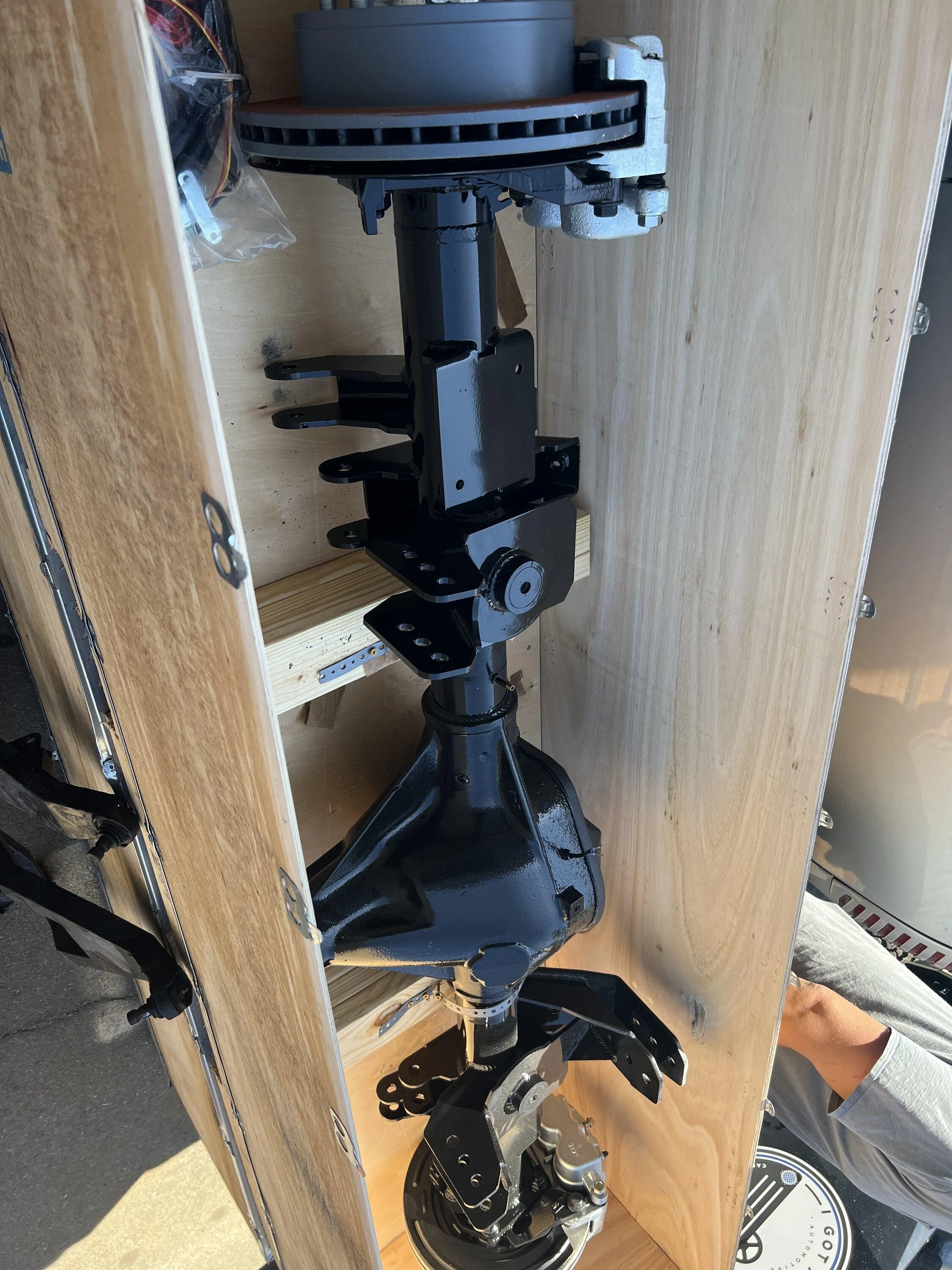

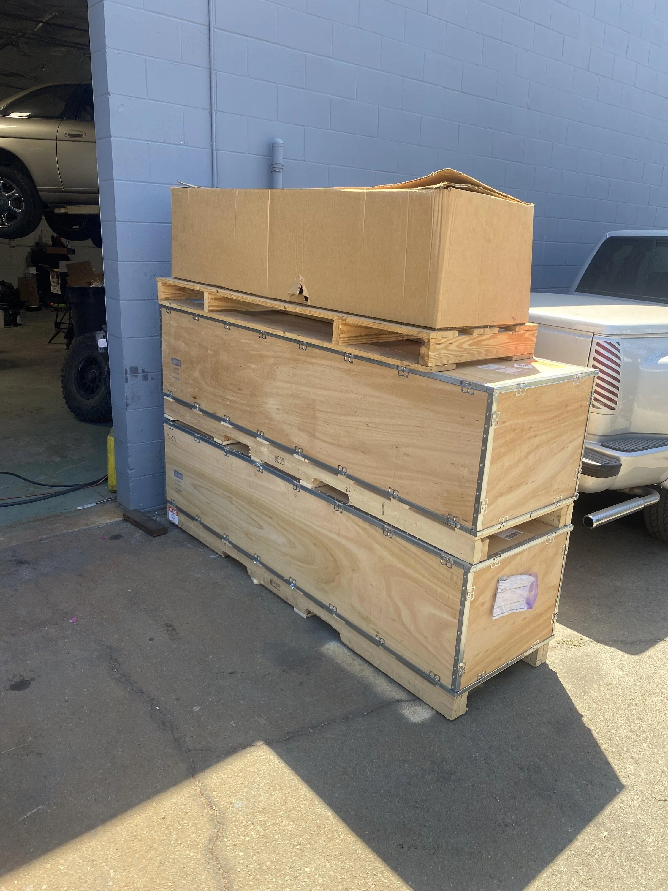

The time has finally come. After 11 months of planning and waiting, the build has started.
Some changes:
Front long arm 3 link from rock krawler.
Full aluminum Rock hard skid system.
Fox bumpstops.
Rob over at Adventure bound offroad started tearing into it. Can’t wait to get it out and scratch it.
Jeep Gladiator 2021 JTRD Sting Grey Rhino 3386F1BF-96BA-43B5-AD68-ADE17A70FB02
Jeep Gladiator 2021 JTRD Sting Grey Rhino 6764FF25-093B-4988-A5BF-49DB2ADCF326
Jeep Gladiator 2021 JTRD Sting Grey Rhino 2BAC1D61-E1EF-471F-9662-AC825A7CD4A8
Jeep Gladiator 2021 JTRD Sting Grey Rhino 3CE89BFE-95C7-45C9-B867-47A682A76CA4
Jeep Gladiator 2021 JTRD Sting Grey Rhino F5CDB841-5DC0-45F0-9668-7A68551ACD07
Jeep Gladiator 2021 JTRD Sting Grey Rhino 166A40FE-F066-48ED-8299-34F78C7E2426
Jeep Gladiator 2021 JTRD Sting Grey Rhino BF0B71CE-3045-43B4-83D8-5DB0346EBCFD
Jeep Gladiator 2021 JTRD Sting Grey Rhino B02B0FCA-D5AC-45CF-94CF-51BFAC87201B
Jeep Gladiator 2021 JTRD Sting Grey Rhino E7B97F36-6E52-4EDA-A1BB-2AC8F079092D

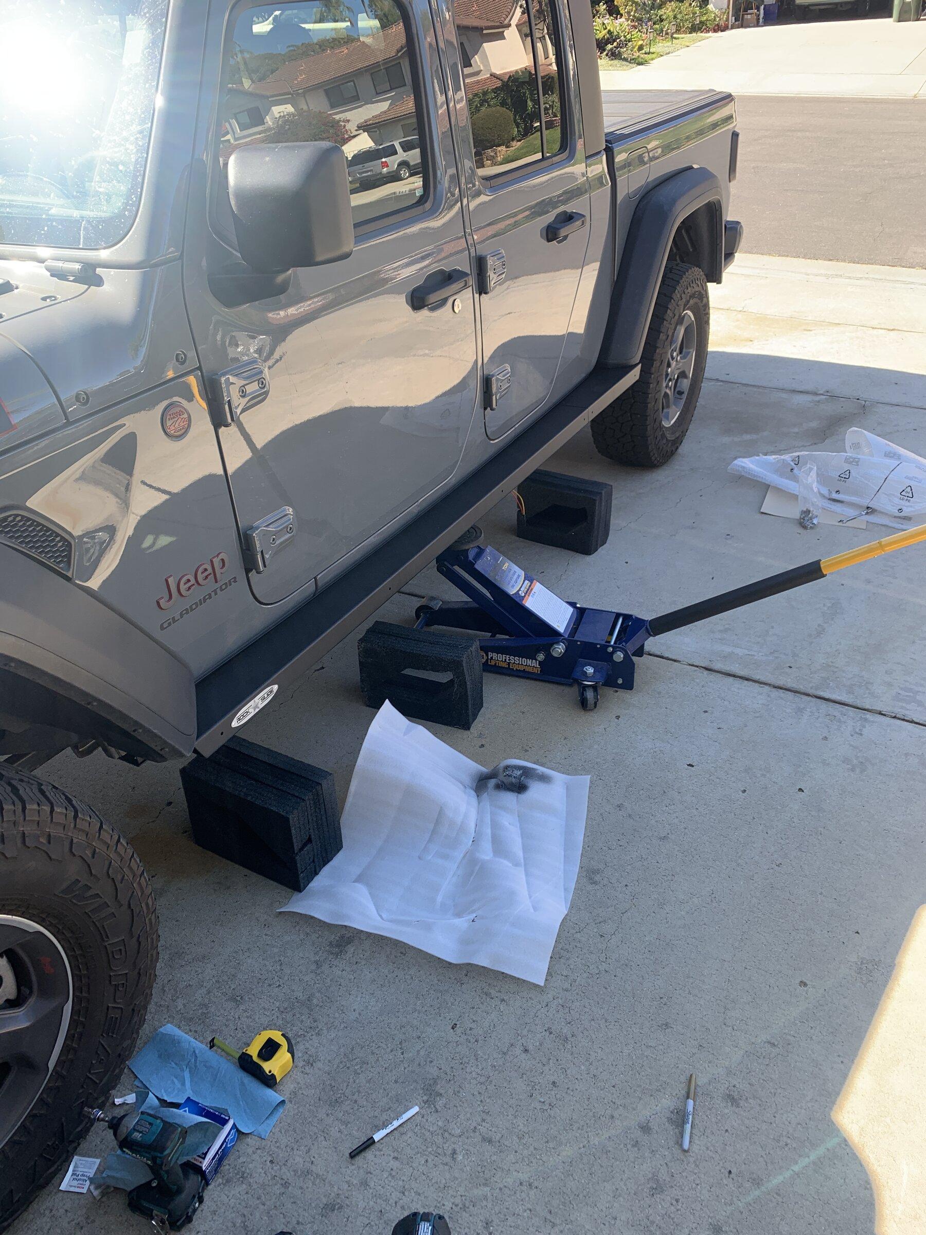

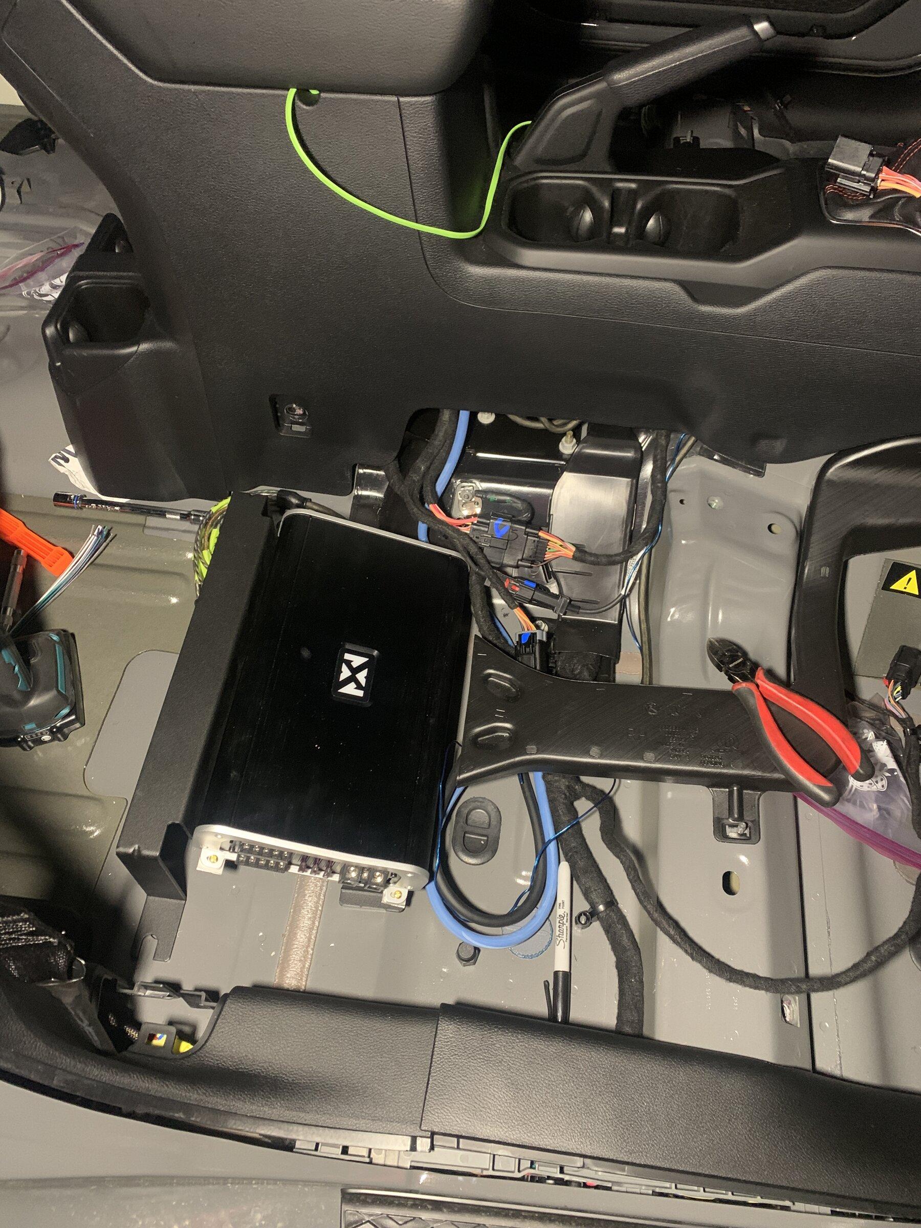

Rock krawler 3 link long arm getting setup.
Jeep Gladiator 2021 JTRD Sting Grey Rhino ABC77C21-9642-4A95-AEC3-62D479FA7023
Jeep Gladiator 2021 JTRD Sting Grey Rhino 3BEC7A10-9815-450A-ABD8-5CA1D21E12FD
Jeep Gladiator 2021 JTRD Sting Grey Rhino 5E71B991-3AC5-4E63-9943-D4BB9CF89723

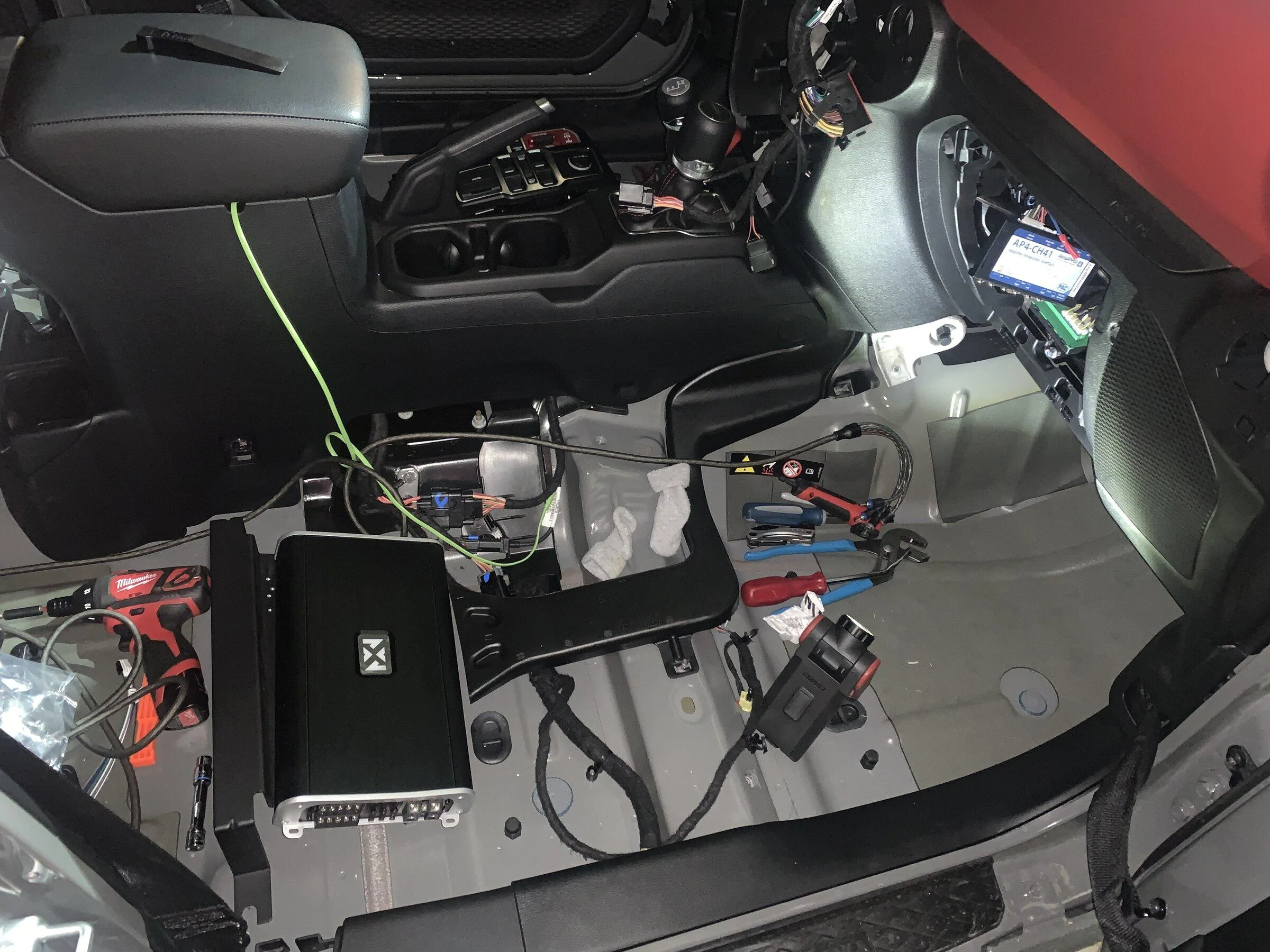

Cycling suspension. Having custom extended shock mounts made.
Jeep Gladiator 2021 JTRD Sting Grey Rhino 5CDCC0EF-A06F-41E9-A710-AD7C066E87A5
Jeep Gladiator 2021 JTRD Sting Grey Rhino 75ECF20E-D623-4E1C-AF76-00C884AEFE99
Jeep Gladiator 2021 JTRD Sting Grey Rhino DE595D23-938D-4CAD-AFA1-CB0257AF557E
Jeep Gladiator 2021 JTRD Sting Grey Rhino 4065F144-528F-4826-BB1E-1A6A1FD52734

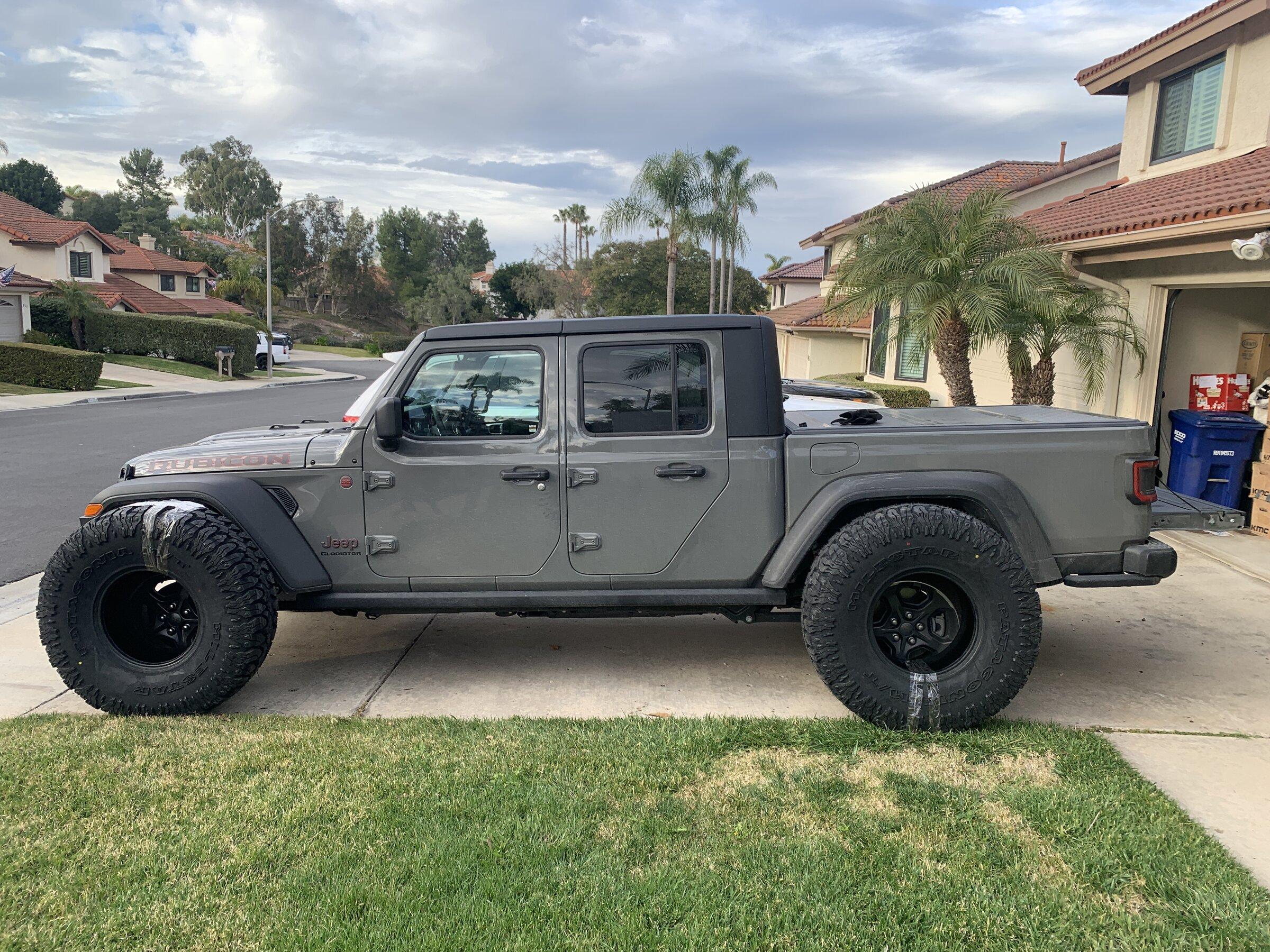

She’s finally complete! It now drives better than than stock. The new PSC big bore kit for the ecodiesel blows me away! The rock krawler 3 link long arm really allows a lot of droop. Don’t have the most up travel due to the 40s, but man can she flex. When you have a shop that knows what they are doing and really dials the suspension in, it makes a difference. Hours upon hours going on and off the rack getting flexed out clearancing everything. First time trip is hopefully Big Bear soon.
