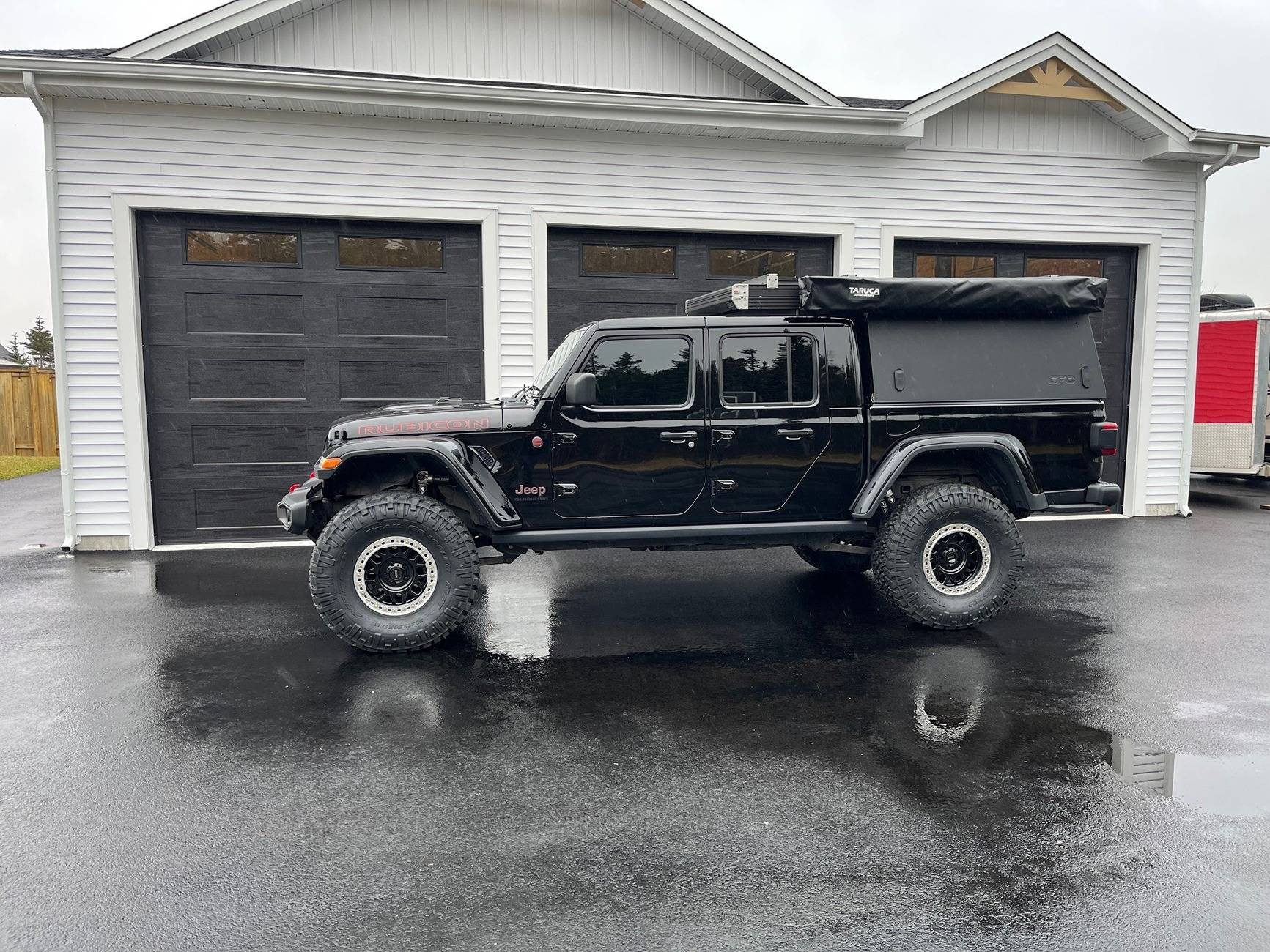

I'm looking into alternatives for front springs as the Eco-diesel engine is on the heavy side and my rig do not sit level as i would like it to. I have the 3.5" TF lift with Falcon 3.3 shocks, Swapped out the rear springs for Dobinson's 3" high capacity 4-600# static weight with a 3/4" spring spacer. The front of the jeep was sagging a little too much so i added the TF 1" front coil spacer but still not sitting level. Wondering if i should just buy 4.5" TF outback springs in hopes it will sit level or what springs could i get that will hold the weight correctly and sit level.

I ran Clayton’s diesel springs on my 2021 JTRD and was very happy with their on and offroad performance. I will be replacing the Teraflex springs on my 2023 JTRD with Clayton’s In the near future.
I have a stubby front bumper and a Warn VR12s to install as well so I'm thinking its going to dive in the front even more so. I definitely need front springs to compensate for the extra weight.
