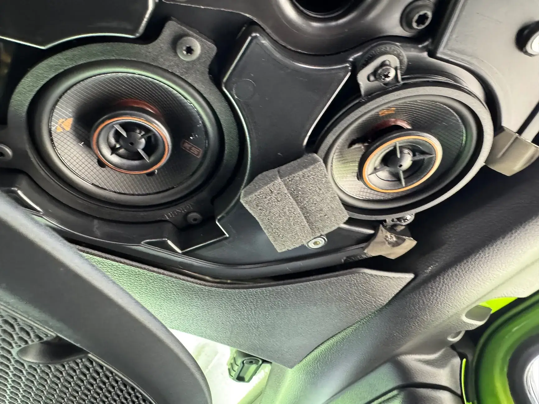

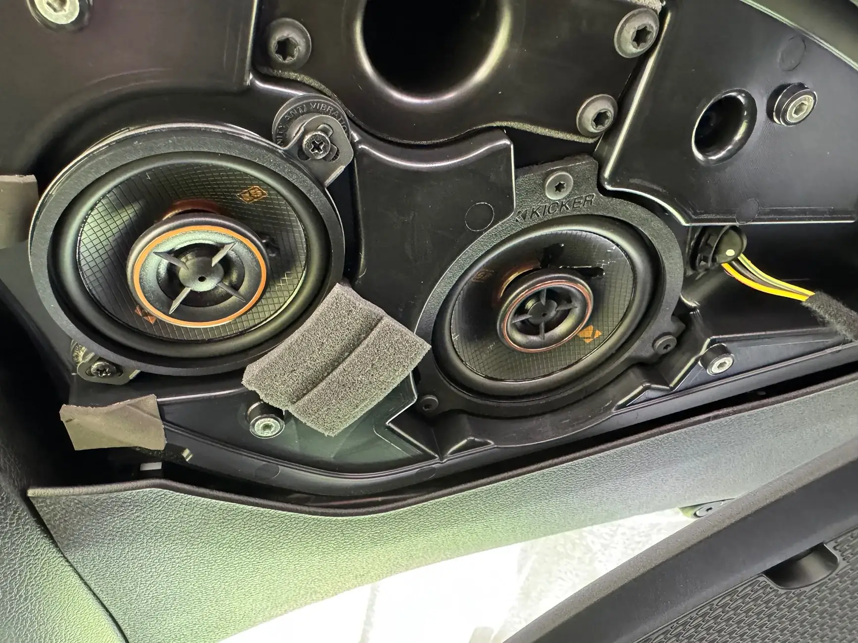

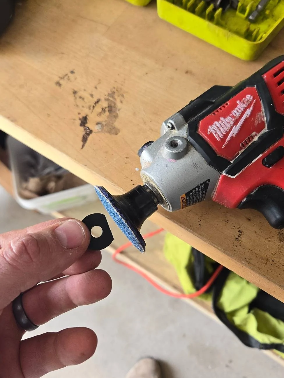

Just installed the ksc350s in dash (huge difference). Then , I did the ksc40s and ksc350s in the roll bar. The ksc350s are just a little bit too big for the opening . So, I came up with this , and it's as clean of an install that you could do. It sticks out like 1/4 inch. I got plastic 1/4 washers . I filed down a bit so that it could fit next to the speaker . Then I used it as a washer . They sit in there perfect now. I wanted everything Kicker ksc series . Sounds amazing.

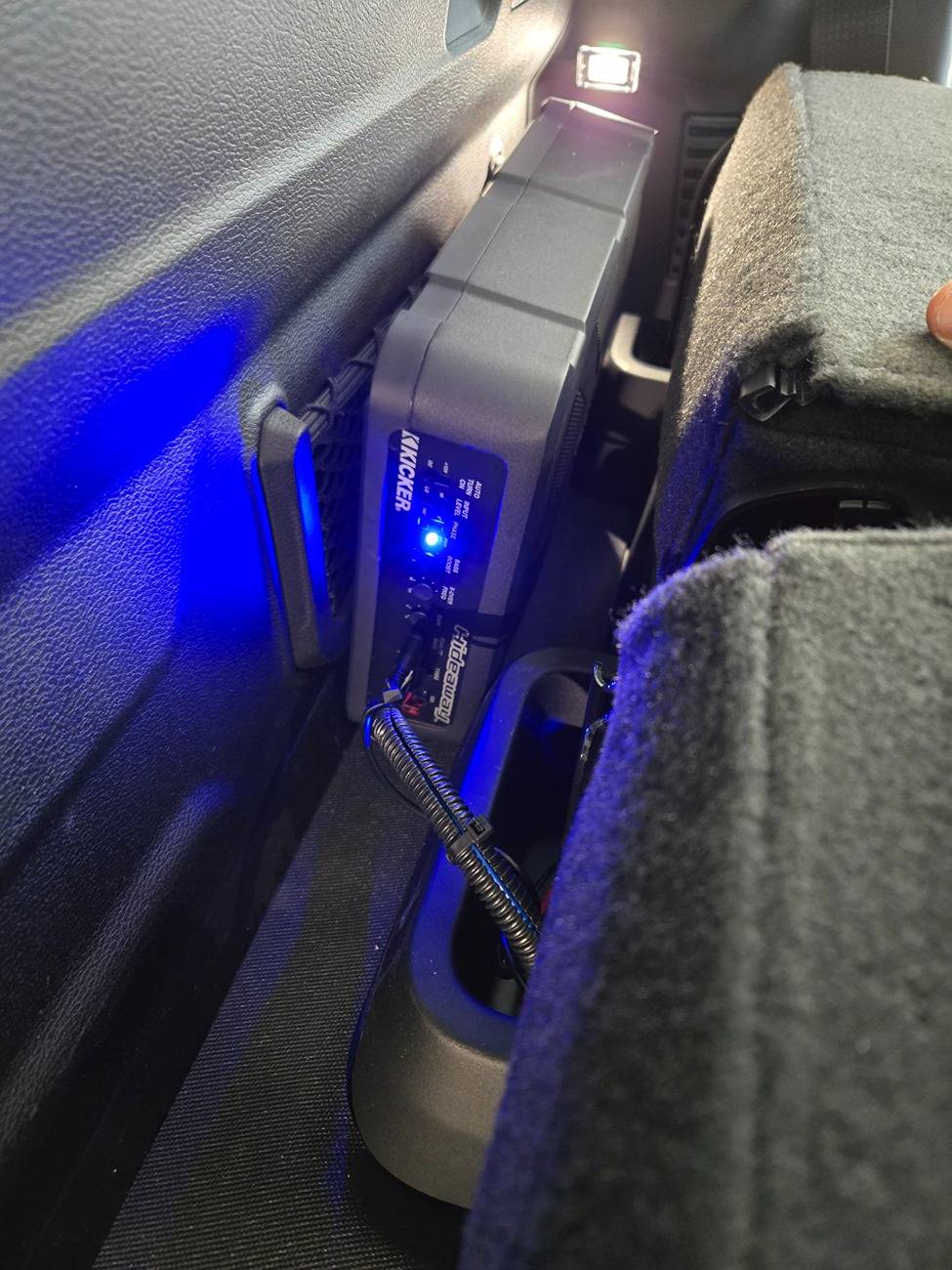

I have a 2025 . So, I have the 12.something inch head unit. What year is yours ? With a 2025 head unit, kickers ksc speakers, and the 8 inch kicker hideaway, it sounds great.

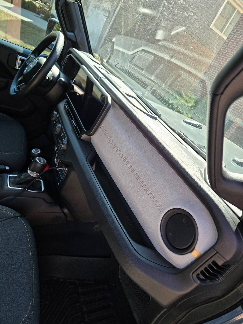

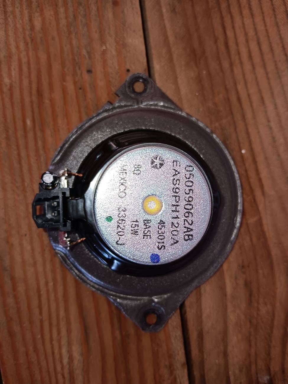

Here's another wrinkle. The stock 3.5" dash and roll bar speakers are actually 8ohm.
Weird, but again I've got no experience with the non-alpine system. Your head unit clipping due to lower impedance could explain your described drop in volume over time. Maybe the head unit is only rated for 8 ohm loads? I know the terra acoustics dash speakers are 7 ohm. I wonder if they did that to work with the base radio?

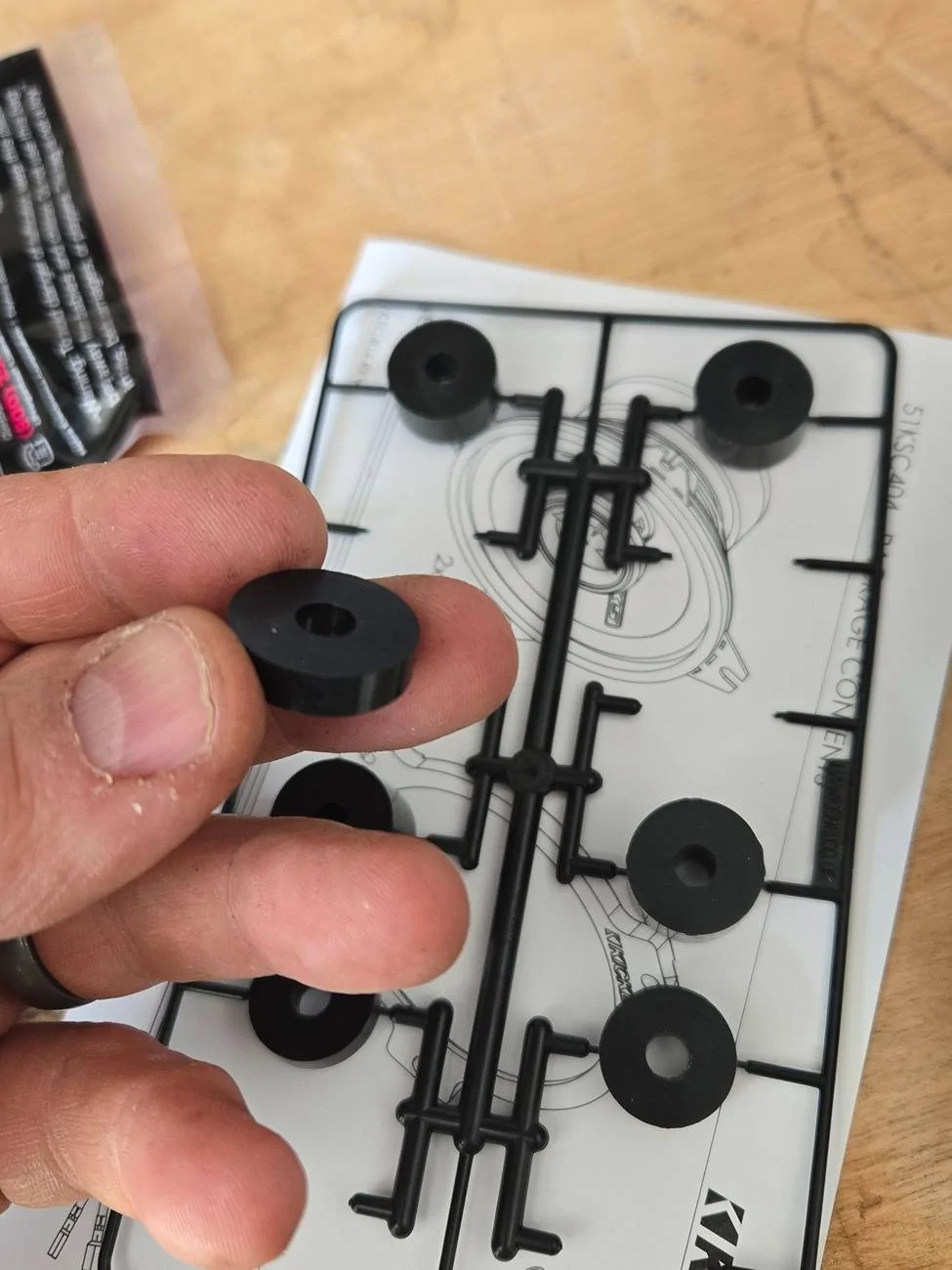

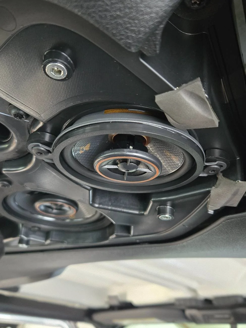

Old post but thanks to Mike, I followed his approach and to be honest, on a '24-'26 Gladiator, doing this improves the sound very well. Only difference is that I used some rubber washers from an external PC fan and worked like a charm
