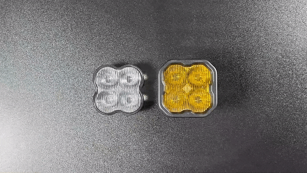

Begin by purchasing Sport/Pro Stage Series LED Pod in yellow with a separate white TIR optic.

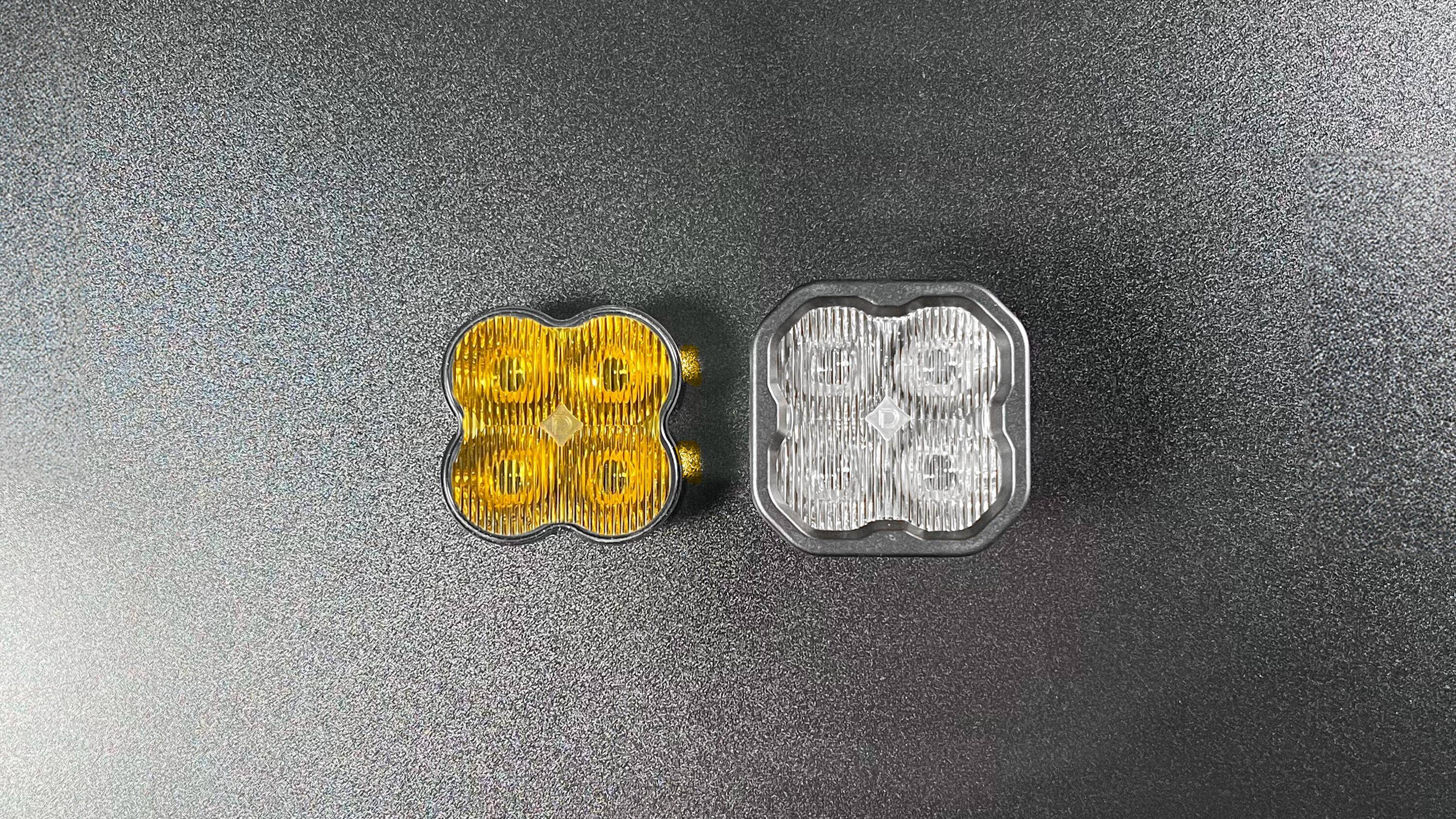

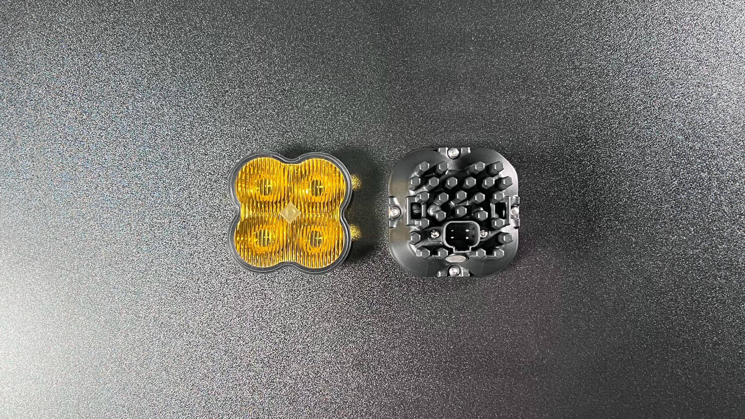

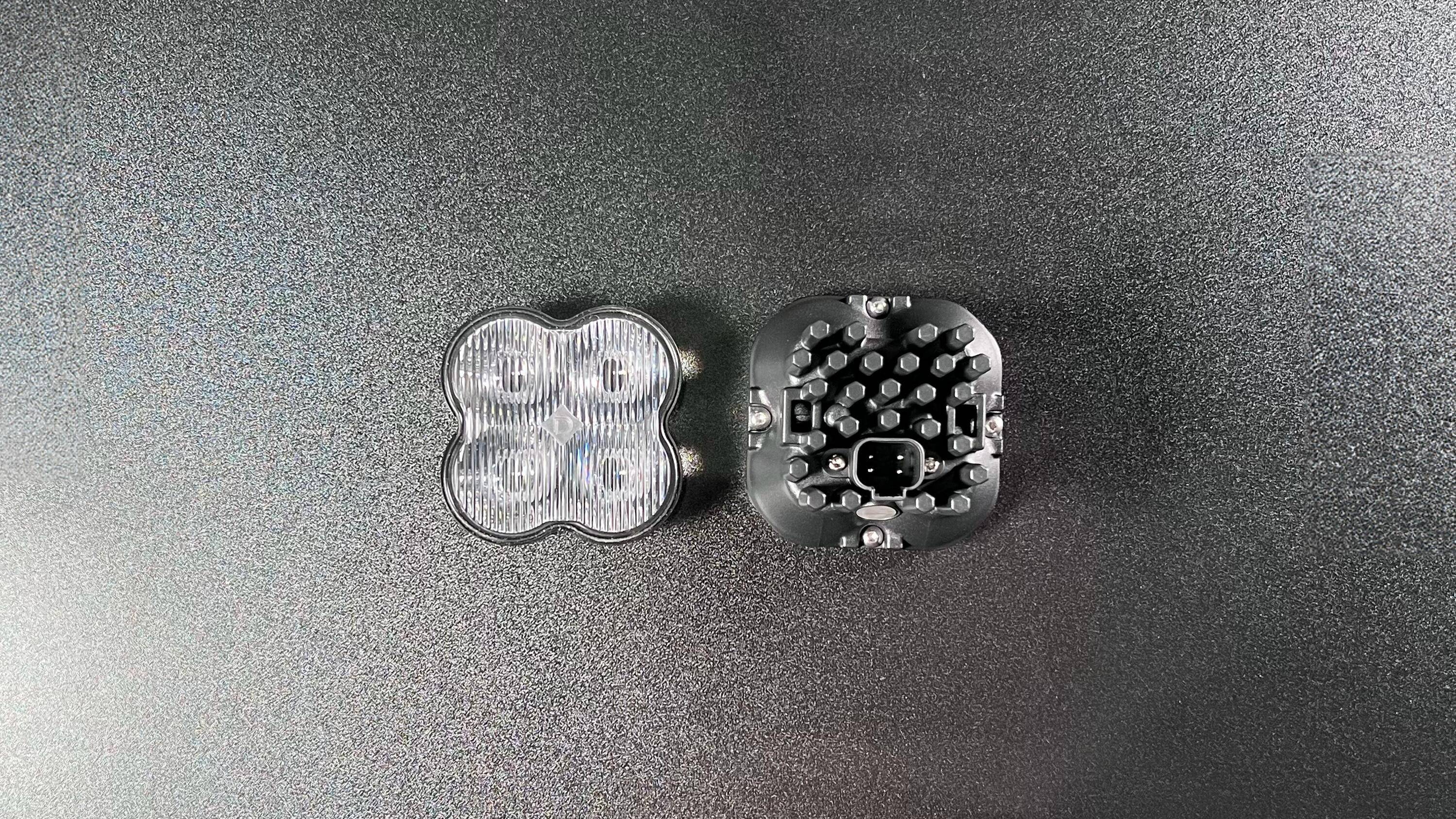

Flip your Stage Series LED Pod over and remove the hardware securing the bezel, TIR optic, and housing together.
Jeep Gladiator 4300K Warm White | Output Configuration | TIR Optic Swap | Diode Dynamics cxAbZQH

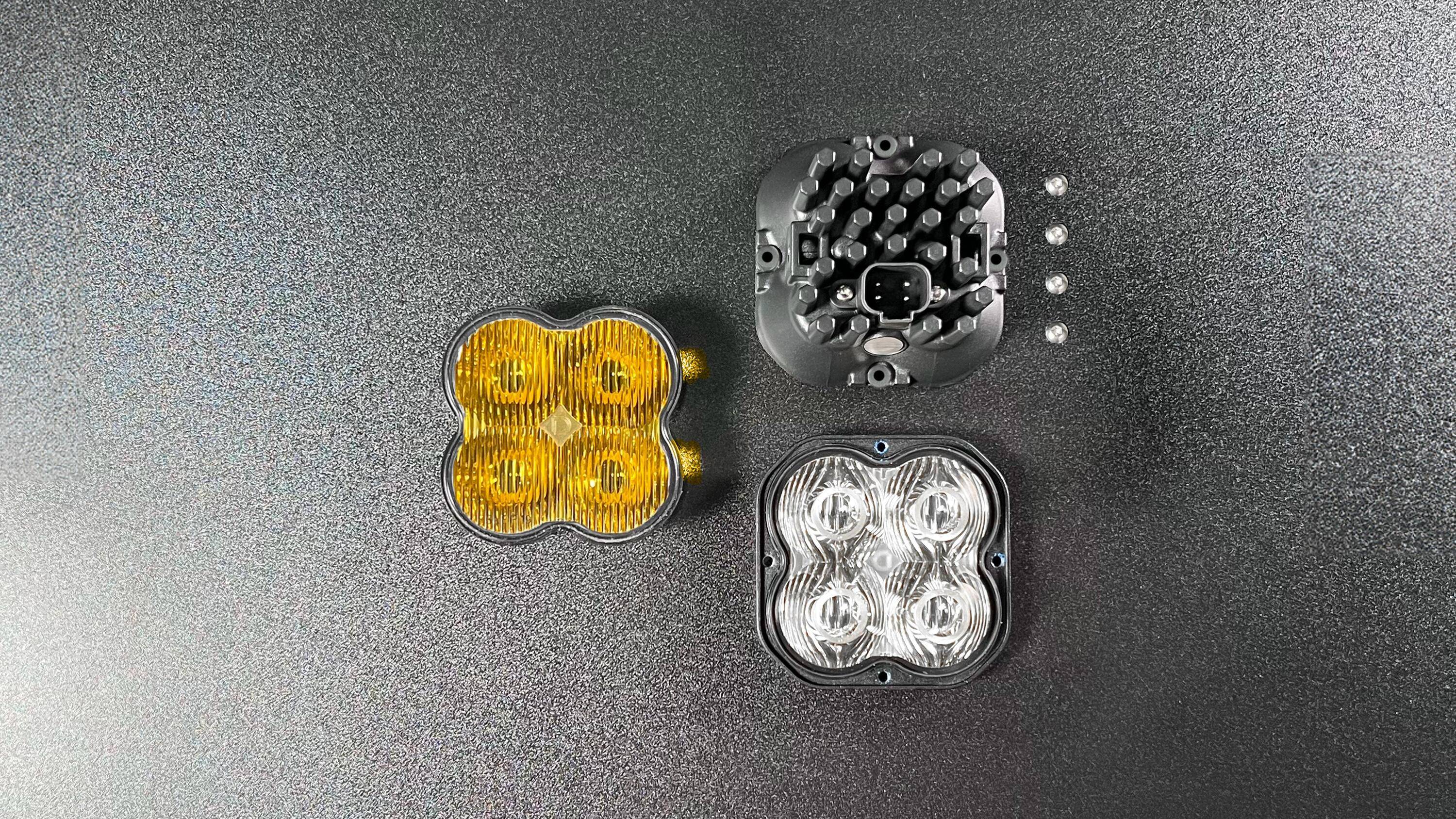

With your hardware removed, separate the housing from the TIR optic and front bezel.
Jeep Gladiator 4300K Warm White | Output Configuration | TIR Optic Swap | Diode Dynamics RsK8ODC

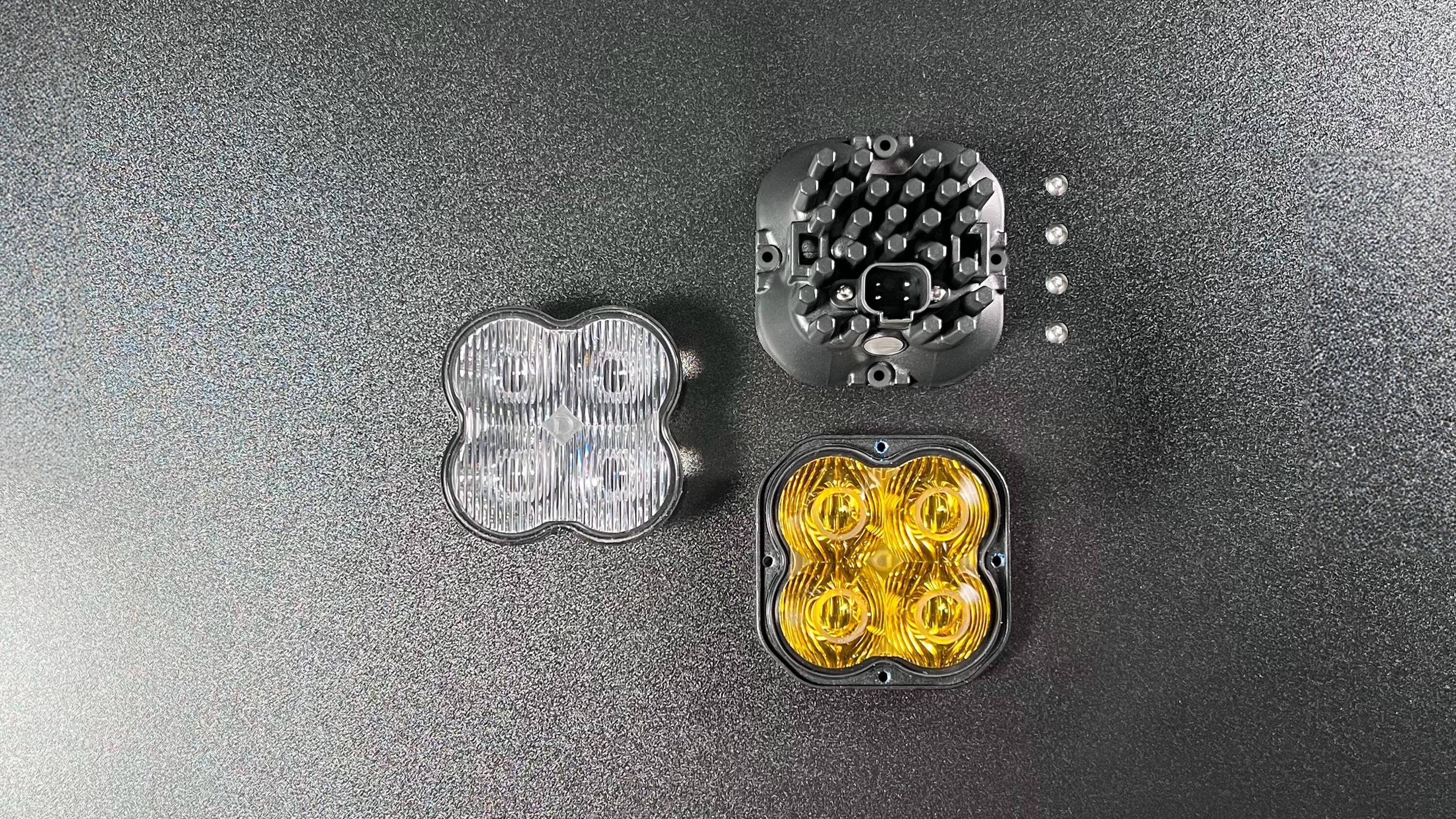

You can now swap the original yellow TIR optic and place a clear/white TIR optic in place.
Jeep Gladiator 4300K Warm White | Output Configuration | TIR Optic Swap | Diode Dynamics ZdcnJiY

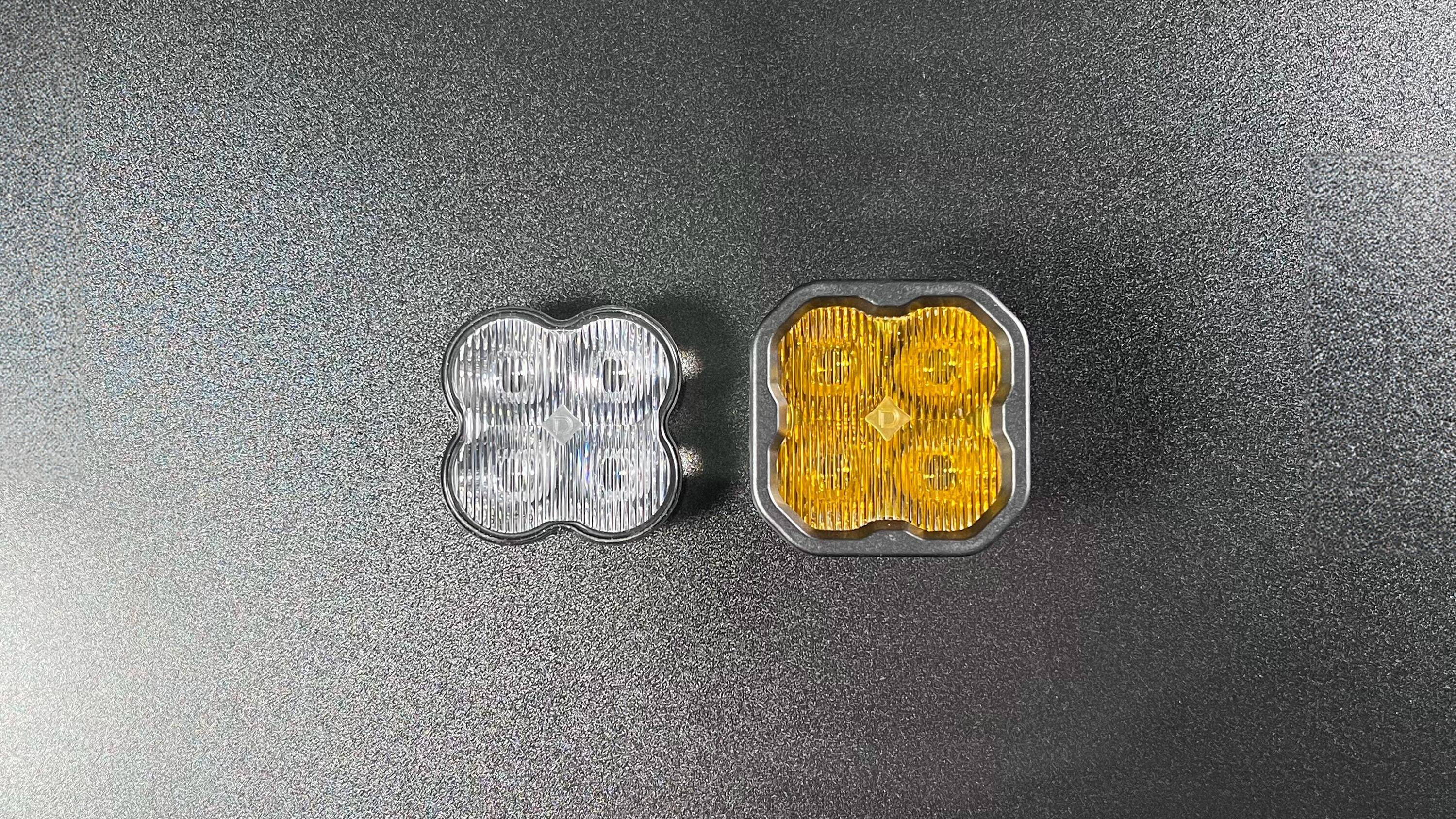

The housing can now be placed back over the TIR optic and front bezel and resecured using the hardware removed.
Jeep Gladiator 4300K Warm White | Output Configuration | TIR Optic Swap | Diode Dynamics bt4oLuM

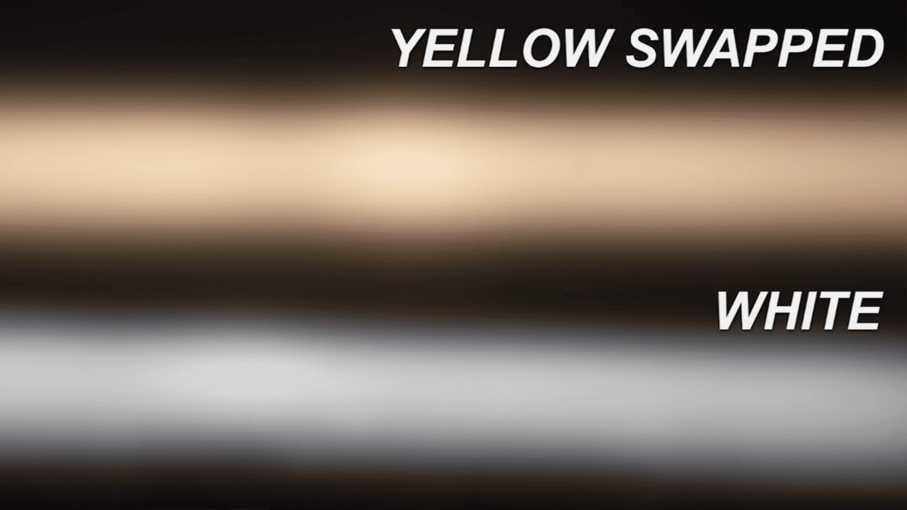

Now you've successfully swapped your Stage Series LED pod in yellow to a clear optic. This will allow for the original warm white LED chips behind the yellow lens to produce a 4300K warm white output through the clear TIR optic.

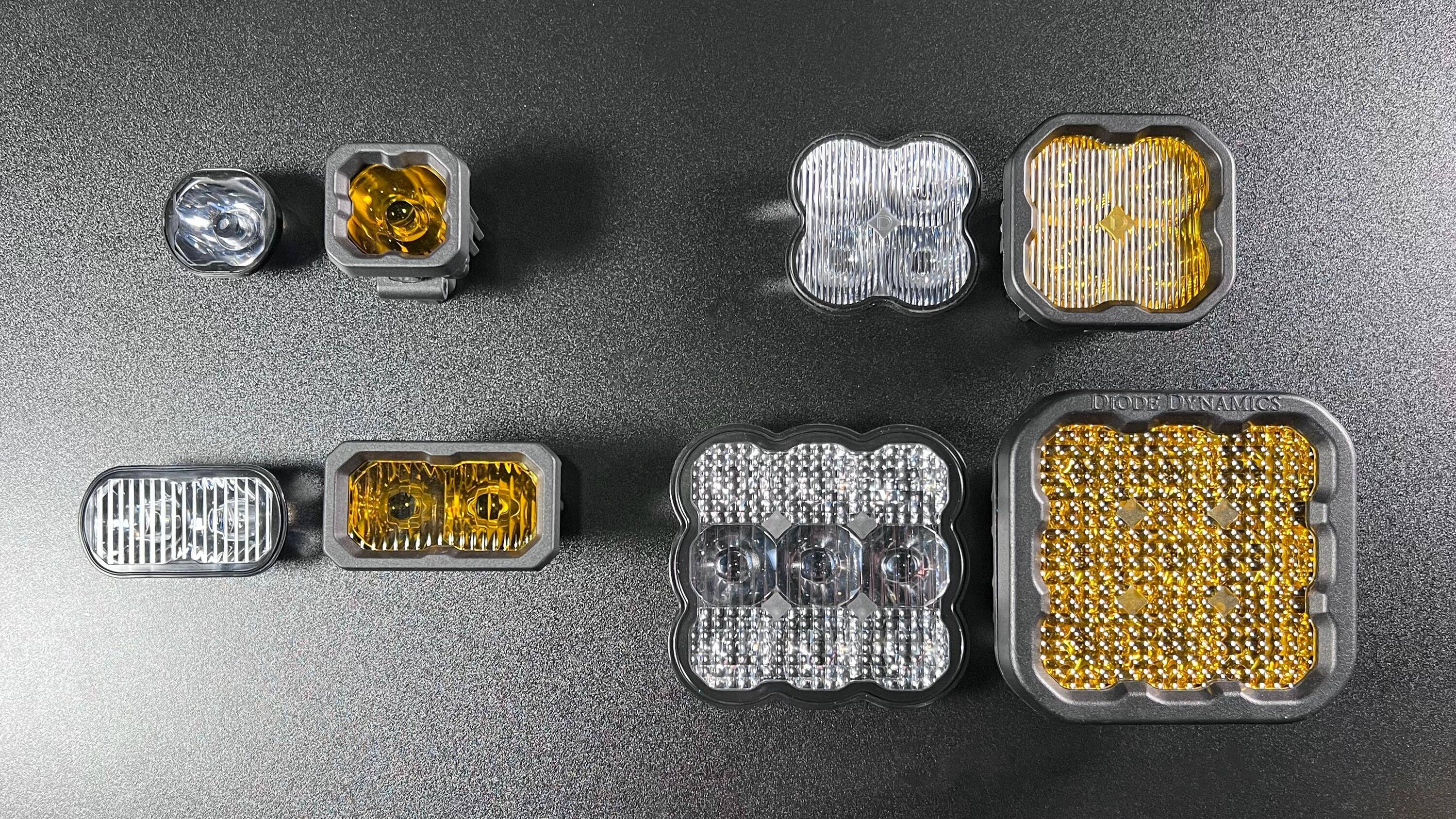

Additionally, our warm white output can be achieved with the following Sport/Pro LED Pods: SSC1, SSC2, SS3, and SS5!
To obtain a warmer white output, you'll need to purchase the following pods of your choice:
• SSC1 Yellow (Sport/Pro)
• SSC2 Yellow (Sport/Pro)
• SS3 Yellow (Sport/Pro)
• SS5 Yellow (Sport/Pro)
CLICK HERE TO SHOP STAGE SERIES LED PODS
Additional purchase required:
• SSC1 White/Clear TIR Optic
• SSC2 White/Clear TIR Optic
• SS3 White/Clear TIR Optic
• SS5 White/Clear TIR Optic
CLICK HERE TO SHOP TOTAL INTERNAL REFLECTION (TIR) OPTICS
Note: This configuration is NOT available for the SSC1 SAE-Fog or SS3 Max LED pods. This is ONLY an option for Stage Series pods in Sport/Pro power levels.
