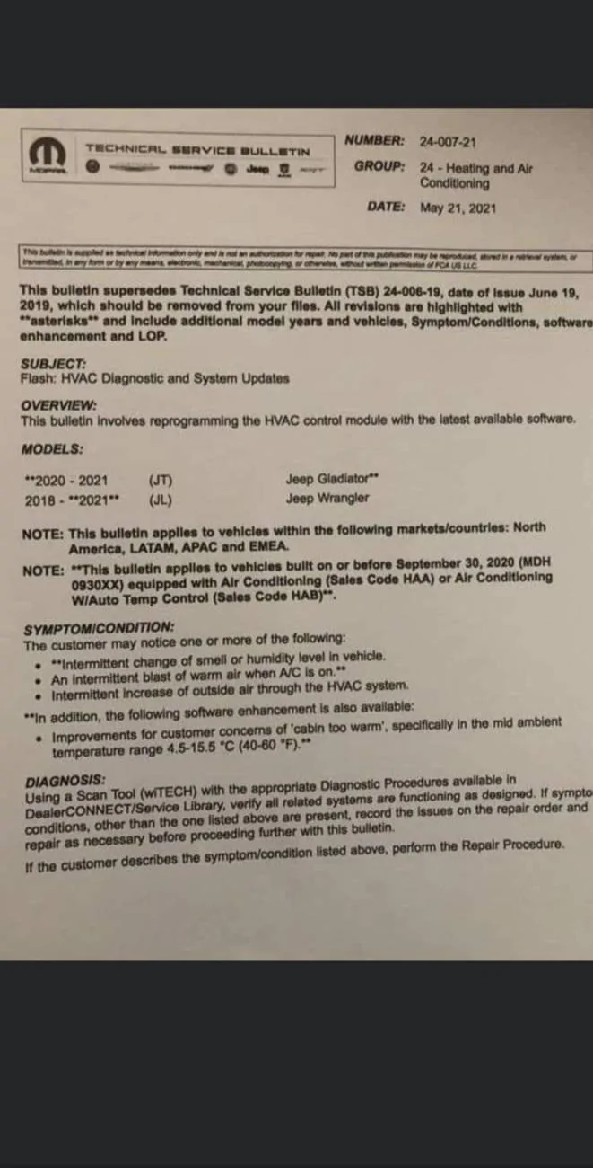

Above is the best bet, but I recall a tsb for the hvac system on early gladiators that was a firmware update ... there was at least 1 thread on it here ... can't remember the details but it would be worth a look
