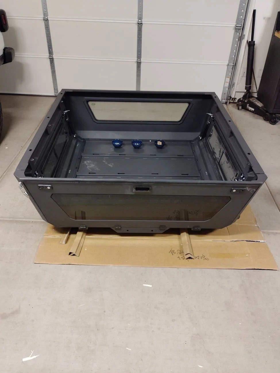

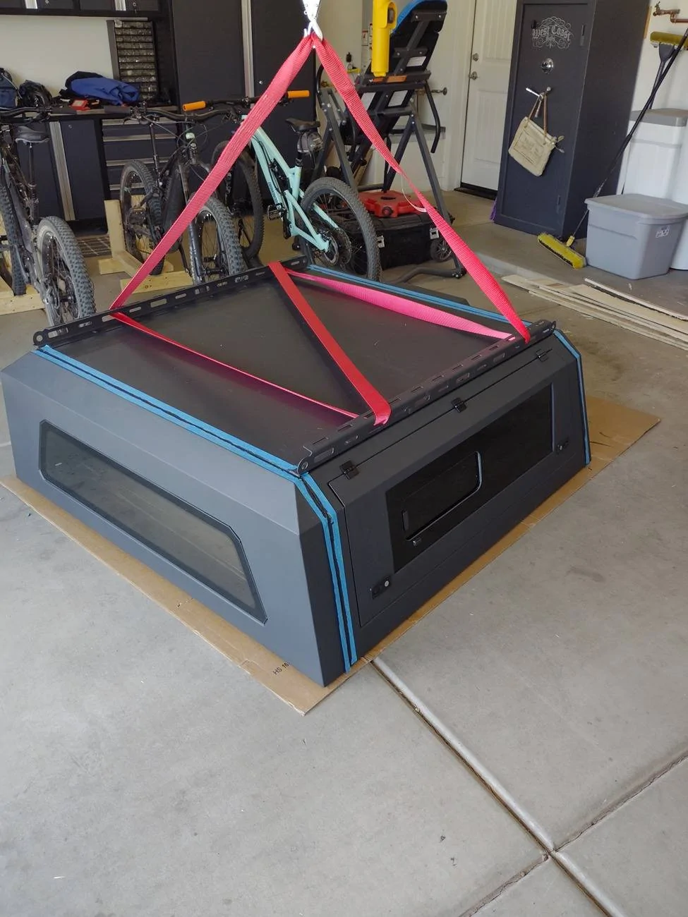

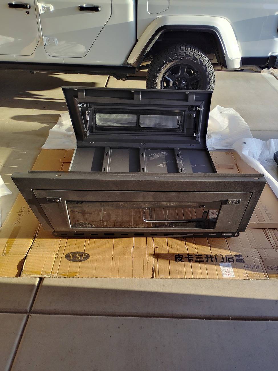

I just put mine together and I agree, especially the rear door. It looked like you added something to the seams and had it taped off with painters tape. What did you use and would you recommend?
MTB58
Marty
Mar 16, 2024
119
298
Prescott, AZ
2023 Sport S Max Tow
Sales Mgmt
I used the silcone supplied by the manufacturer, probably some sort of loctite 598 copy. yes, I did use painters tape to keep it clean.
Oh, mine just had a rubber gasket. Maybe I'll add a bead on top of it.

As long as the rubber gasket seals, I would not bother with the silicone. My topper did not come with a seal just the silicone.

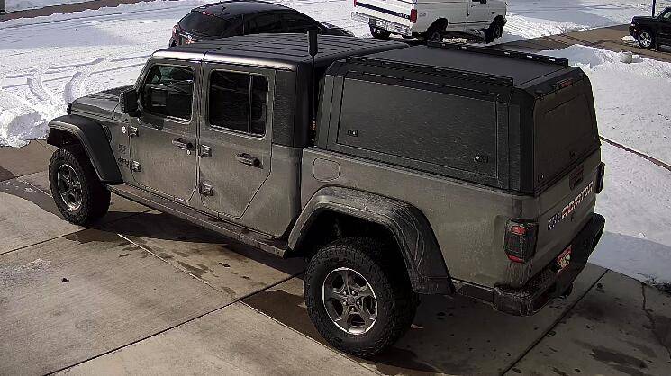

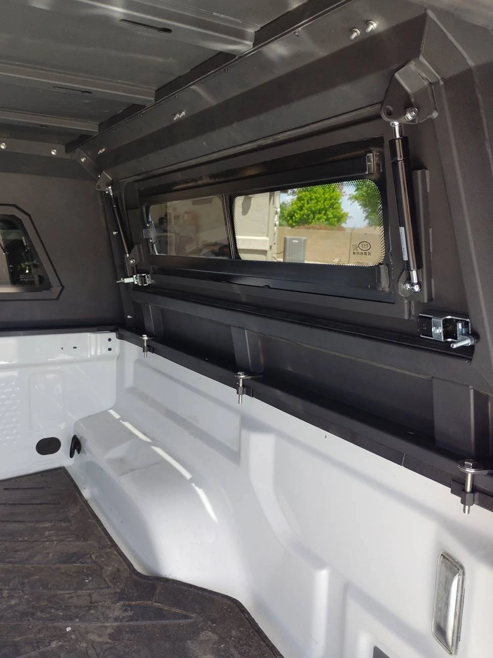

Does anyone have a solution to get the gull doors to open higher? Especially the rear? I have 37s and a 4" lift and I STILL hit my head on rear door. 🤞
Mateo Bobcat
Feb 10, 2026
39
42
Ohio
2023 Gladiator Mojave (Rita)

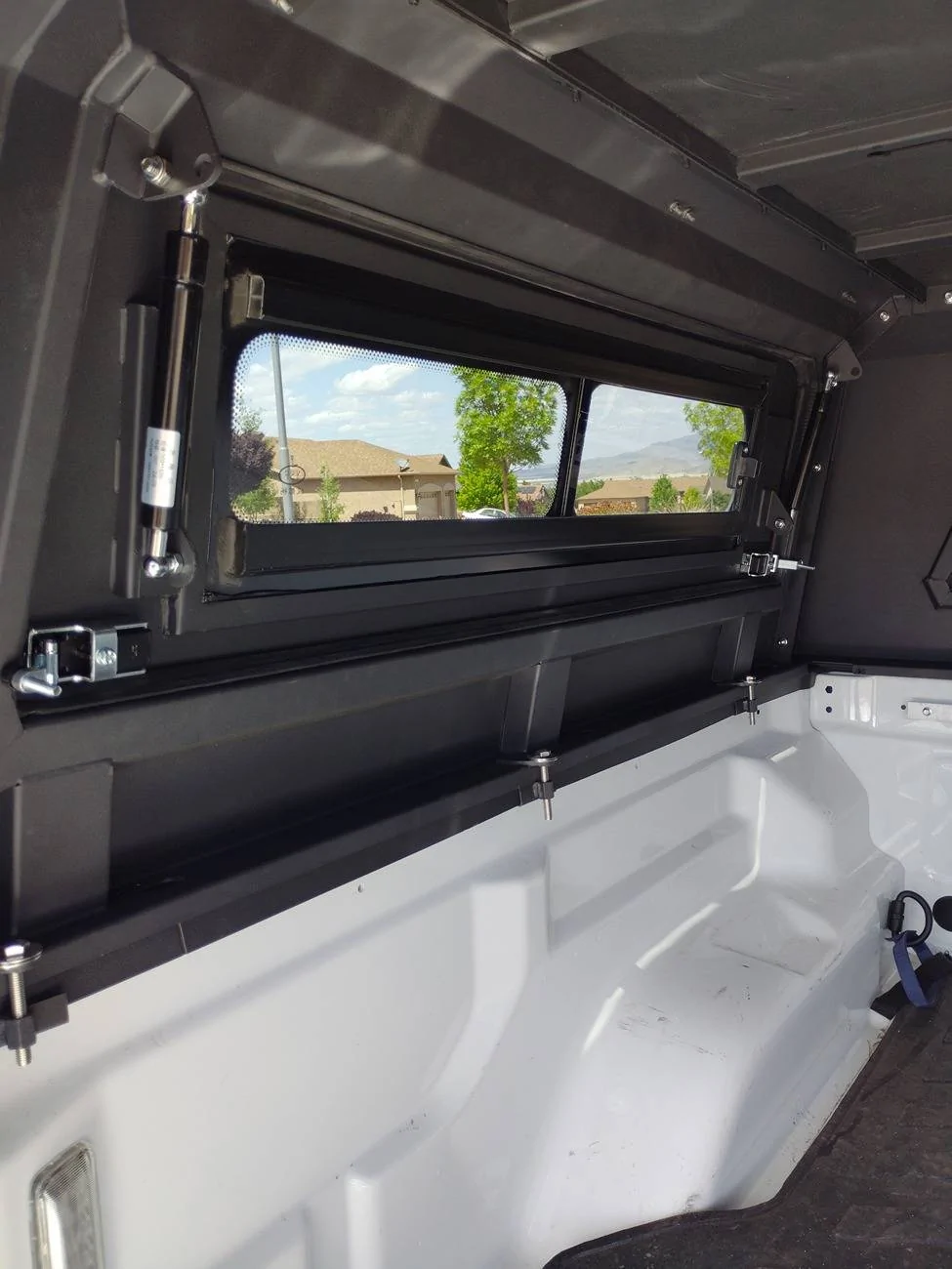

Ok, I answered my own question AND it turns out, my wife was right. Two inches makes a big difference. 🤣.
If anyone else is having problems, These struts worked on my Alibaba cap. They open to 14" and close at about 9" and had 40 lbs load limit. The old ones were about 45 lbs, open at 12" and closed at less than 9".
https://a.co/d/0bQvmt76
I also had to get some 10mm ball studs. Link.
https://a.co/d/09cCpcQw
This is a better strut IMO because they are snap in. The Alibaba struts had the ball stud built in.
Before and after pics.
