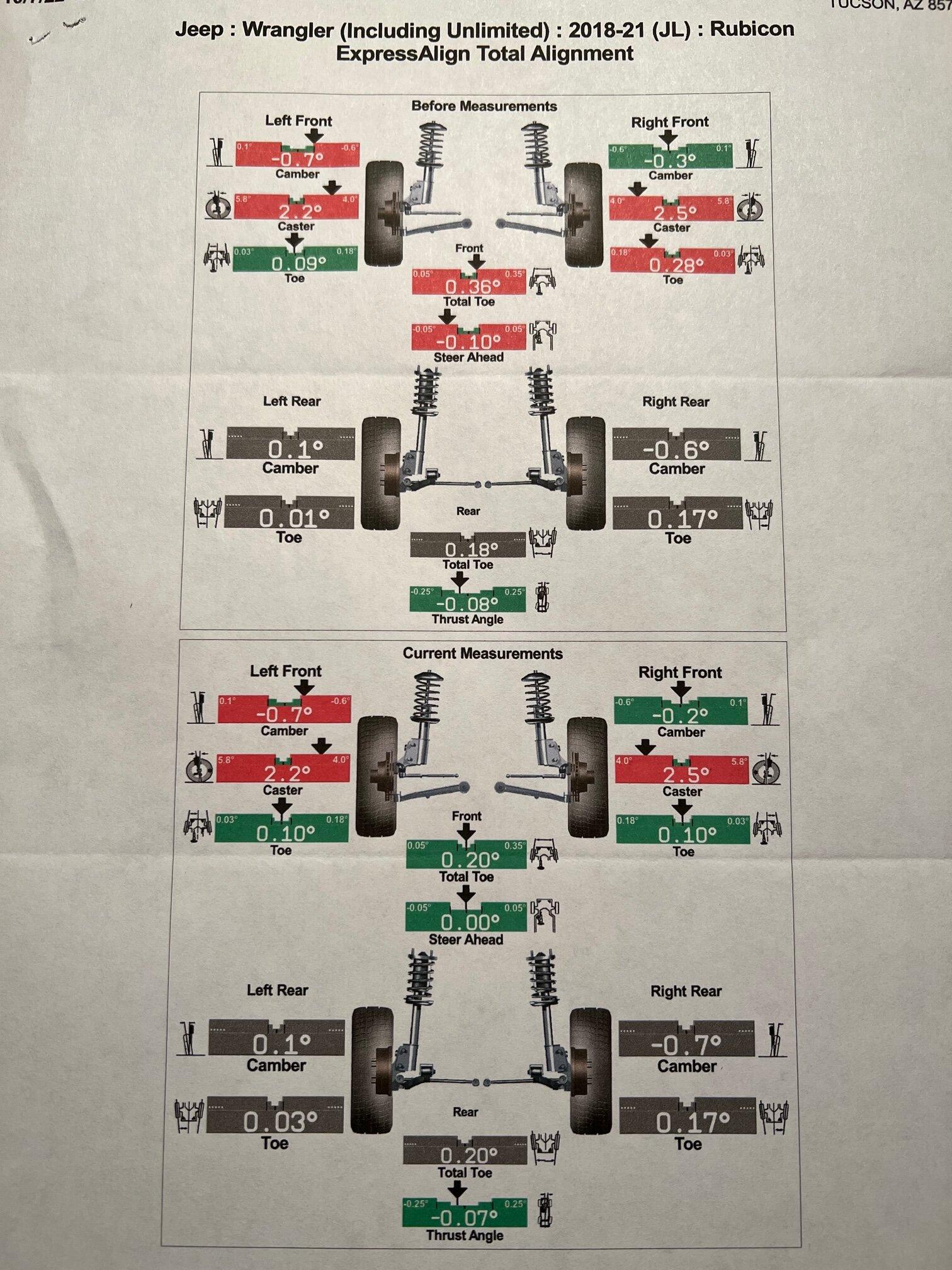

Had 4WP install a Clayton 2.5" Ride Right (upper LCAs only) a couple of weeks back. Took a 600mi roadtrip so I'm heading back to 4WP for some bolt tightening and what not.
I was looking for opinions on the below alignment specs. I told them the caster is way too low and I'm not sure why their machine stated 2018-2021 JL Rubicon if that even matters. JTR tracks well outside a slight pull to the left which may be from the 2020 steering box TSB which I have yet to get done.
Thoughts?

Holy cow that’s way too low. Need like 5.5-6.5 caster

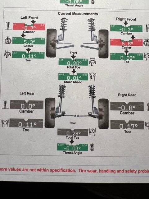

forgot to upload my new alingment specs. Tracks really well, but I've recently got a case of Death Wobble. Checked all torque settings across the entire front end. Nothing out of spec. Next step is to look at steering deflection thought I do have a steel steering box.
Thoughts.
