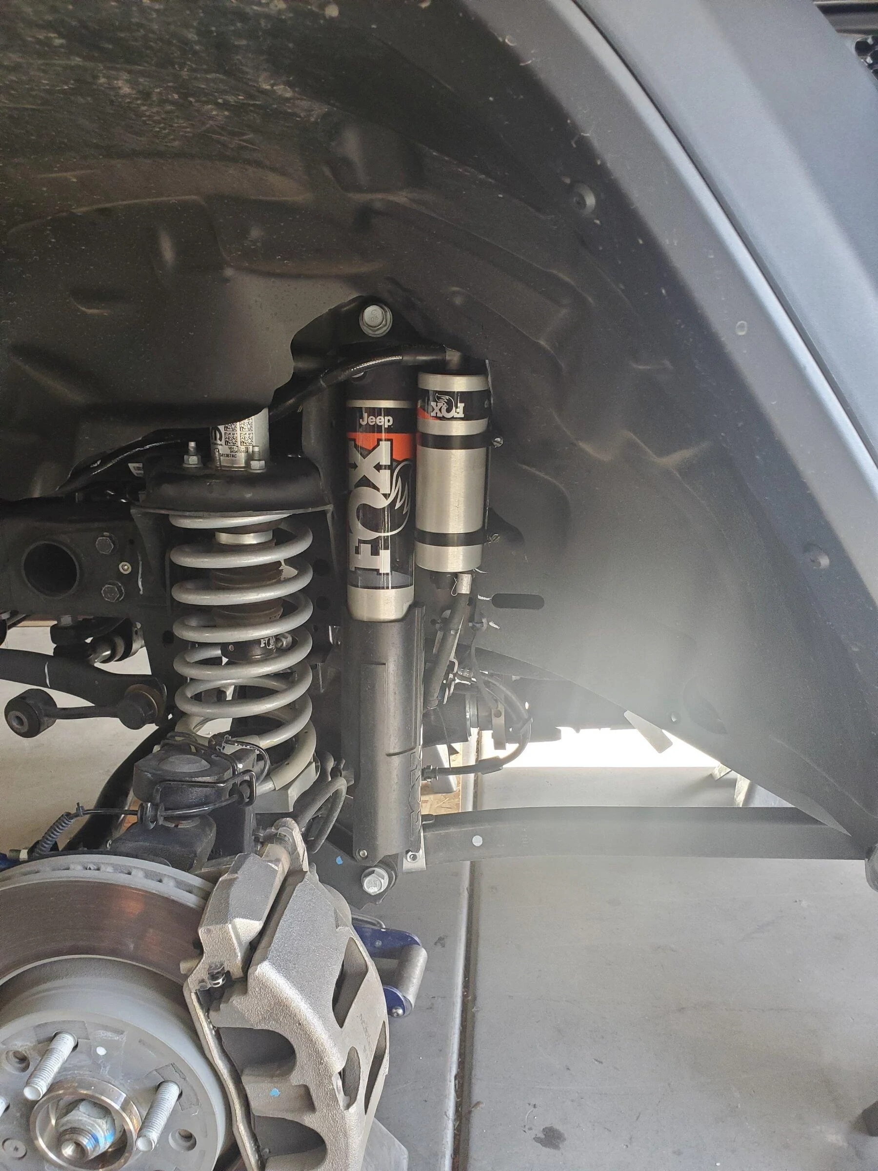

I am very undecided on the Anti-Rock versus the Apex AutoLynx.
I love the idea of the Anti Rock in that I would never to have to deal with disconnecting anything. Worried it might be TOO soft on road though….
The AutoLynx are great because they are so simple (and $150+ cheaper)
Has anybody installed an Anti-Rock on a Mojave? If so, mind showing where you moved your reservoirs where moved yo?

I went with the Aries bumper and couldn't use the stock skid, so I relocated the reservoirs next to the shock with a bracket.
Jeep Gladiator Anti Rock on Mojave - where did you relocate reservoirs? Shock Pic 1
