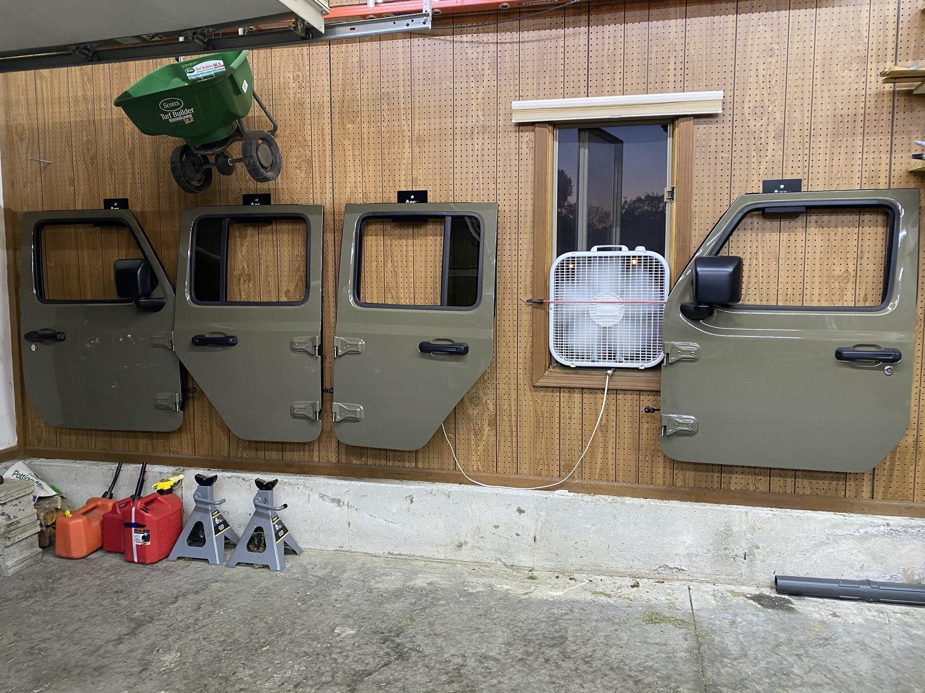

Gave it a shot tonight at mounting my Arc off road door hangers, as you can see from the pictures... it didn’t turn out amazing. They are hung but the spacing between the doors is super tight and I am afraid I am going to end up scratching them up. Does anyone out there have the magic pattern and spacing that works nicely?

Well you’re in a bit of a jam since you’re not stacking them one mounted higher up on the wall. Hard to tell from the pic but it looks like you may not have 9+ feet of ceiling height. Mounting them 4 across takes up a lot of space especially when you need to hit a stud. You are somewhat limited where you put them. The window further dictates spacing. I suppose you could mount a 6-8 ft 2x6 horizontally screwing it into the studs and then mount the hangers into the 2x6 where you need them to achieve a better fit.
