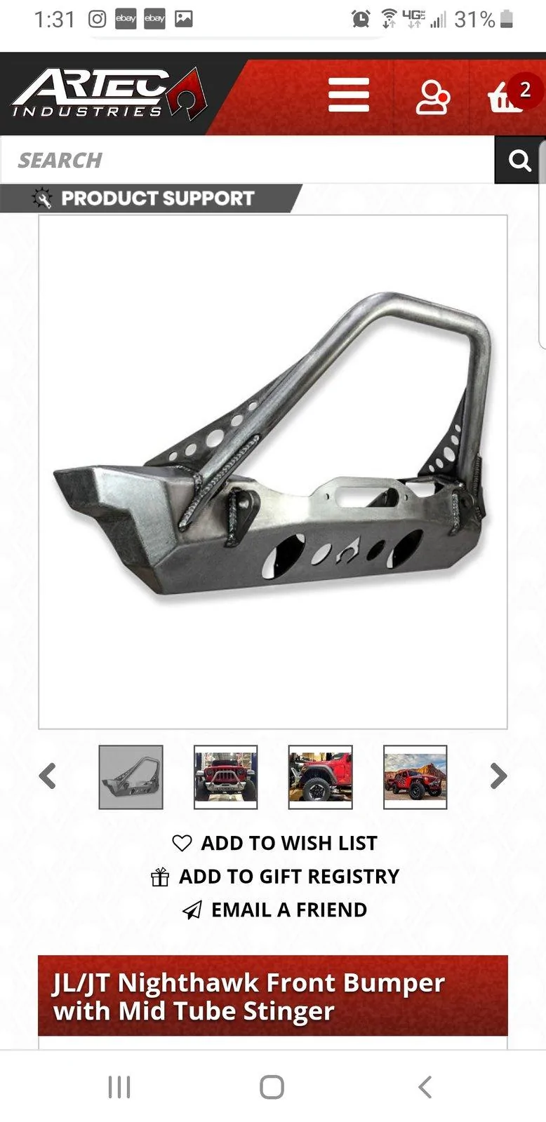

Anyone run one of these?
Any frame cutting involved?
What are you doing for fog lights?
I wasn't planning on buying one now but they are running a 20% off sale until the end of the month.

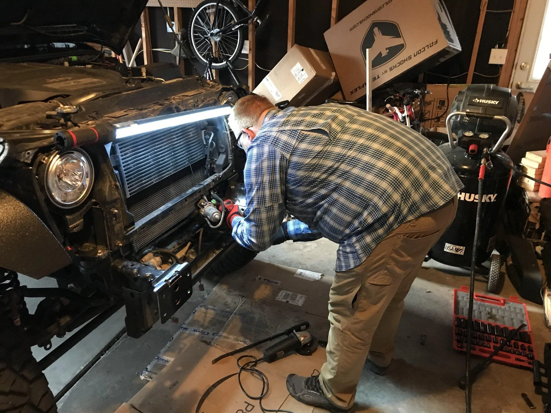

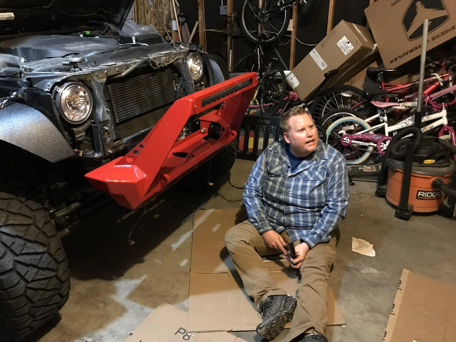

My buddy got one for his JKU. That bumper is stout. We had to cut a flange off the frame on the drivers inside where the winch plate went on. Also the frame horns needed a diagonal cut because the stuck they stuck out into the winch plate area(no pictures of that attached m, I’ll get my buddy to snap a few to show)
as for pictures you can see my friend cutting that spot.
For fogs he picked up some led replacements that had a anti flicker built in.
I hope it’s different for the JT/JL
PS: it turned into a 4-6 hour job to get done. I will recommend 2 people at least and we had 3 due to we had to take the bumper on and off to make the cuts/grinding.
