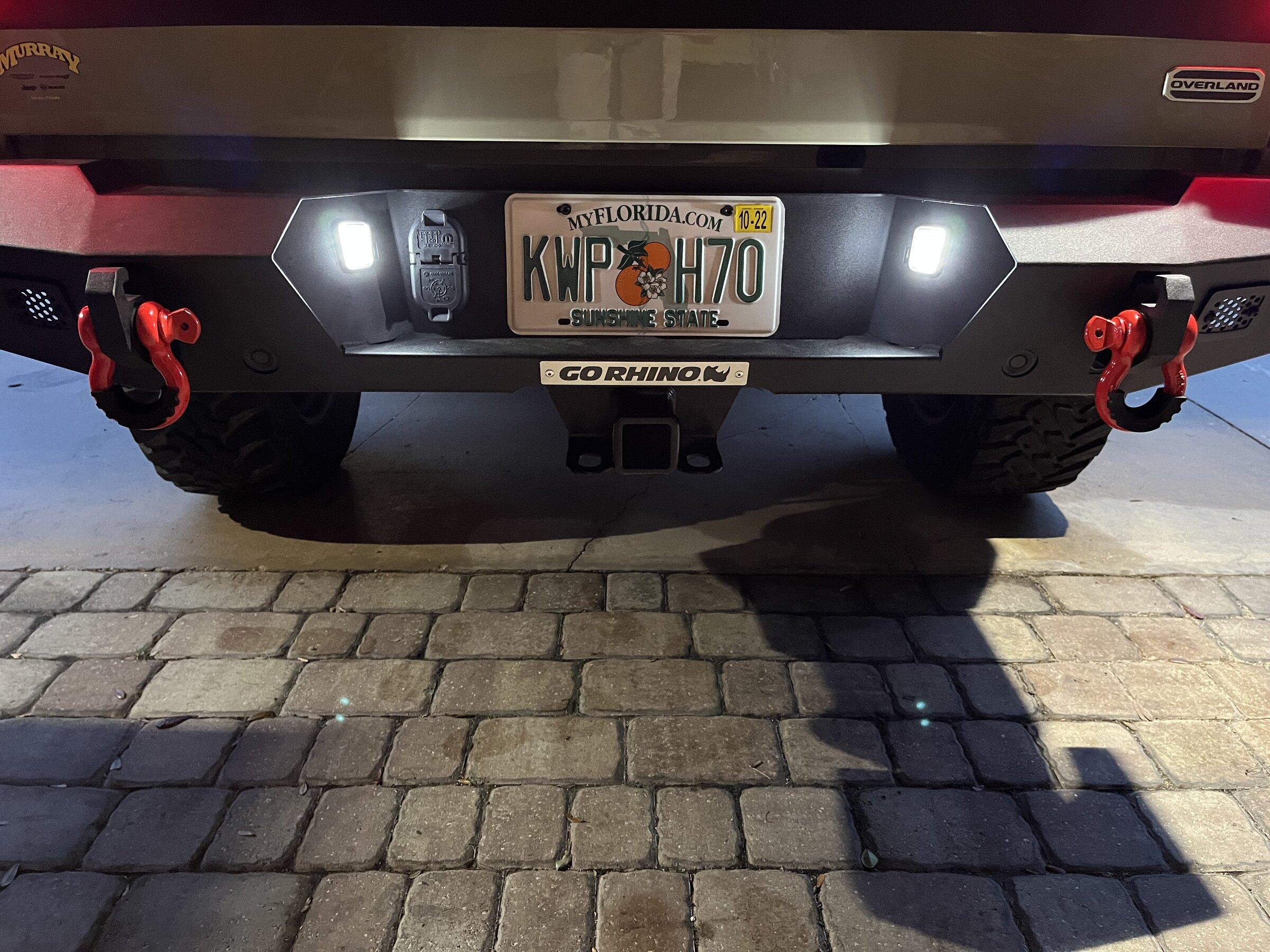

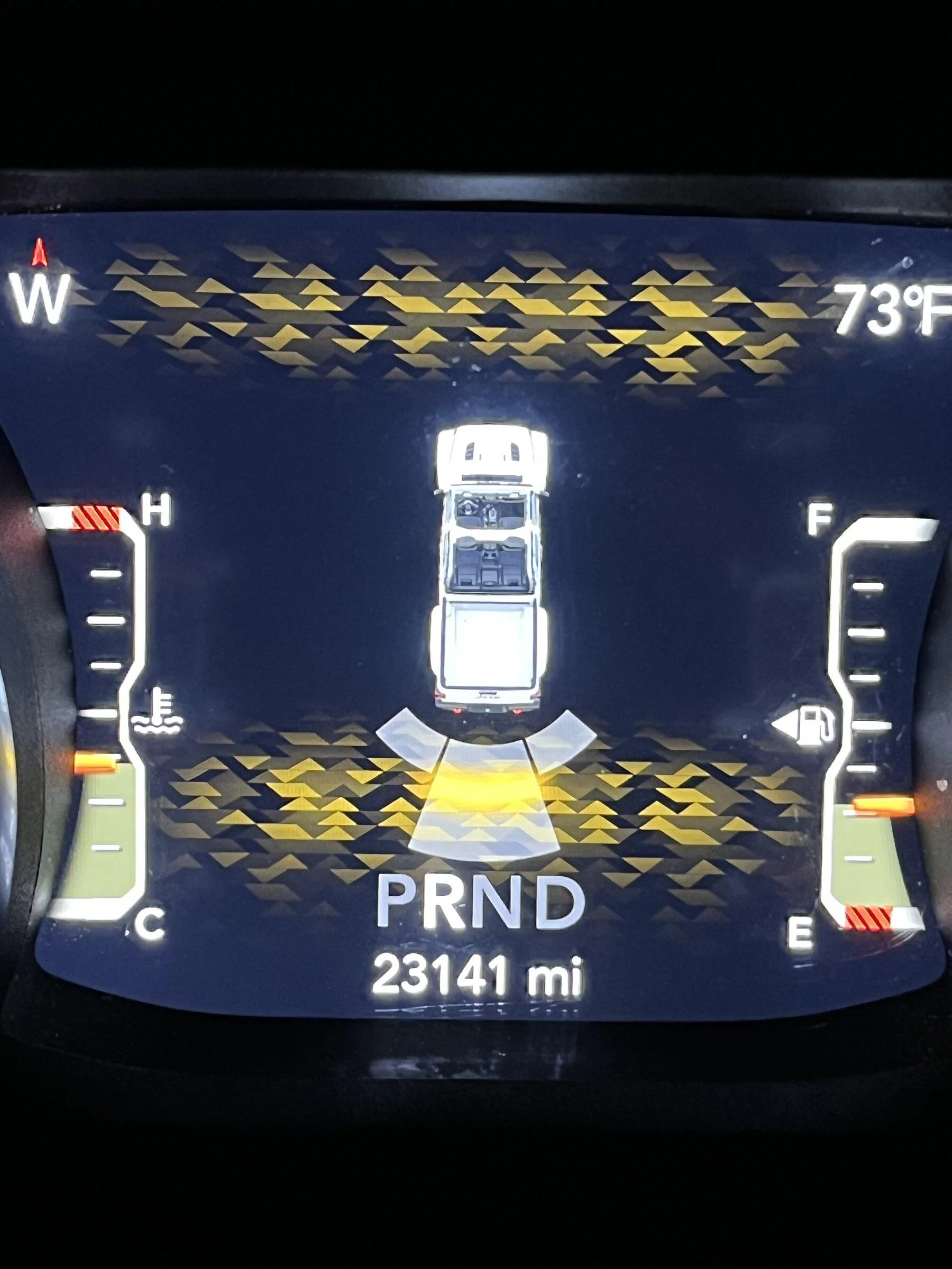

I’ve installed sensors into my new aftermarket bumper and now I’m trying to figure out what’s triggering the sensors in the center. I’ve taken the red hooks off and they still were being triggered. If anybody else has had this problem please let me know for what you have done to fix it. My guess is that they are picking up the black brackets coming out? The truck is a 2020 overland and I’ve installed a go rhino rear bumper. Thanks to anyone that could help.

Check the JL threads…..there are no great fixes for this. You’re going to need to rotate them until you get it right….that is problematic, so find a way to index them correctly so you can get back to where you started. Most aftermarket rear bumpers do t have the same angles as the factory bumper sensor angles. I wish that was better help.
