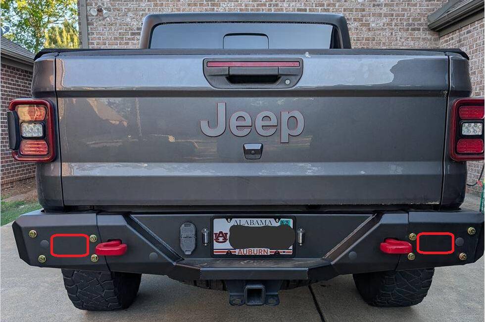

Cut holes in the bumper and mount surface mount offroad lights in the areas outlined in red. (Unless that's where the frame rails are.) If the frame rails are in those locations, get rid of those terrible stock tow hooks and put them there.
Thanks for the reply. I thought about removing the hooks, but I kind of like them. There are brackets that could work, so maybe if I get desperate enough I might try that. I do not want to remove the bumper again if I can help it, it was kind of a pain to install.

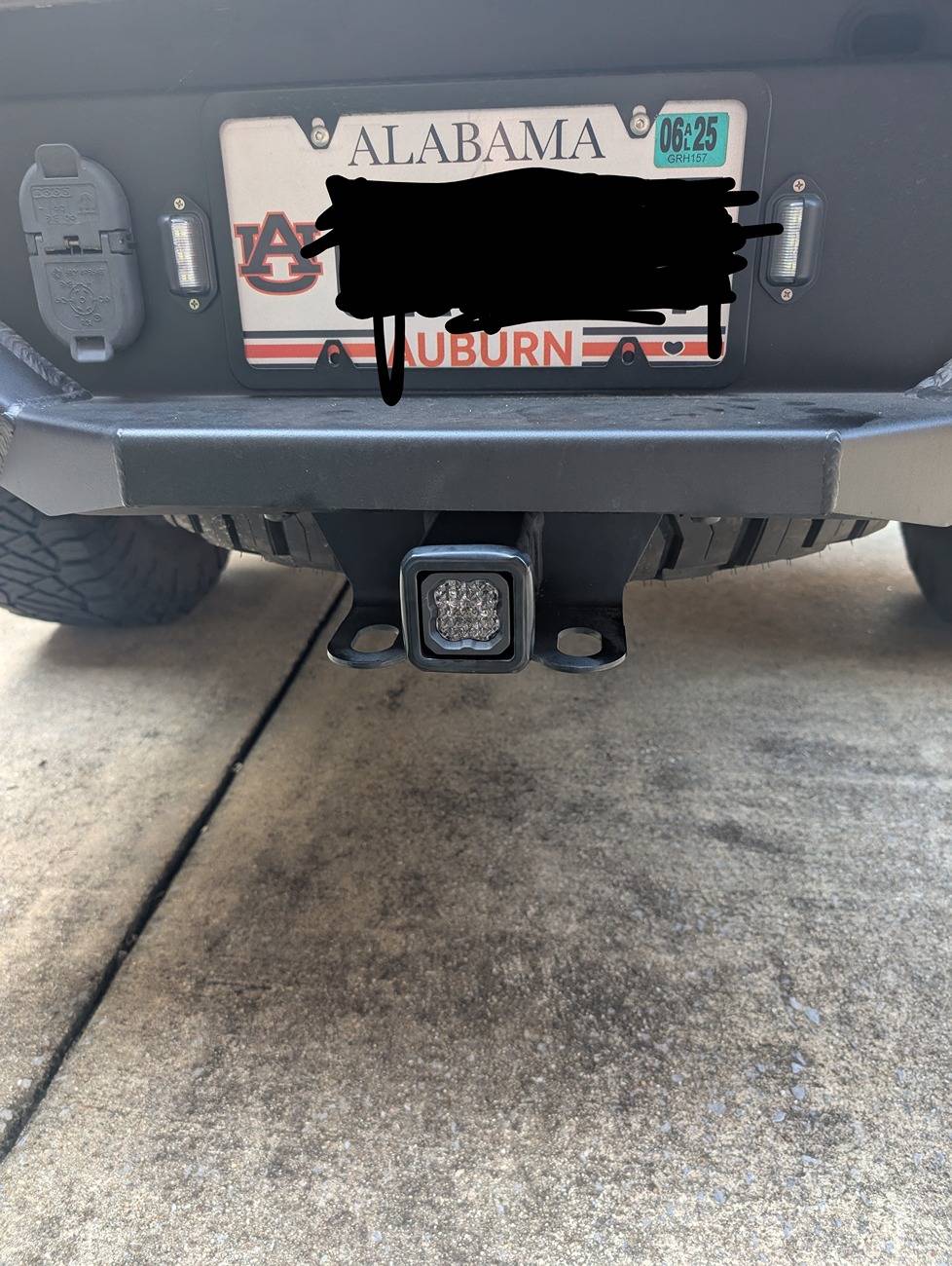

Thanks for all the suggestions everyone. After some searching and not finding any brackets I had decided to make my own. Starting with a 3D print then looking for someone to cut me out the brackets but I think I found a better option.
Ended up going with the C1R + Brake Hitch Mount light from Diode Dynamics https://www.diodedynamics.com/hitchmount-led-pod-reverse-kit.html
Took maybe 5 minutes to install. Hopefully it's a good replacement, though I doubt it will be as bright as the Oracle lights I had prior.
