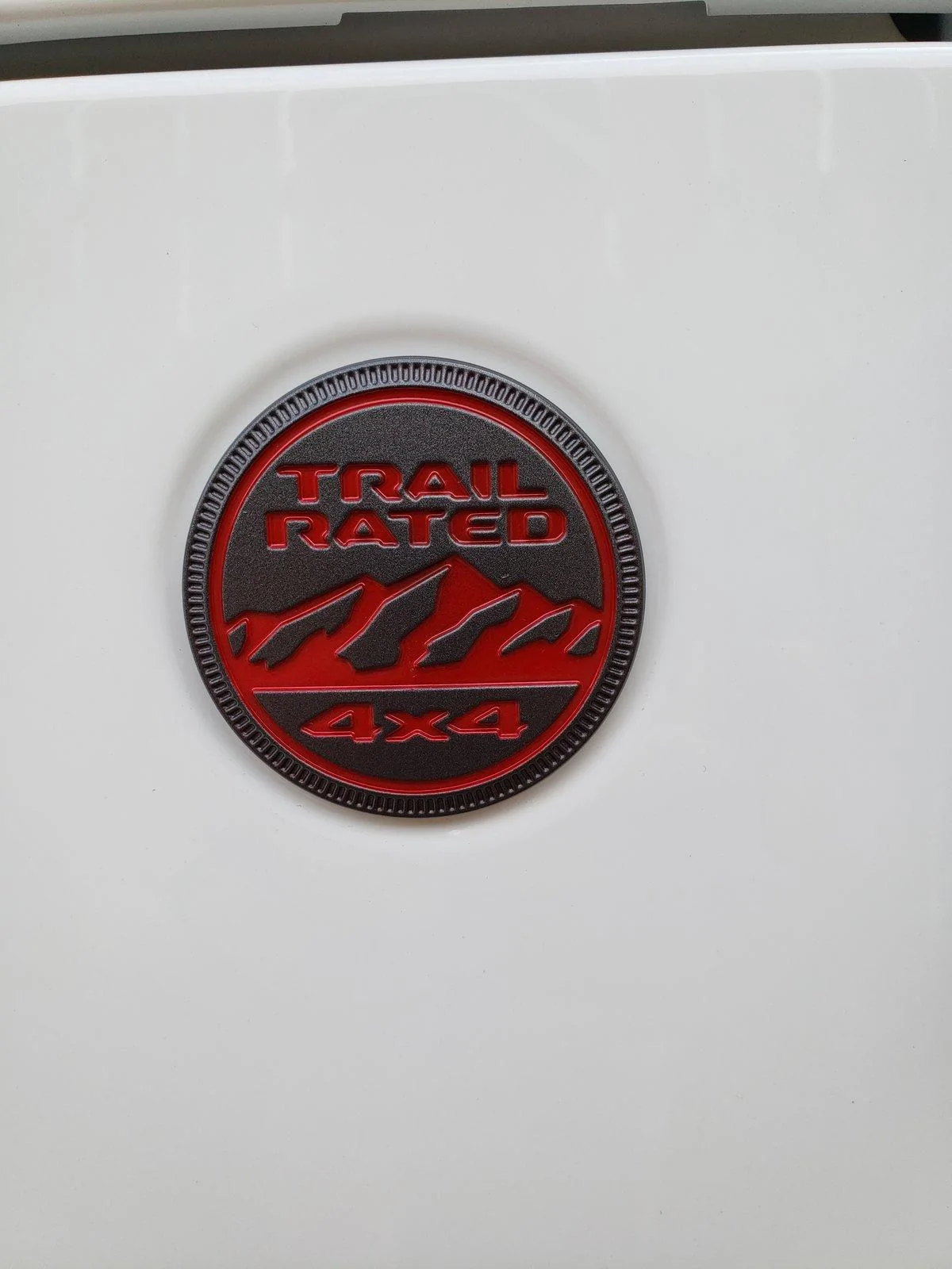

Does anyone know if this badge is only "glued" to the body, or is fastened in another fashion?
Thanks

On the videos I’ve seen, it seems to help when you add a little heat, ie a hair dryer or heat gun. Keep it moving or you could damage the paint. I’ve used dental floss to get behind and remove the badge. I would try the dental floss first. If it will not go through try a little heat.

I swapped the same red/gray Rubicon-themed trail-rated badge for black. It took less time to swap the Jeep letters on the tailgate!. I recommend fishing line, I used 50lb test and still snapped it a few times. There is a tab that fits into a hole in the body of the truck about 1/4 way down from the top.
