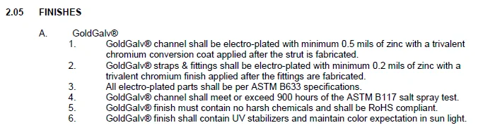

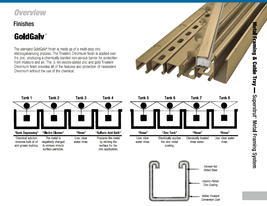

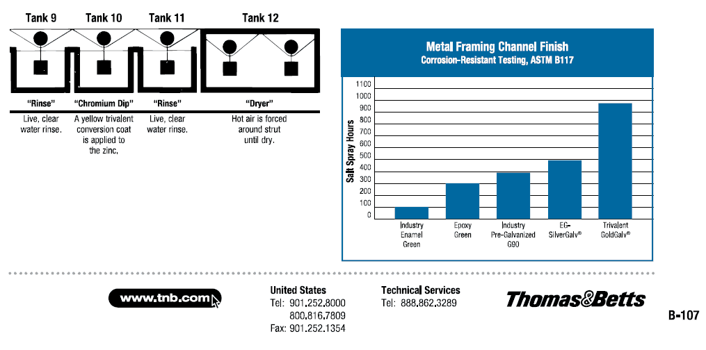

You cannot anodize steel. It is gold colored zinc plating. Here's the coating spec straight from the PDF on the site.
I recognize this comes across as pedantic. But galvanize = coat with another material - like zinc. Anodize = form a protective oxide layer with crystals made of the substate (usually aluminum).
So these struts are not "hot dip galvanized" which is probably what you're thinking of. But they are electro-plated with zinc, which is also galvanizing.
