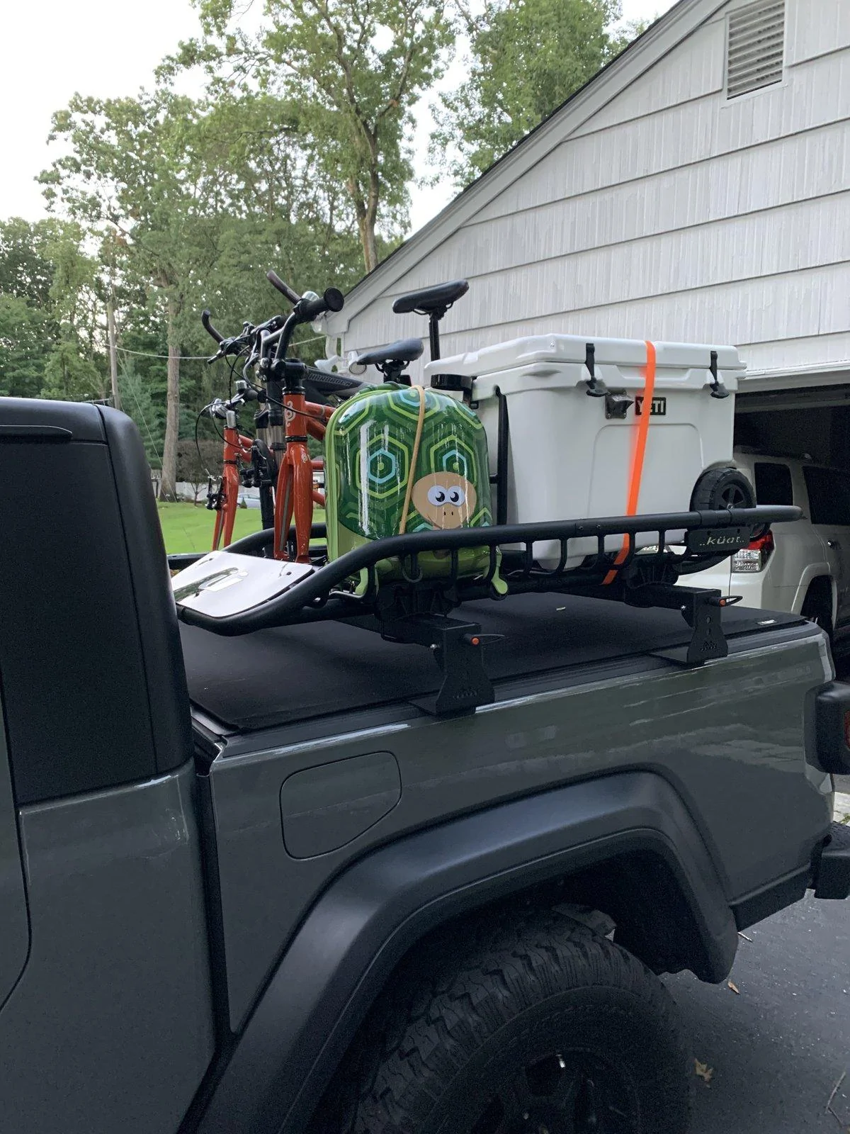

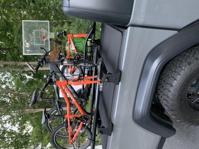

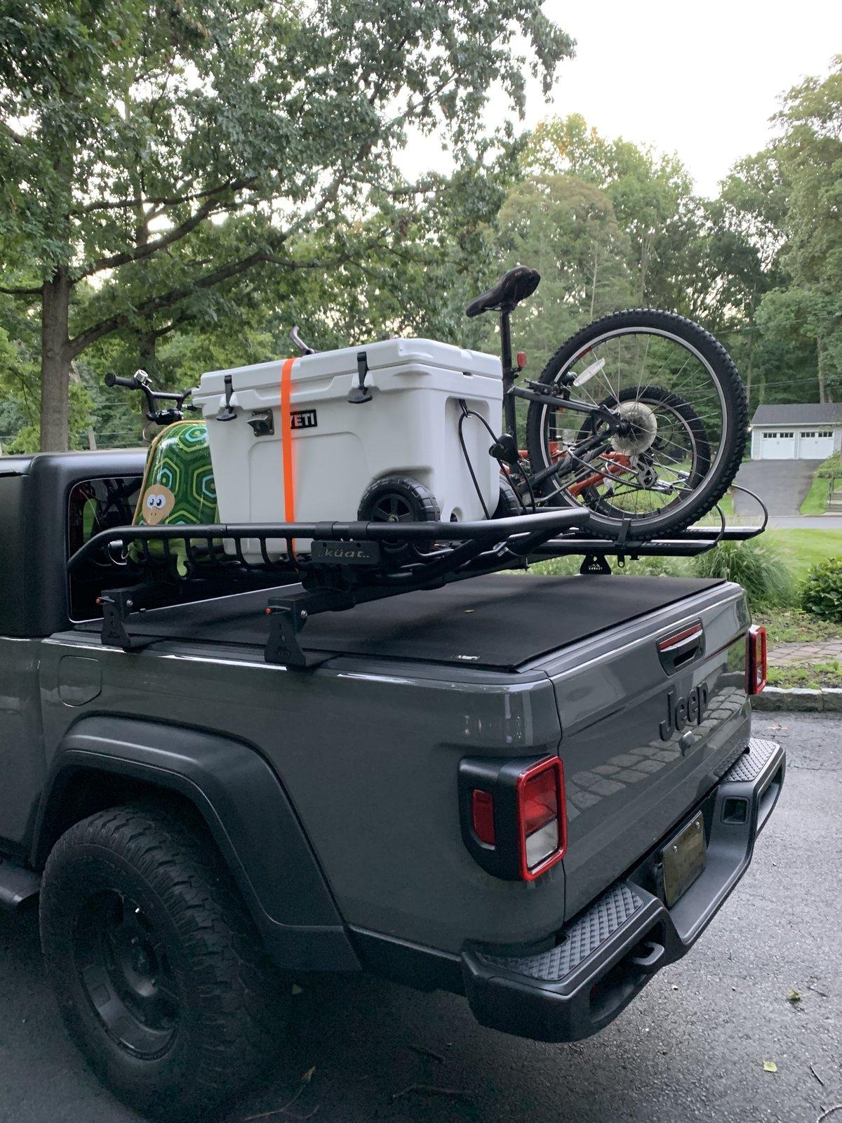

Here are the KB Voodoo aluminum hi rise racks, with a rugged ridge hard rolling cover. Bike trays are Kuat Trio, and cargo rack is the Kuat Skinny mini. I did have to swap our bike rack (Trio) hardware for longer metric bolts and could only get 2 not 4 bolts in the front part by the fork, I confirmed with Kuat engineers that 2 bolts would not be a problem and they assured me it would still hold. I just made a 800 mile rounds trip with zero issues so they were correct. These bike trays also come with built in bike locks which I love and the cargo tray has a fork mount as well which enabled me to put my sons small bike on that with my Yeti. All in all it’s the perfect setup for me, as I refused to sacrifice the cover for a rack and don’t like bikes hanging off the hitch, especially when I need to get the tailgate down. Good luck and let me know if you need more pics as they are still on the truck.
