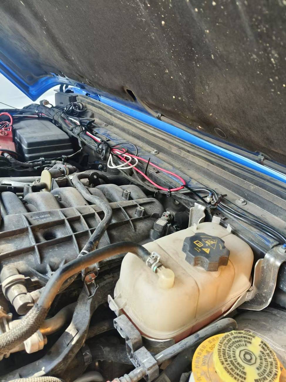

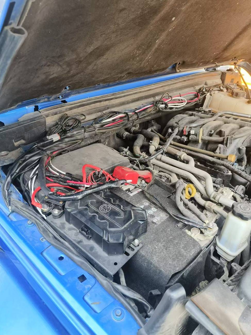

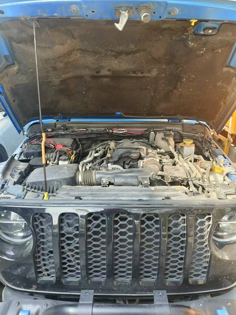

When you add a lot of pods and other electronics, cabling is definitely a big part of your job.
First up, here's our negative example... a bunch of Baja LP6 and other wiring harnesses cluttering the wireless switch.
This month we're using wire loom to keep things tidy!
How do you cable your engine bay? Any tips to share? Looking forward to seeing some nice work!

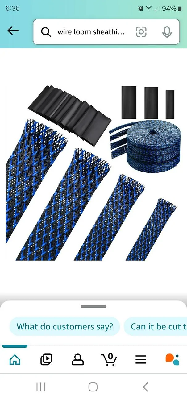

I use this sheathing to run my wires in. I double it over itself on the ends an put heat shrink over the ends. They make it in several colors. I have several pieces of equipment that is left outside, so protection from rodents is an issue. I have not had any rodents chew on it yet. There is a track forward of the cowl area where you can run your wires from left to right. I still use the sheathing in this area, it's just neater.
Now you have alot going on there . I don't think all of that will fit in that track, but you can run some of the smaller harnesses in there.
