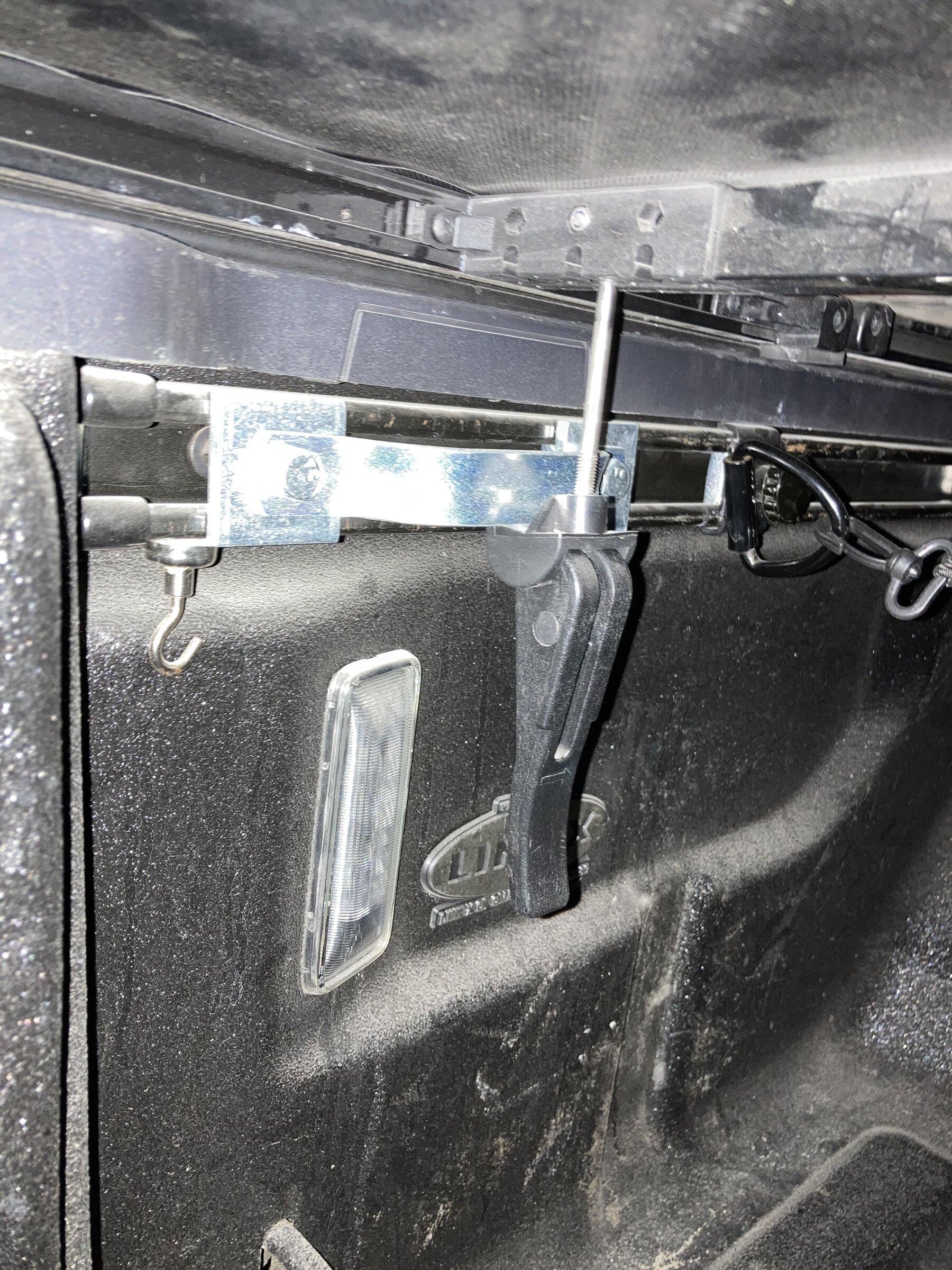

Hi! I wan’t to purchase an inexpensive Trifold tonneau cover for my Gladiator and they all say they are designed for the beds Without the cargo management system. Has anyone figured out a DIY to incorporate the rail system as a mounting point ?

I have a home brew unistrut system based on the one found on this forum. I have a cheap trifold and the mounts near the cab were okay. For the latches near the tailgate I’m using galvanized screen door handles mounted in the rail. They double as a handy anchor point too. I don’t know if this would help you, but it might give you some ideas.
excellent hack! This is what I’m looking for.
