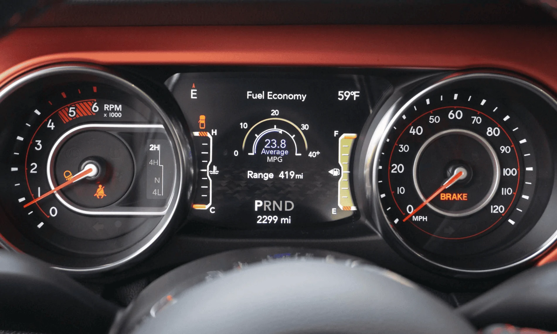

Ordering a diesel rubicon. I realize 35s can fit stock. My question is does the diesel rubi with 35s and fully loaded (bumpers, cap, RTT, winch, etc) stay in top gear on the freeway at 75 mph or does it have to downshift to go over overpasses, etc?

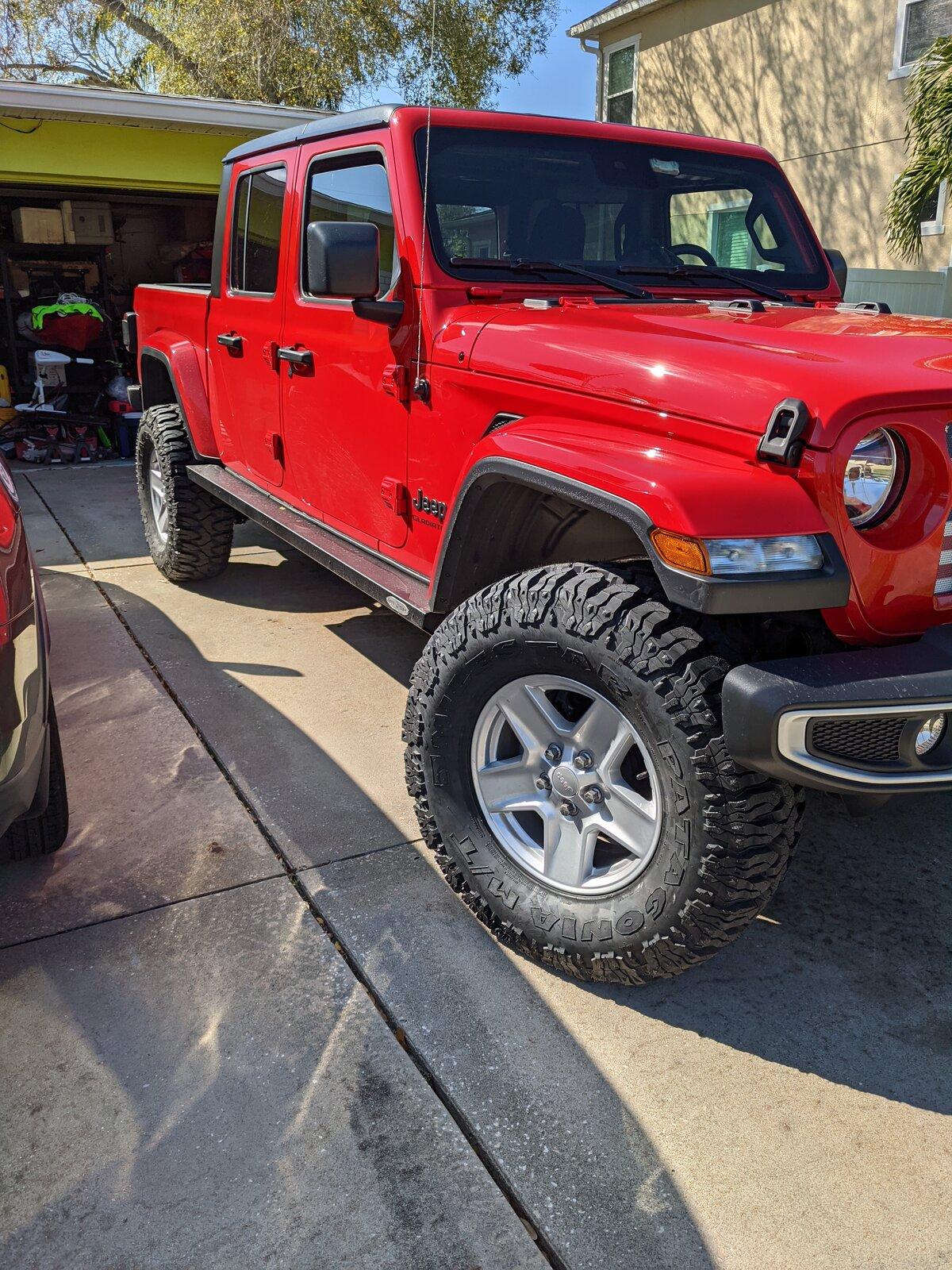

I'm loaded up for a camping trip and will report back after I get to the campsite, Sport with the Mopar 2"lift and 35" Patagonia's, haven't been on the highway since the install last weekend...
Everything ran fine on the highway on the way up and off-road, absolutely love the looks and ride of the combination 2"Mopar lift and 35's..... No troubles maintaining speed and averaged 22mpg on the tank...
