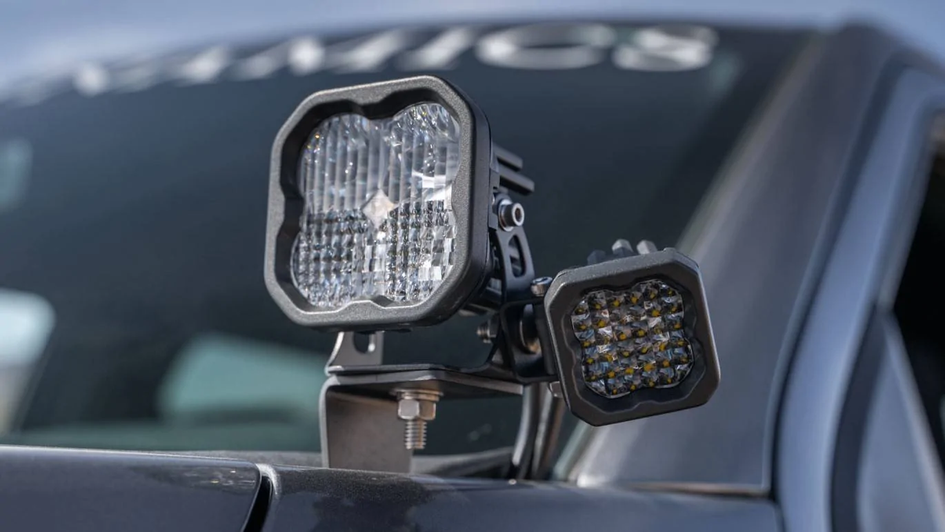

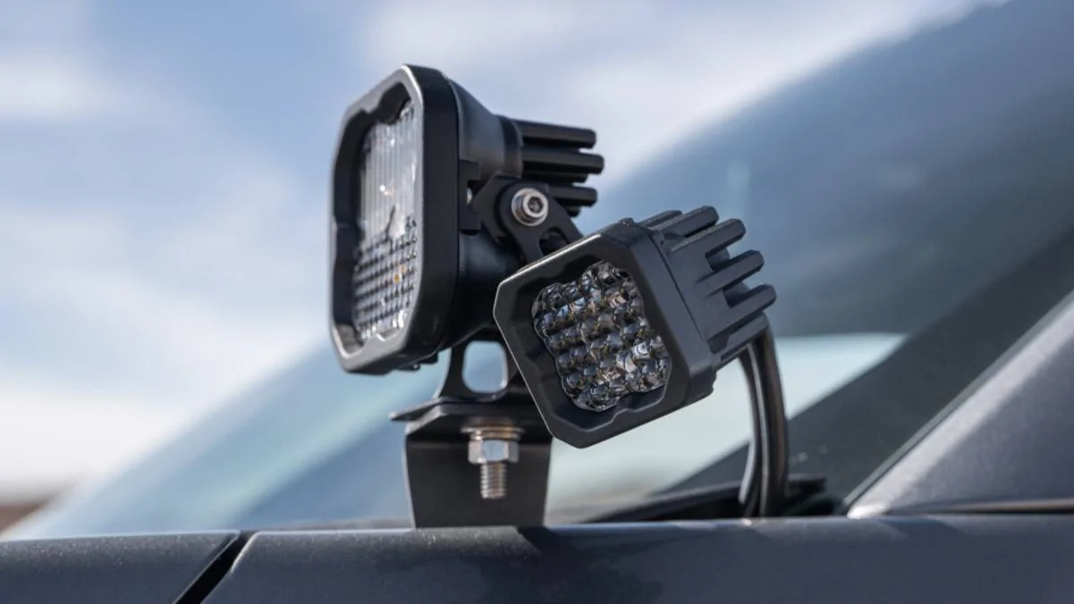

If you haven't seen it, this is one of the most popular ditch light upgrades trending online using our products!

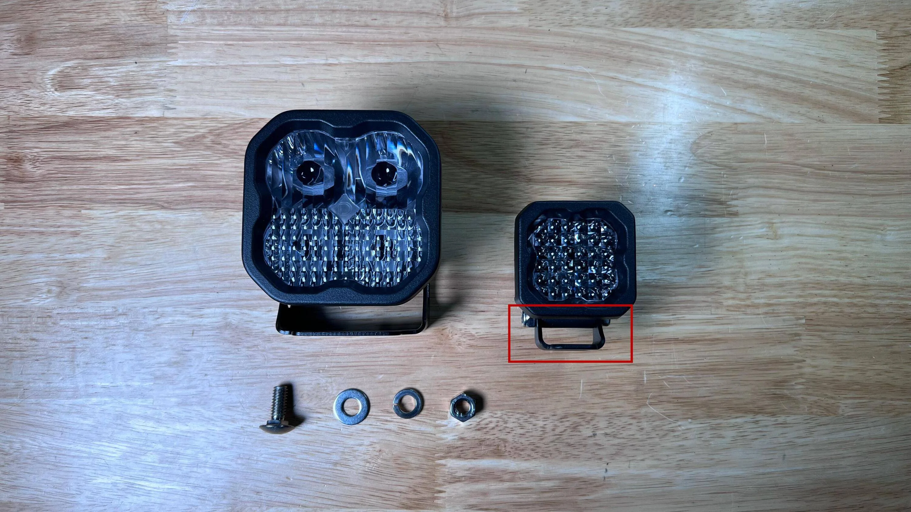

Due to the design of our SS3 universal bracket, you can bolt our SSC1 LED pod directly to the side of the bracket for additional output.
Jeep Gladiator Ditch Light Hack: SS3 + SSC1 Pods | Diode Dynamics Ek2XM5v

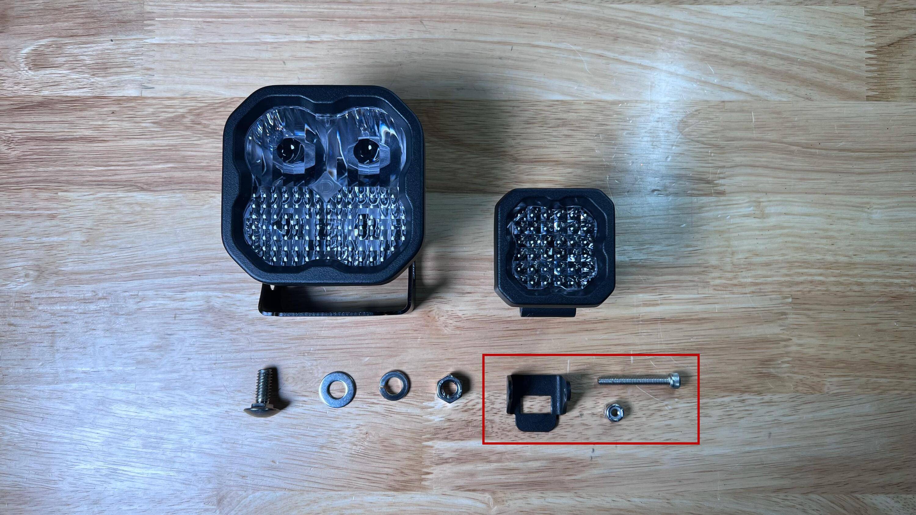

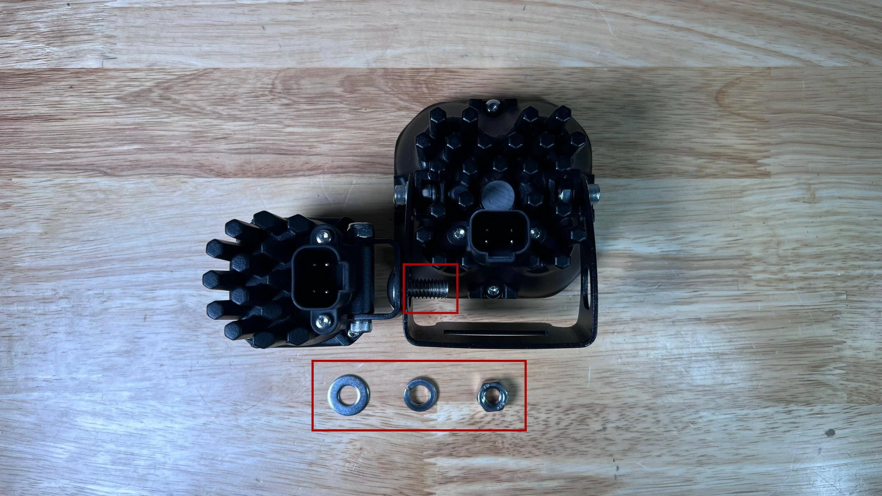

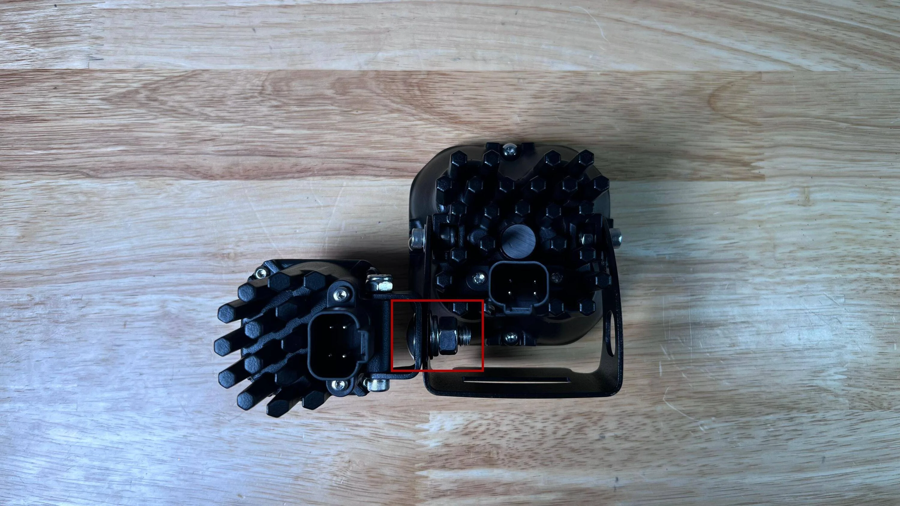

Attach Universal SSC1 U-Bracket to SSC1 LED Pod
Jeep Gladiator Ditch Light Hack: SS3 + SSC1 Pods | Diode Dynamics 6bHuLMX
SSC1 LED Pod with U-Bracket Attached
Jeep Gladiator Ditch Light Hack: SS3 + SSC1 Pods | Diode Dynamics tqZxwtT

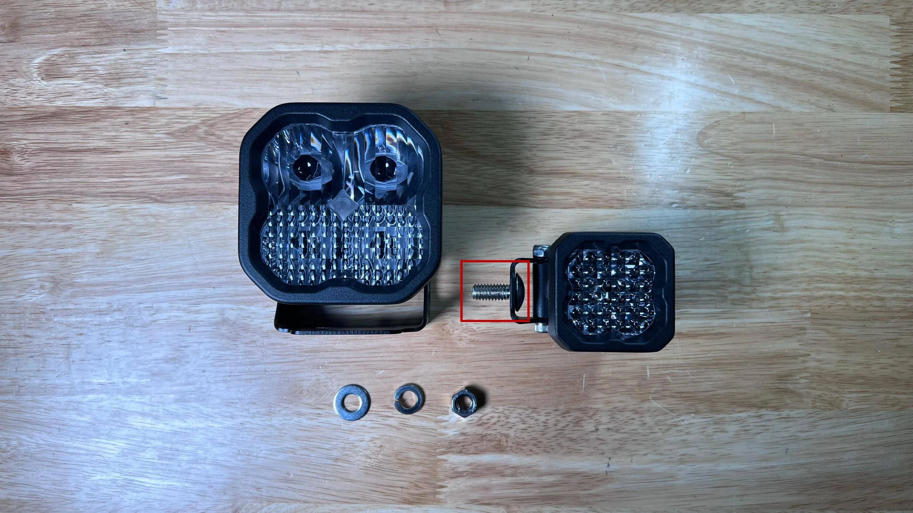

Slide the included carriage bolt through the SSC1 U-Bracket
Jeep Gladiator Ditch Light Hack: SS3 + SSC1 Pods | Diode Dynamics SEZL3p8

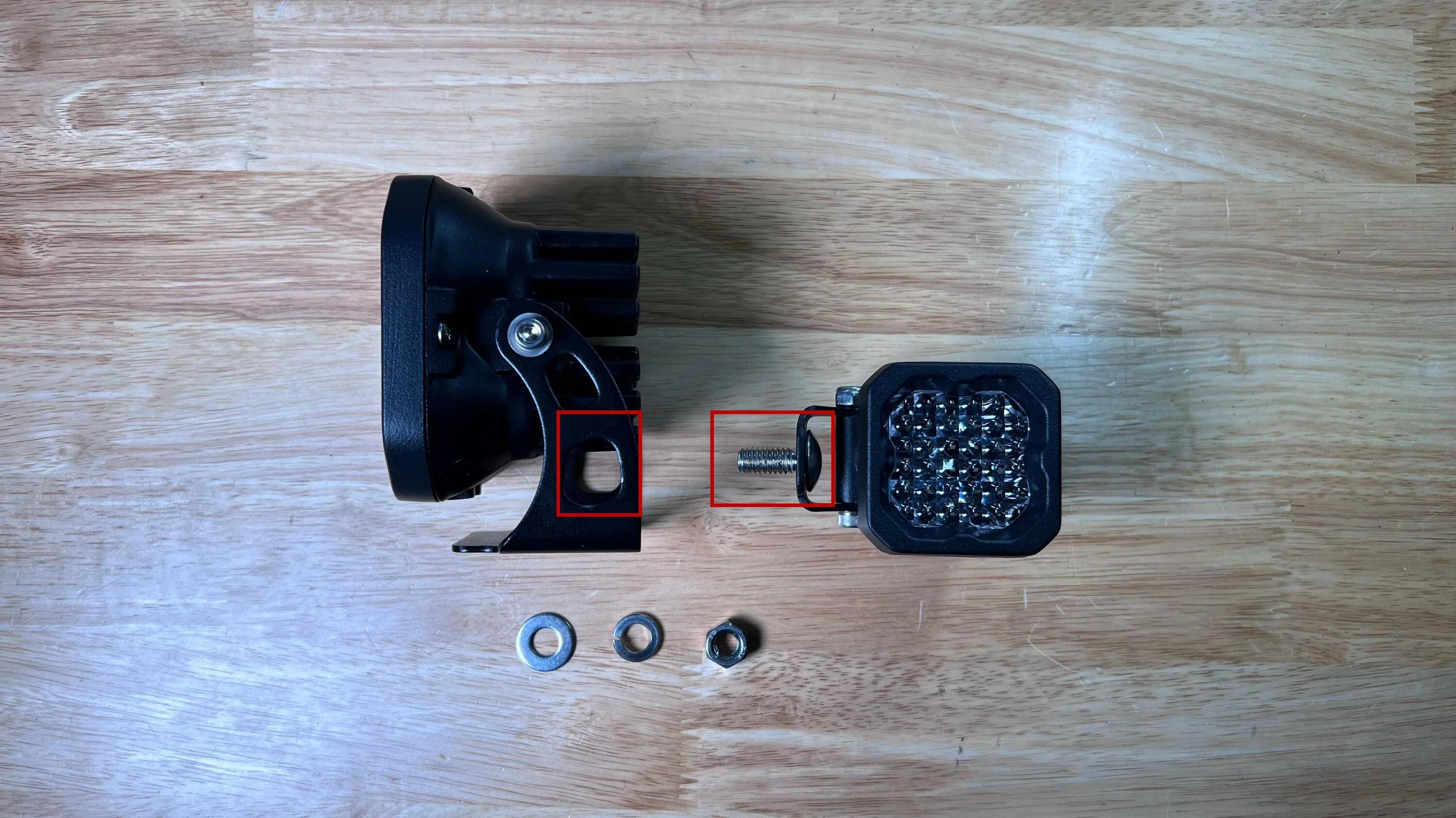

Slide the SCC1 LED Pod with carriage bolt through the side of the SS3 U-Bracket
Jeep Gladiator Ditch Light Hack: SS3 + SSC1 Pods | Diode Dynamics UESNIID
SSC1 LED Pod with included carriage bolt through the side of our SS3 U-Bracket
Jeep Gladiator Ditch Light Hack: SS3 + SSC1 Pods | Diode Dynamics W8zJabv
Thread on the included washer, lock washer, and nut to secure the SSC1 LED Pod to the side of our SS3 U-Bracket

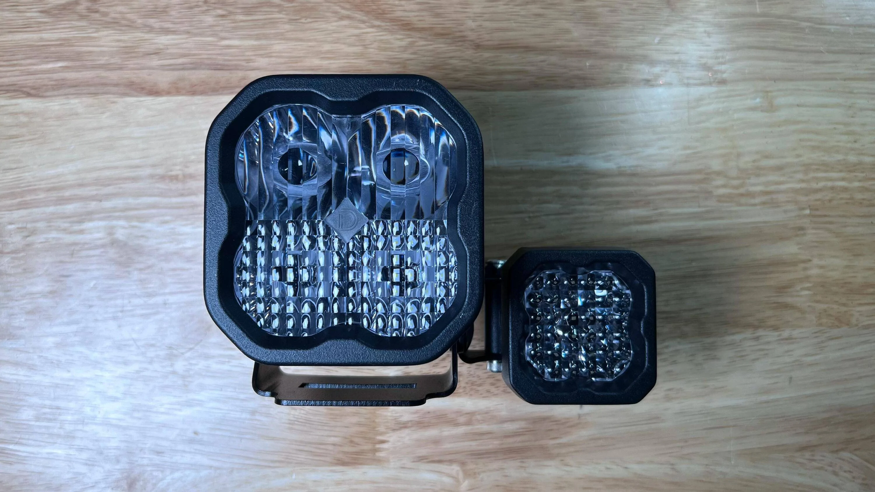

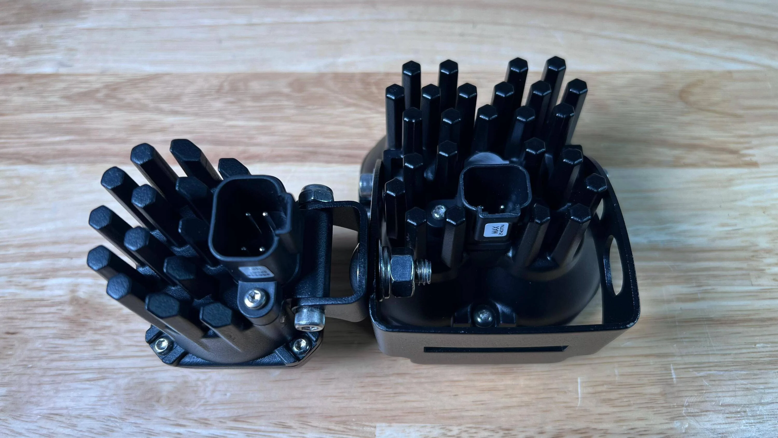

Jeep Gladiator Ditch Light Hack: SS3 + SSC1 Pods | Diode Dynamics GF1zYOt
SSC1 LED Pod attached to our SS3 LED Pod
Jeep Gladiator Ditch Light Hack: SS3 + SSC1 Pods | Diode Dynamics Hh9x7Y7

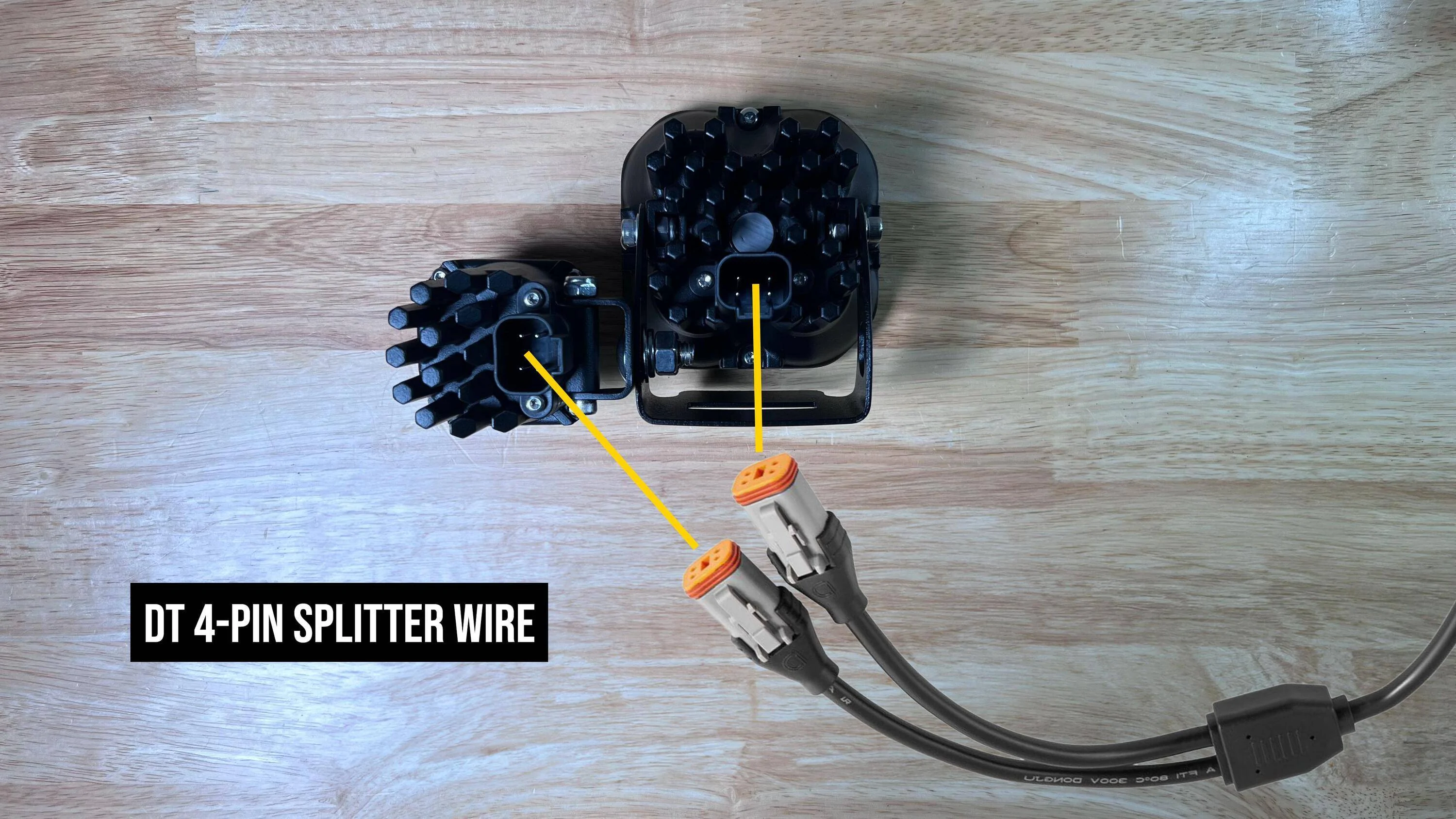

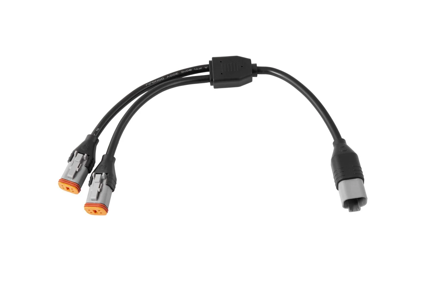

If you plan to have your SS3 and SSC1 LED pods backlight and main beam operate together, you'll need our DT 4-Pin Splitter Wire.
Jeep Gladiator Ditch Light Hack: SS3 + SSC1 Pods | Diode Dynamics QU8B3IJ
Click HERE to shop our 4-Pin DT Splitter Wire!
Jeep Gladiator Ditch Light Hack: SS3 + SSC1 Pods | Diode Dynamics vWoBjU

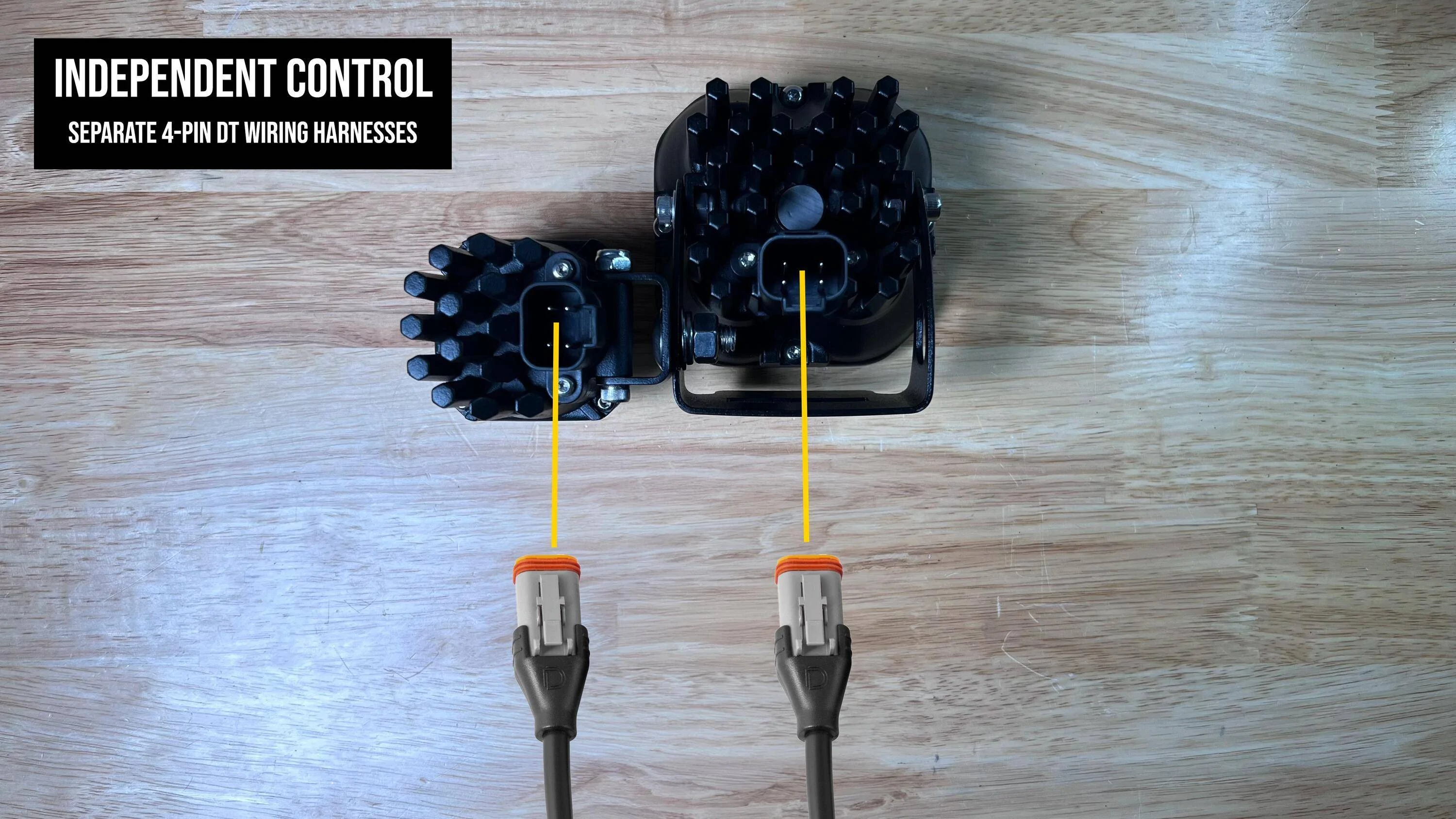

If you prefer to have independent control over your SS3 and SSC1 LED pods, you'll need to wire them using separate 4-Pin Wiring Harnesses.
Click HERE to shop 4-Pin DT Wiring Harnesses!
Jeep Gladiator Ditch Light Hack: SS3 + SSC1 Pods | Diode Dynamics RTOPmwh
SS3 + SSC1 Ditch Light
