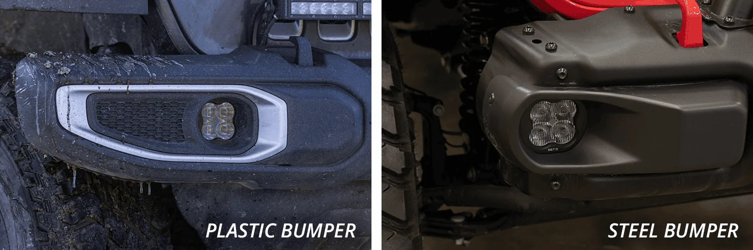

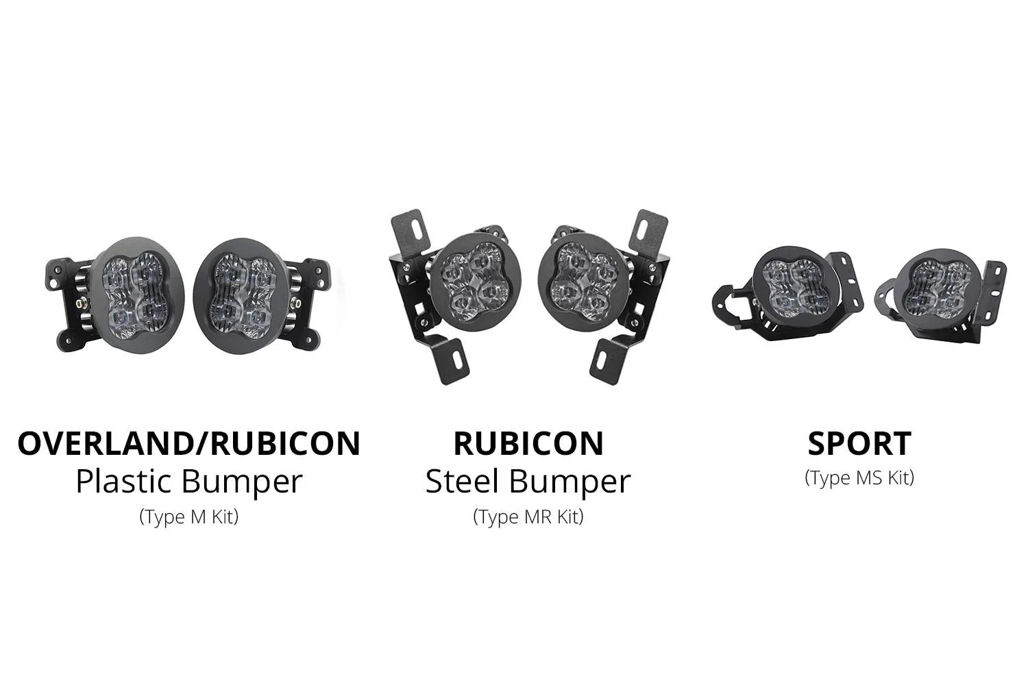

Introducing Diode Dynamics new SS3 LED Fog Light Kits for the 2020 Gladiator and 18+ JL Wrangler! Compatible with both the plastic and steel bumpers, our SS3 Fog Light Kits allow you to mount two of our 3" SS3 LED Pods in your factory fog light location. Our LED pods have been designed for maximum light output, with custom-engineered TIR optics shining in highly functional beam patterns, all in a compact, durable package.

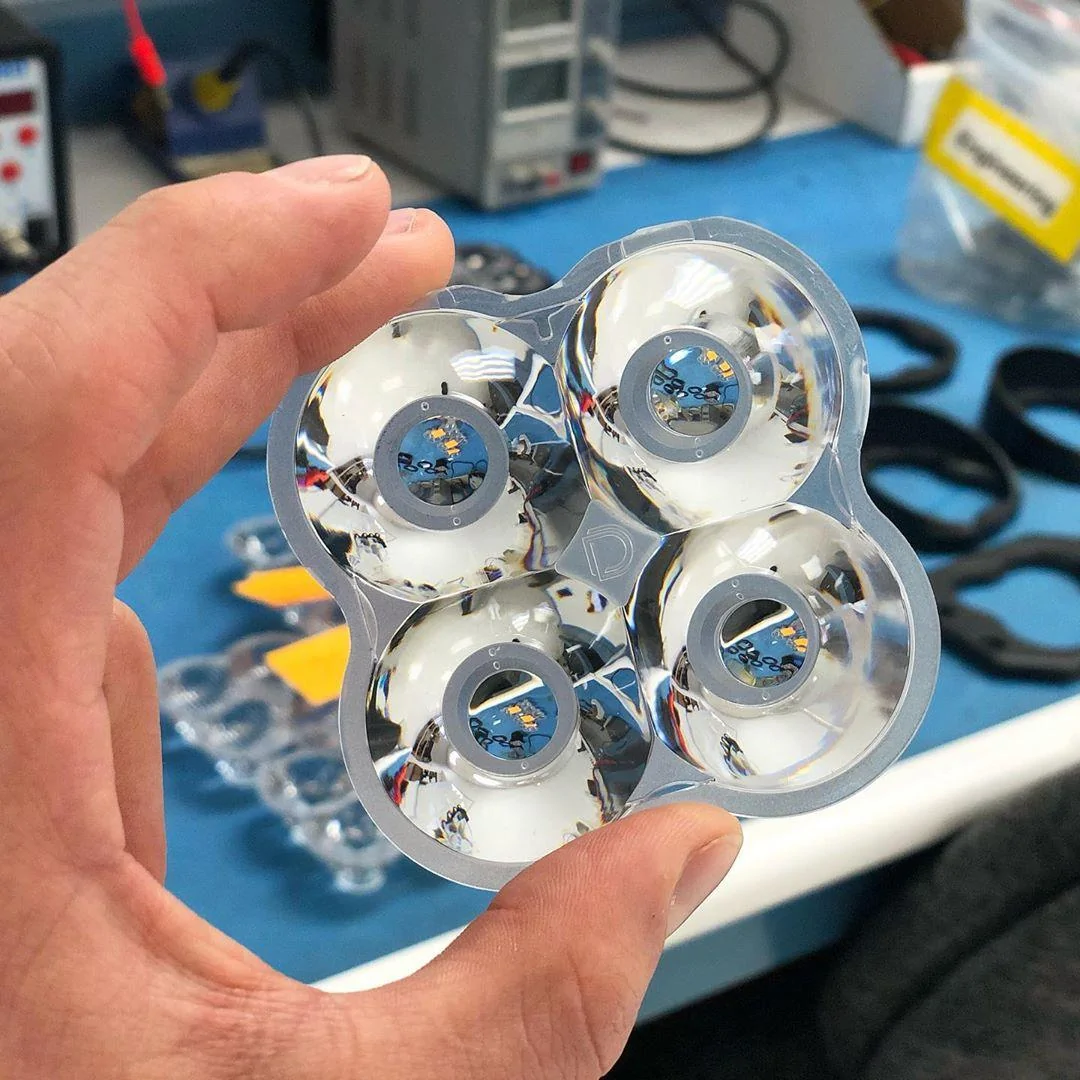

Focused: Most LED pods on the market, even certain premium options, use outdated technology like reflectors or simple lenses that lose light internally and to glare. By comparison, our custom-engineered TIR optic in the SS3 collects all of the light from the LED, drastically reducing wasted light and improving total efficiency.
While these outdated optics lose up to 10% of the light output shining through an outer lens, the SS3’s custom-molded TIR optic functions as both the optic and the main lens, dramatically increasing the amount of usable light output.

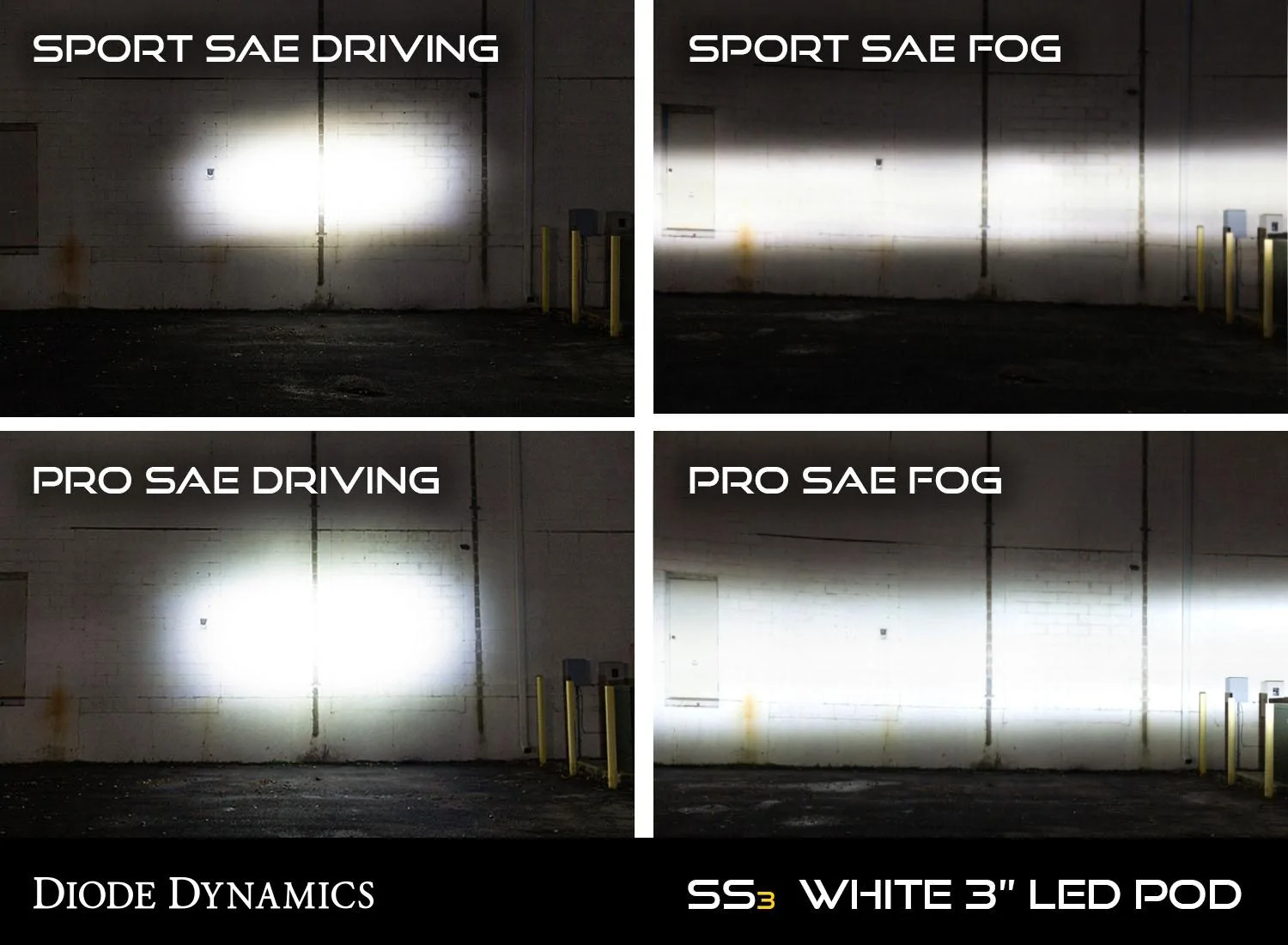

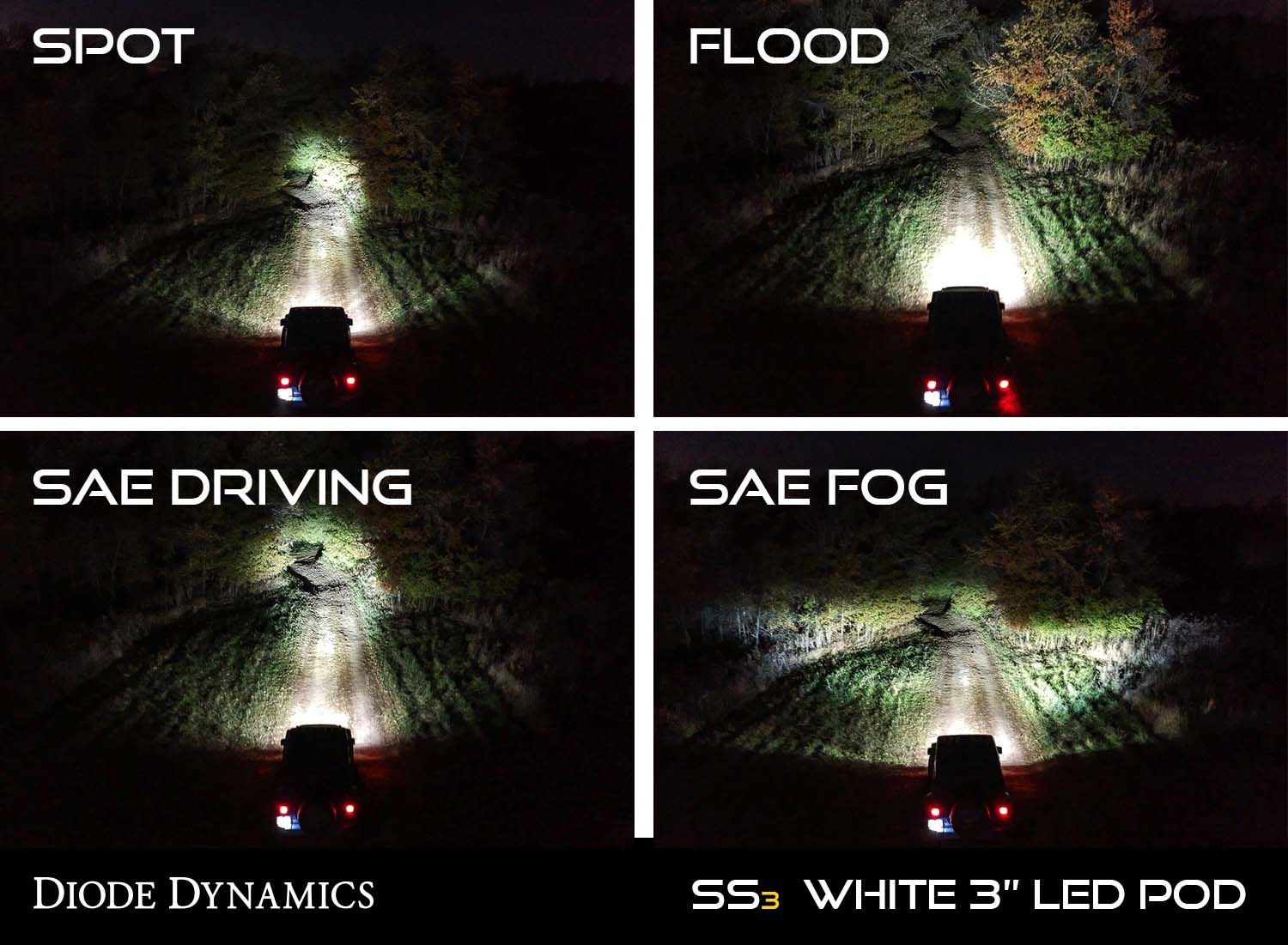

Functional Patterns: All SS3 LED Pod beam pattern options were designed with optical simulation modeling, to shape the light output in a highly-functional beam pattern. No matter what your auxiliary lighting needs are, there is an SS3 LED Pod for you!
  • Our SAE Driving optic is designed to supplement your high beams, but it’s great for improving general illumination as well. Rather than a typical "spot" pattern, the Stage Series Driving pattern shines in an 18x8 degree spread, providing just enough width to completely light up the road ahead at high speeds.
  • Our SAE Fog optic provides an extremely wide field of illumination, with high-intensity light output over an entire 80-degree spread. It serves as a great upgrade for any factory foglamp, and will fully illuminate the area in front of your vehicle. Choose your output color of 6000K cool white or 3000K selective yellow, which is popular for cutting through inclement weather.
  • The Flood optic was engineered to provide uniform, even illumination with a full 60x60 degree spread of light. Unlike typical "flood" lights that are just a heavily diffused spotlight, our flood pattern uses pillow optics on the outer lens surface, to provide a true optically designed spread, for even illumination throughout. It’s the perfect optic for use as a backup light, lighting up tight trails at low speeds, or for loading trailers and setting up worksites.
  • Finally, our Spot optic is an unmodified pattern, shining light directly from the TIR optic. The result is an extremely focused 6-degree beam of light, perfect for directing light far into the distance. With an incredible output of 151,000 candela, the SS3 Sport shines a half-mile away (¼ lux), from a compact 3-inch package!

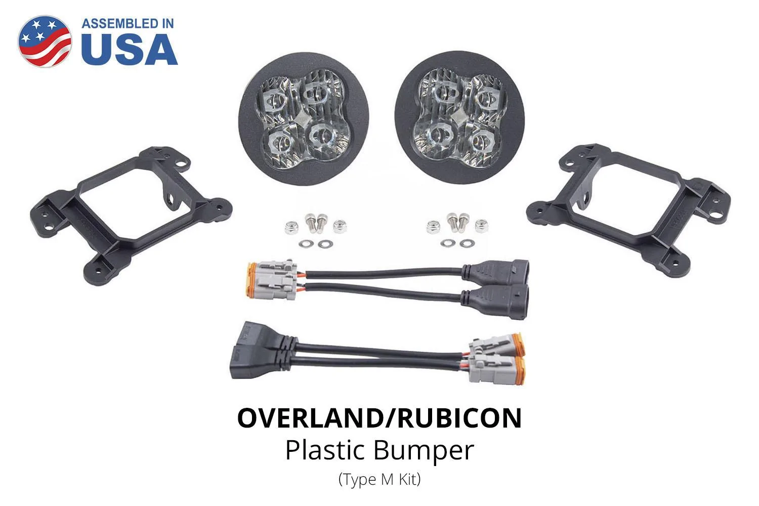

All SS3 LED Pods feature a custom-molded DT type Deutsch-style connector on the back. Both the Type M and Type MR Kit will include CAD-designed brackets and DT wire adaptors for a completely plug-and-play installation. This can be done with basic hand tools in the comfort of your garage!

Would these fit the steel Rubicon winch bumper and what kind of improvement would there be over the factory lights?

Pro SAE Fog pattern looks amazing.
Great question! Our engineering team is working on a bracket kit specifically for the steel bumper, which we hope to release in the coming weeks.
In terms of light output, the SS3 will provide FAR more light output than any factory bulb. The Pro version with our Driving optic delivers a peak intensity of 66,500 Candela, and measured output (not estimated, like the majority of LED lighting) of 3,000 lumens. And that's just for a single pod!
Anecdotally, the SS3 delivers more light output than any plug-and-play lighting upgrade I've ever used. We installed a pair of the SS3 Sport Fogs on my dad's truck, and they delivered more light output than the headlights!

Are these plug and play on a Sport S?
So far, we've confirmed fit and function on the Overland and Rubicon, and will be confirming other trim levels asap.

The Sport S has an extra fill panel between the bumper and fenders that covers the lights down there- I suspect that MAY be why the question???? The others are open behind the lights as far as that filler panel isn't there on the O and R levels.
