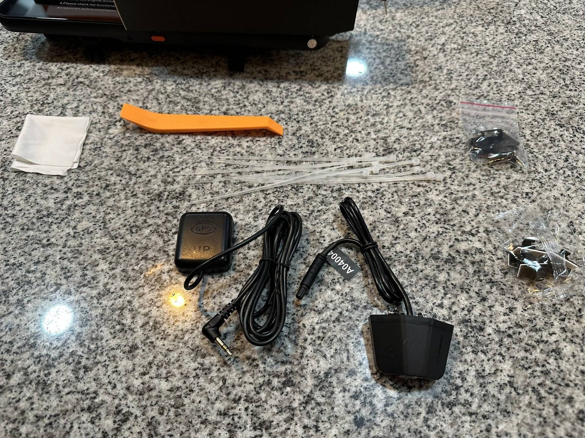

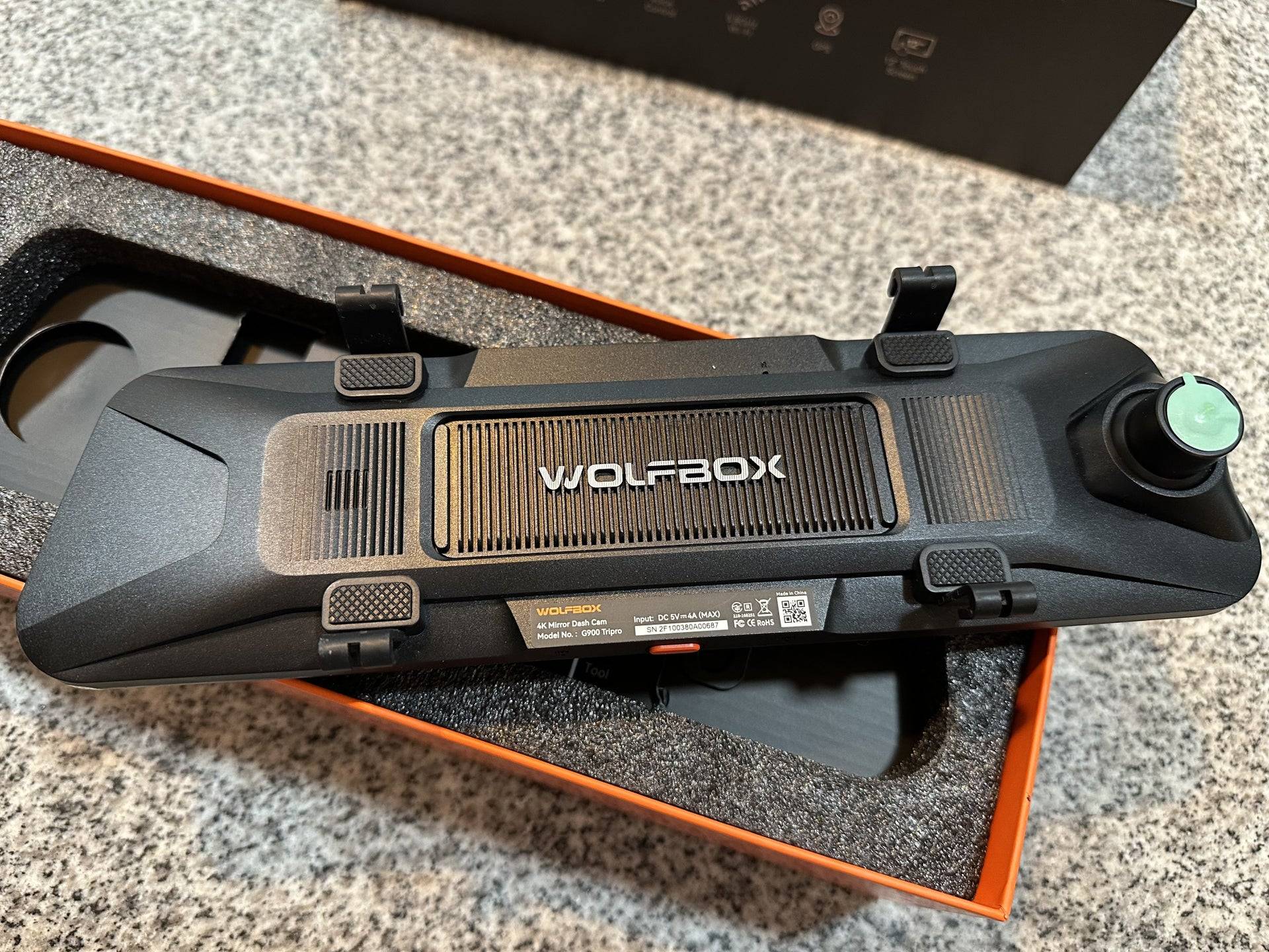

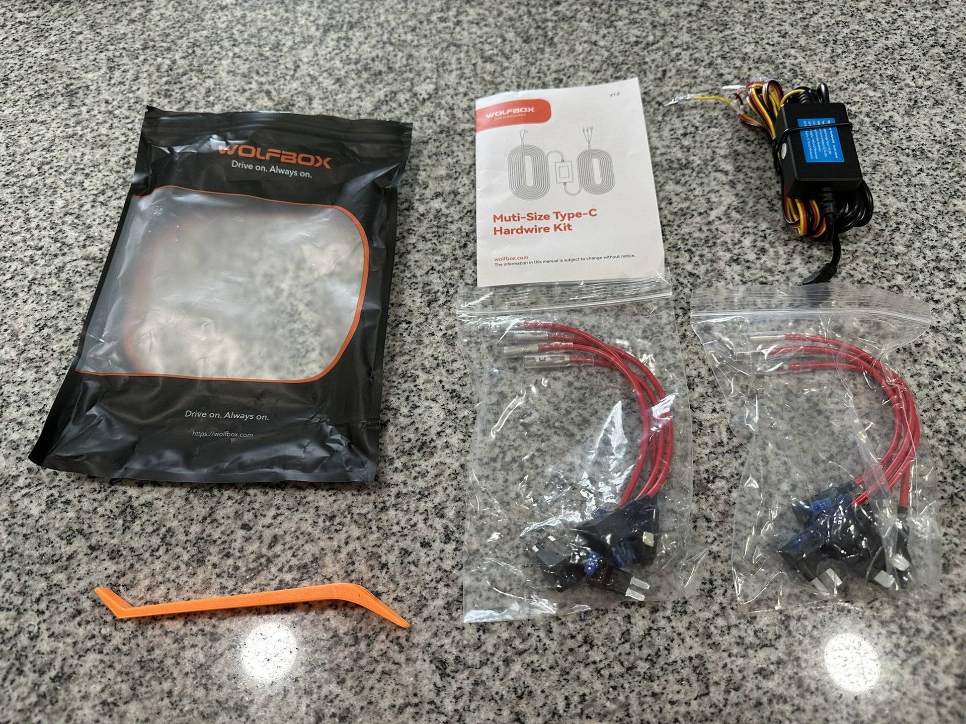

The full install took about a month and a half since I had to 3d print mounting brackets for the front bumper and rear camera. It is packaged very well was impressed with the build quality.
Jeep Gladiator Wolfbox G900Tripro Install and Review (another one) img_4152-jpe
Jeep Gladiator Wolfbox G900Tripro Install and Review (another one) img_4157-jpe
Jeep Gladiator Wolfbox G900Tripro Install and Review (another one) img_4158-jpe
Jeep Gladiator Wolfbox G900Tripro Install and Review (another one) img_4160-jpe
Jeep Gladiator Wolfbox G900Tripro Install and Review (another one) img_4289-jpe

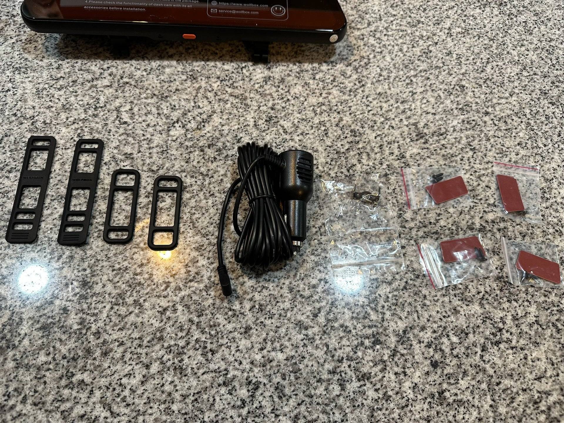

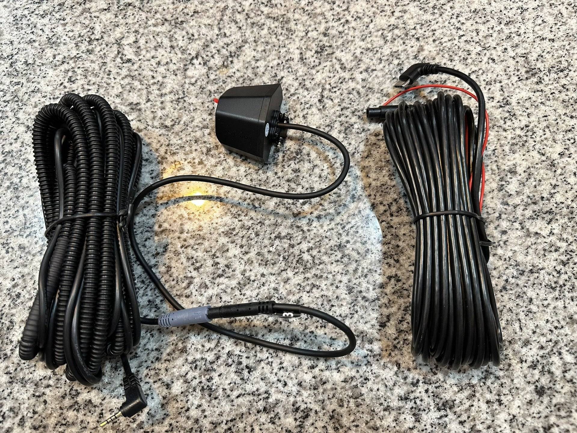

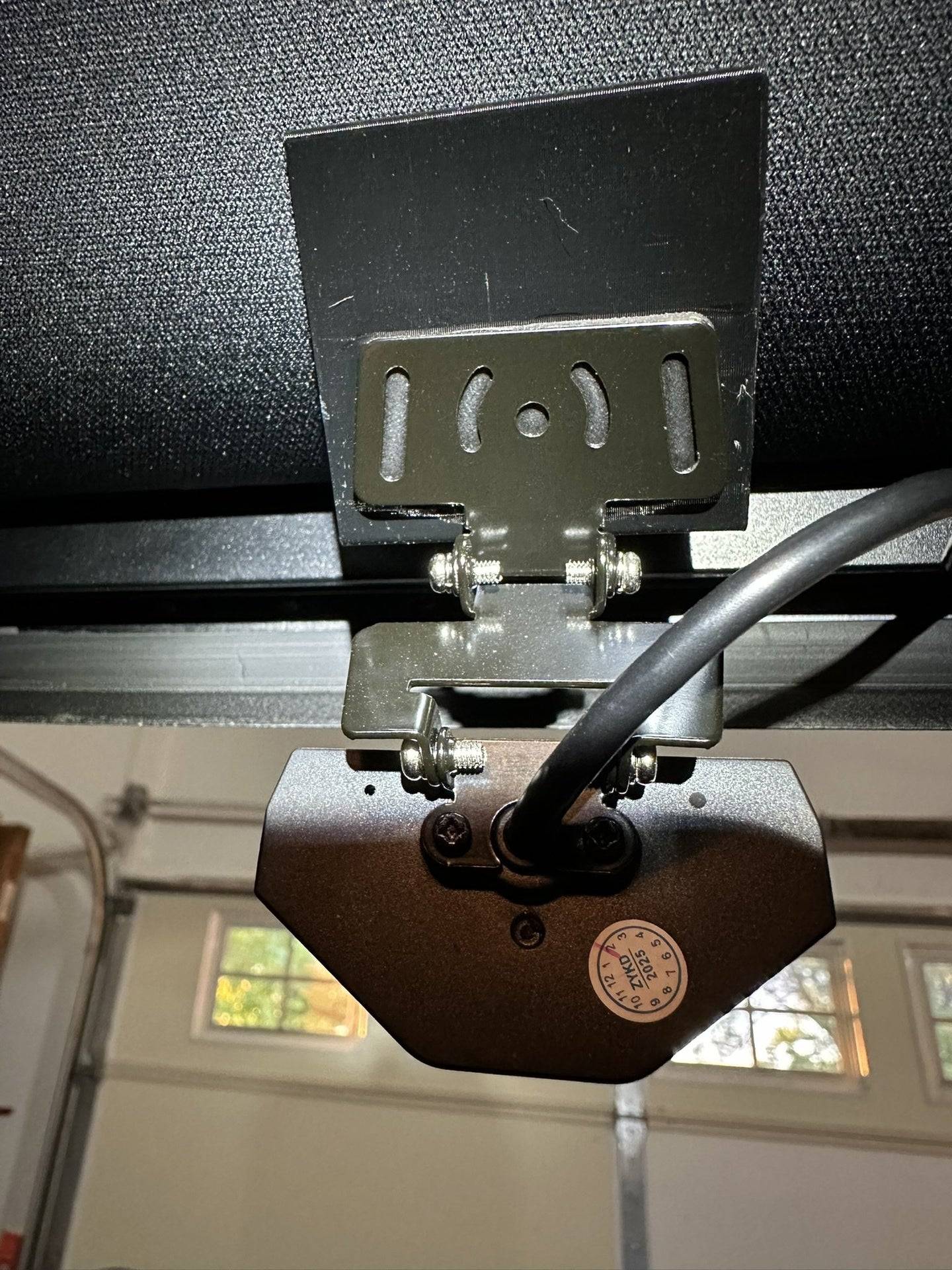

It does make since they don't have custom brackets for every vehicle, but it does come with a license plate bracket and the cameras have double sided tape. I did use the tape on the rear camera, and it didn't stick very well. I ended up using some 3M tape and it has been holding well on the rear camera.

As mentioned in the video, make sure to stay behind the side airbags. I found a mount online for the rear camera and it was super easy to install. It basically clips onto the headliner.

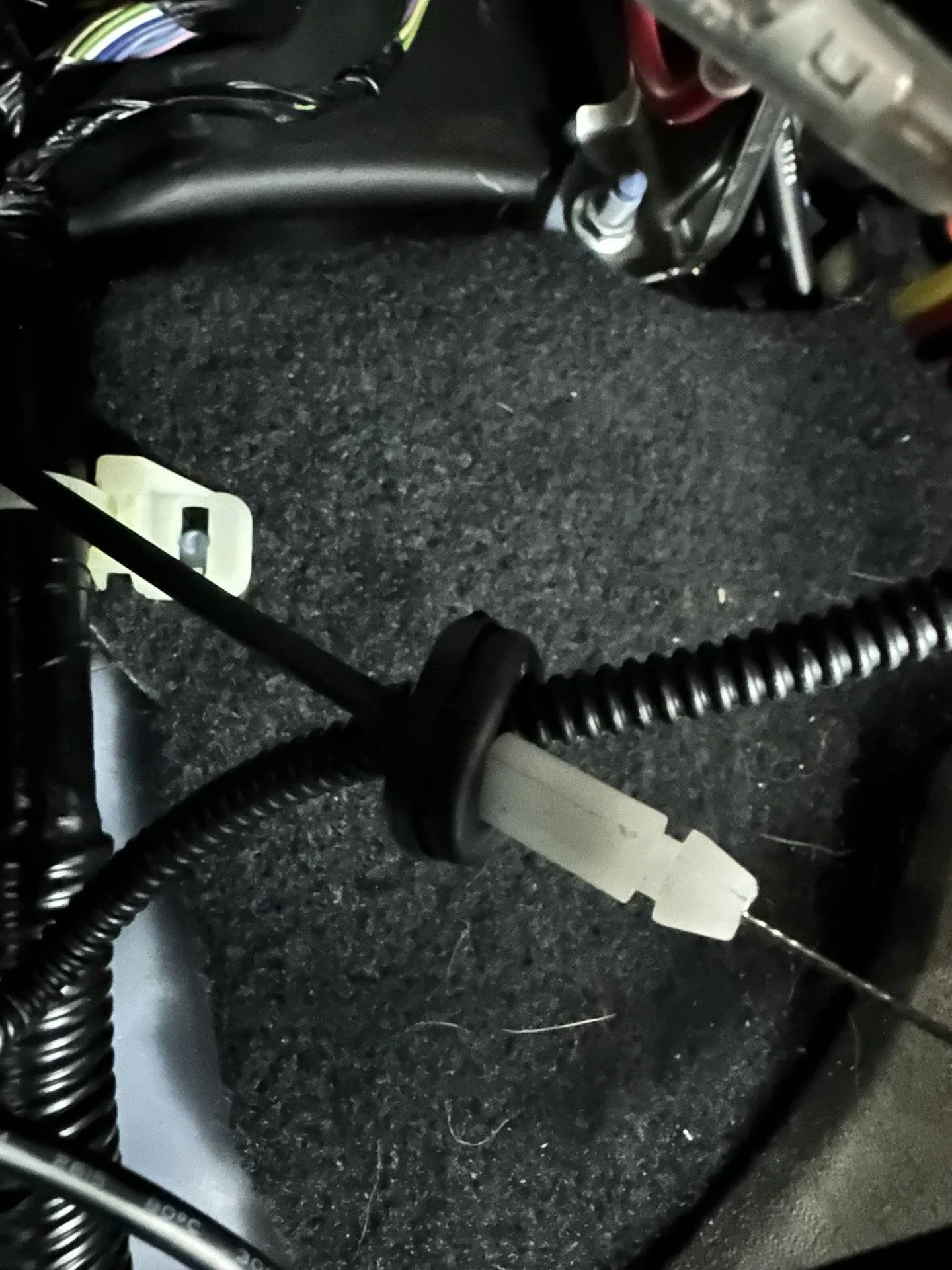

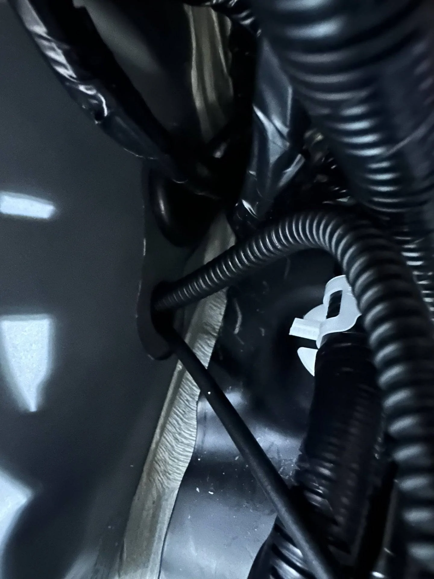

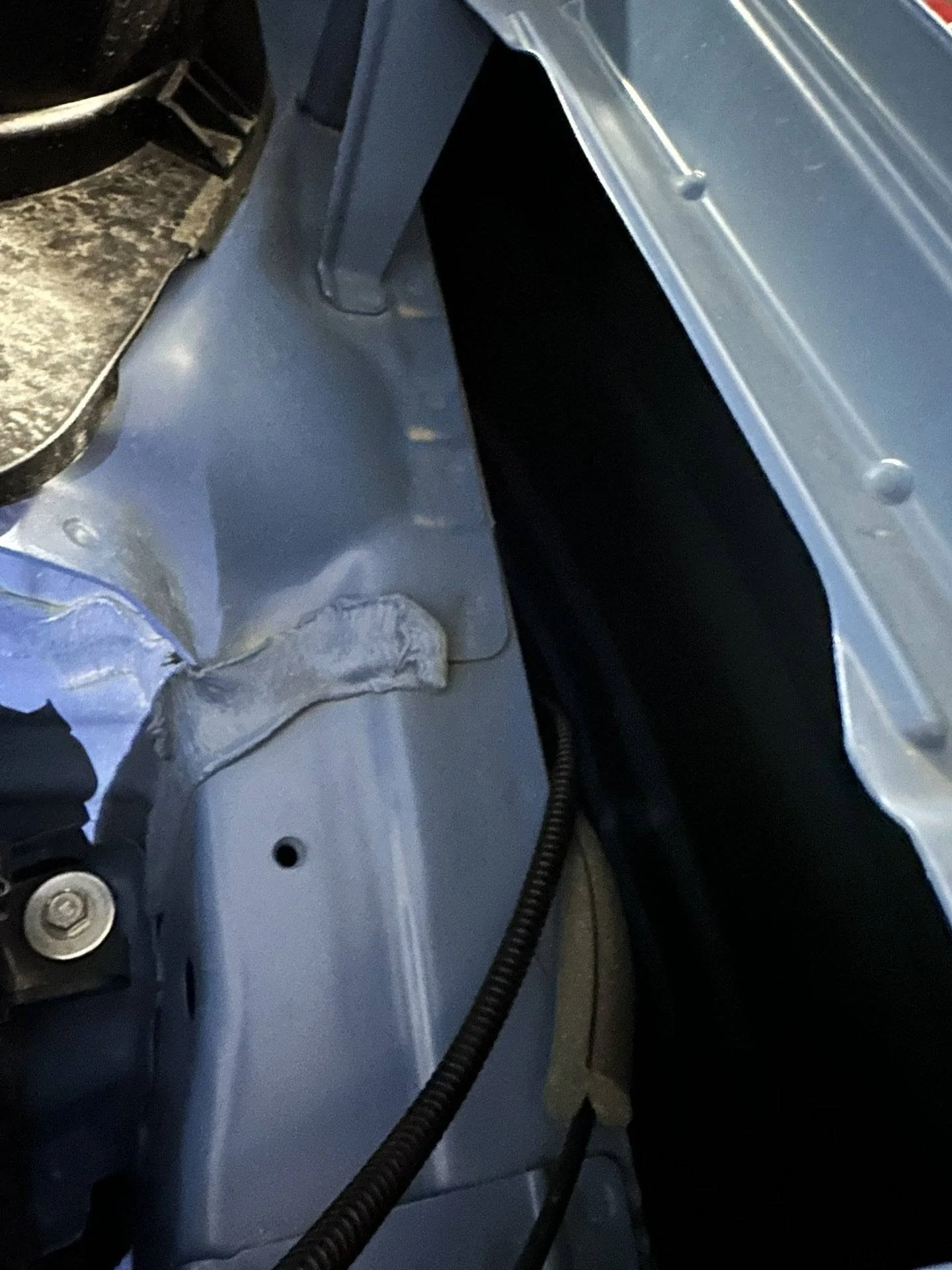

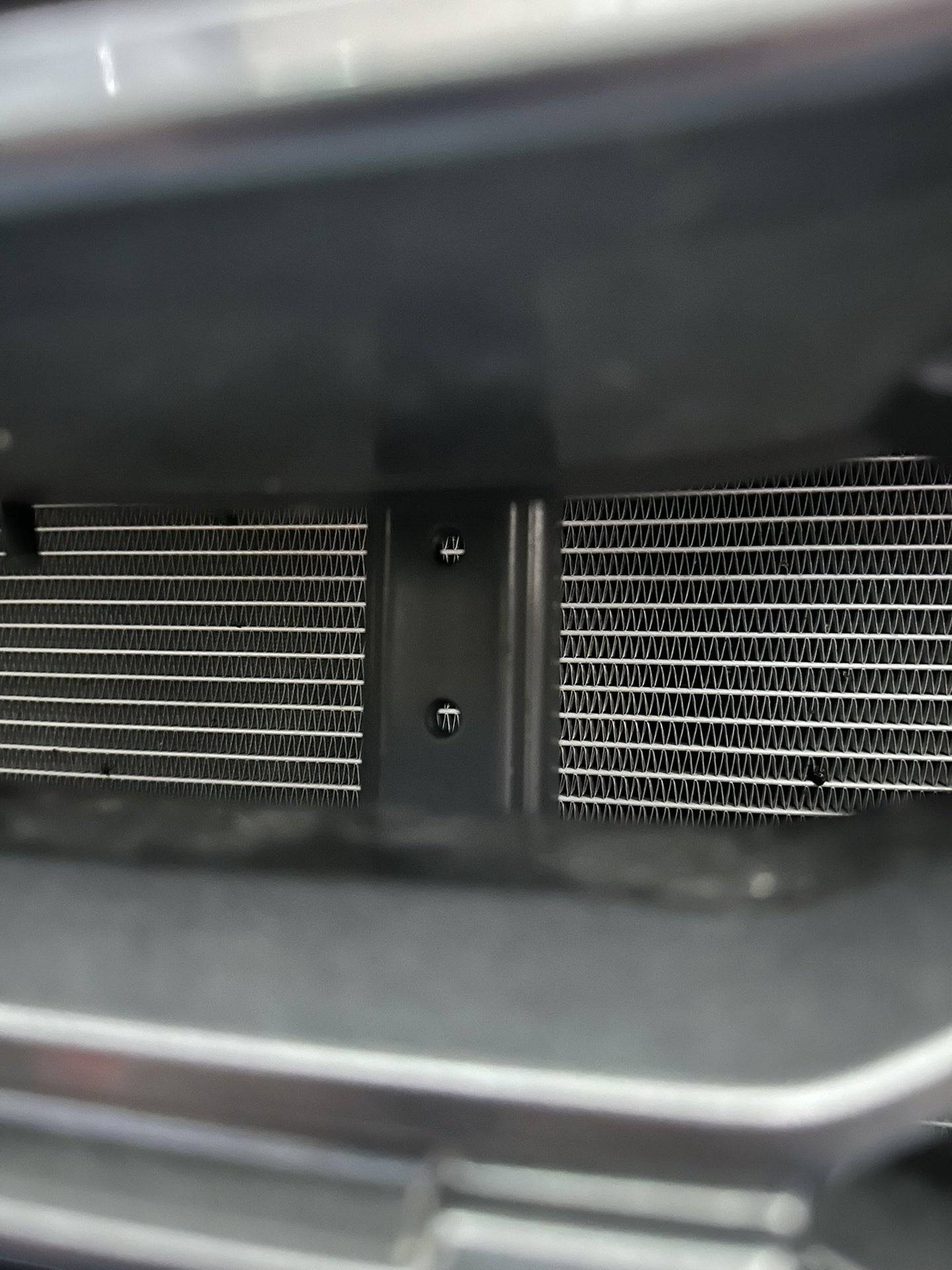

The front camera took a bit more work. I tried a few different routs to get the cable through the firewall and eventually decided to run it through the same grommet as the hood latch. Thank you to the guys at Naviks for that pointer. That's where they run their front camera cable on the RL/Pilot.
Jeep Gladiator Wolfbox G900Tripro Install and Review (another one) img_4345-jpeg
Jeep Gladiator Wolfbox G900Tripro Install and Review (another one) img_4344-jpeg
Jeep Gladiator Wolfbox G900Tripro Install and Review (another one) img_4346-jpeg

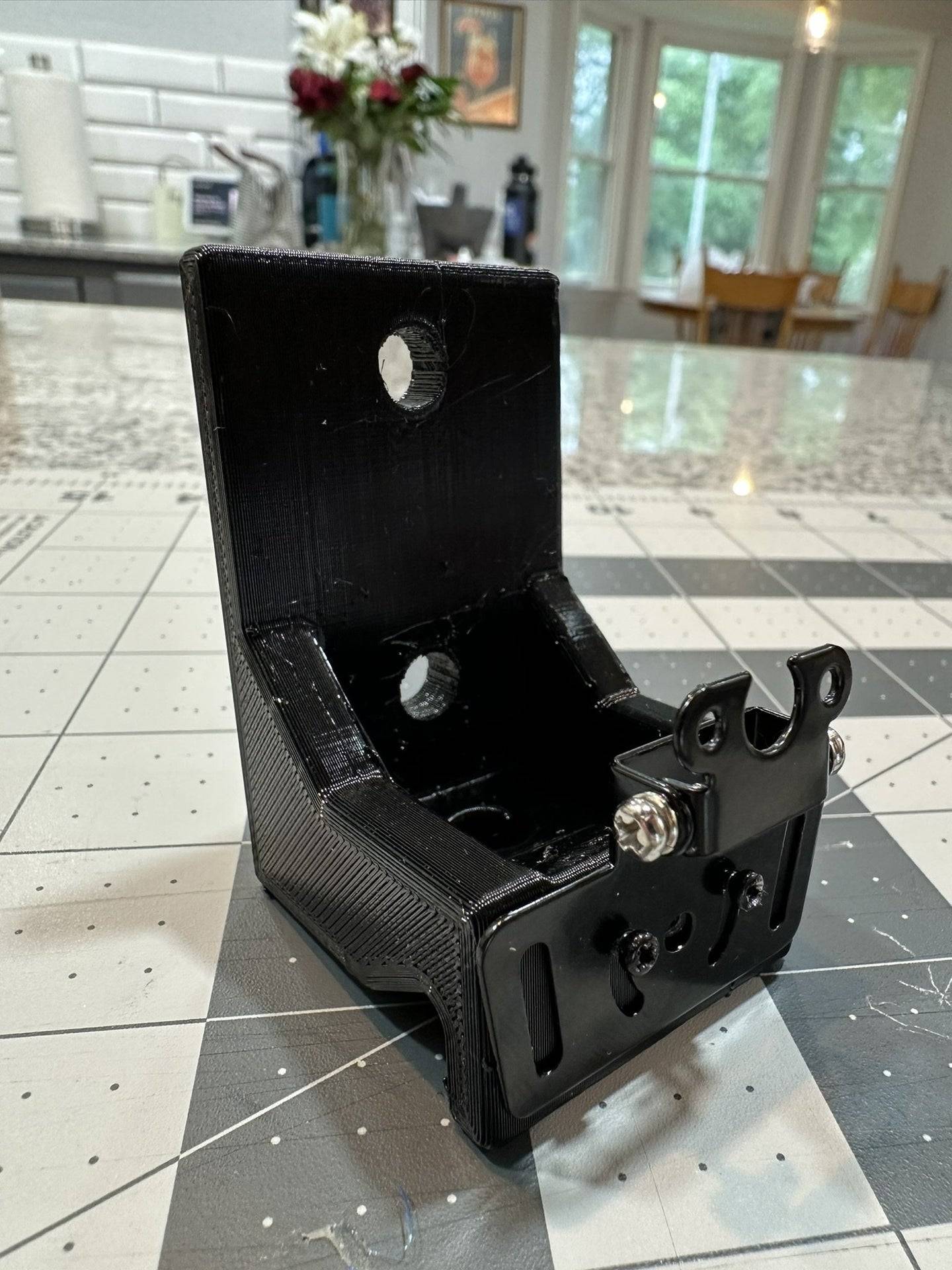

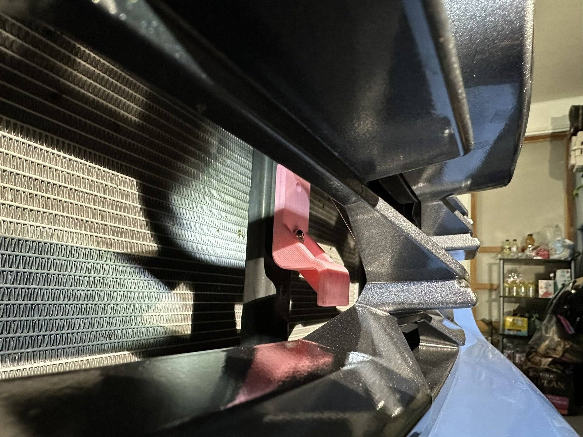

The next step was how to mount the camera. I could have double sided tapped it to the grill, but wanted a cleaner/more professional mount. Thankfully Honda made that very convenient but adding tapped holes right un a brace right behind the emblem in the grill.
Jeep Gladiator Wolfbox G900Tripro Install and Review (another one) img_4138-jpe

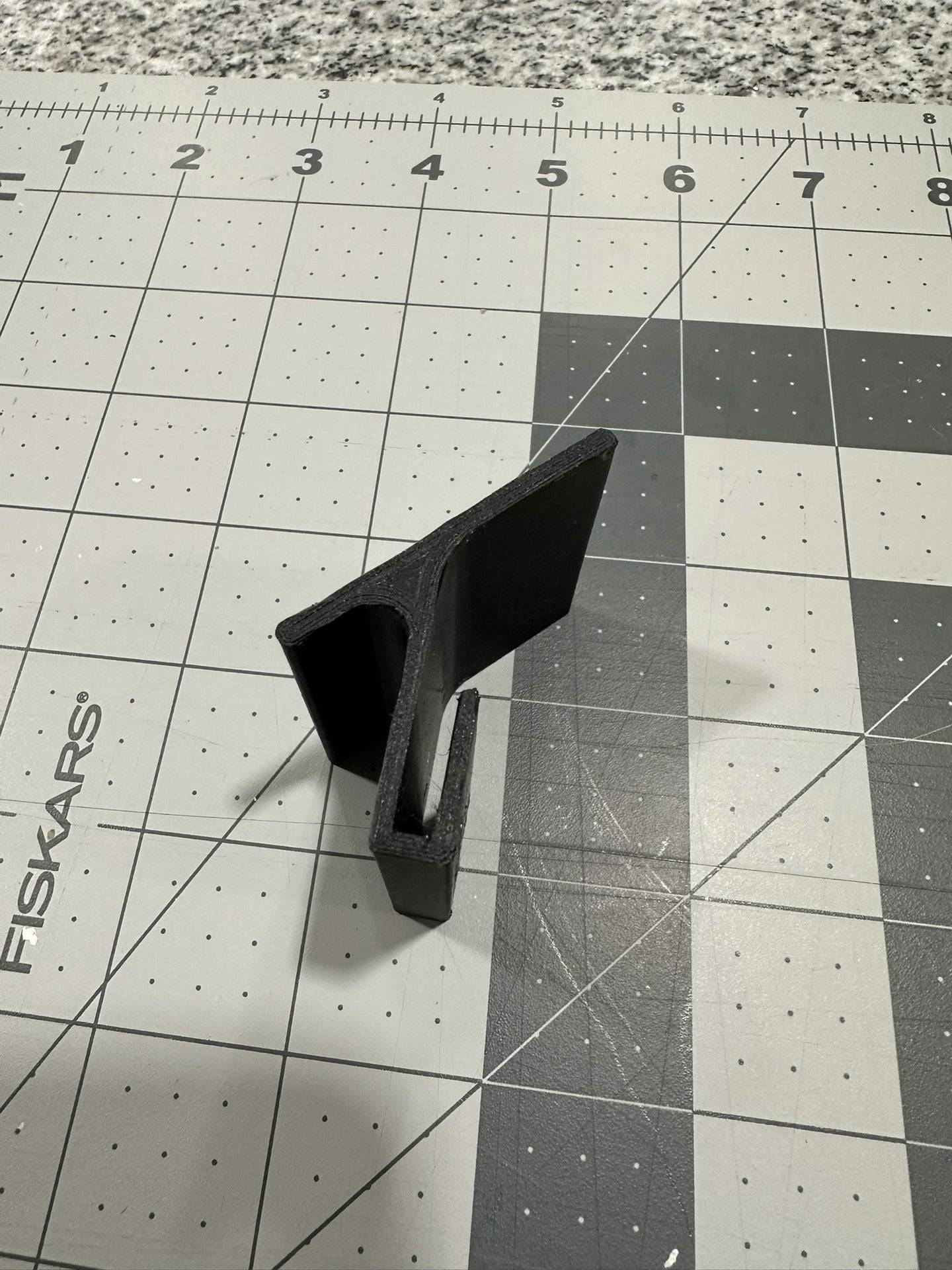

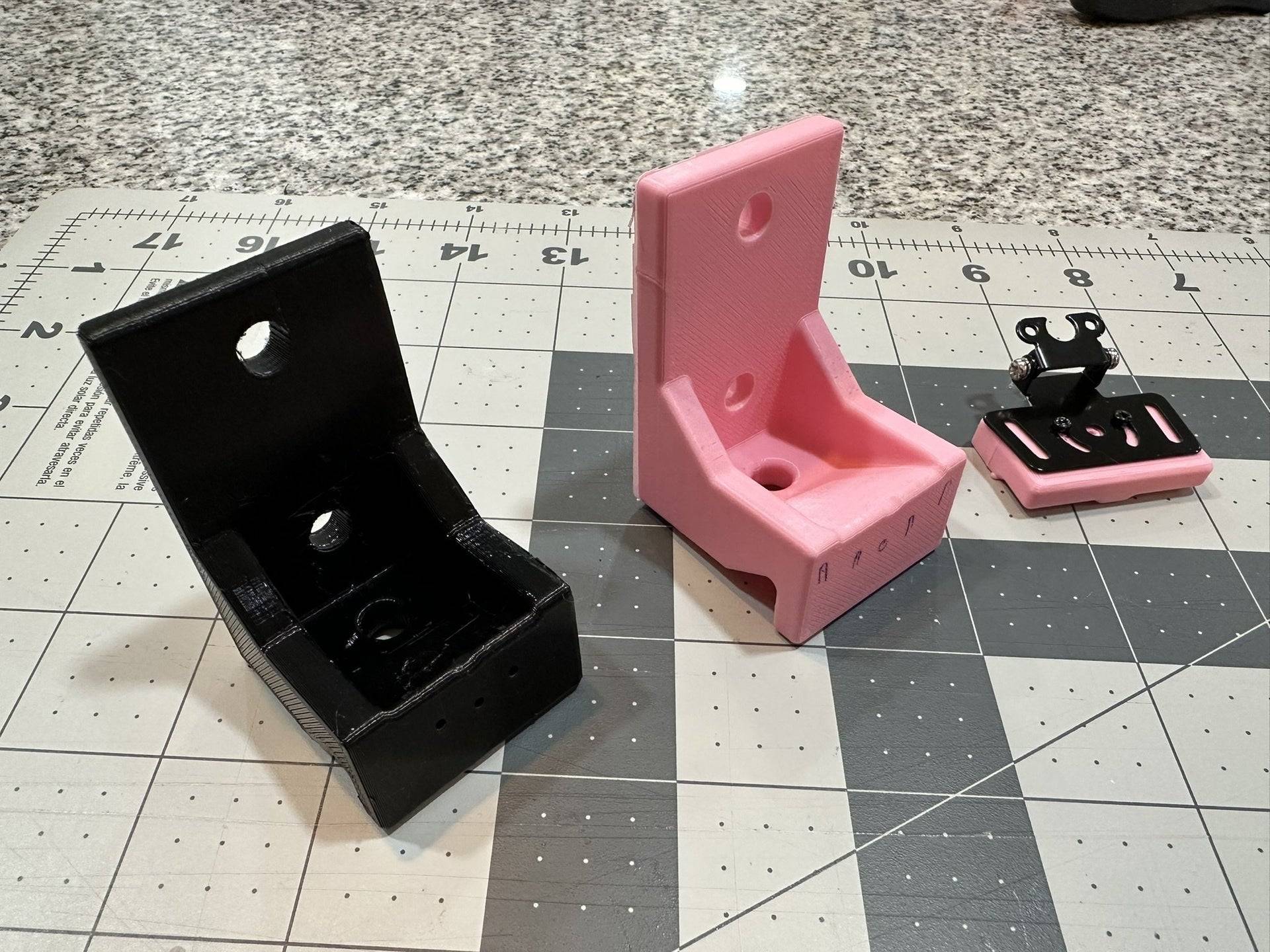

I took some measurements and modeled up a mount in Solidworks and tried out the prototype.
Jeep Gladiator Wolfbox G900Tripro Install and Review (another one) img_4379-jpe
It need a few little tweaks, and I ended up with this.
Jeep Gladiator Wolfbox G900Tripro Install and Review (another one) img_4403-jpe
Jeep Gladiator Wolfbox G900Tripro Install and Review (another one) img_4404-jpe

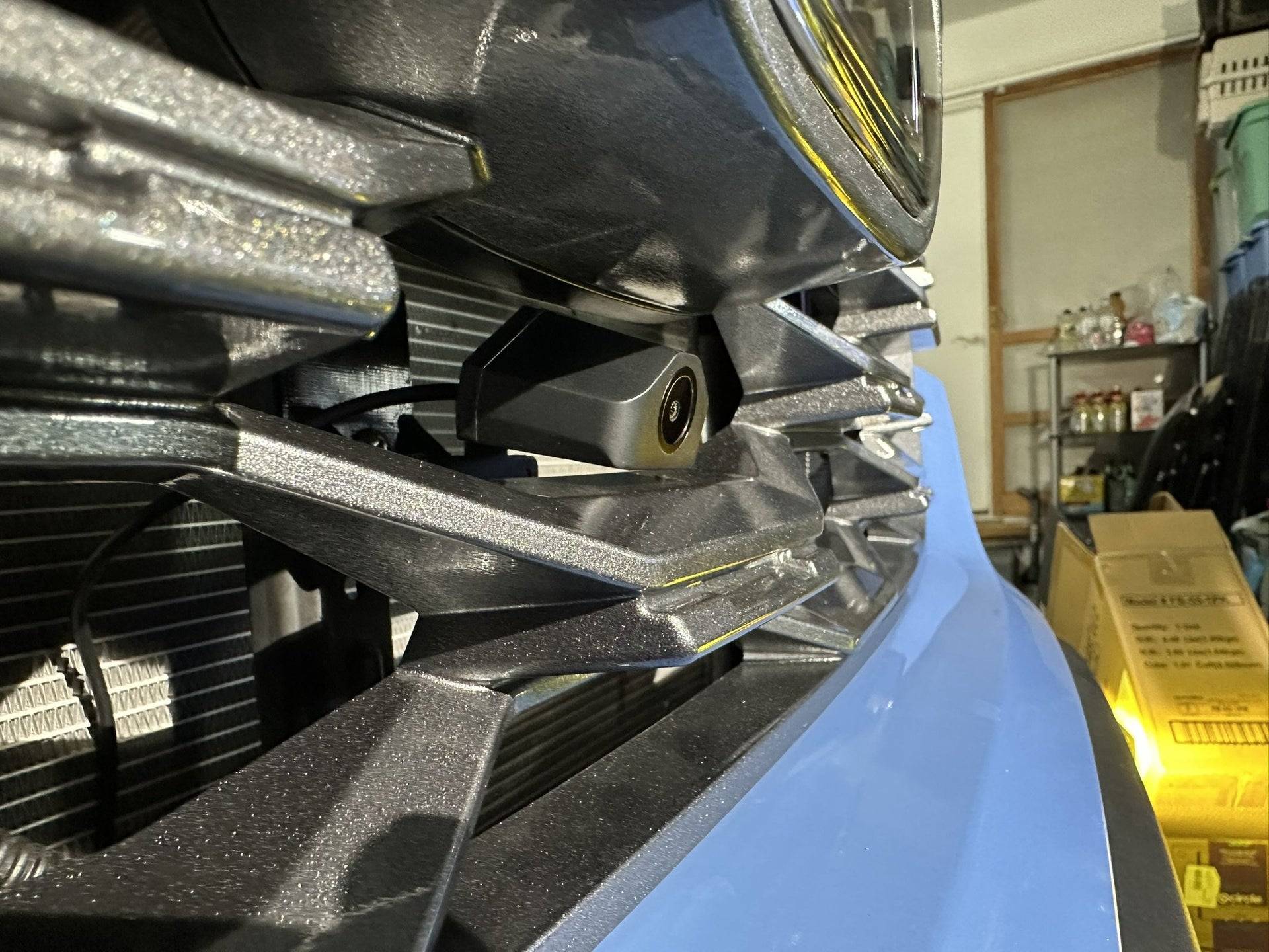

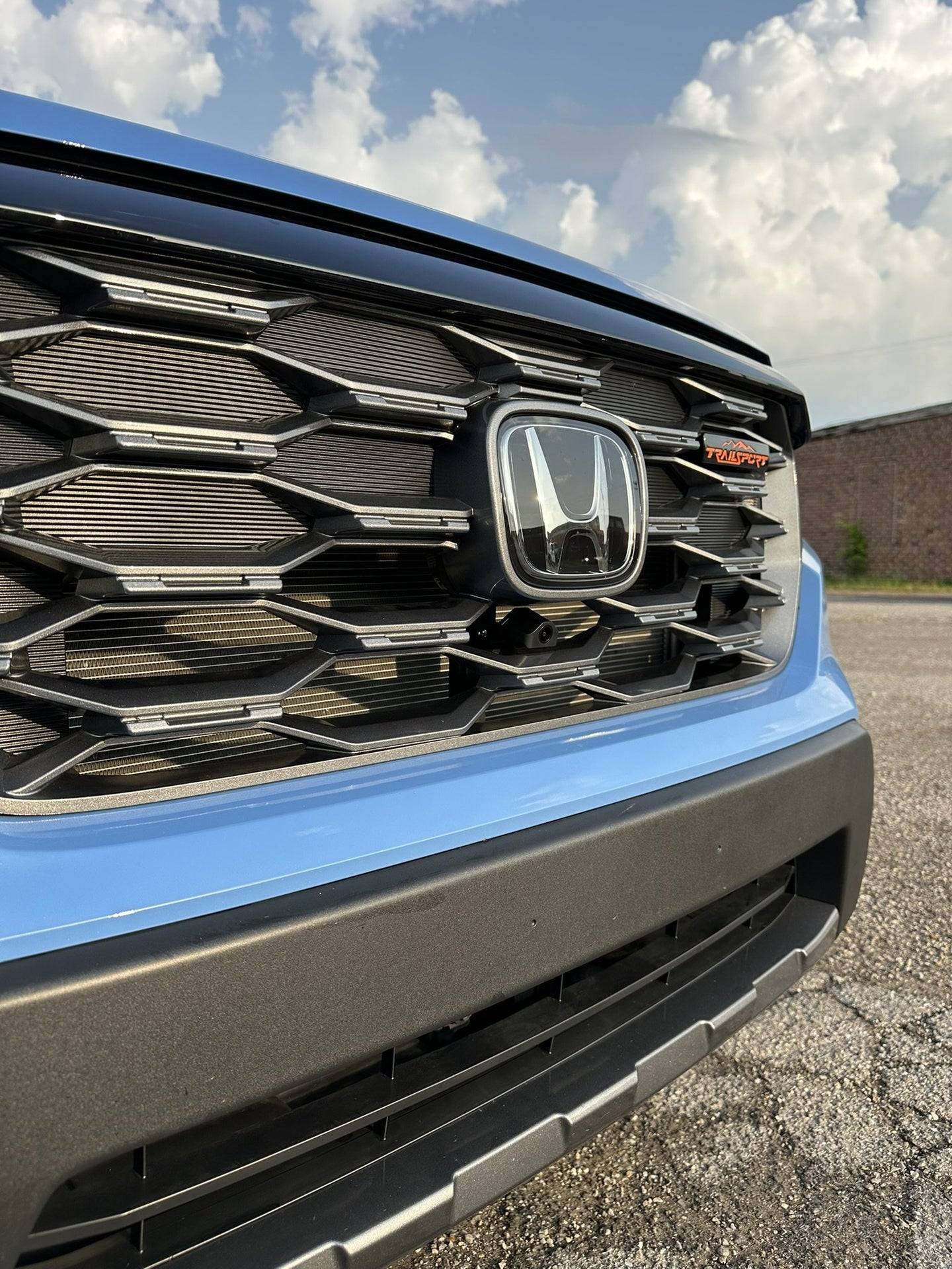

The final product fits great. If I were to do it again, I would make the install a bit more user friendly. The screws are right behind where the camera mounts, but it gets pretty tight there. The best way would be to pull the grill, but there are a couple screws at the bottom corners that look to be a pain. I used a thin phillips and got everything tightened up.
Jeep Gladiator Wolfbox G900Tripro Install and Review (another one) img_4409-jpe
Jeep Gladiator Wolfbox G900Tripro Install and Review (another one) img_4414-jpe
