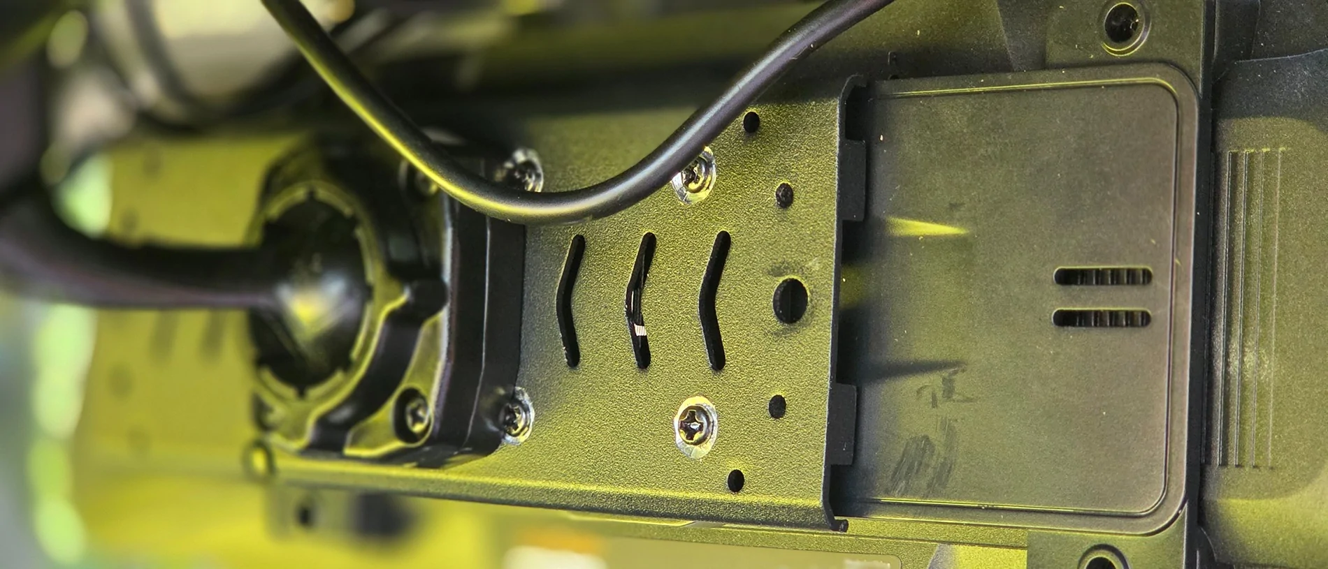

It does impede the sun visors a little. I purchased the optional mount that allowed the Wolfcam to be mounted to the stock location inside the ACC box. Unfortunately, the ACC box blocked a large portion of the front camera, so I created an offset plate that mounts between the Wolfcam and the mount. It moves the entire Wolfcam about an inch to the left, so it no longer interferes with the passenger side visor and lessens the area blocked by the ACC box.

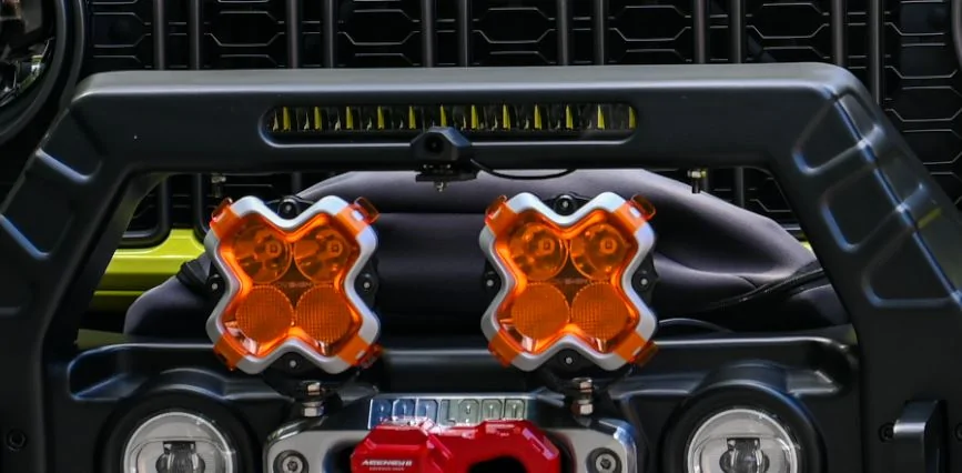

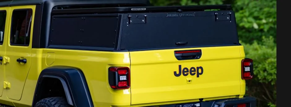

I've got the front and rear cameras mounted outside the vehicle and use the rear camera as my rearview mirror.

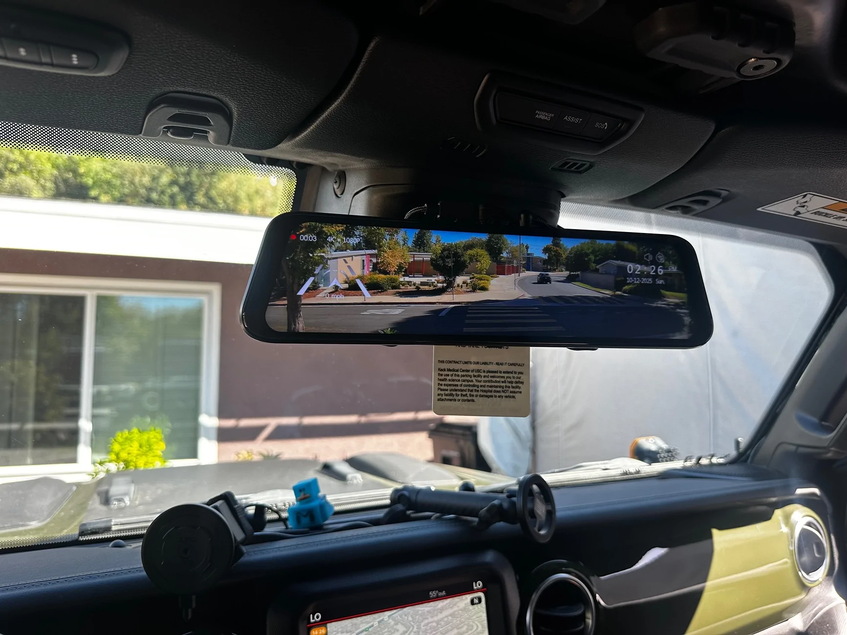

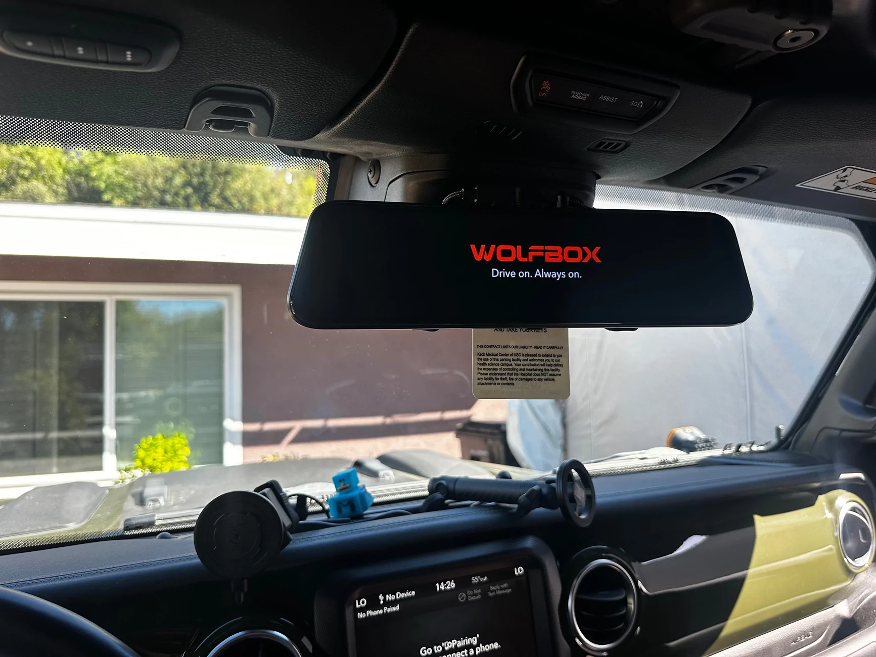

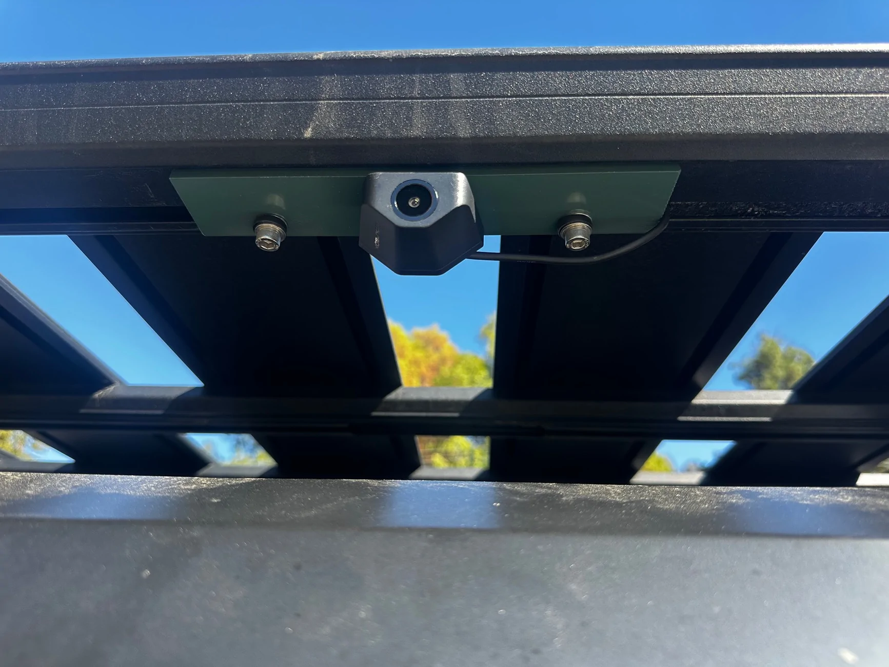

I installed the cheaper version to help seeing past the Smartcap. Overall really happy with it. It does hit the visor when flipping, but just turn the mirror to the side and back. Mounted the camera on the rhino rack platform. Needed to buy the longer camera cable. Didnt hook up the reverse lines wire since there is a regular back up camera. Nice to see those little cars hidden behind me now!
