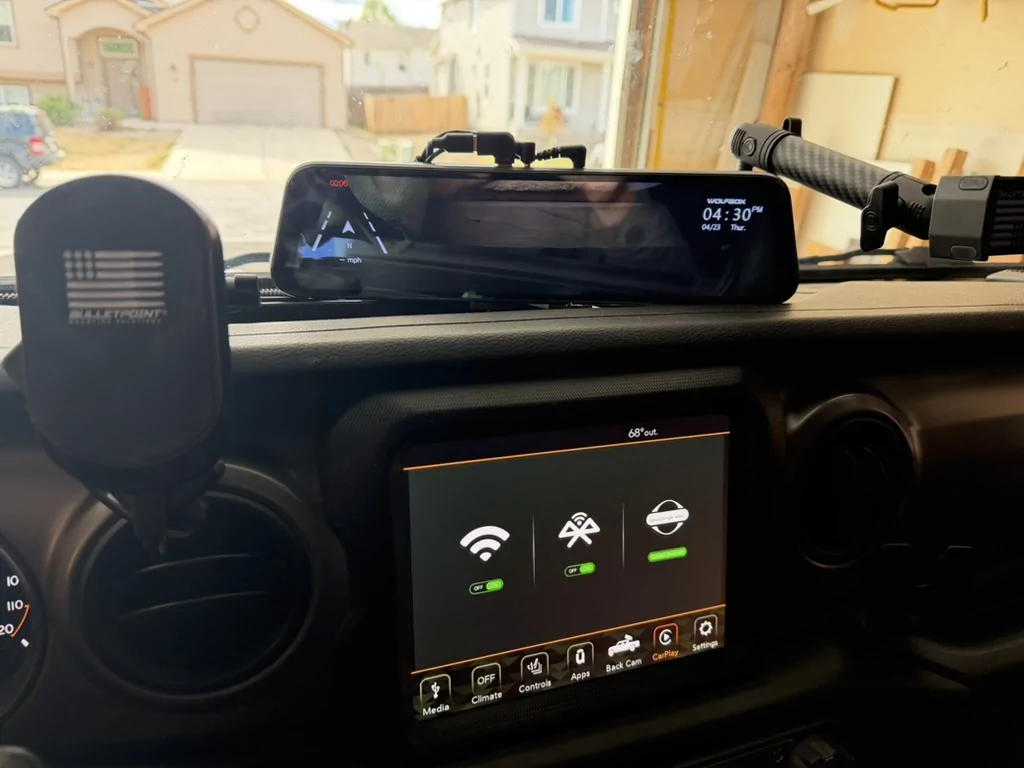

I already had the bulletpoint drivers side mount, so I used their parts (passenger side mount with standard arm and wolfbox mount) and have been pretty happy with it. you do get a bit of glare at times, but i'm ok with that for being able to easily see out of the window now.

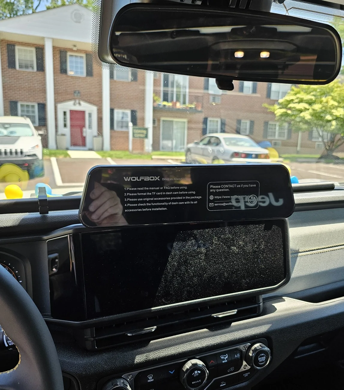

So far I installed the anvil overland mounts and the wolfbox screen. Took a little adjusting to get it where I wanted it but overall happy with where its mounted. Still have to wire it up and mount the cameras.

Suggestion on mounting cameras. Mock it up with some folded over duct tape before you use the adhesive pad. I had to move mine around a few times before I was satisfied. Look at them day and night before you finalize.
