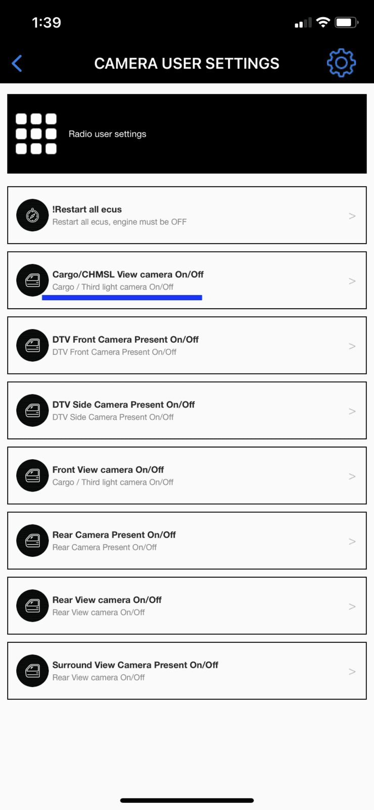

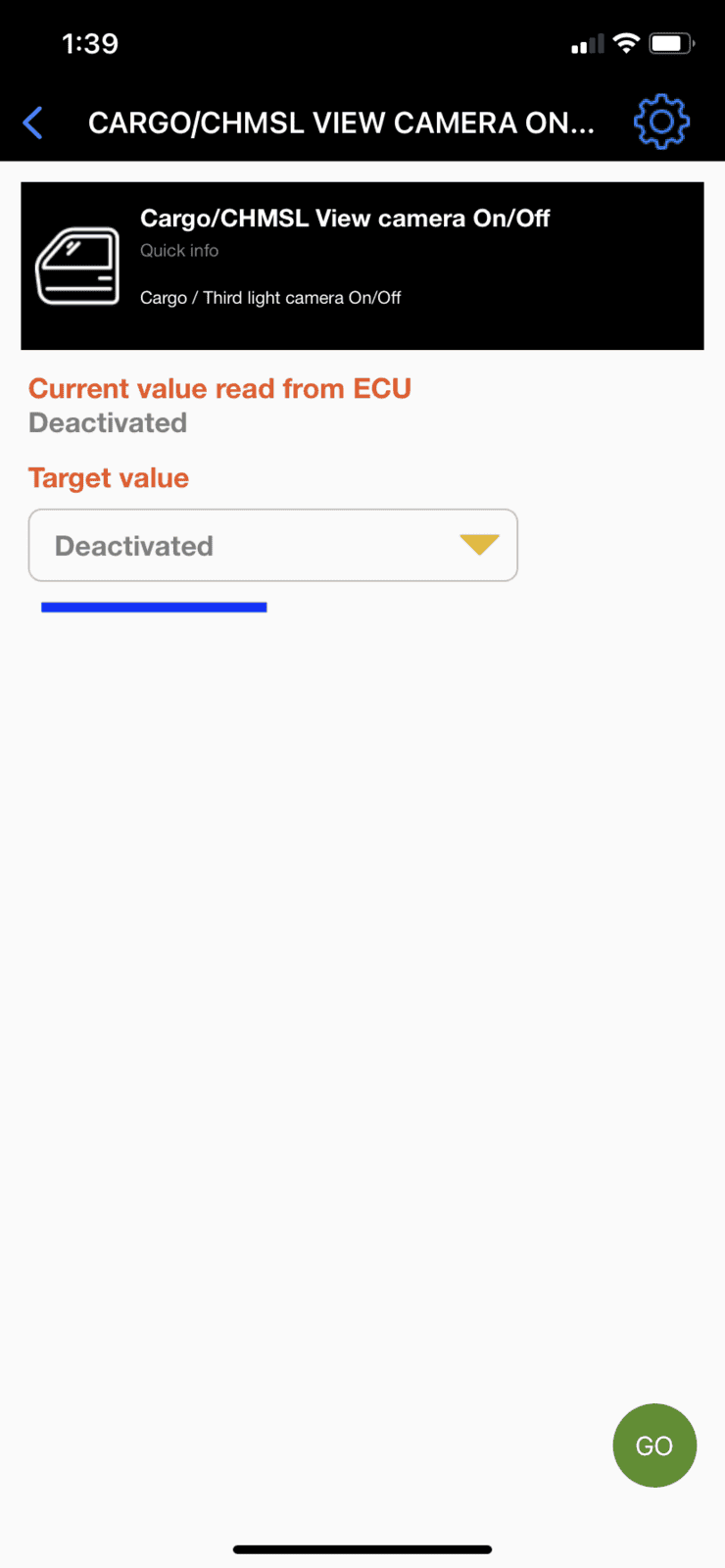

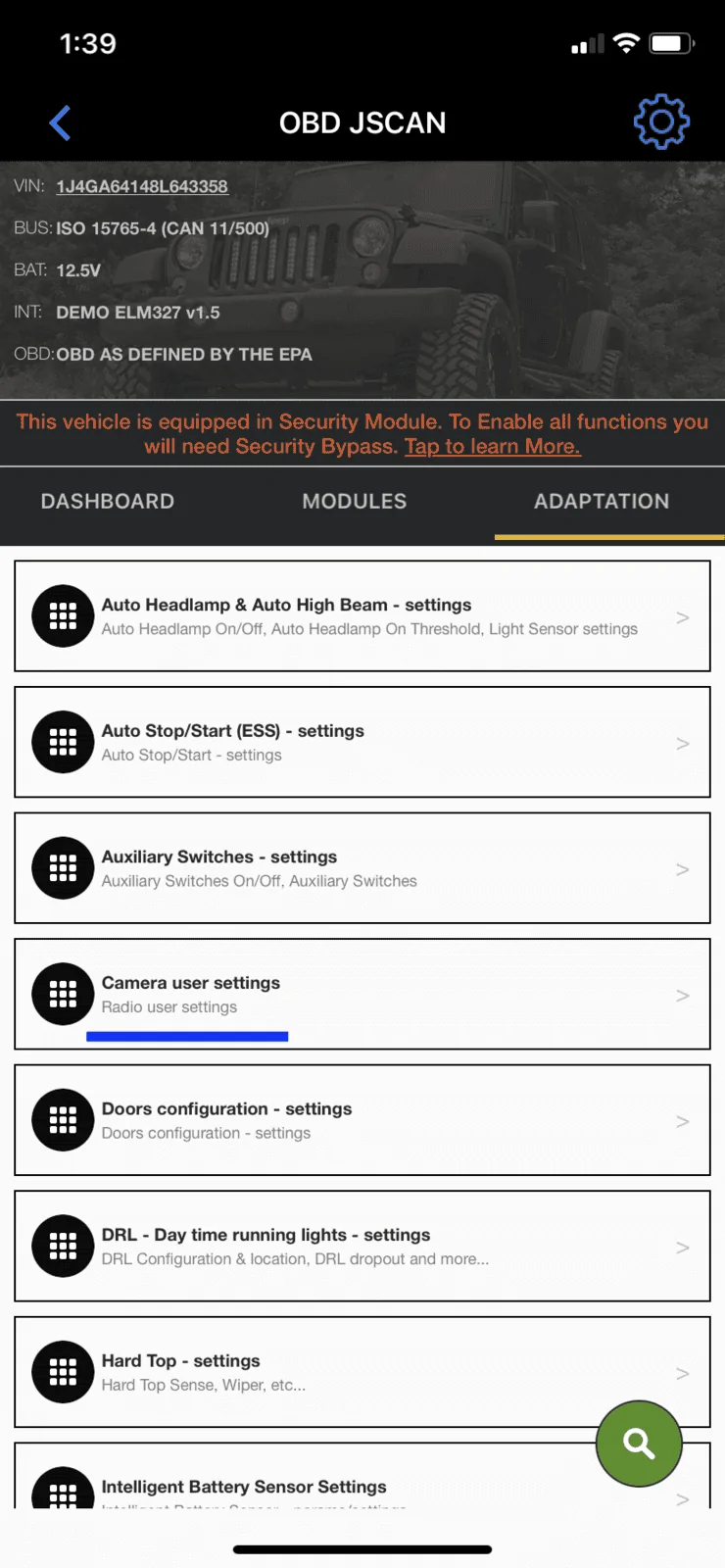

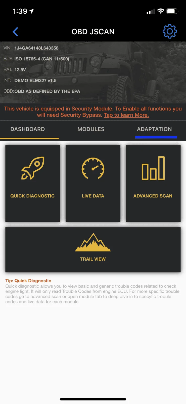

Without having the actual Front camera from the factory, you need to look for the Cargo Camera settings.
Jeep Gladiator Enable AUX video input on 8.4 with JScan IMG_0556
Jeep Gladiator Enable AUX video input on 8.4 with JScan IMG_0557
