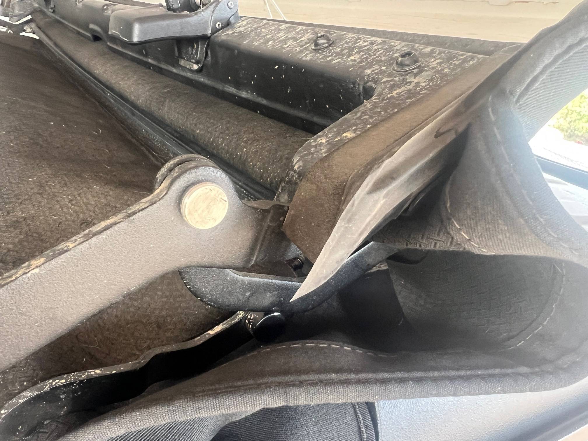

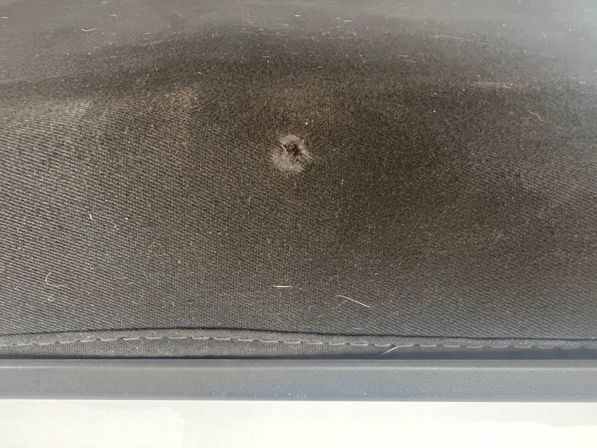

I love my Bestop Sunrider on my JT. It has been on three different vehicles now, so it is getting some wear and tear on it. I don't think this is Bestop's fault!

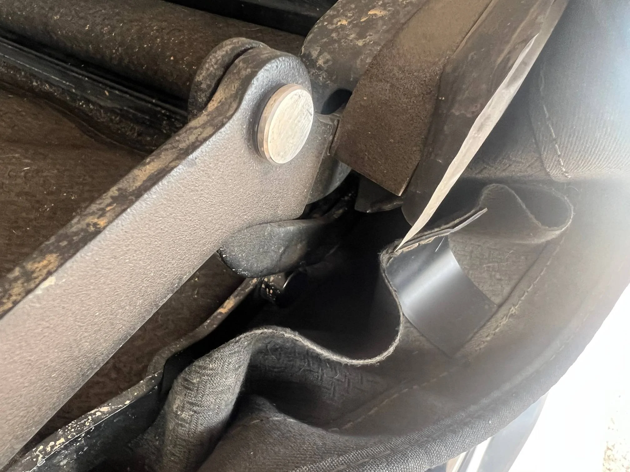

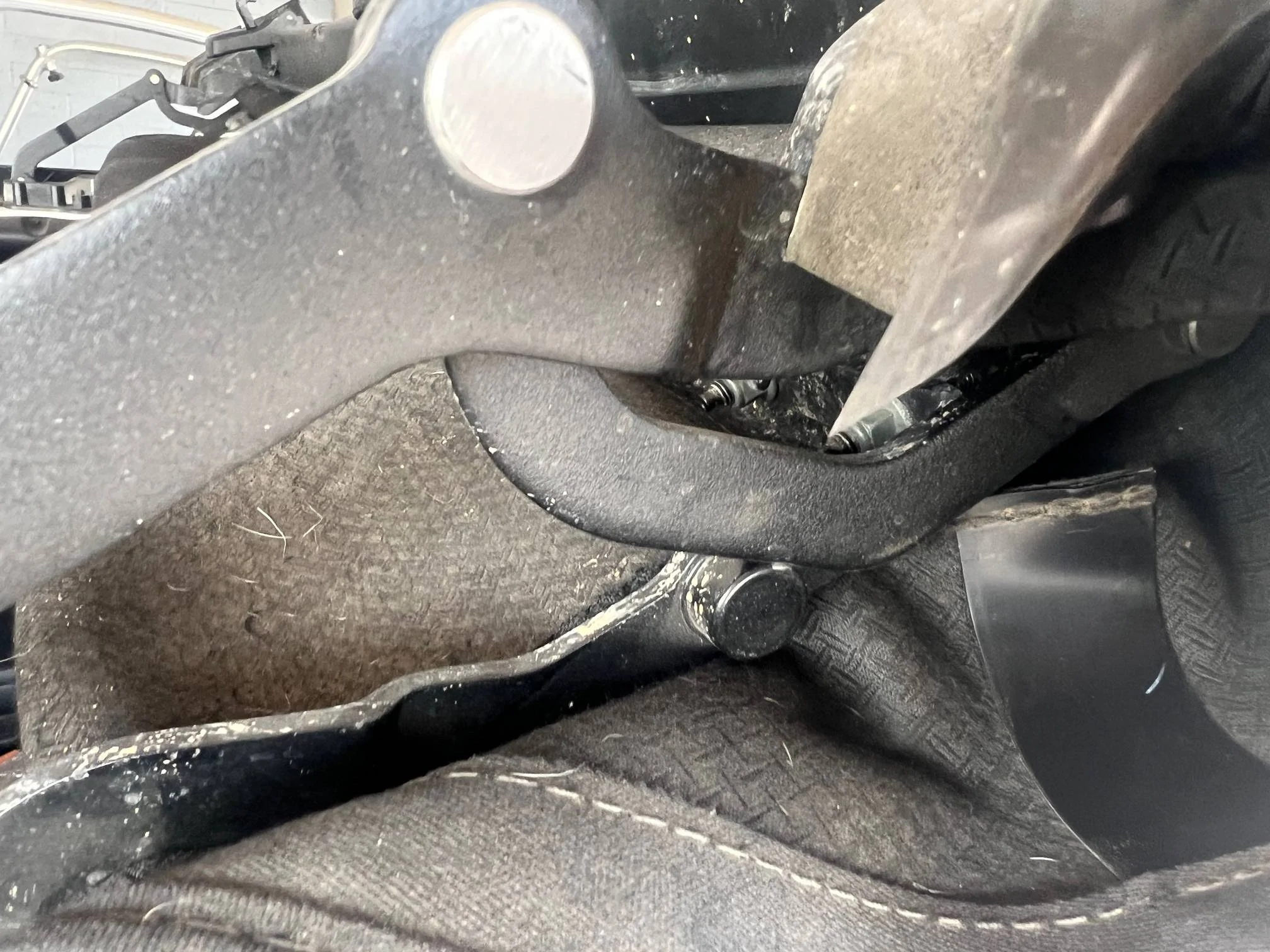

I just wanted to share this so maybe I could save you guys some money. I noticed that my Bestop Sunrider had a small hole in it. When I inspected the top I found the problem. The material was rubbing on the frame. The top was actually designed to prevent this, but my material had folded the wrong way. Check along the edge of your top and make sure the folded over material is under the frame, not above it like mine was. There is actually a plastic strip of material that I think is made so it holds the material straight and under the frame. I hope this post saves some of you from getting a hole like me!
I patched it with this fabric tape which seems like it will be a good fix.
