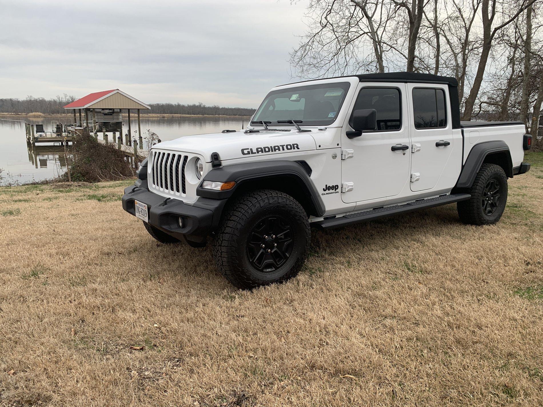

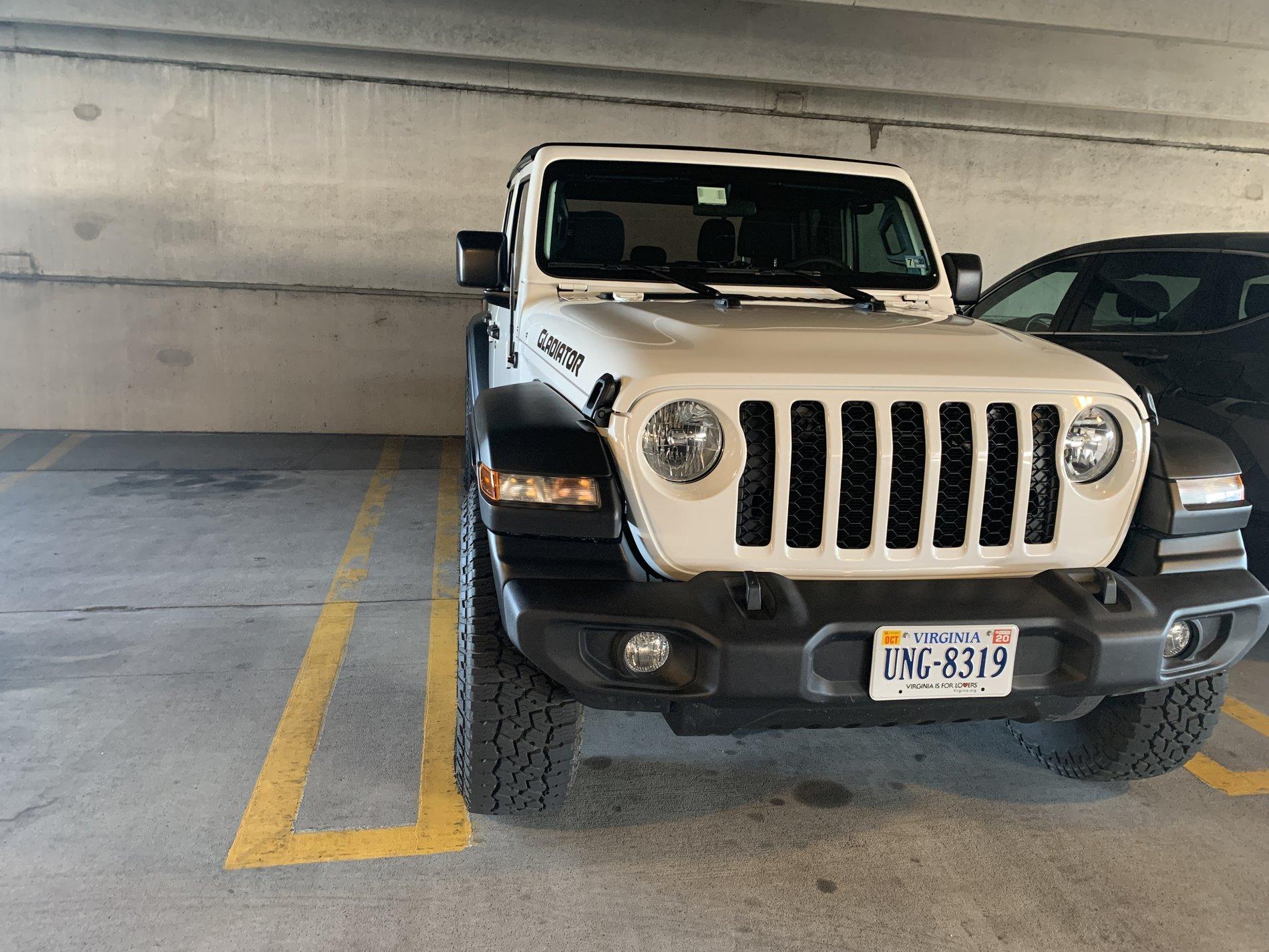

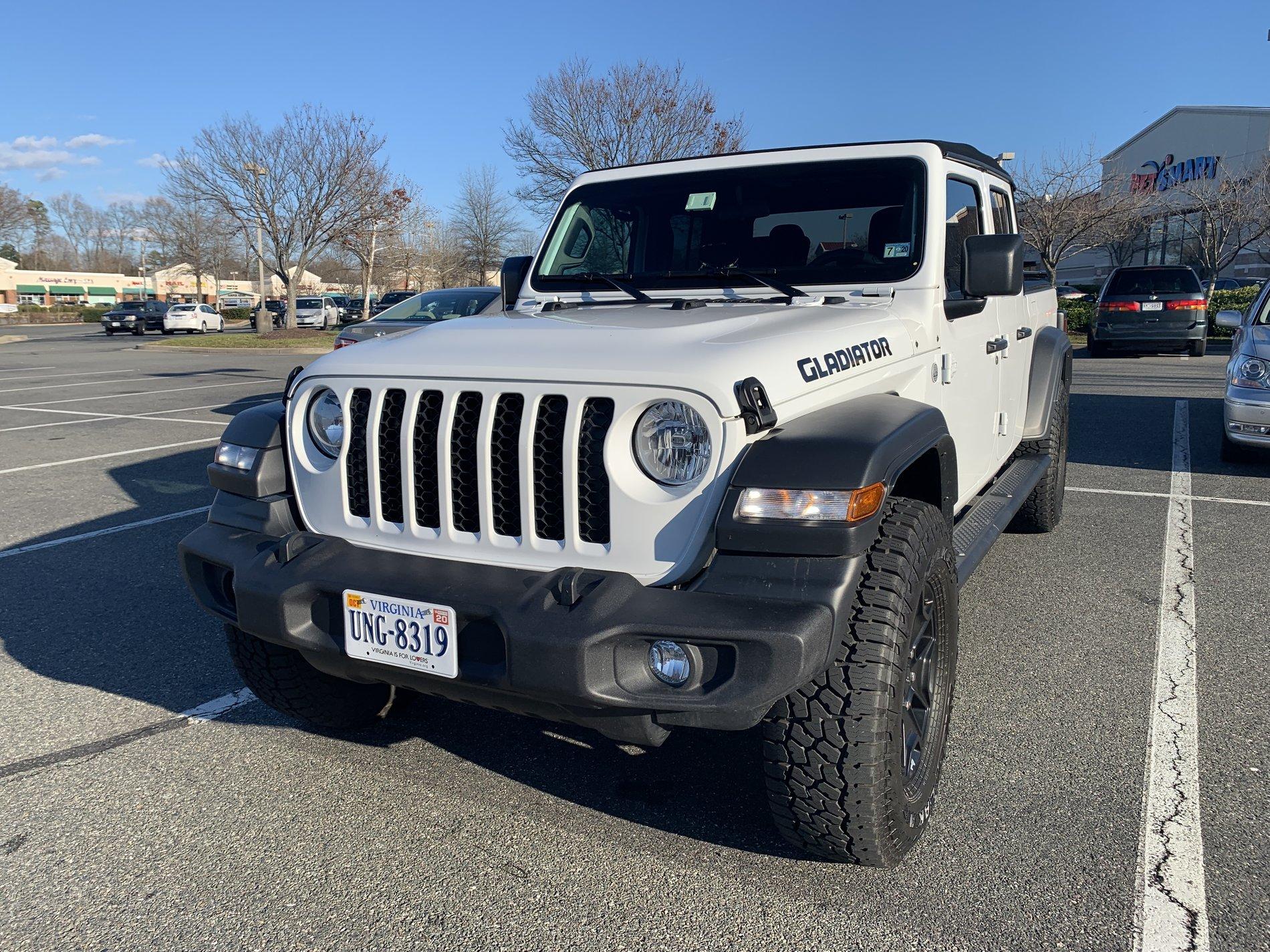

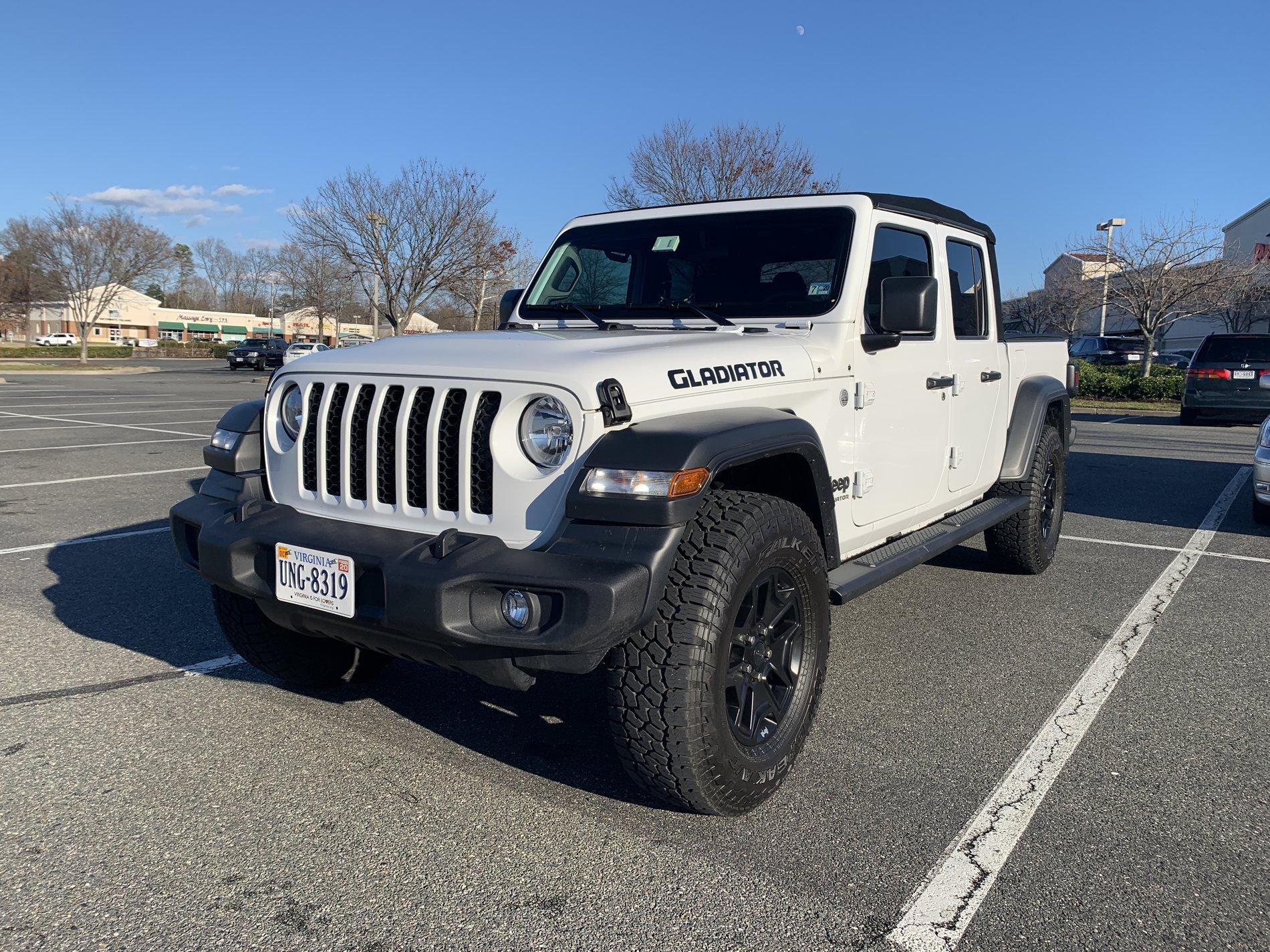

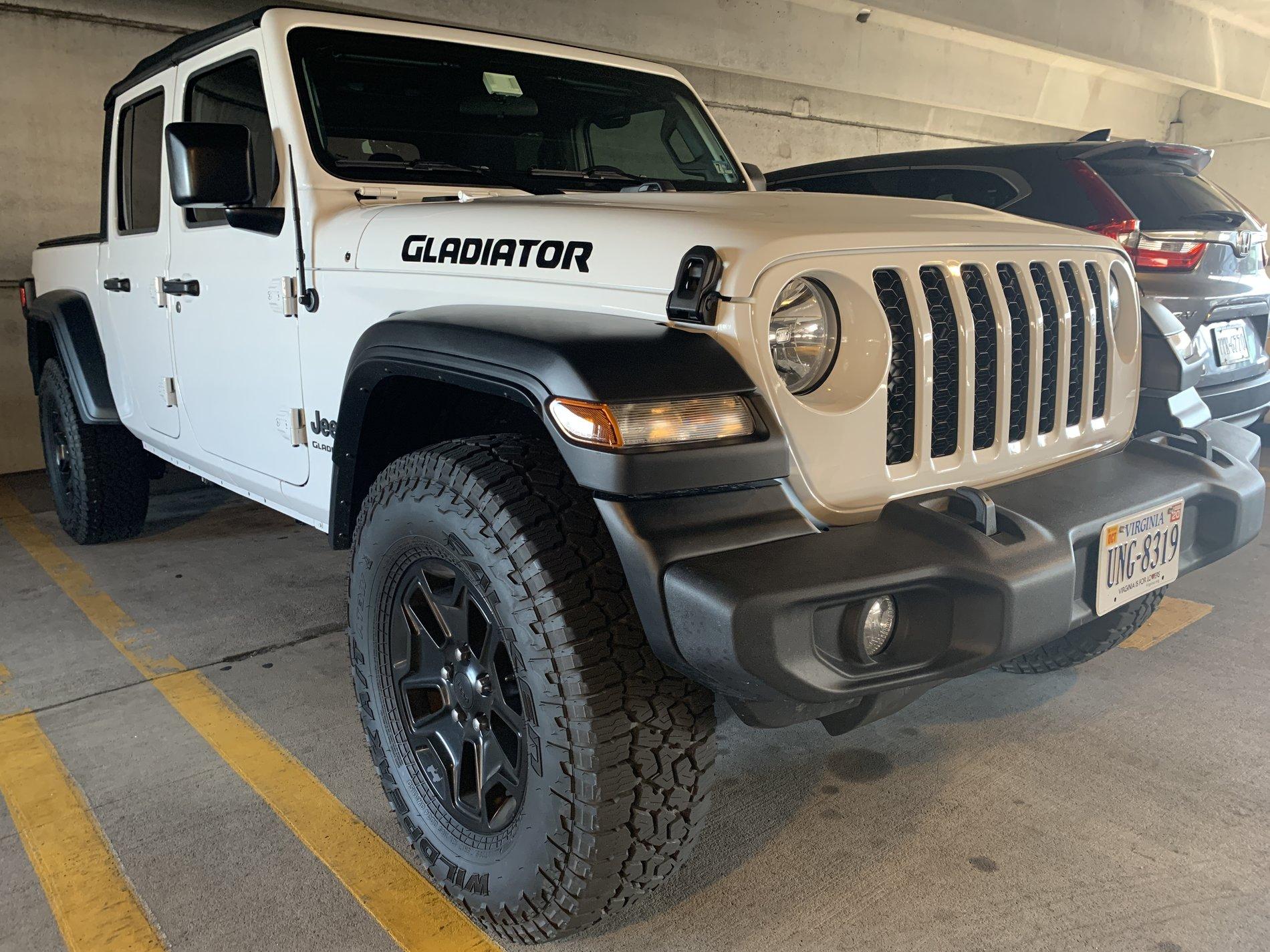

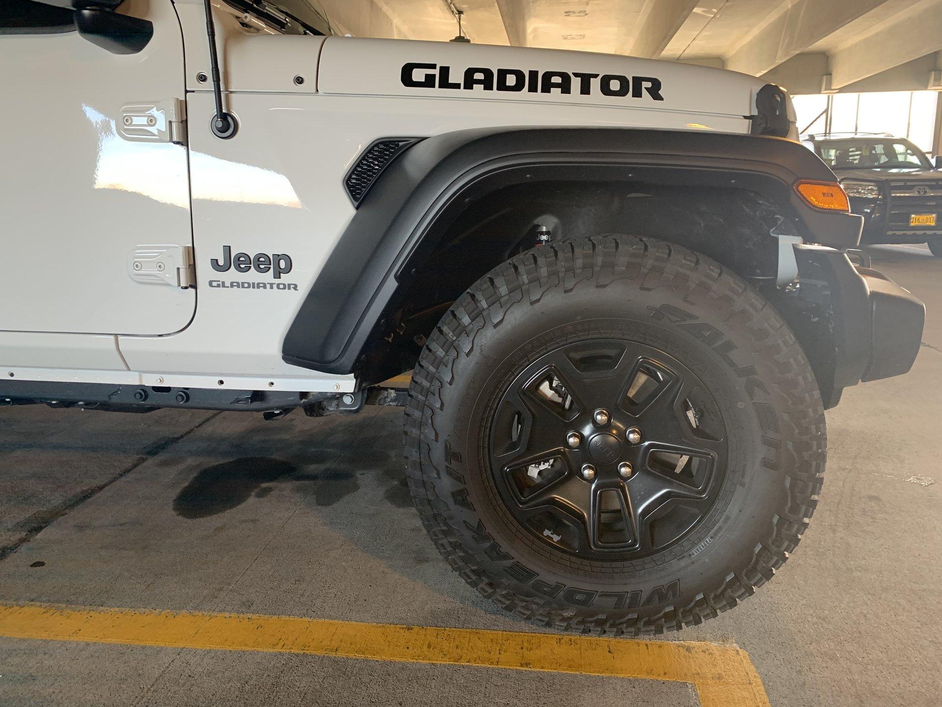

I put the 285/75r17 wildpeaks on my sport and it drives and handles great. Super impressed with the handling, especially in rain and how quiet they are. I have Rubi take off black rims which are the same size as stock rims and no rubbing and didn’t have to take off the air dam. If you go with mud terrains they def be louder. I’m pretty sure this is the biggest size tire you can put on without altering anything ...
