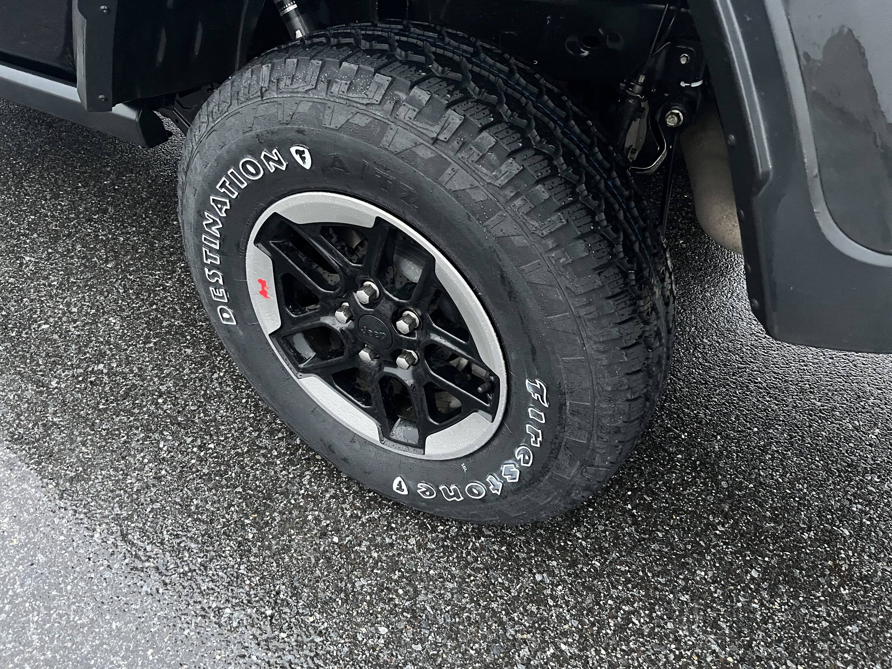

I run 255/75/17s. I absolutely loved a set of bronco take off Dueler ATs I had but the tread wore down faster than I wanted.

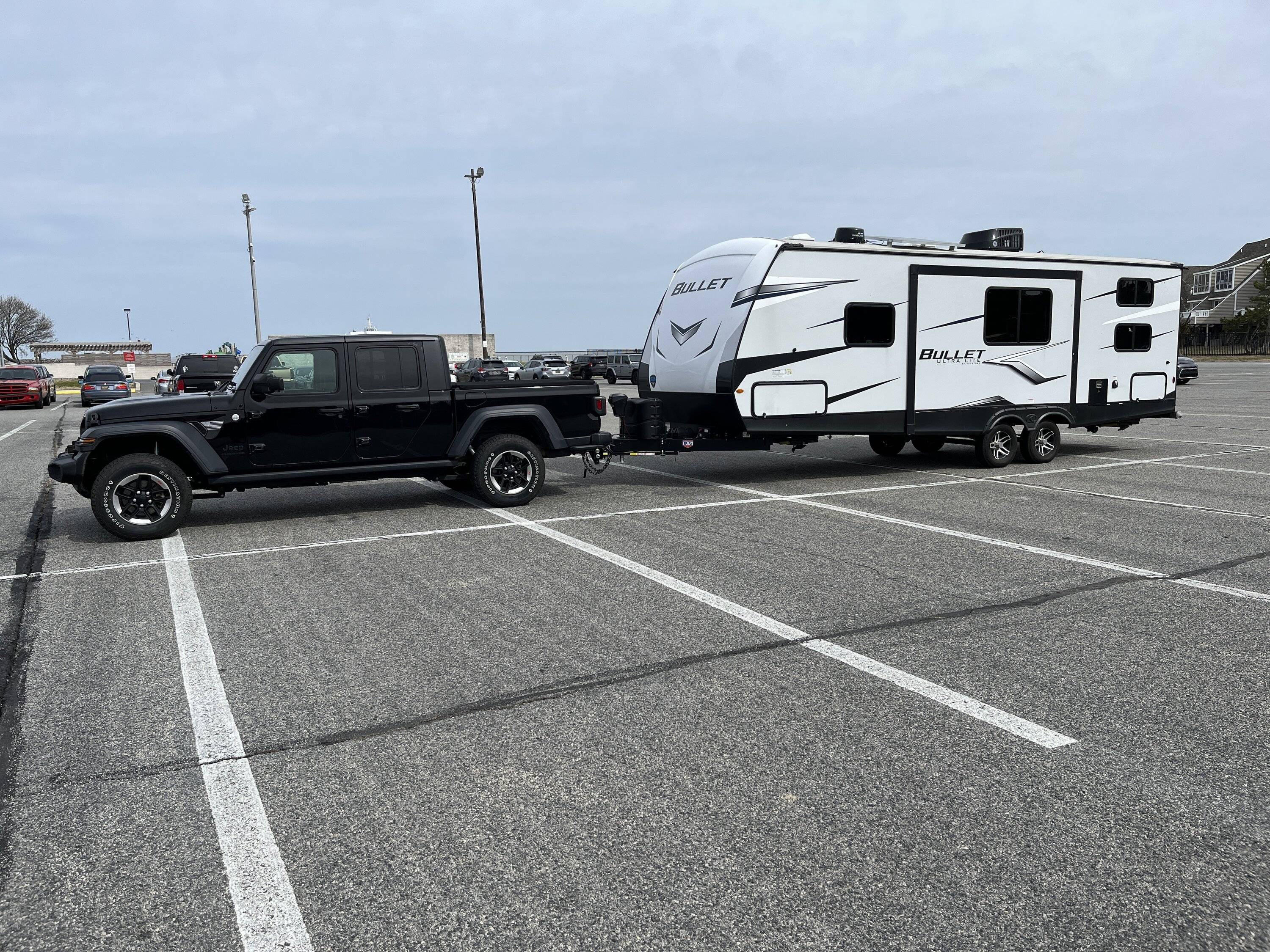

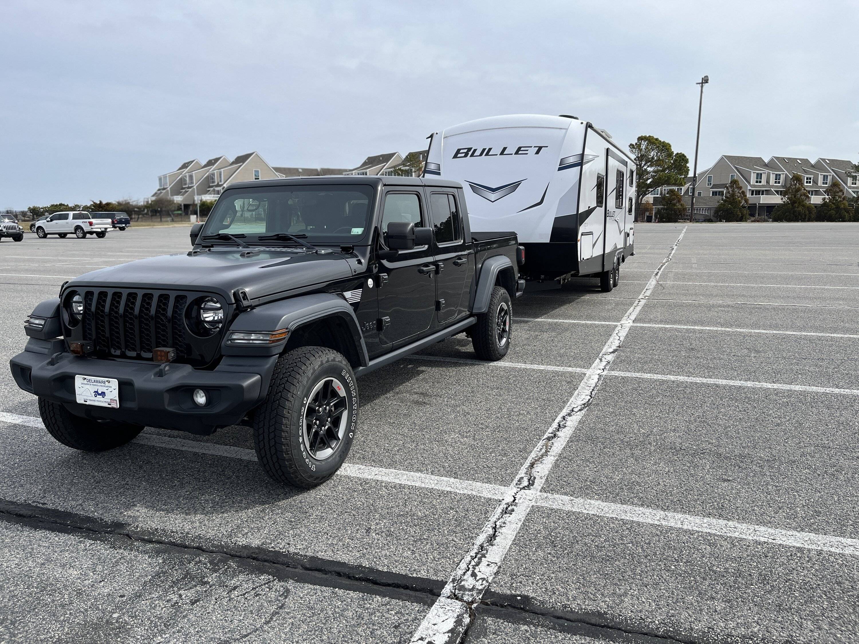

Currently I have 255/75/17 Firestone destination AT2s. These tires have been fantastic! Low rolling resistance, just as quiet as the OEM duelers, the JT shifts at the same points as the duelers, I get the same MPG as the duelers, and they look great IMO. Theyre 113T so they carry just a bit more weight than the standard 112 duelers, which doesnt really matter but it makes me feel better. They handle my 6,000lbs travel trailer great so far. My last trip was about 90 miles one way, not far but it was a good test and the tires did exactly as good as the duelers did. They went up about 3-4d during the trip with the extra load.

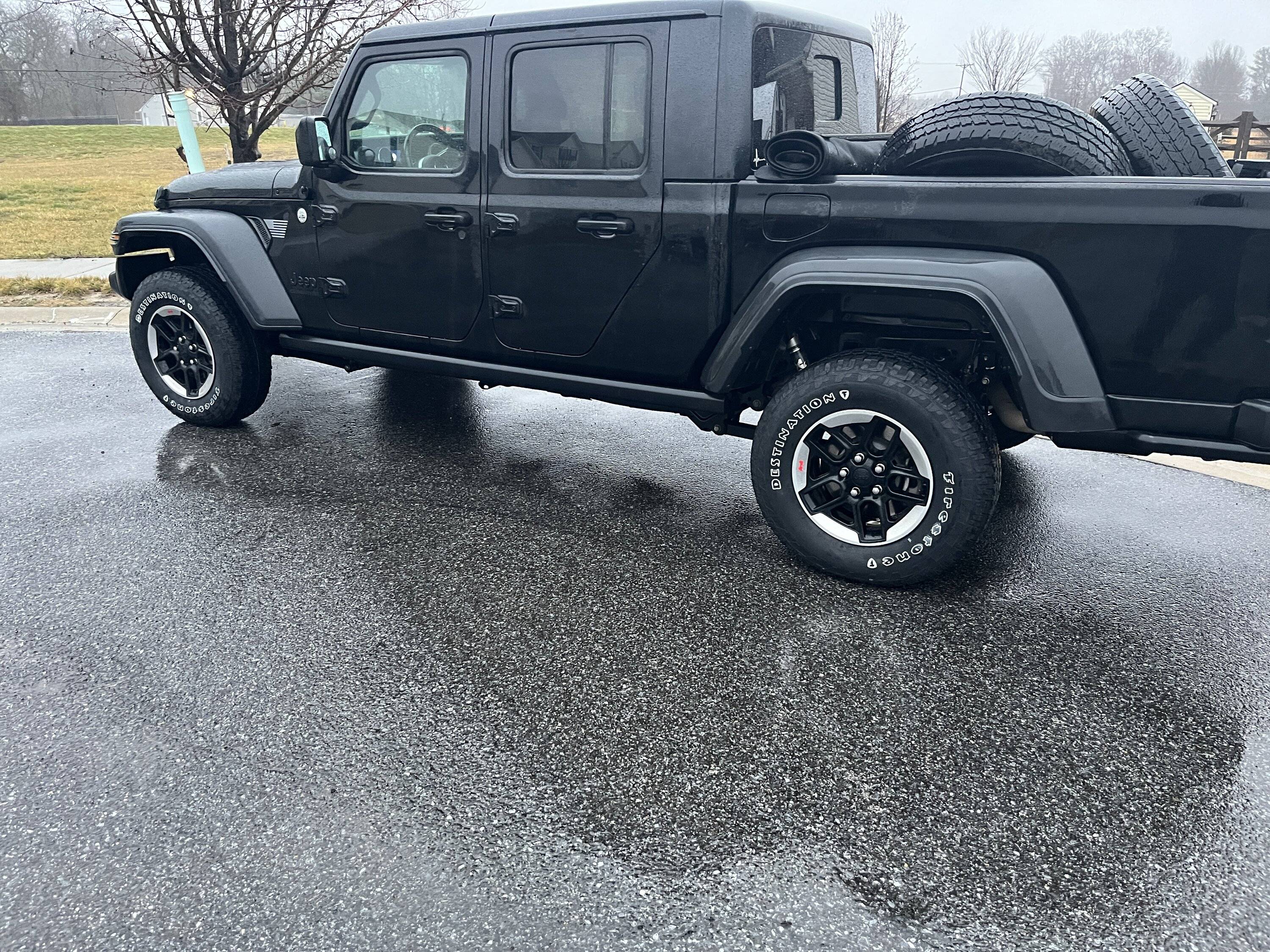

I had my bags inflated and I have a 2in lift. So don’t mind the space between the tire and fender. It’s larger than it will be on stock.
