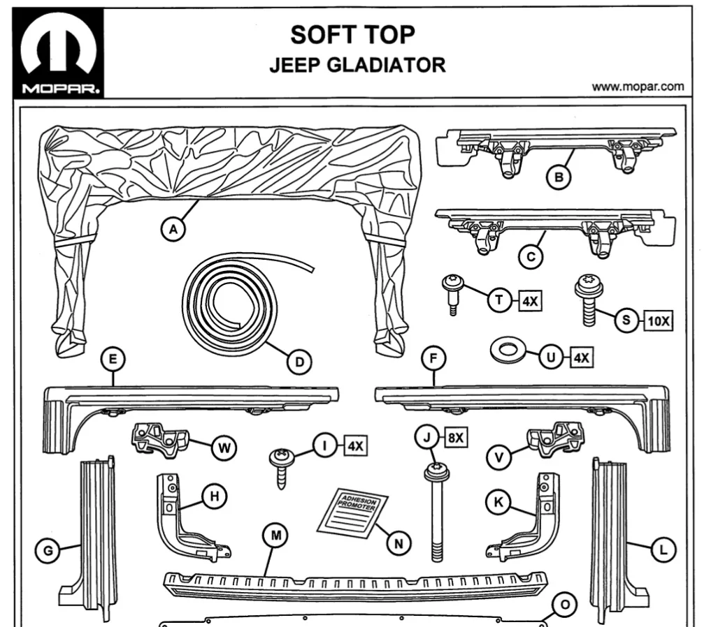

Hey guys I'm hoping one of you can help me out. I sold my Gladiator with the hard top on it, and now when I went to sell my soft top, I realized that I left the bolts in the Gladiator. What bolts are needed to secure the the soft top in place? I know there are a bunch of bolts in the back, but I believe they are the same bolts that are used to secure the hard top. As I remember, there are just two bolts above each door that are needed, but some pictures or guidance would be very helpful. I called the local Jeep dealer and they can't tell from the schematics what is needed either.

Download the installation instructions from Quadratec to see what you're missing. Here's a link.
https://www.quadratec.com/sites/default/files/installation_instructions/2019_09_18_11_06_06.pdf
Here's a pic of the page that spells out the total number of bolts. You're probably missing: "S" bolts for the rear window base, & "J" bolts for the door surrounds.
I assuming you did not remove the 4 screws & washers ("U" & "T") that hold the Rear Door Surrounds together, OR the 4 screws ( "I" ) that hold the base of the rear window together.
