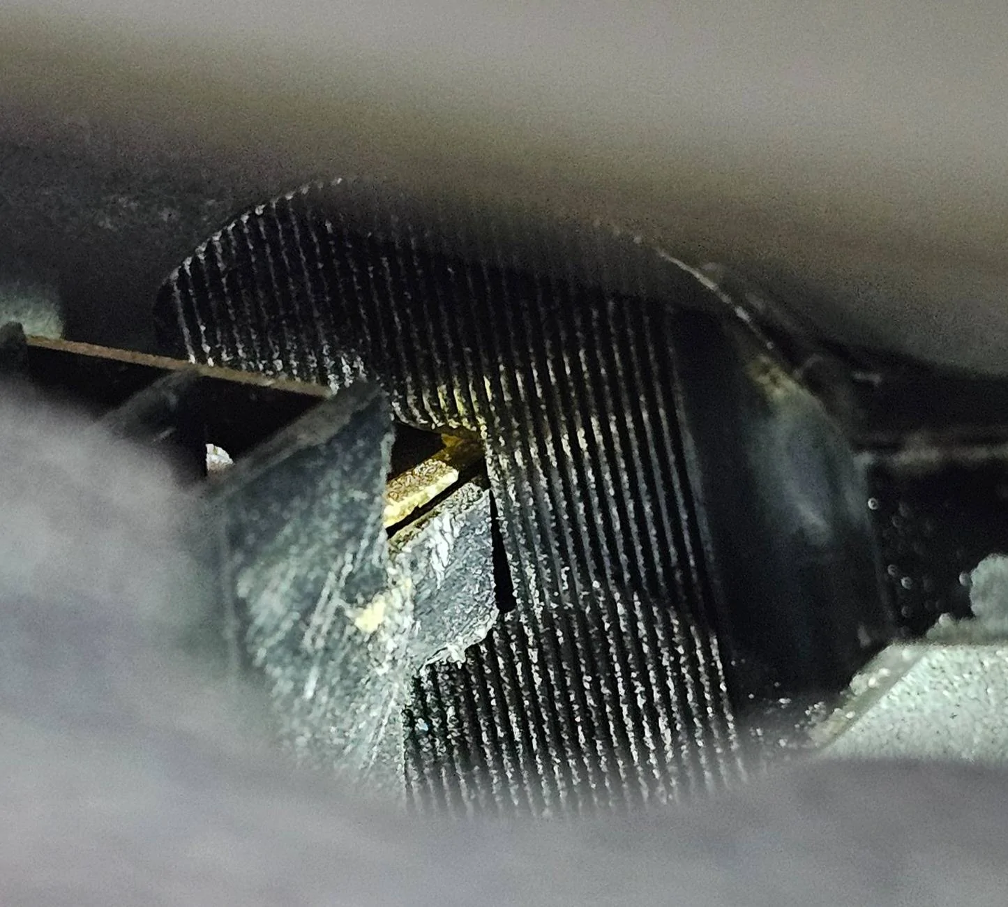

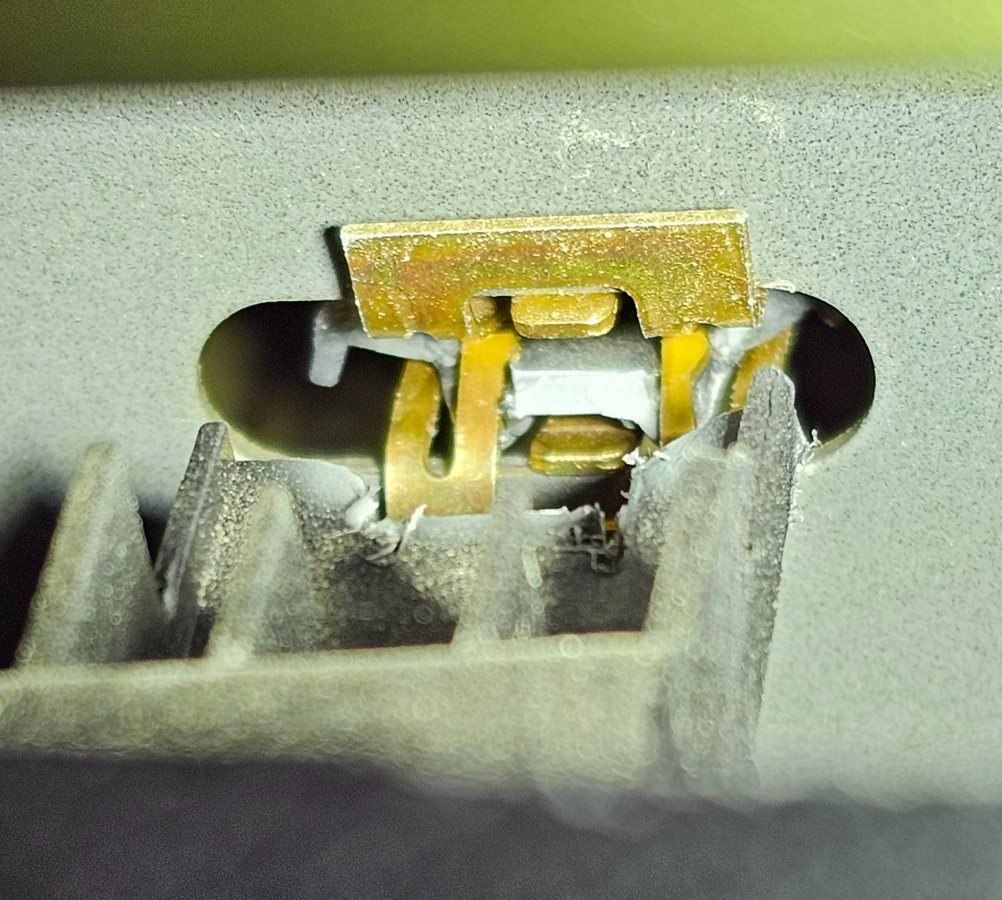

I also started with pry tools and just figured from what I was seeing that the rear panel was on top and didn't require anything else removed - all before I came here looking for help. The issue that you seem to make light of is how delicate those top clips are: they're lightweight plastic clipped into sturdy metal clips. The first one appeared to come off easily enough, but further inspection showed the plastic simply snapped off at the metal clip:
Jeep Gladiator HELP! Removing the rear and side interior panels… 20250504_173204

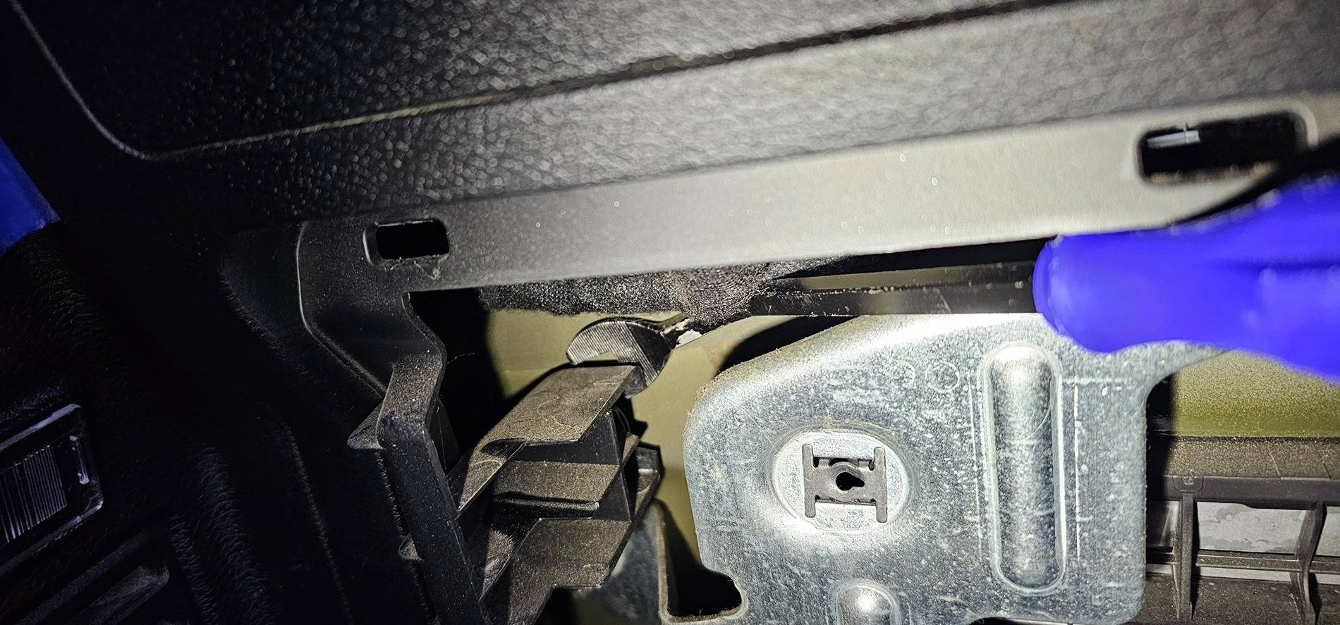

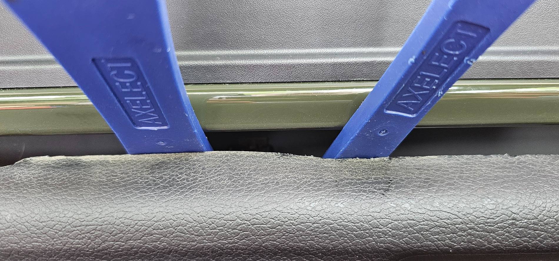

So then I read your comment and a trim tool on either side and a bit of a gentler, but steady pull:
Jeep Gladiator HELP! Removing the rear and side interior panels… 20250504_174109
and it doesn't look broke, but possibly deformed:
Jeep Gladiator HELP! Removing the rear and side interior panels… 20250504_173306

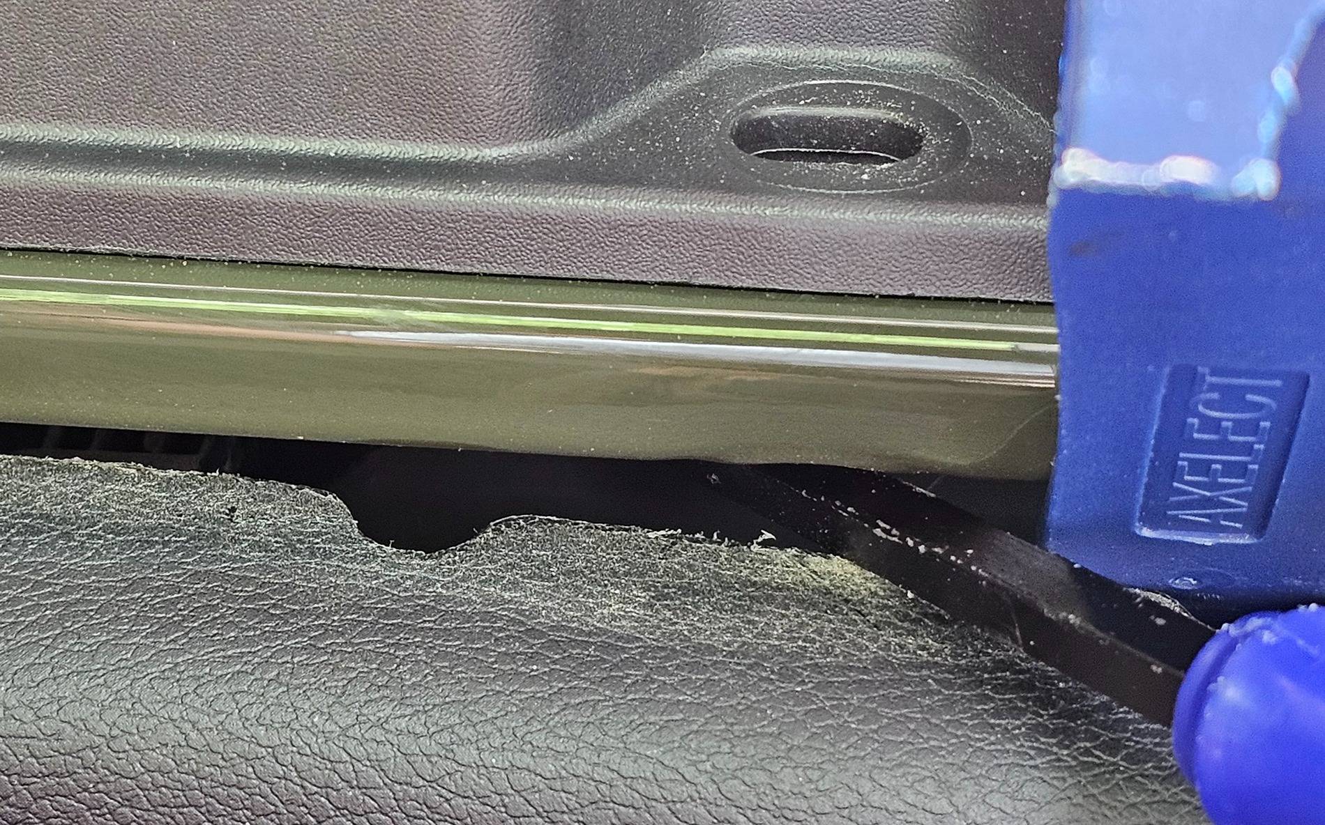

Then I tried something different.

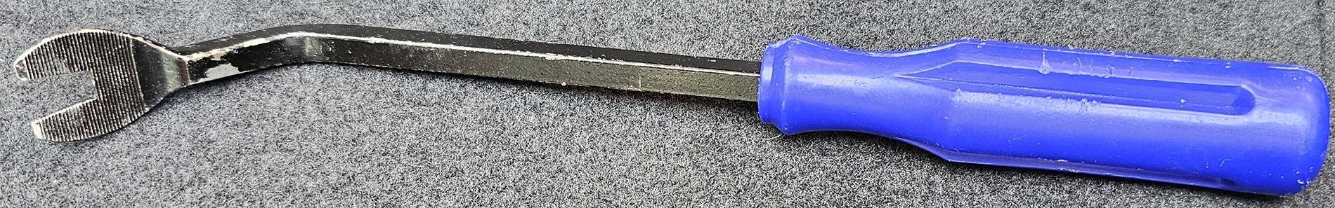

I pulled out this trim tool:
Jeep Gladiator HELP! Removing the rear and side interior panels… 20250504_173624

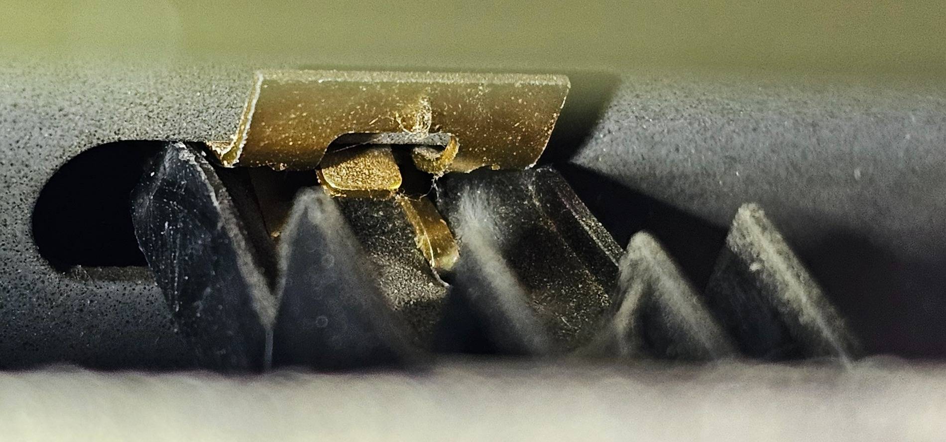

And using the relief cuts in the top of the trim panel that almost seem precisely for this purpose (pure speculation), I manged to get the tip right around that clip at the joint. I needed to remove one of the roof bolts to allow the arm to get the proper leverage: (below is how the tool sat before I leveraged it)
Jeep Gladiator HELP! Removing the rear and side interior panels… 20250504_173418
Then a gentle lever action, and the clip popped out of the slot cleanly and does not appear damaged:
Jeep Gladiator HELP! Removing the rear and side interior panels… 20250504_173553

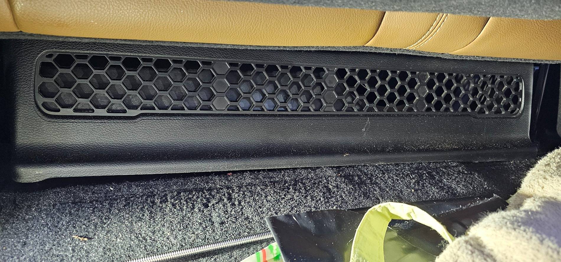

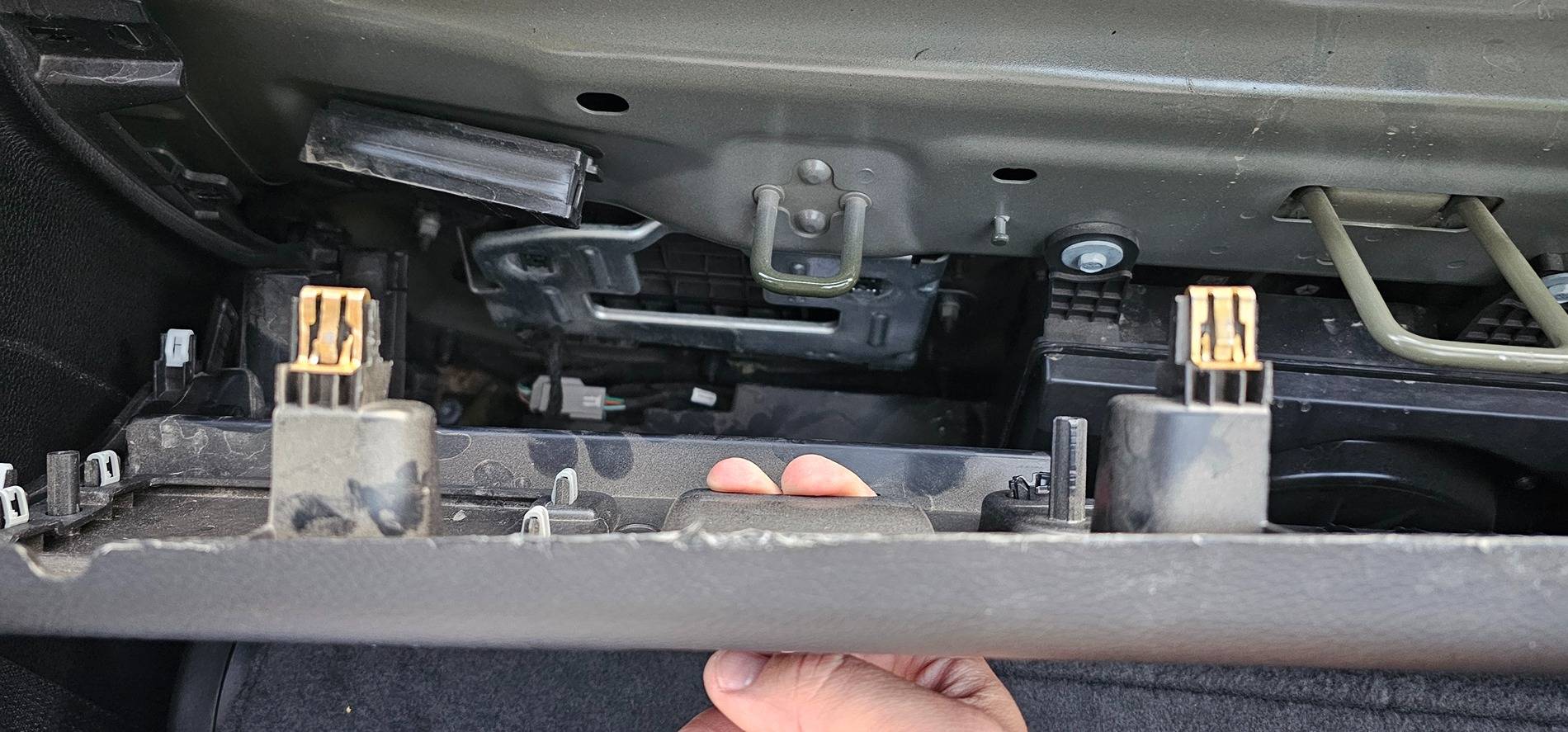

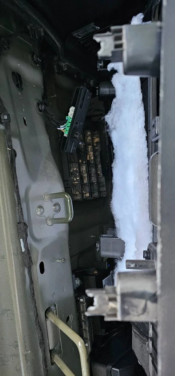

OK, so I don't think you can get that panel out completely without removing the passenger side seat pair.
The panel goes under the seats on that side:
Jeep Gladiator HELP! Removing the rear and side interior panels… 20250504_201709

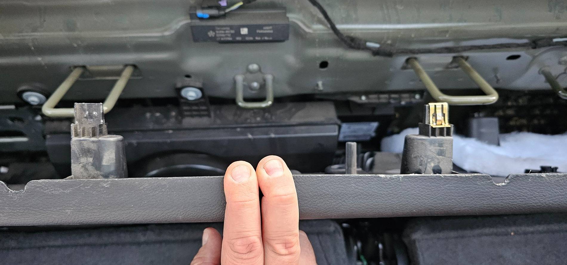

But here's the final top clip states - using the metal trim pry bar was definitely better for the clips, at the expense of the top lip of the trim getting scratched:
Jeep Gladiator HELP! Removing the rear and side interior panels… 20250504_201425
Jeep Gladiator HELP! Removing the rear and side interior panels… 20250504_201432
Jeep Gladiator HELP! Removing the rear and side interior panels… 20250504_201439

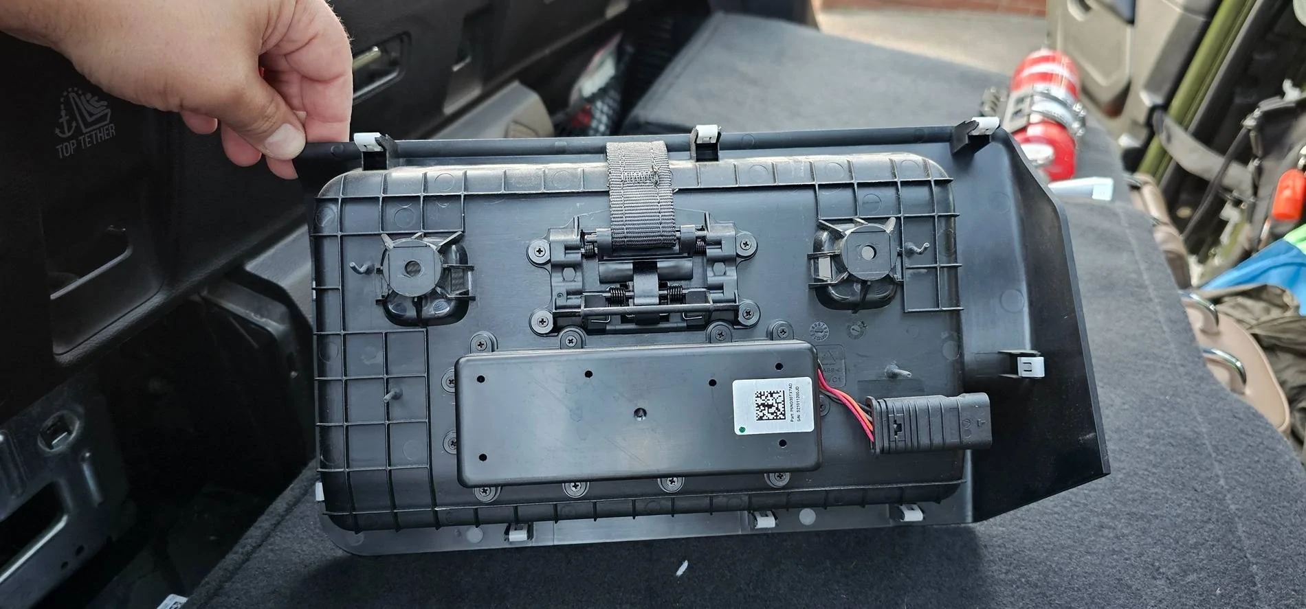

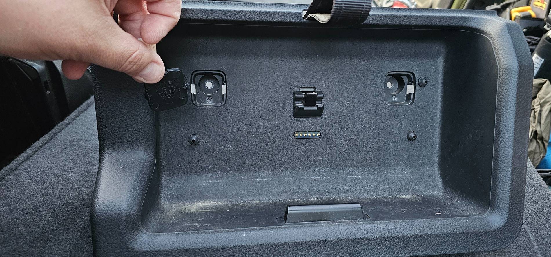

Also, there ARE screws on the passenger side, at least if you have the Bluetooth speaker - not sure if it's similar without it.
There are two, each behind their own small trim panel in the charging base (the piece in my hand is the little panel cover) :
Jeep Gladiator HELP! Removing the rear and side interior panels… 20250504_201835
And here's the back, so you can see the clips you need to break loose:
Jeep Gladiator HELP! Removing the rear and side interior panels… 20250504_201901
After getting it all done, I'd highly recommend starting on the passenger side, because pulling out that charging base (or I'm assuming a similar panel if you don't have that) gives you excellent access to get hands/tools in there:
Jeep Gladiator HELP! Removing the rear and side interior panels… 20250504_195427
which helps, because at least in my situation the lower clips were incredibly tight, it really felt like it was breaking before it finally came loose. Not sure if it's because mine is 3 years old or what, but the plastic felt tough and brittle.
I also highly recommend you do NOT drop your primary trim tool back there while trying to get the top clips off... It will definitely add some time to the process.
