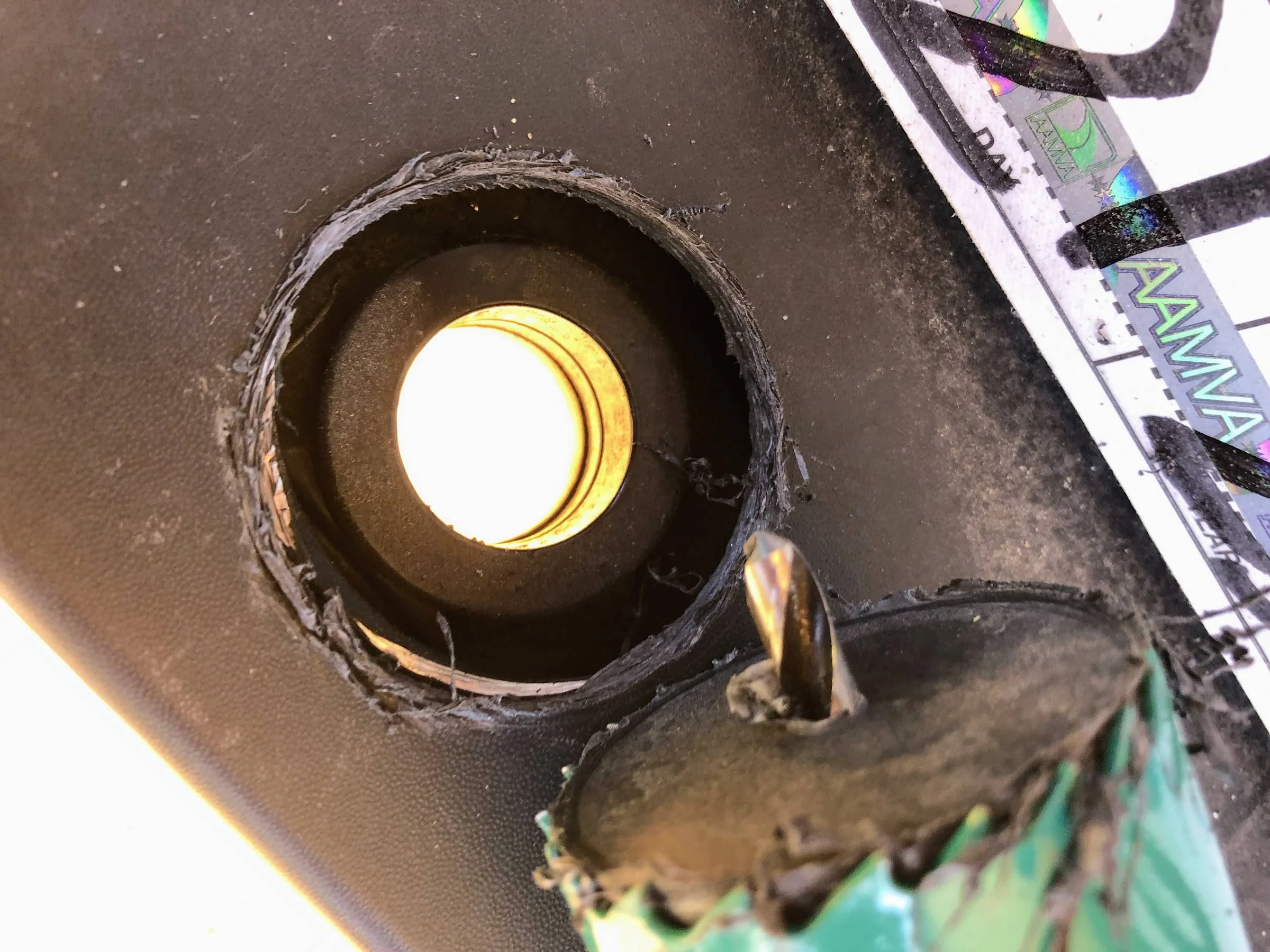

The thought of cutting a 2-inch hole in the plastic bumper
on my new-to-me 2021 made me nauseous
so I attempted to remove the bumper as I saw in one video.
That is when I determined that a Rubicon has a steel bumper.
Only the license plate centerpiece is plastic.
Back to square one.

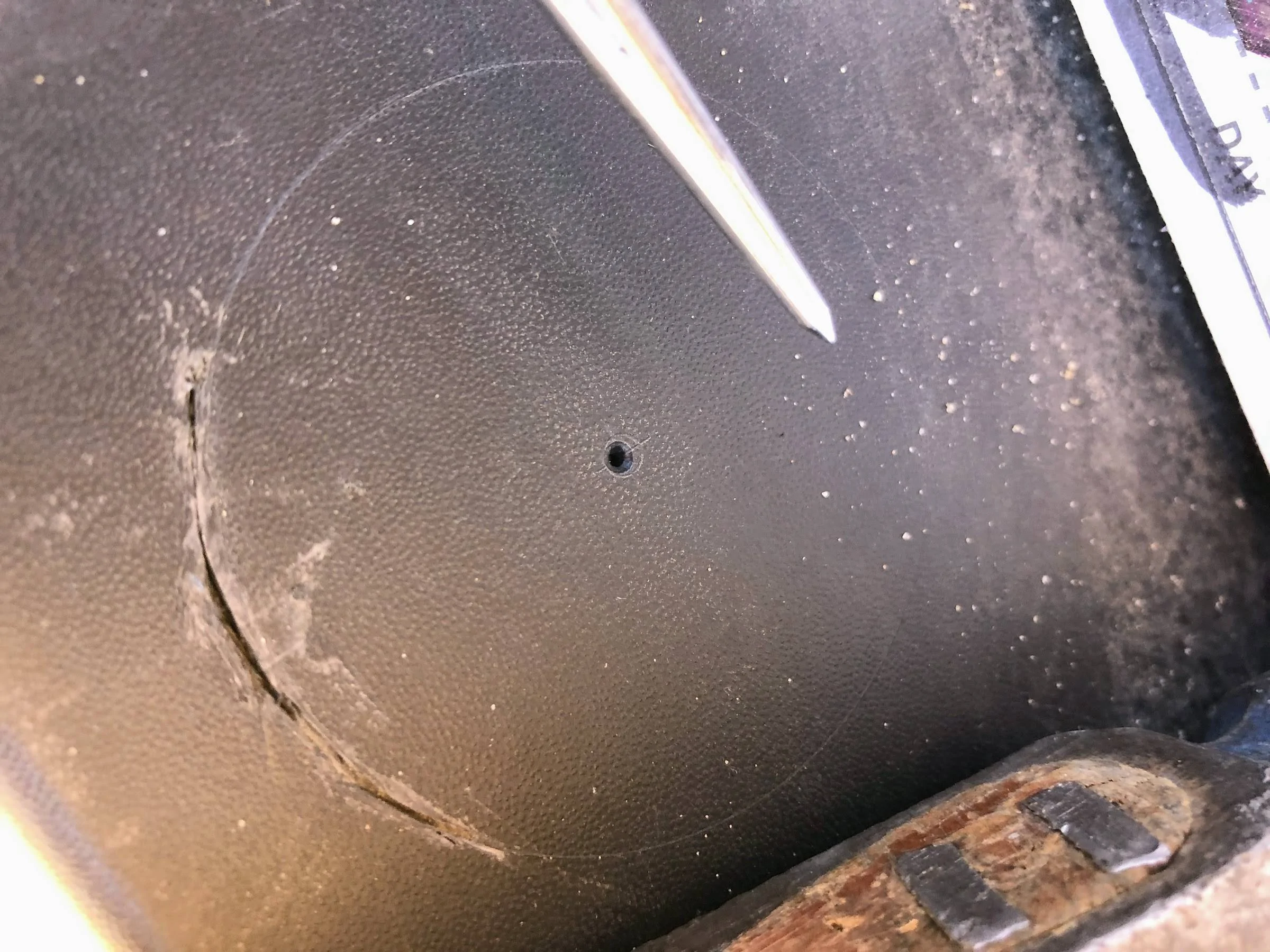

Another youtube video showed a fellow
cut out the 2 inch disc with a box cutter.
A few minutes of that was enough for me.
Armed with a new 2-inch hole saw
I carefully punched the center + mark
so the drill bit would not wander around
and drilled a great big hole in my pristine Gladiator.

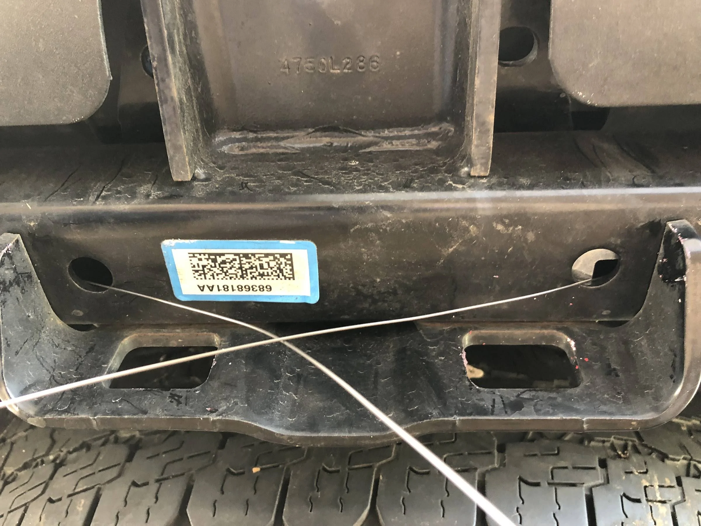

The fish wire was not cooperating
like it did in the video so I removed the hitch
thinking it would make it easier. Nope.

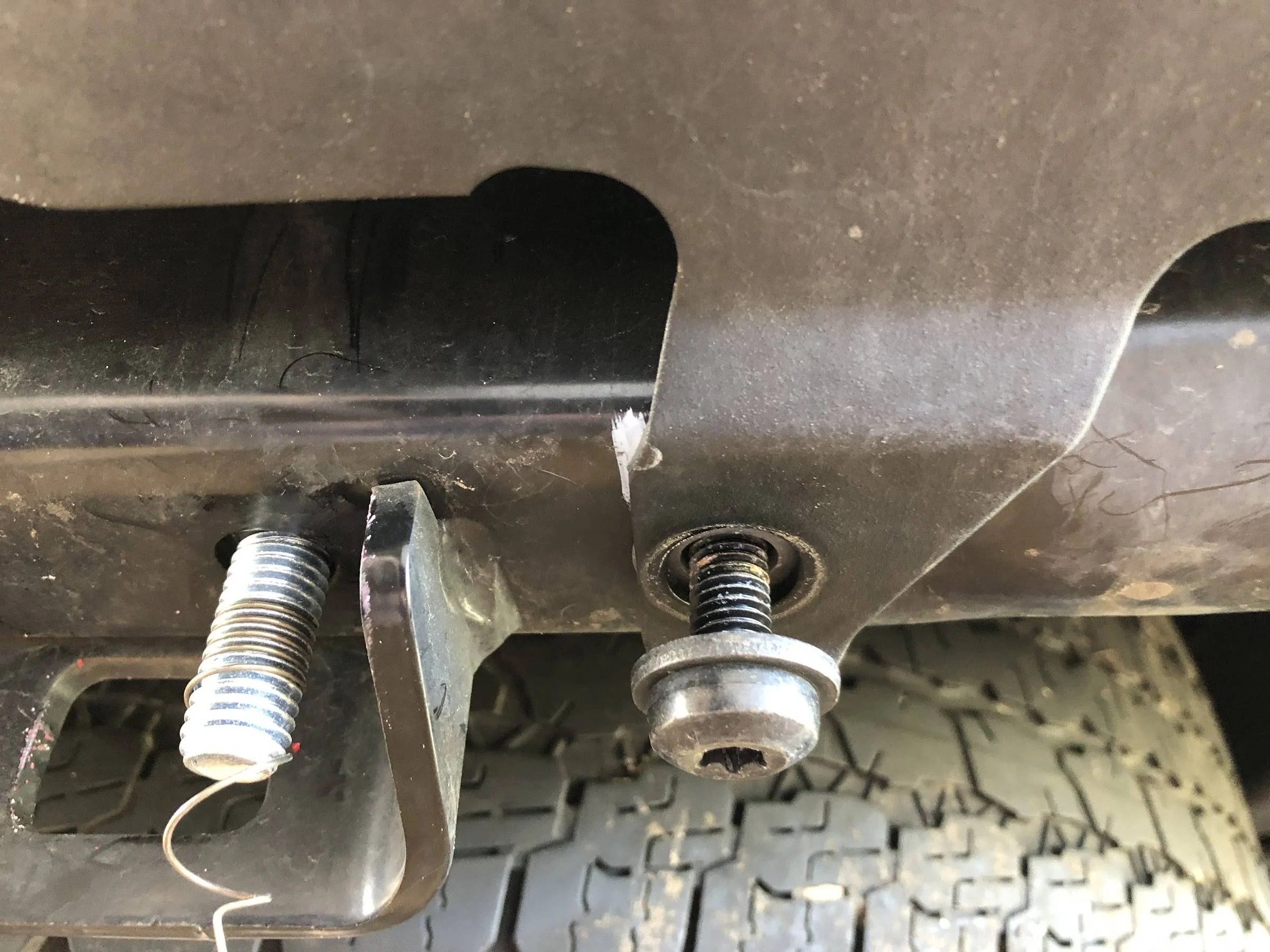

That steel bumper got me again.
Two torx screws needed to be backed out
using a T47 Torx bit from a previous misadventure.
As usual, it was ultimately located in the last place I looked.

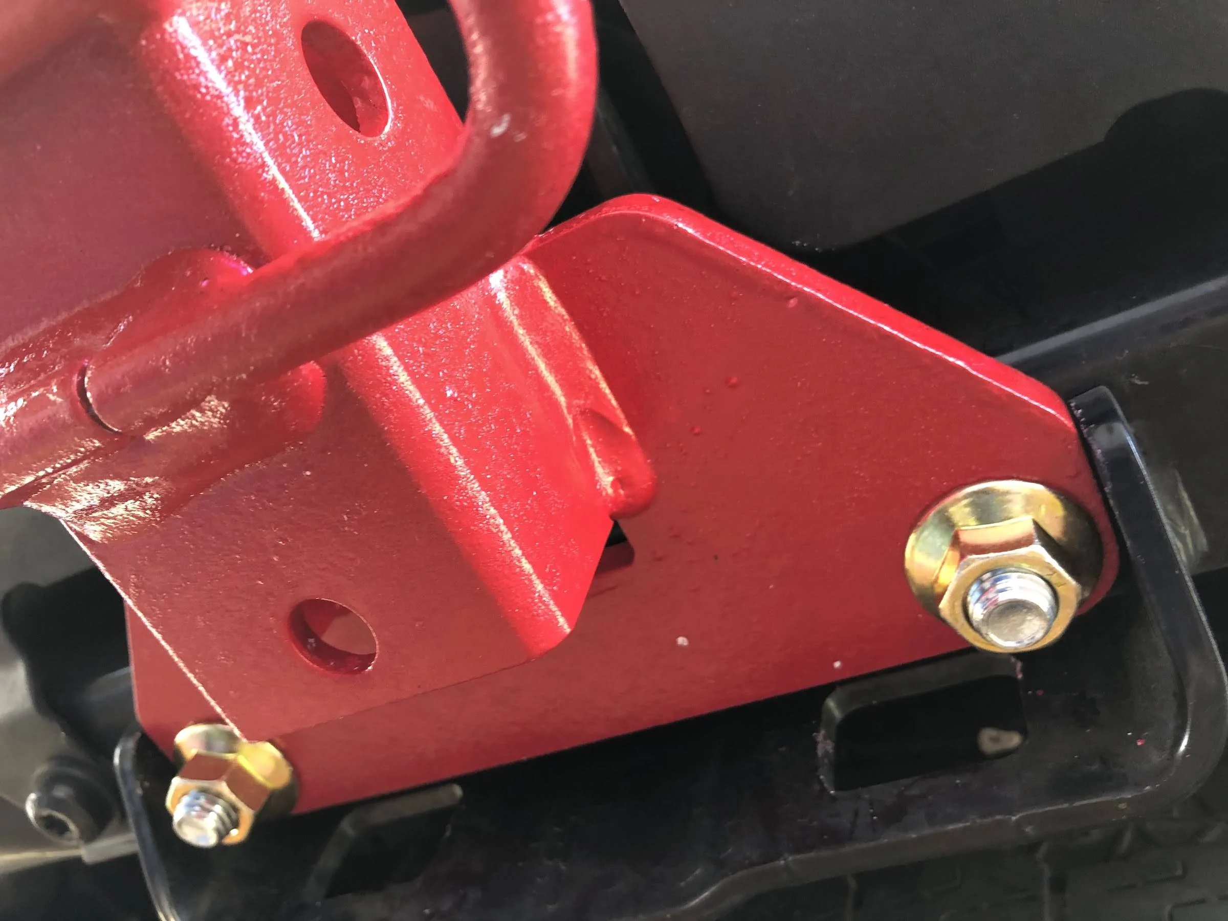

Then the 1/2 inch bolts slipped through slick as KY Jelly.
Jeep Gladiator Hitch Installation Trials and Tribulations 0TqaJ05-AuTFEH_v_av1_syGlhmutSMvIjMTy1fHEBU0=w2400
Jeep Gladiator Hitch Installation Trials and Tribulations pnCyhHTq2f1cWykRNopU5UoTbkGul863S5VYW8Wdq3qU=w2400

Did this install on my old Willys. Not sure what issues you had with the fishing wire. Mind elaborating?
The Torx bolts in the steel bumper of the Rubicon
protruded into the crossmember
blocking the 1/2 inch carriage bolts.
